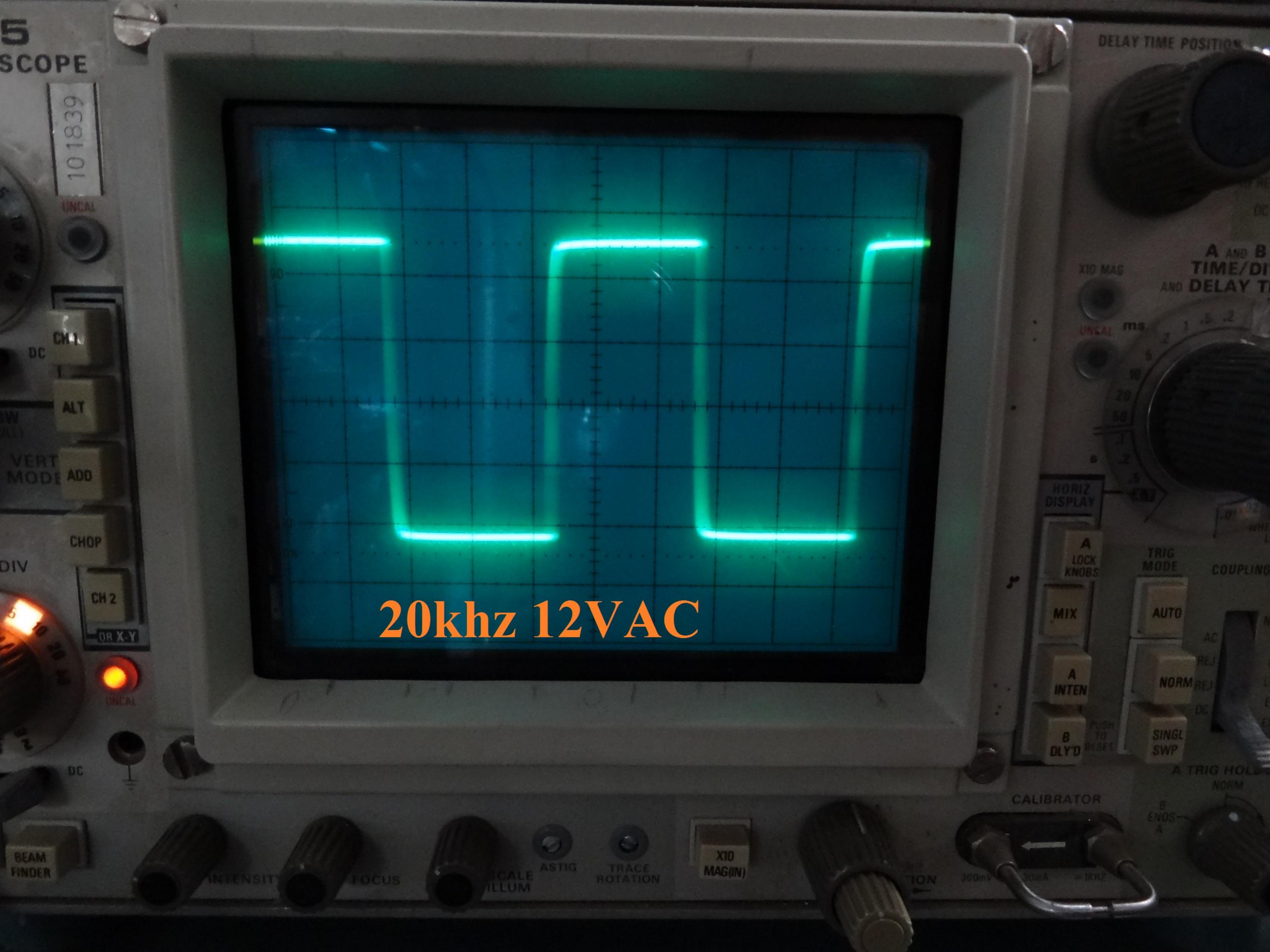

Keep in mind that this oscillation picked by the coil always exist
Can you replace 100nF de-coupling capacitor with ceramic X7R or film type? Maybe paralel it with 10nF ceramic?
I will try with multilayerCan you replace 100nF de-coupling capacitor with ceramic X7R or film type? Maybe paralel it with 10nF ceramic?

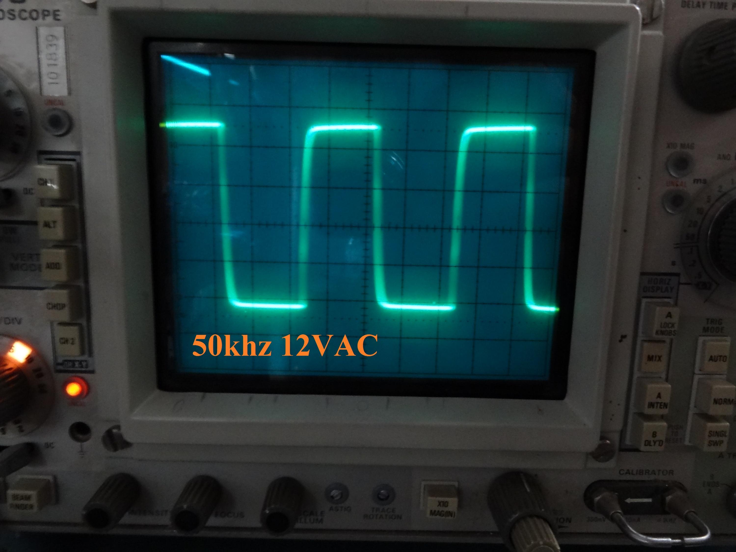

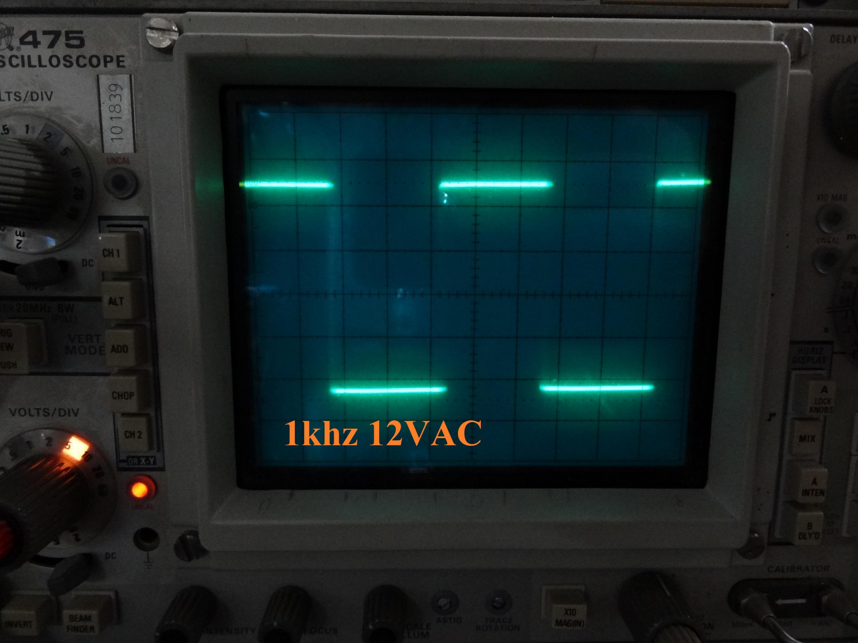

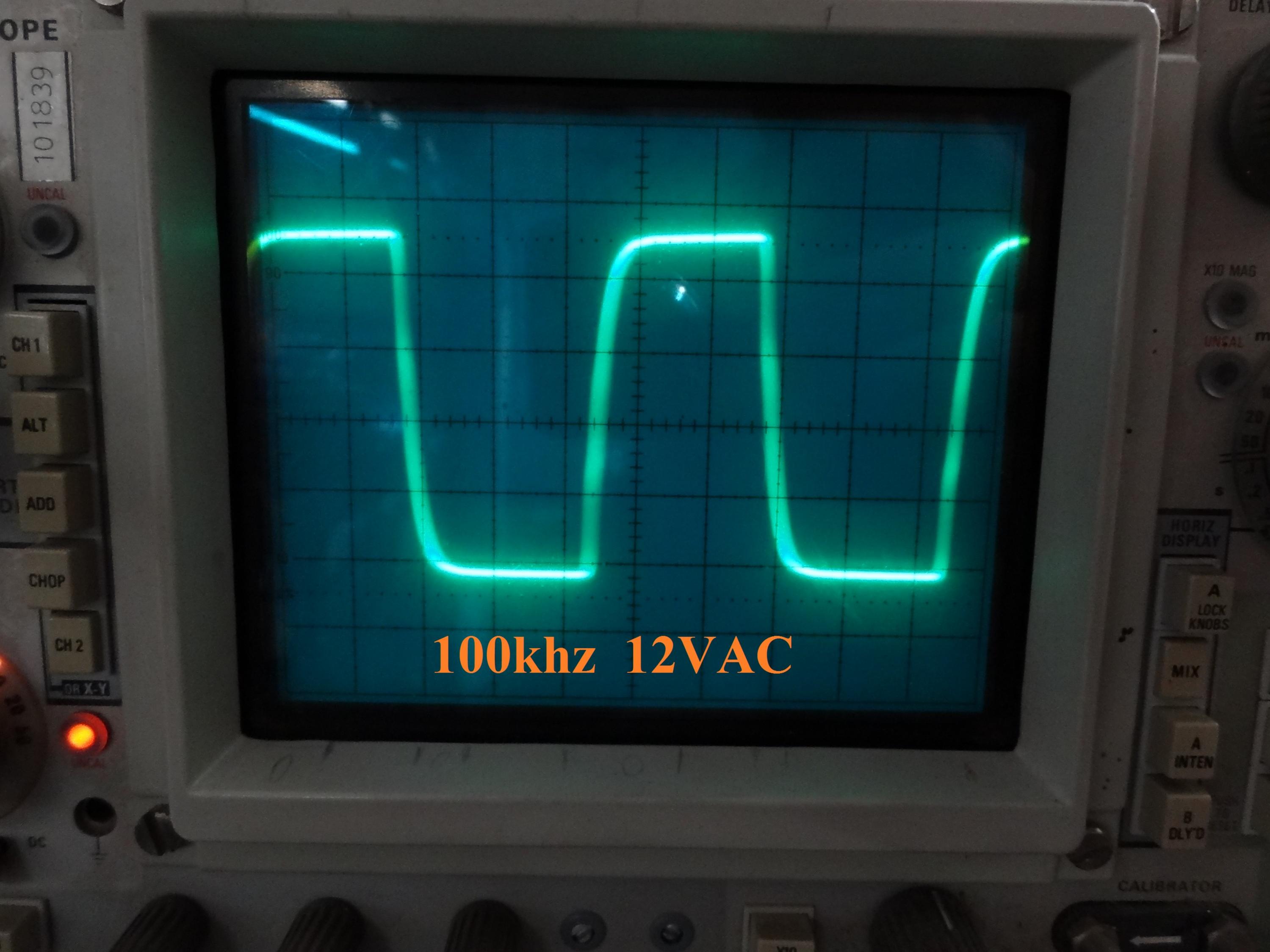

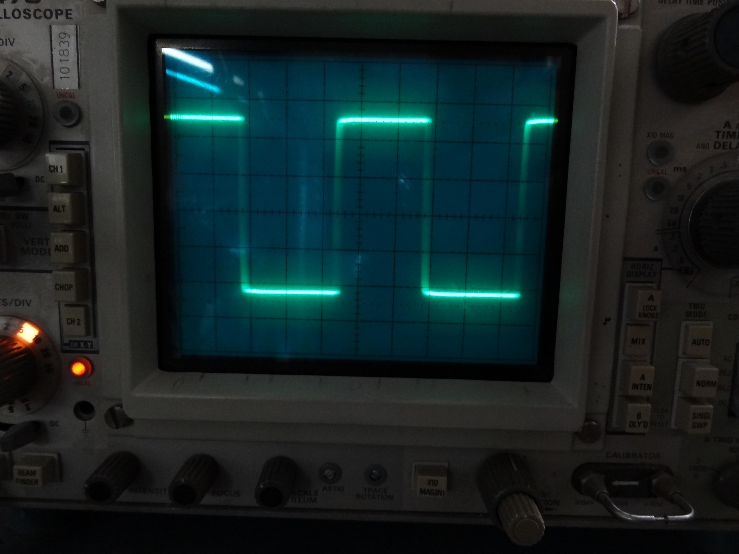

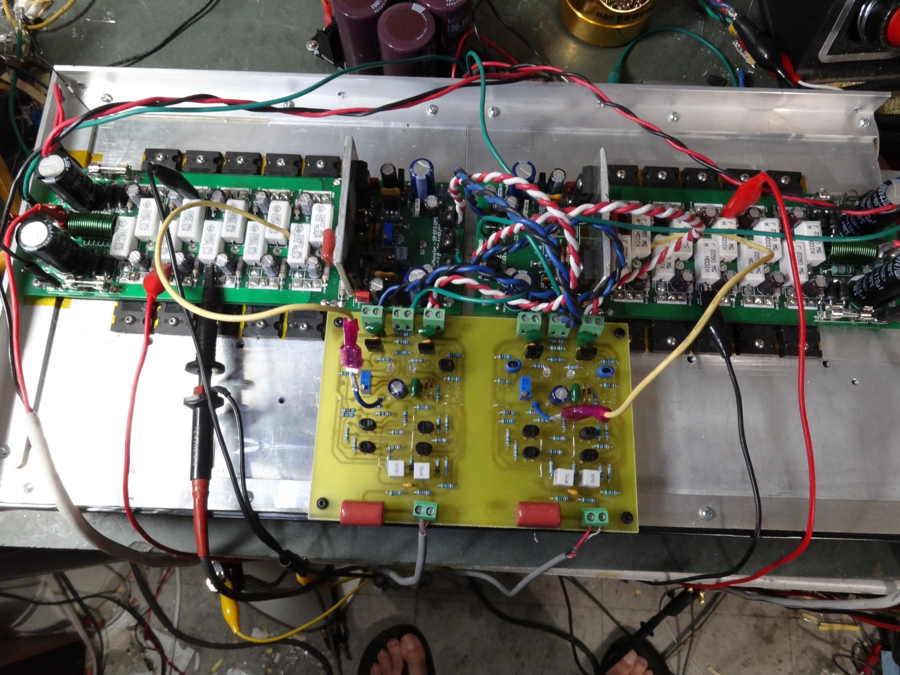

I pulled Cbp1 and Cbp2 and that did the trick. Square waves look clean. No more sizzling. Plays great.
Blessings, Terry

I have it hooked up opt2 except for pulling the two caps. I can post more pics. I've only listened for about an hour. It sounds pretty much just like the other slewmaster IPS. Great!

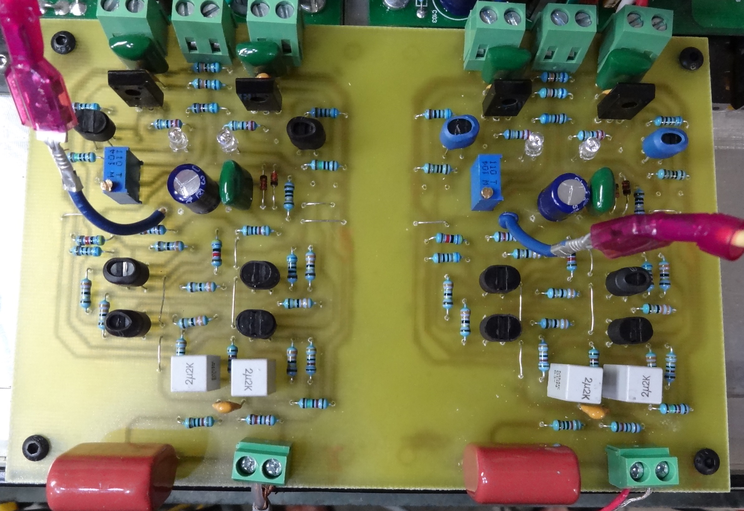

Here are some pics.
Cool setup you have there , Terry ! (clip them toenails 😀 ) .
Looks good , you have a big OPA660 IPS now.
If it looks good now , reduce the comp caps , it should do 250khz just as good
(it can go much faster).

Here are some pics.
Nice work Terry!! Now I just have to start etching my own PCBs like you do. If you have any tips you can PM me.
