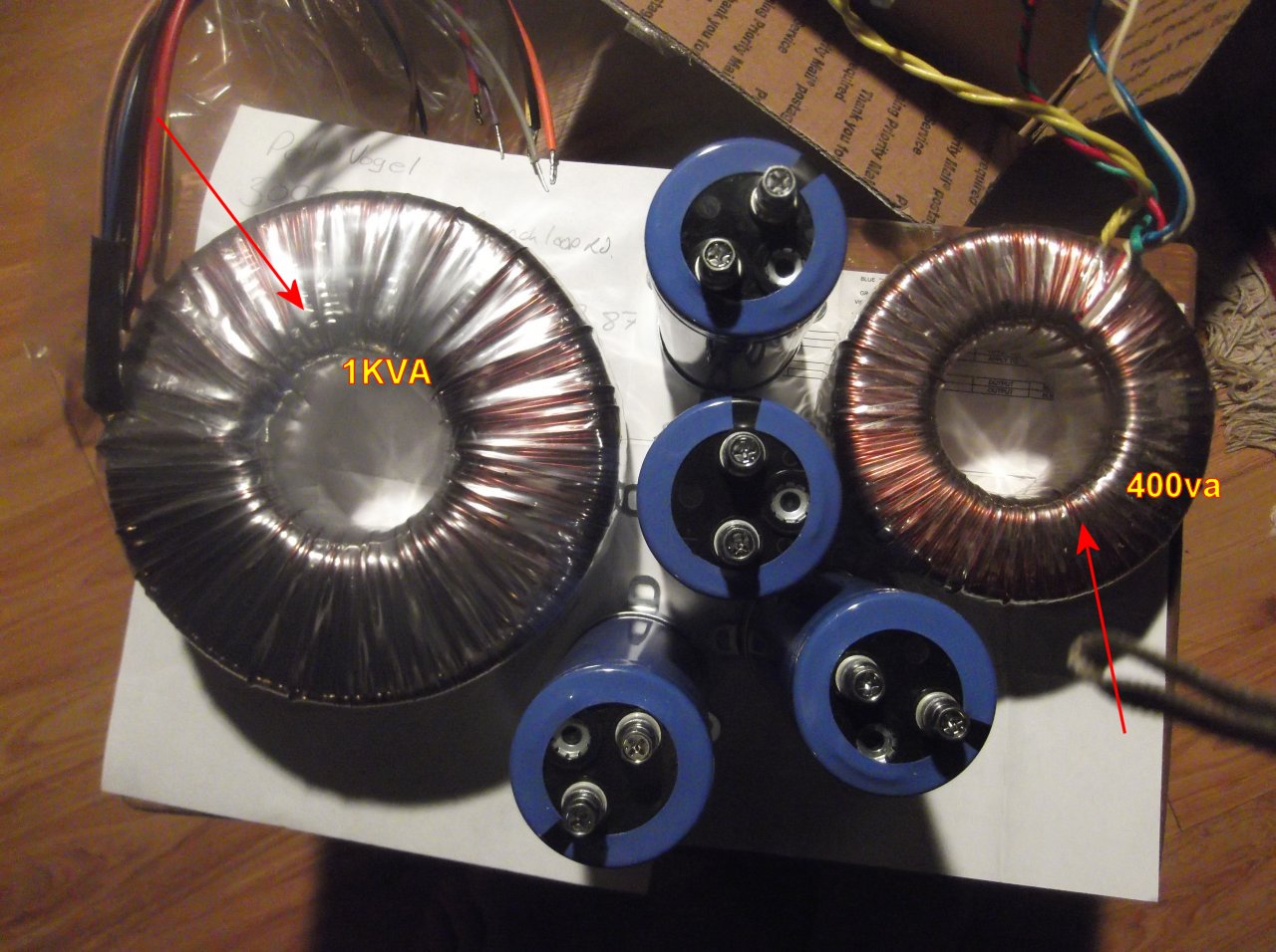

(below) - thanks EvanC ... is the "real man's" trafo. Then - the "hulk"
(bigger one)came in the mail ...
I think my previous Genesis trafo was 800VA , the "hulk" is massive.
I tested all the photographed items ... the "realmans" gives 60+V per rail.
The "hulk" will do 70+ V per rail (with a 500W halogen hooked to it).
That was the only load that could even be measured (as a load ). 😱
