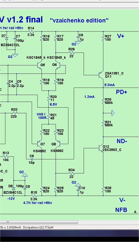

I replaced R7&8 with 100R and C6 with 15p. It is better but not gone. This may be a clue. If I hold the DMM test probes across ND- and ground, the pulsing stops. and D10 glows as bright as D9. With the probes removed D10 dims and pulsing starts again.
Thanks, Terry
EDIT; I just noticed that C6 connects to PD+ but there isn't a cap on ND-. Could this have something to do with it?

I use a slightly different compensation scheme... difficult to comment, not seeing the exact model. Well, you can slightly increase the base stoppers around VAS:
R26, R34 = 47R
R28, R32 = 22R
That's what I use in my design.
Also, 10-15pF caps between PD+ and base of Q9 as well as ND- and base of Q14 (Miller compensation) should stop the pulsing.
It may be optimized later on, but this is what I would try to reach stability.

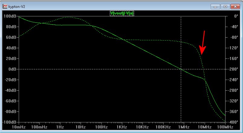

I took a "middlebrook" probe shot of the differences between a plain VAS
(below) and the previous super-pair config - the oscillator 😱 .
The "plain VAS" has no second phase "bump" after the initial drop (arrow)
(after) unity gain . Running "plain" , it is like a "blameless" (wolverine/Badger).
AND should be just as oscillation free.
PS- I'll have to explore this strange interaction between this IPS and
the more "advanced" VAS's.
OS

My experiments have shown - super-VAS likes Miller (or even TMC, as an enhancement).
It's a high-OLG design, so many factors, including purely implementation matters, play their role. Some Miller capacitance makes the whole thing less dependent on these factors, keeping it more "predictable"... Just as an overall observation 😉

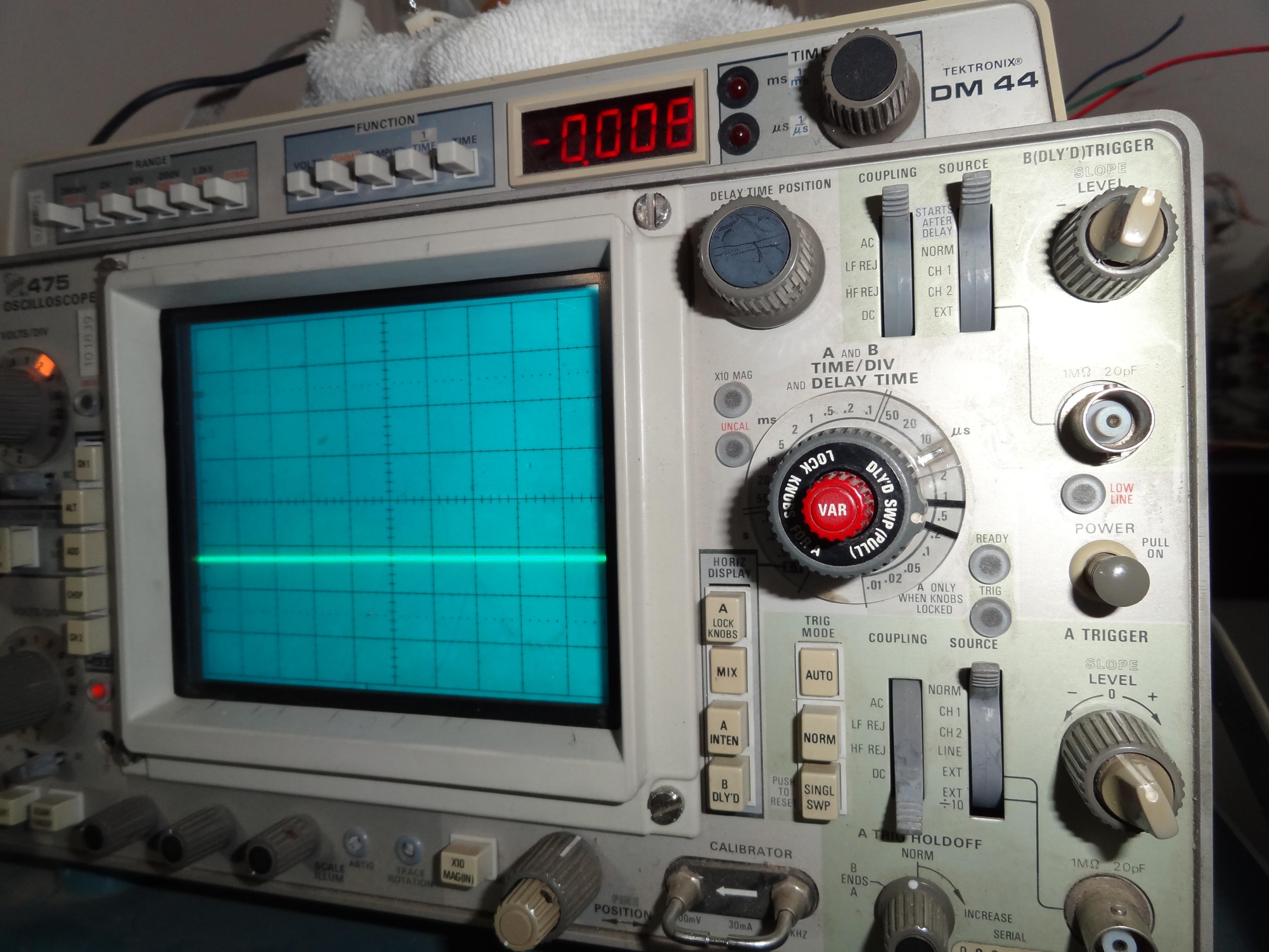

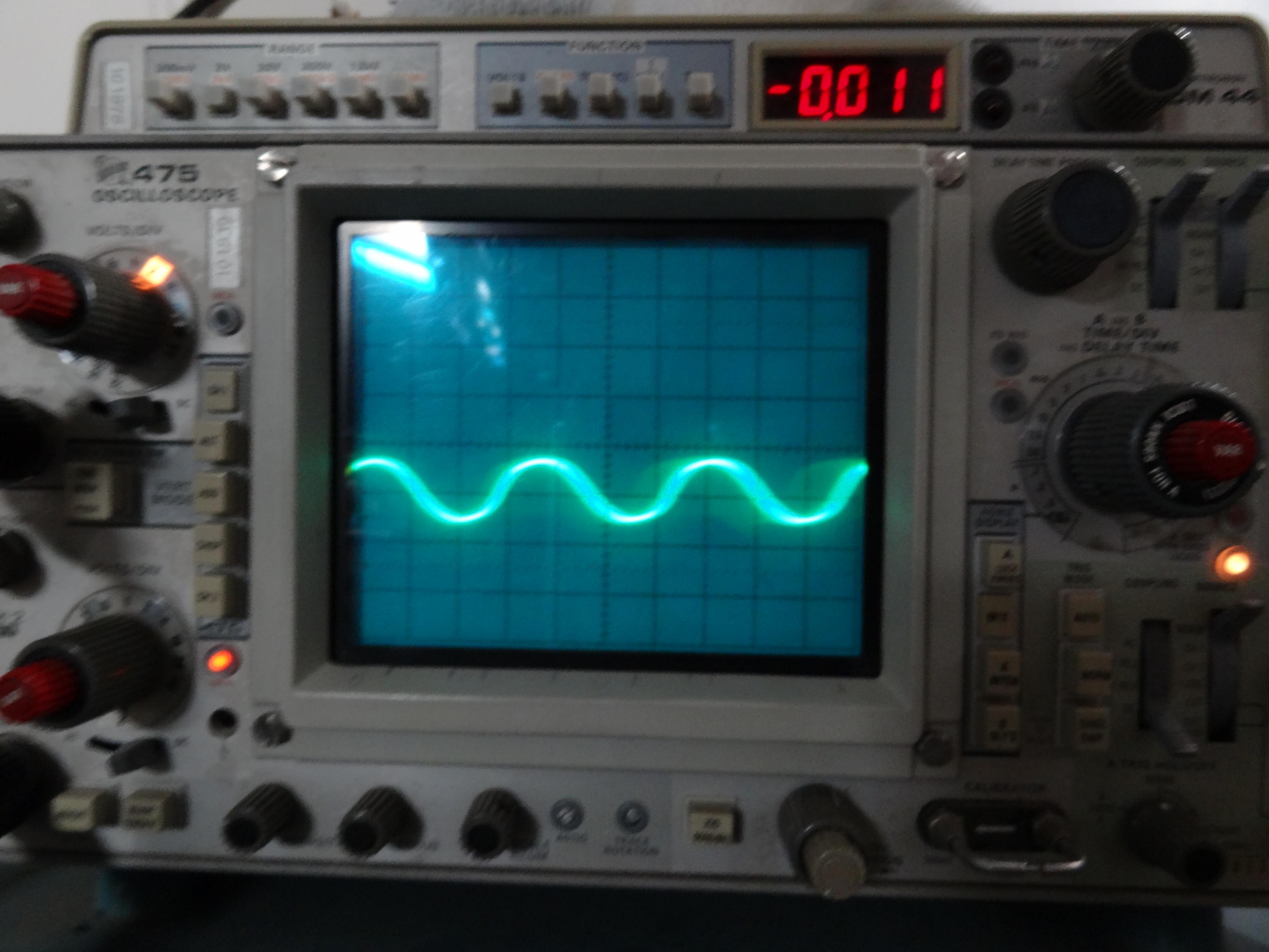

Good news. Being lazy I started with adding 10p across bases of Q9 and Q14 to PD+ and ND-. That did the trick. No oscillation and perfect sine and square waves. Do you think I still need to change out any more of the resistors? The output seems higher than my other IPS. I had to reduce the bias on the OPS compared to the other IPS units I used before. Maybe not a big deal. I will try to get both channels so I can give it a listen.
Also, I discovered the issue with the servo. I was testing at a lower voltage through a light bulb because of the oscillation. Once I took it to full voltage the offset is down to 1 or 2mV.
Thanks, Terry

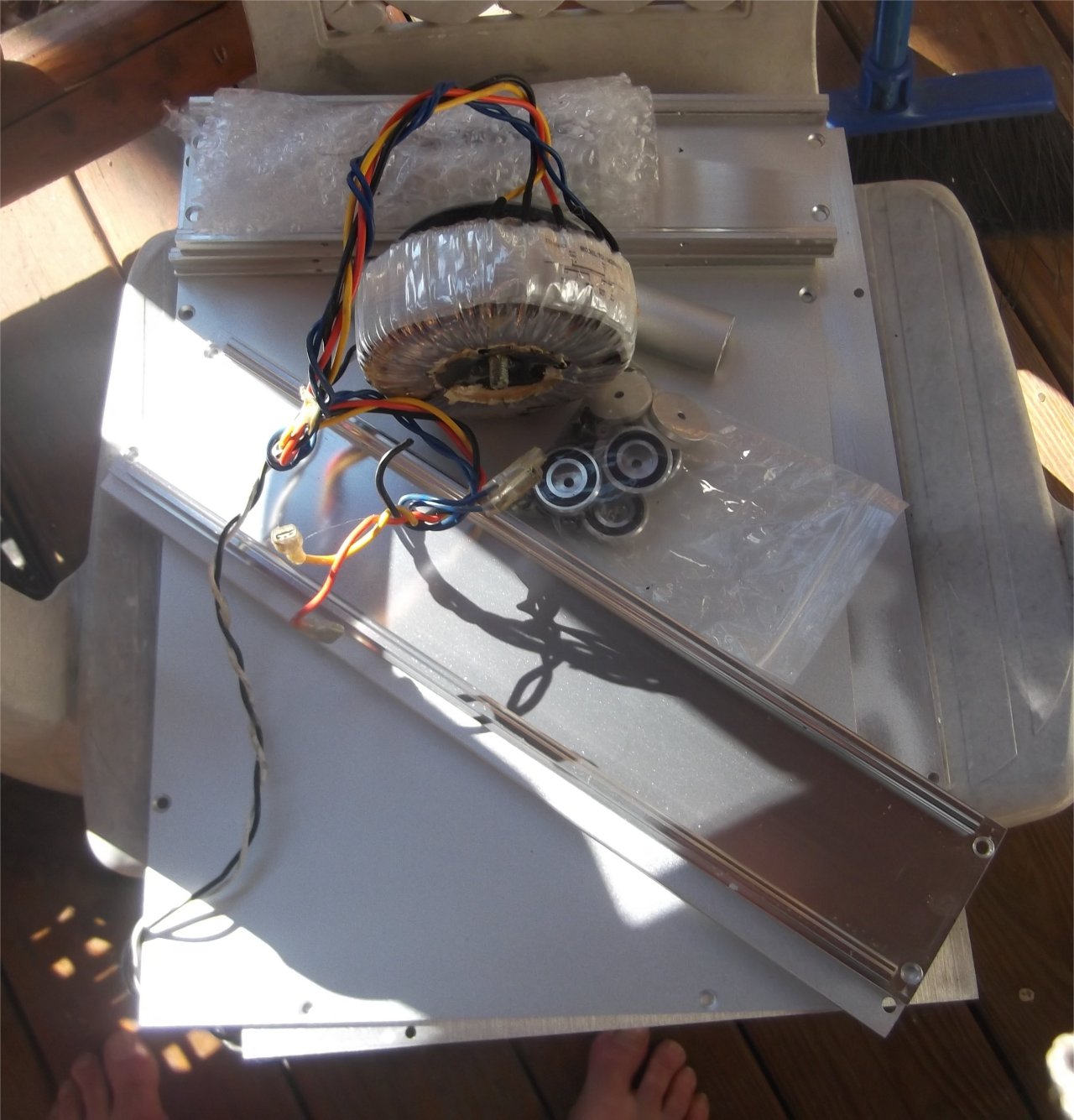

I have to figure who sent me a preamp case ?? Do they want me to
design a pre-amp ? (below - trafo and case).
These IPS's could easily be run at 24V rails and attached to a class A
(headphone/pre-amp) output stage.
