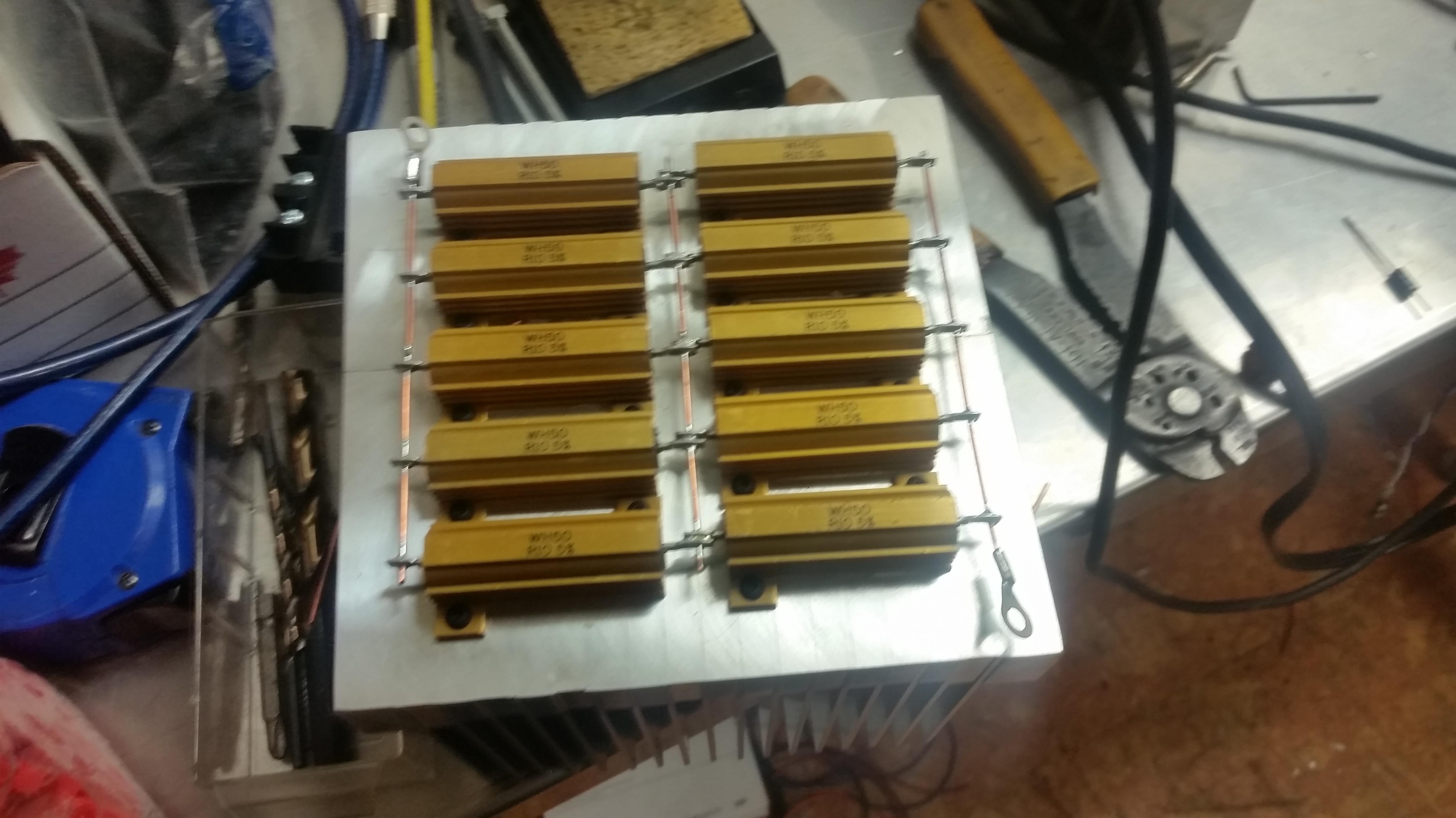

Or , running some of these "overkill" amps right into a 500W halogen
(as a load). I've also tested OPS's on an electric range element
or water heater "cal rod" ... most of these are 7 ohm resistance and will pass
1-2KW.
Use the amp to heat up some water for coffee/tea. 😀
OS

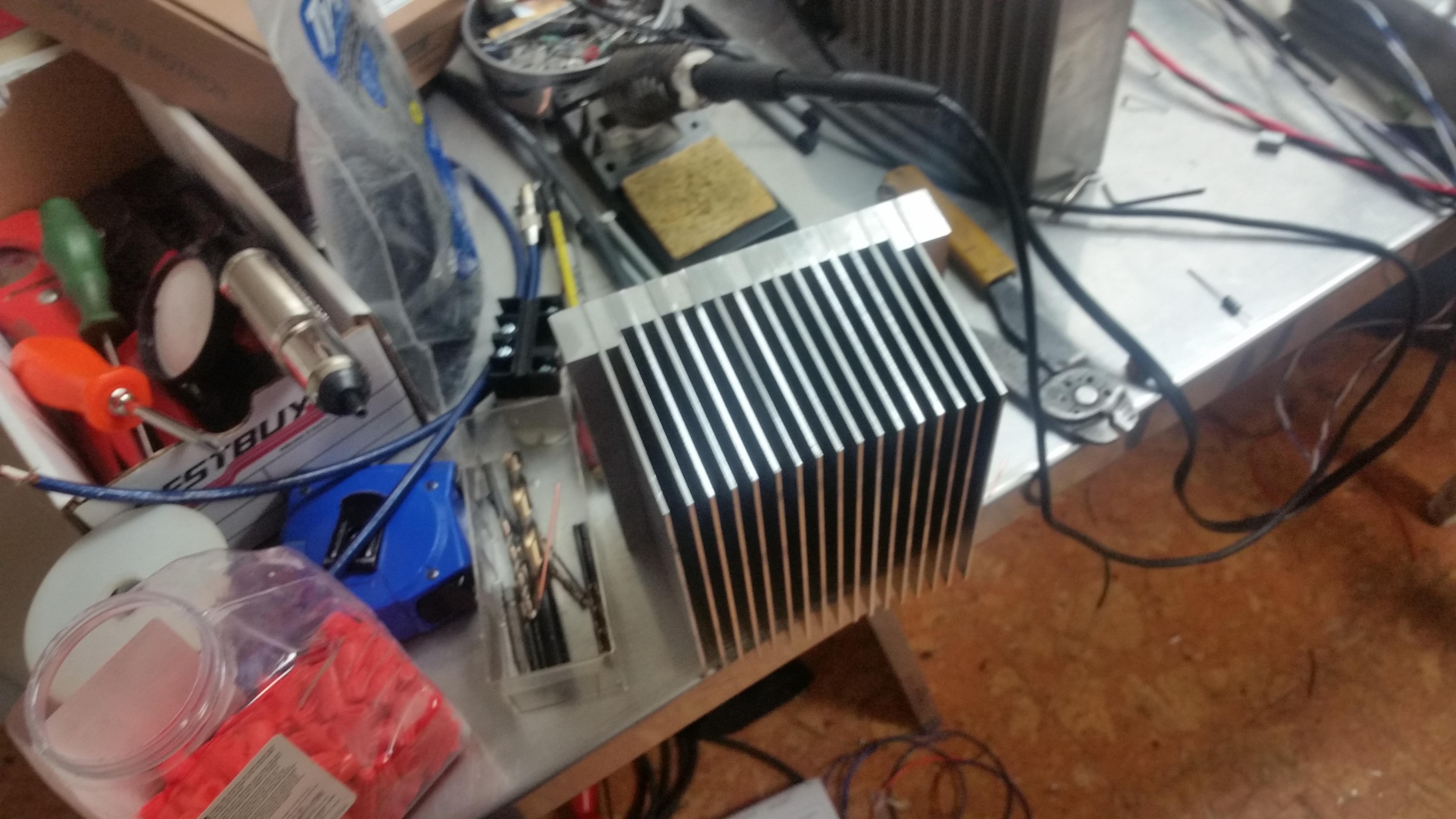

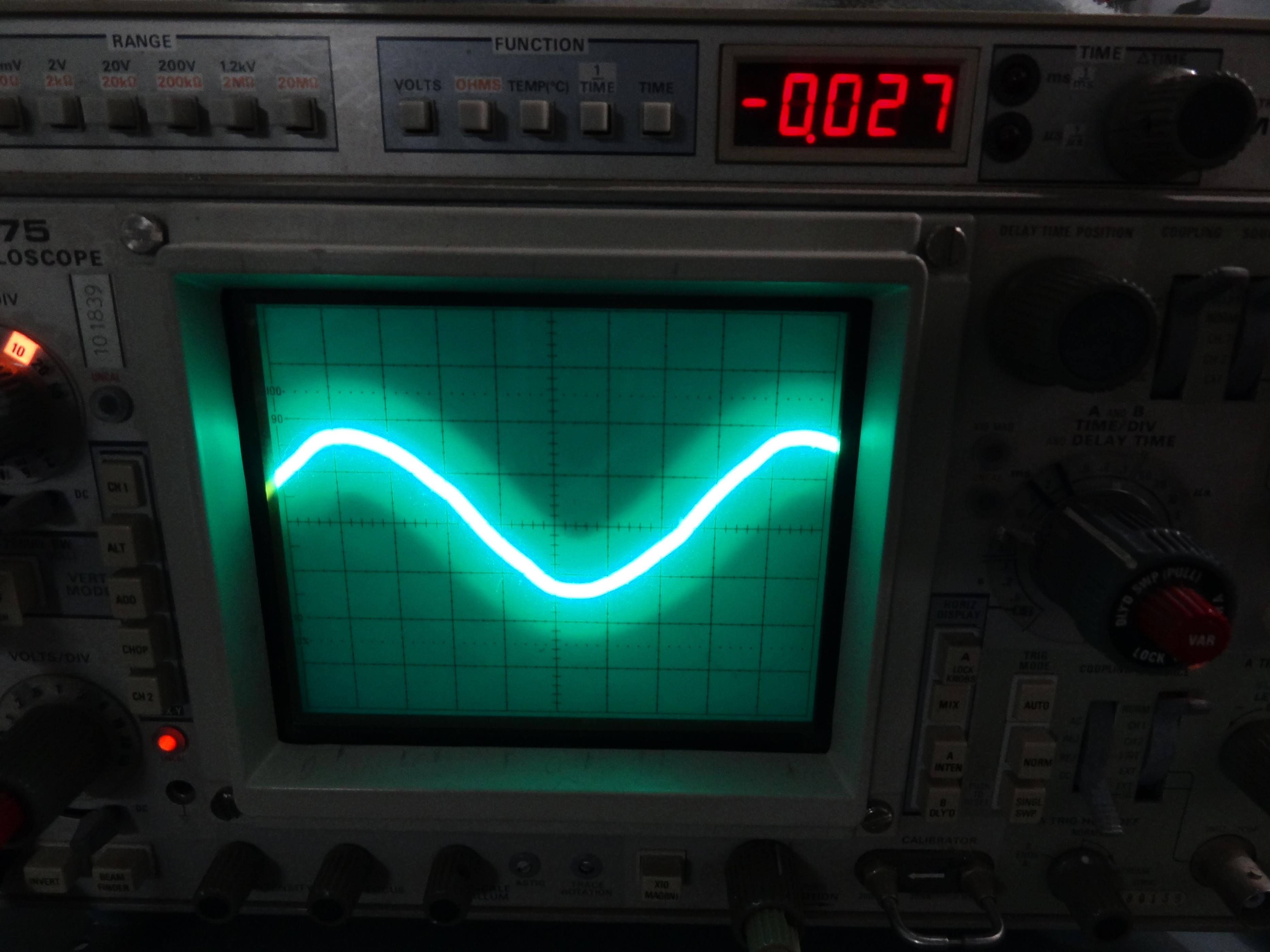

I'm putting fans on these. Two 500 watt 4 ohm space heaters.

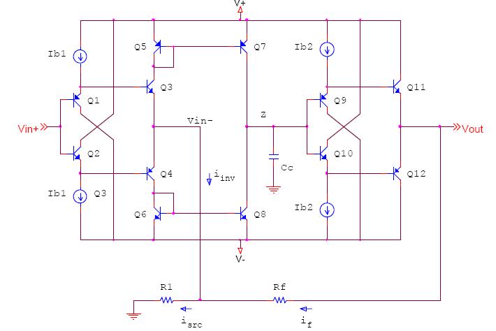

It looks like the VFA and CFA are closing in on one another. So, I would expect now that the sonic differences will be getting much smaller.

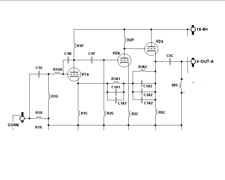

Here is what I derived and use -- when the tube was still the main device, nfb to the cathode was common (but this isnt CFA topology). Such as -

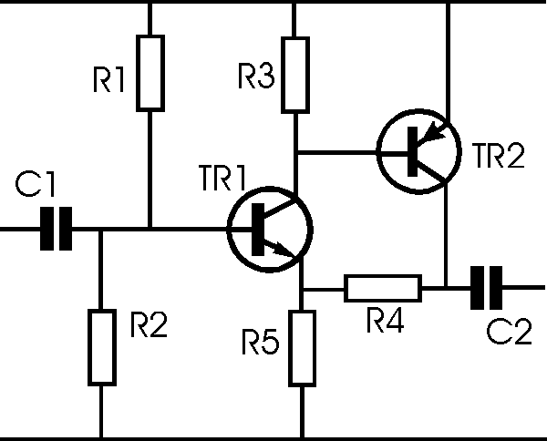

Then when ss came along, the designs copied the tube circuits. Such as -
What some, later did was connect the two of these circuits in parallel using compliments and got the circuit popular in DIYAUDIO (LC's original circuit?). But they were still cap coupled and still needed a large value c in the gain path of the nfb.
What I invented was to reconfigure the two compl circuits into one so they could be dc coupled and eliminated the big electrolytic caps. That is my contribution. Not the CFB Amp topology.
That basic circuit is the one I use now..... a complimentry push-pull from IPS to OPS... With fb to the emitters of the compl input pair. There are many derivatives of it now, of course. And, you are showing some close to it here. Such topology as --

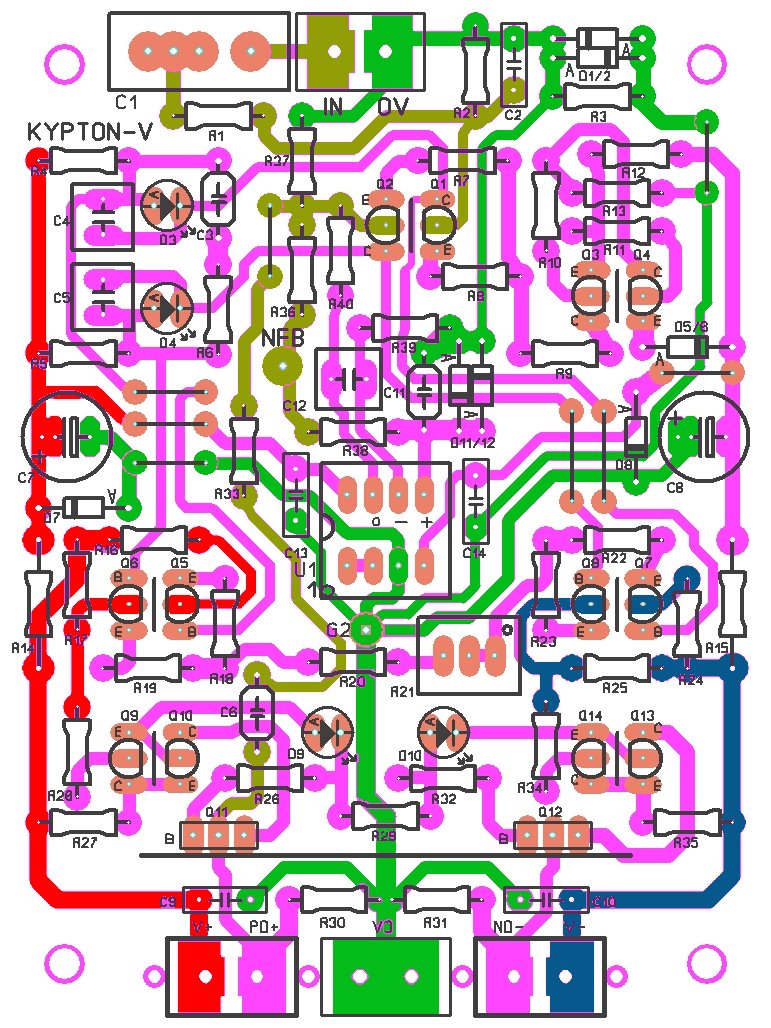

Still struggling with the Krypton-V.
I got the IPS working, sort of, stand alone. with 1k resistors tied to the NFB I can set the current to 10V from PD to ND. If my calculation is correct that should give me 5ma on the VAS. It will play a clean sine wave and even square wave on the scope. However, when I try hooking it up to the OPS it surges in about one second intervals. I also have to turn the bias down a lot. Any suggestions?
Thanks, Terry
