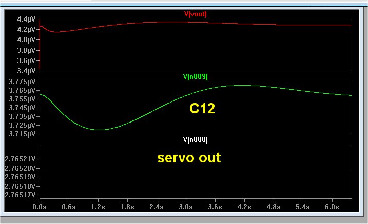

I don't consider this a major issue , but I did "revisit" the design.
#1 - I pushed it to it's limit to "bury" mike B's "symasym".
I especially liked the 2ppm 20hz performance , which is why I used the
servo in the first place. A DC blocker cap gave me .006% 😱.
68p for main compensation and R9/10 @ 68-100R still gives me 33ppm 20k
and a LOT less offset for the servo to "push".
#2 - I did use the Sansui Z for inspiration (servo wise). I overlooked the
"bleeder/shunt" (Rsl) across C12. It is better to deal with the issue
at the uV level than at the VOLT level.
#3 - Consider that to "float" a virtual ground off the servo negates
(Q2) from referencing to the actual input ground.
This could present problems if you hook up a input with a ground loop
or bad ground.
I even tried these changes on the real sansui (22K Rsl) and it shortened
the "pump" of the woofer (sansui has no relays) 😱 .
Edit - I went back to the original symasui servo with no "rsl" .. it
takes 4 seconds for C12 to stabilize. (below) You see how sensitive the servo is ,
3uV = 2.75V !!
OS

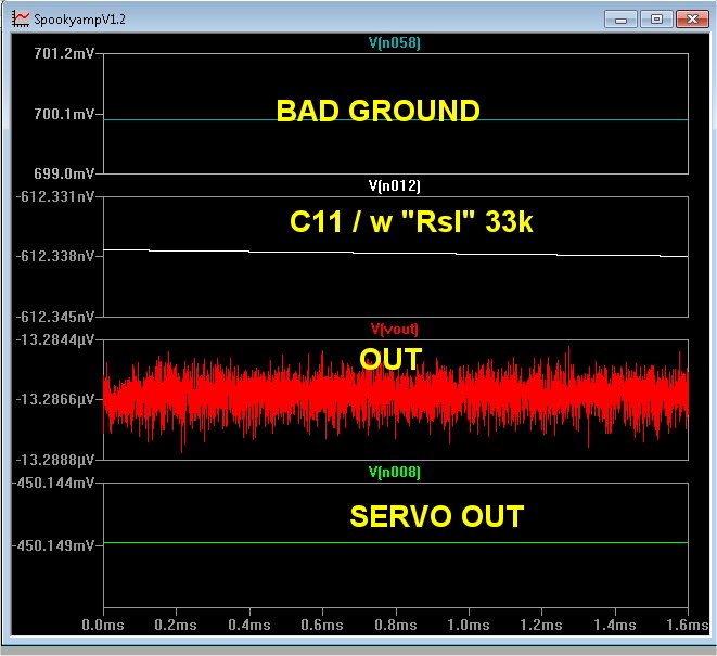

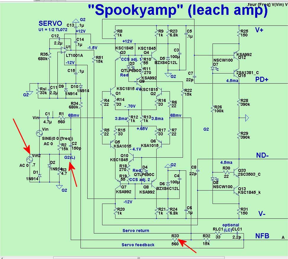

"Spooky" revisited ...
The "issue" is much less pronounced on the "spook".
But , in the name of perfection ... add the "Rsl" across C11 (22-47k).
Also ,the "spook" references its NFB from G2. This is not an issue
unless you have a "less than ideal" ground.
(below 1) I simulated a .7V "bad ground" at the input. Perfect with R33
going to G2(L) (arrows - below 2).
NO major rework for the first minor issue , R33 would have to bridge
NFB to any point on the lifted ground.
I will work perfect without these changes , but will be more so with them.
OS

Trace out my board, R33 is referenced to the 'lifted' ground already. I think I made that change because it didn't seem right when I did my layout it out to make the references at different locations, so I'm already there on the grounding point.
The issue is 1/10th the magnitude on Spooky as per prior testing, so definitely no real problem there, though I'm sure the added Rsl will only make things better.

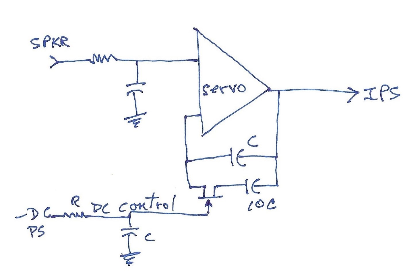

Some times a simple diode after the high R from the OPS can be used to charge up a small cap to turn on a fet switch. Fet switches in a parallel C or larger value for longer servo time constant. Result is fast initial response and then slower drift servo action.
Then hook up those bad grounds - Good to go !! A SAFE amp.
Protection Diodes would literally have to smoke before this equated to
a major output offset issue. 🙂
OS
servo C-multiplier
A number of ways -- shunt or series arrangements.... DC voltage may be taken from the speaker output and rectified or taken from DC buss thru RC timing network, as shown. switching in larger C to servo opamp after the RC timing delay. something like this maybe -
You could also place the fet switch across the input C in appropriate way to add more C.
THx-RNMarsh
Instead of switching another cap into the integrator , why not just
just switch the resistor in the integrator R/C ?
But I get what you are saying - change the Fc of the servo on a timed basis.
I'll add (it) to E. stuarts "super TIS". (or something similar)😀
PS - next "insane" creation. 😛
OS
THx-RNMarsh
Nice thinking, adding a startup switch to reduce the integrator time constant for initial settlement 🙂 I may experiment with this if you're ok with that.
Of course.
And increasing R instead is fine also... just not so much that noise or additional offset is created.
Or a fet switch across a second cap (or R) which opens after time delay. A number of ways once you got the idea.
