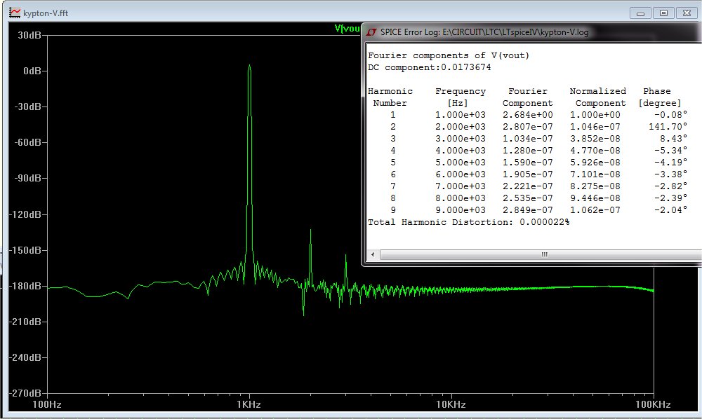

Class A 24V circuit (below).
I use this to test a IPS in isolation @ 5ma VAS I.
ALL present IPS's are 5-10ppm.
Kypton C/V are parts per billion. (in class A).
And yes , power supplies + layout are BIG factors. 😱
Edit , member 5th element did not get his 5ppm UNTIL he moved some wires.
OS

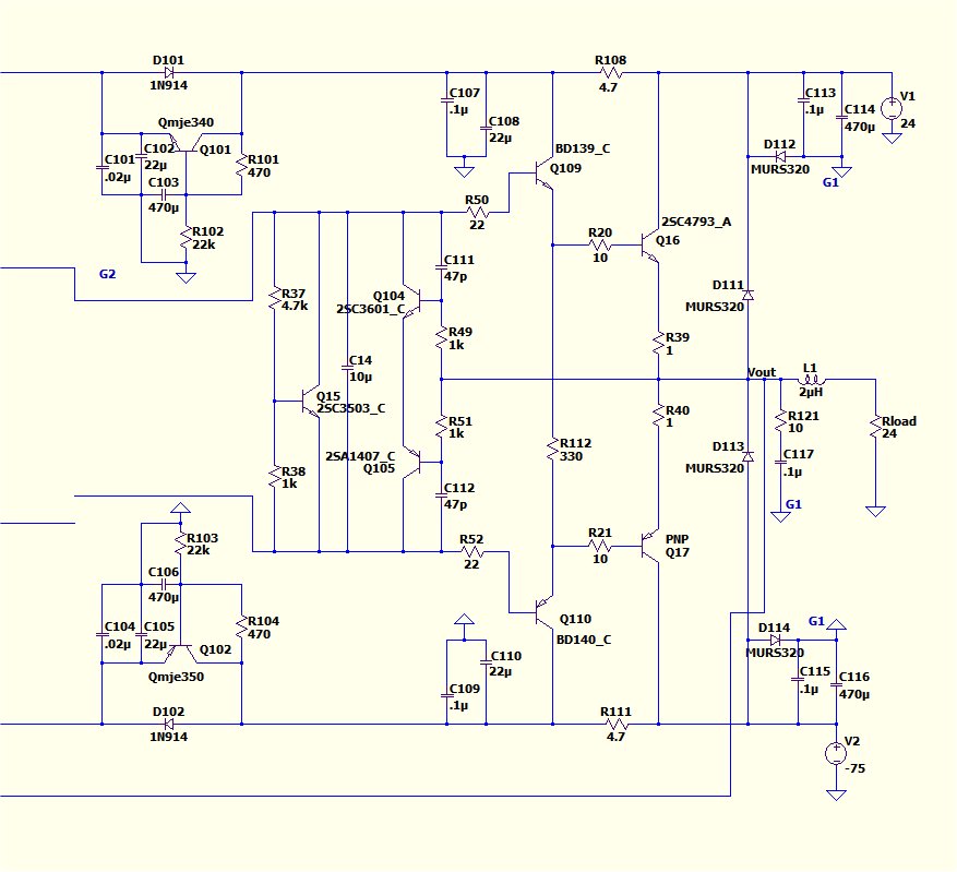

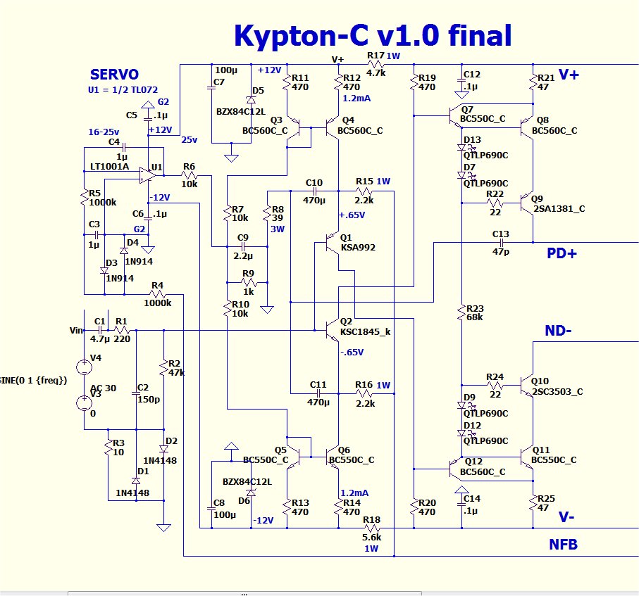

......have not laid out an "infant" slewmaster (headphone).
For 24V , all you would need to do is change any zener dropping resistor
to 1K on the IPS's. 24V-80V , these run the same ...
The kypton V/C IPS's are phenomenal in class A ! (below).
24R load -3w output. Cheap EF2 toshiba to-220 output stage .
OPS
