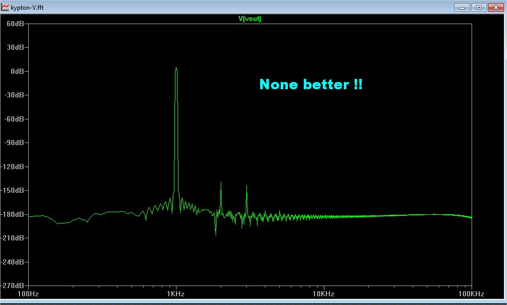

I'm curious how distortion levels appear at low power levels. Does anyone ever simulate at one watt? I still need to figure out how to use LTSpice for more than scematics. Never enough time!
At 1 watt , below the noise floor on the "C" , it has those dang caps.
The "V" ,I can jumper the DC blocker .... 2W is below.
It is 100 PPB (billion) with full even and odd cancellation.
(lowest FFT I've seen).
It just "ATE" the "blameless" (lameless) .. 😀
PS - The 1 watt behavior and how the amp's response changes at
100W is a IMPORTANT factor in it's final design !
Oh ... The "C" is about the same as the "V" - performance has "merged"
(except in slew rate).
OS

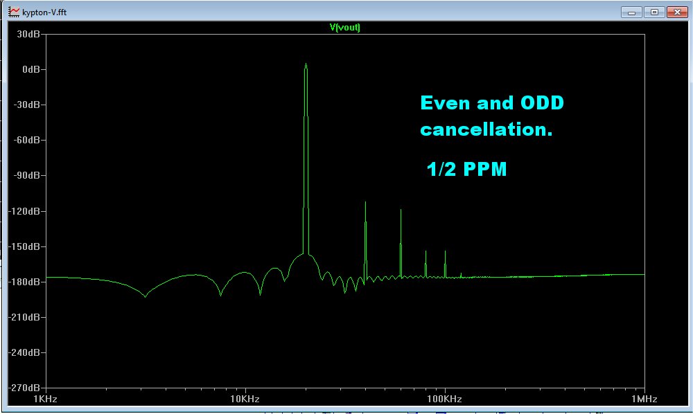

So am I following this correctly and these latest Kypton versions are to supersede any of the earlier CFA-X and Gonad versions of CFA input section? This is your current SOTA pair of vfa and cfa input section?
The last ones were quite hard to beat. These took longer.
These ones mainly will endure overload better , run at lower
currents , are even more stable ... etc. PPM THD is lowest I've
achieved to date. Both will run PPB (billions) into a class A OPS.
PS - just to get a few PPM.
Edit - but I DID beat them .... 1/2 ppm 1W THD20K - best even/odd cancellation (below).
OS
