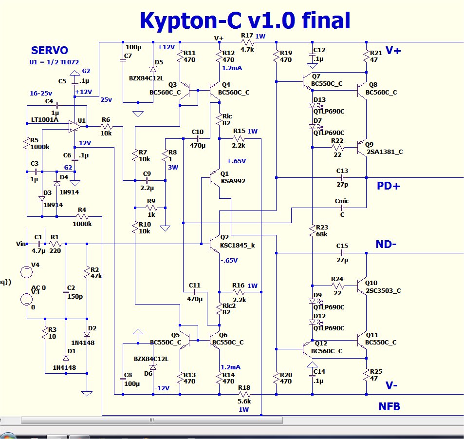

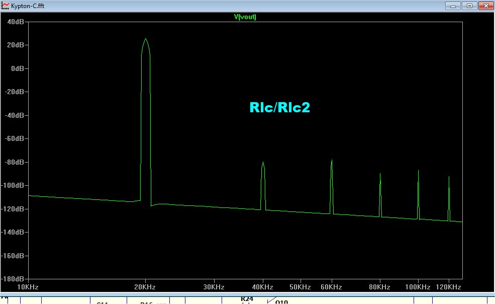

(below 1) - I ran the cat's original FB scheme. I still get 8ppm and the same
basic performance.
The single digit performance is due to the VAS/mirrors (80+db CLG)
, not bloody "secret sauce" (go to Mcdonald's for that)!
In fact ,using (Rlc ,Rlc2 - R8) , the H3 was more (below 2) than with a summed FB scheme (R8 only). H2 was dominant with the "BV" FB.
Also, 50hz performance was inferior ,too.
Well , I'll leave it to Thimios ... The prototype will have both compensation
types and both feedback paths (jumper Rlc/Rlc2 and include R8=39R).
I bet either way will sound fine .... not "unlistenable" ($$$$$) .
(Ohhh , voodoo magic - unobtainium).
