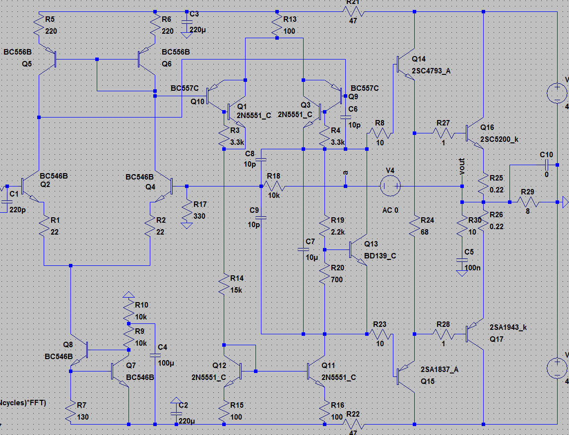

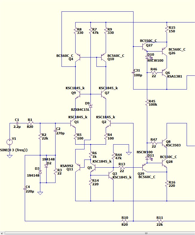

new stuff / old stuff = more IPS's
A few more tinkering(s).
One does 15ppm,the other .... 8 .
First is - "badger/wolverine" meets hawksford/ baxandall.
Second is a folded cascode ...(Roender , abomination , havoc)
Might they sound different ??

Just if it can help some of you to figure out the pros and cons of adding a driver after a VAS, or any additional pole, and looking at its input ( a tip that i recommend) in my DDSSA, the frequency where the bandwidth increase of 3dB (in connection with the open loop bandwidth) goes from 9KHz with DVSSA to 7KHz for the DDSSA. Means less feedback ratio (more distortion) at 10KHz.
In a ideal audio world, with devices offering a transition frequency faster than our poor 100MHz ;-), it should be flat up to 20Kz , or, at least 10KHz if we consider 19KHz as our audibility limit (harmonic 2).

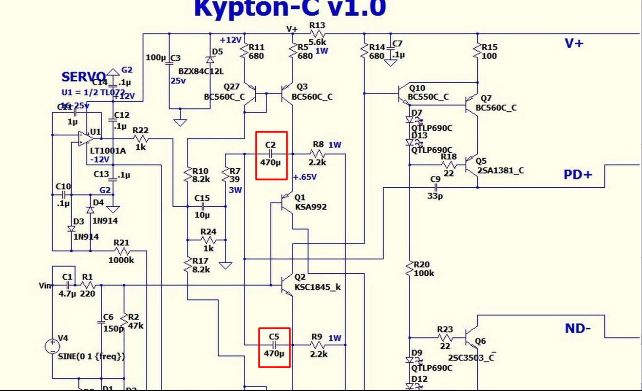

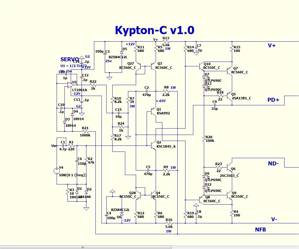

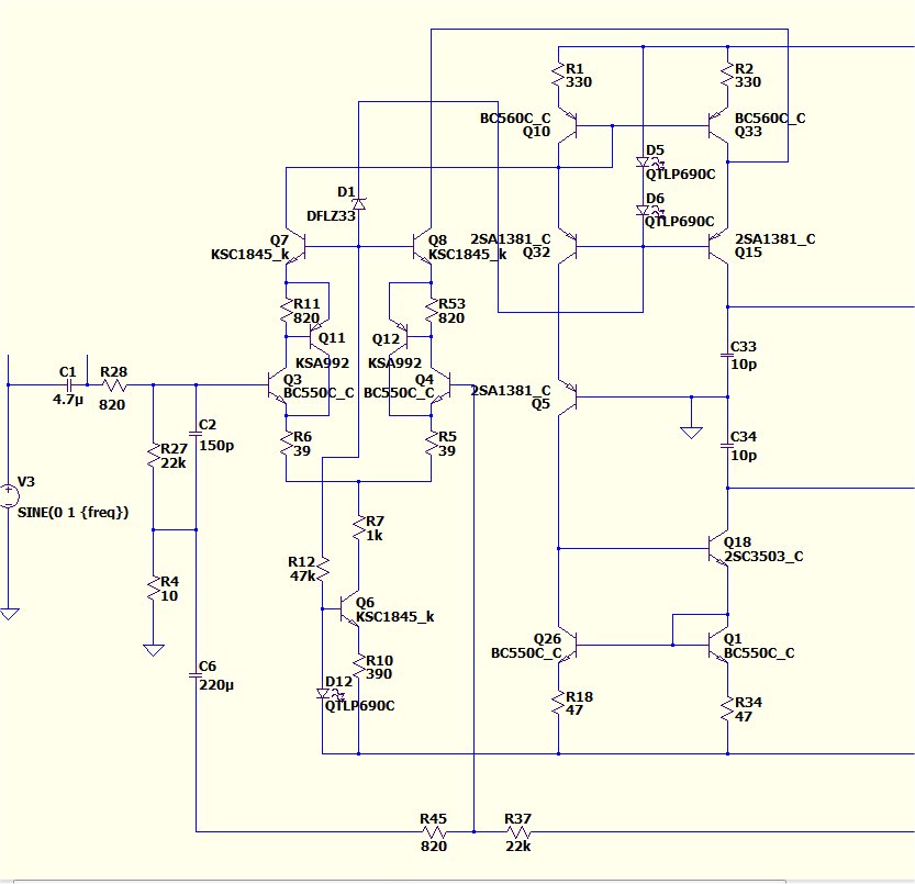

I'm going with the "Kypton's"
Kypton-C (below 1)
.. is a "jewel" (vssa/CFA-X) with all the "toy" like issues solved.
-90db psrr.
-8 ppm.
-servo without DC NFB.
- cool running with 4 red LED's.
- simple 12 device unit with 1 comp. path. (MIC)
I like it.
My last posted "Kypton" is the V (VFA amp).
Apex amp with 20X less thd and good clipping .. 3ppm.
Actually beats the "wolverine" :eek: .
The "C" can go as low as 1ppm if you replace the simple mirrors
with wilson mirrors. The drawback is loss of (a little)voltage swing at
the hawksford (1 more led !!). But , you will have a unique "wilson/hawksford".
PS - slew is "king" .. bandwidth can go as high as 4mhz (PM is less). :D
Edit - ahhhh - CLG on this CFA is 90db+ @ 1K ... like a VFA !
OS

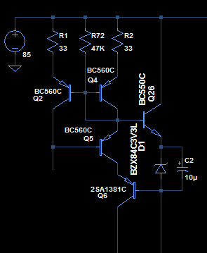

I have a trick for your hawksford cascode that makes that particular combo (current mirror + H-cascode) perform even better. Add Q26 in the diagram below :D (Do the same on the bottom end).
I've accustomed myself to call the upper circuit half of an amp the "North" side, the lower half the "South" side. So yeah, add the transistor to the south side of the cascode also.
Edit: Oh yeah, you can equalize R14/R15 again in your schematic after adding this little mod :)

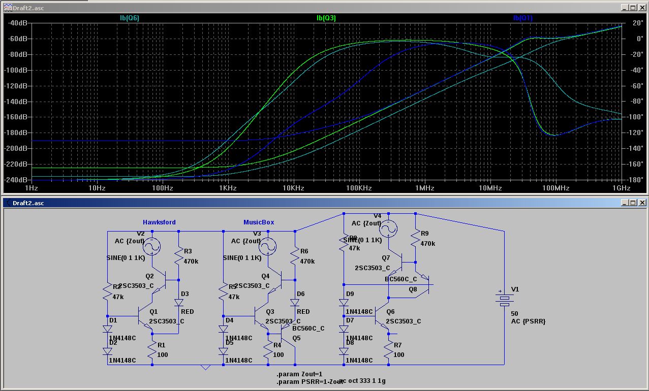

In what way does it perform better? You defeat the base-recirculation loop, which in my simulations reduces CCS output impedance by more than 10 times. Output impedance is generally the main reason to use base recirculation.
The cascode Ib is prevented from flowing through the VAS transistor, so this eliminates one of the last sources of load-independent distortion for this VAS.
However we still have the problem that the base currents of the cascode flow through the VAS, which is unnecessary and lets some distortion through. The version on the right does better from a THD, gain, speed and phase standpoint, without sacrificing 20db of output impedance.

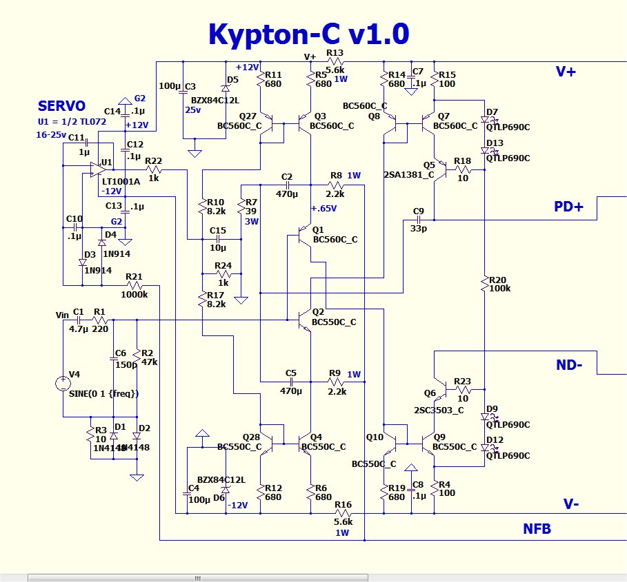

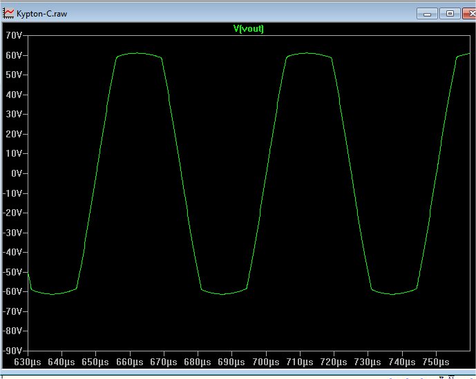

It is a "jewel" ...
Add the super - pair = 5ppm + good clip.
Nothing else changes , except for rounded edges. :)
(below 1/2).
PS - built either way , 5 or 8 ppm (what's the difference?).
Still ... a "jewel".
edit- everything still is VERY dependent on Q1/2. TO-92L would be the best
bet to get a "fault tolerant" design ( 12ma "bursts" with overload).
An inherent design deficiency that is unavoidable.
OS
Now what if you change the cascoded device (which you set by a series of diodes) into a current mirror? The improvement from the additional transistor may be a result of linearizing the current mirror again. When you let the cascode reference loop sink into the current mirror emitter resistor, this additional current severely affects current mirror linearity.
Edit: I'll give your version a try as well, might be well that yours works even better as it also avoids the reference rail sinking into the mirror itself, which was the main reason for adding that transistor.
Useful update: It's the actual equalizing of the current mirror emitter resistors that caused the improvements (in THD). Ofcourse obviously, but in Ostripper's schematic he has offset them to deal with the cascode reference rail current, to keep the VAS current an actual 1:1 mirror. But that worsens THD a lot. From then on, I went to compare between with and without that extra transistor. Adding it makes THD worse. In fact between these two, sinking the cascode rail into the CM is the better option and one should not offset the mirror emitter resistors and instead maintain a different thinking as the mirror output current is shared between the VAS rail and the cascode rail: I(in)=I(vas)+I(cascoderail). This however, is by using a Wilson mirror, the cascrail is injected into the collector of the Wilson cascoded device. Sinking into the emitter resistor directly I haven't tested yet.
Edit: Ok. Sinking directly into the emitter resistor makes THD go BAD. Offsetting the resistor to make the voltages across them equal again improves the BAD some, but not by much and it's still bad. Throw in that 3rd tranny and make a Wilson CM indeed :D Then, sinking the cascode rail into the junction that connects the mirror bases, has no impact on mirror performance. You're just splitting the mirror output into two rails in the end.
