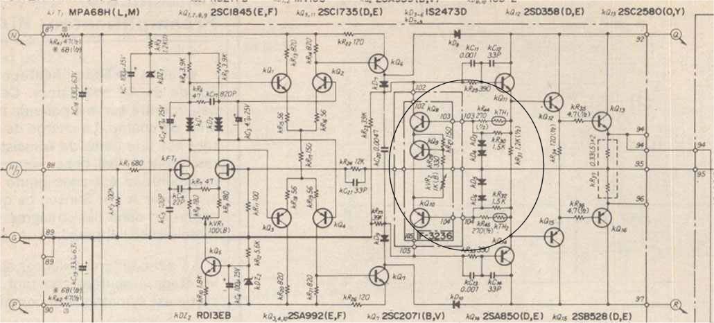

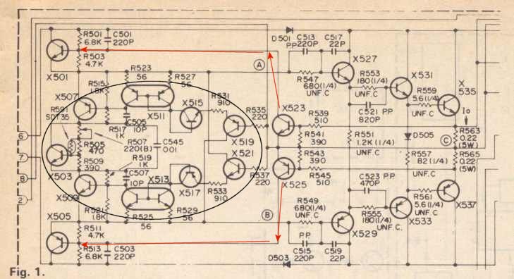

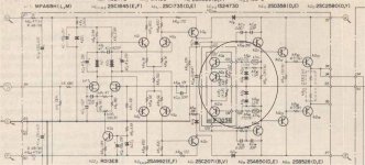

I have found the original JVC "super A" (before it became a chip - below 1).
It is dynamically controlling the bias spreader (X503-below 1) and has error
correction (red arrows to X501/505).

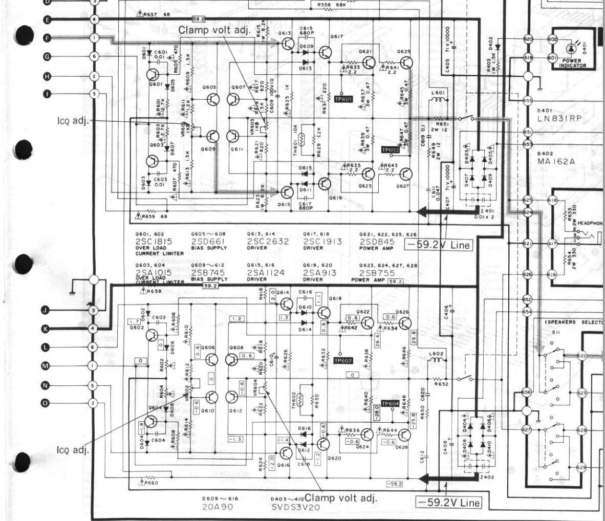

Another one is the pioneer (below 2). It uses symmetric super-pairs(circled) for feedback to the simple bias spreader (VR5/D7). It uses a standard EF3
plus current sources. It is more simple (with no final output error
correction) , but has a cool 😎 non- switching and traditional bias adjustment(vr7/vr5).

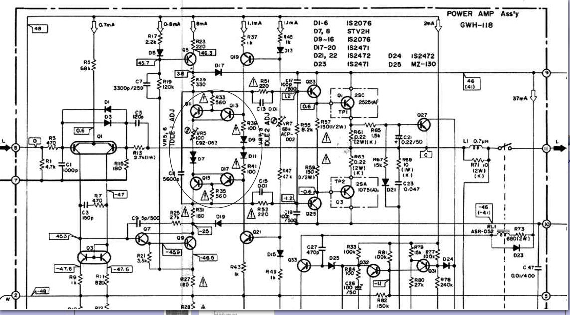

And - the sansui (below 3), is just a curiosity (too simple 🙄) - I do like it's IPS .... I might try it on the kypton V !!!

I'll start with the Pioneer - it seems to need the least local nested compensation and uses basically the standard slewmaster EF3 for OPS.

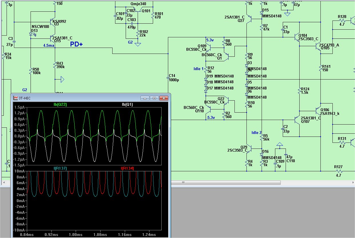

pioneer non -switching spice
The (below) circuit works as advertised. ! 🙄
"Idle 1" is the main Vbe bias , it stays at 80ma 20hz to 20k - any power level.
"Idle 2" will adjust the non-switching threshold between 2-20ma.
No oscillation ..... BUT the EF3's distortion doubled (in isolation).
THOSE DIRTY DIODES.
Plus - 2R loads (or a reactive load/speaker), allows switching to take place.
I suppose with cheap japan 8R OEM speakers... this might be minimized ??
This was the topic on the "super A thread" - diode distortion...http://www.diyaudio.com/forums/solid-state/162559-new-class-super-non-switching-need-revival.html

That Technics also has EC (error correction). More to it than just a diode reference (+buffer/clamp). The reactive load of the speaker is measured
at the output emitter resistor(s) and fed back to the clamp.
But they still use diodes as the clamp's reference.
I will try this one next. Thanks for the schema (I can read it)
I would predict the EC would offset the added
THD from the clamp. 😕
PS -(below-.03%) ... is the base THD20K of a slewmaster EF3 OPS
(20K/4R/75ma bias) @ 60V p-p .
Edit- my observation of the pioneer - this THD20 rises to .065% , but the 3rd
harmonic decreases. More total thd in return for less odd harmonics.
OS
