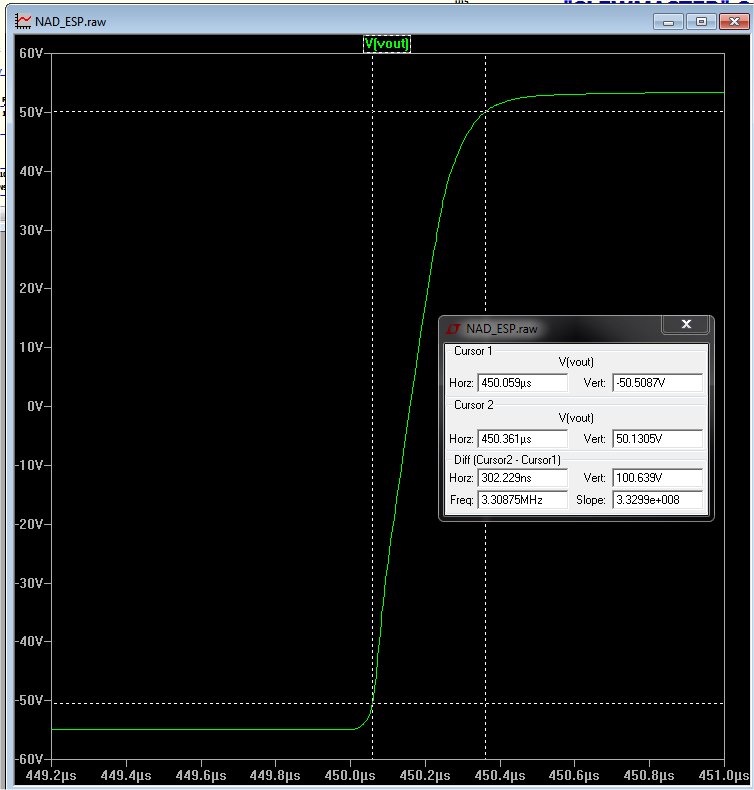

I always knew the diamond was not "bad" 😀.
Your results are close to my experiences.
In fact , I have to "trick" my VSSA design (no input cap , higher UG point)
to get 350V+ slew.
Out of the box , my NAD-BH gives 100V in .3uS (340V/uS).
Servo hooked ... running the EF3 (below).
I did get 700V , but this design is a compromise to get a cooler running,
better clipping IPS while retaining a CFA "heart" 🙂 .
PS - I'm testing new OPS's ... not all can relay (from IPS) these high slew rates to output. This has a lot to do with the end result (slew wise).
OS

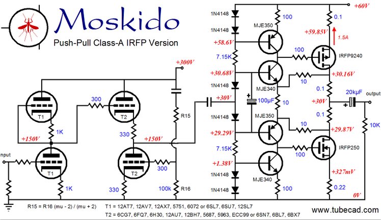

NEW -- OPS ... VFET/LFET Class A or AB !!
I almost have it figured.
I've already simulated "Moskido" Class A (Below 1).
A. Crude current feedback error correction.
B. is not "self settling/adjusting" , needs a Vbe for thermal comp.
C. It does error correct ... but not to the degree of (below attachment 2 +.asc).
Attachment 2 - - Voltage FB from the IRF's source. Voltage across the
output source resistors collapses the driver stage .... equilibrium
without a Vbe , this seems to work for bjt/vfet/and Lfet.
Non-linearities are also fed back.

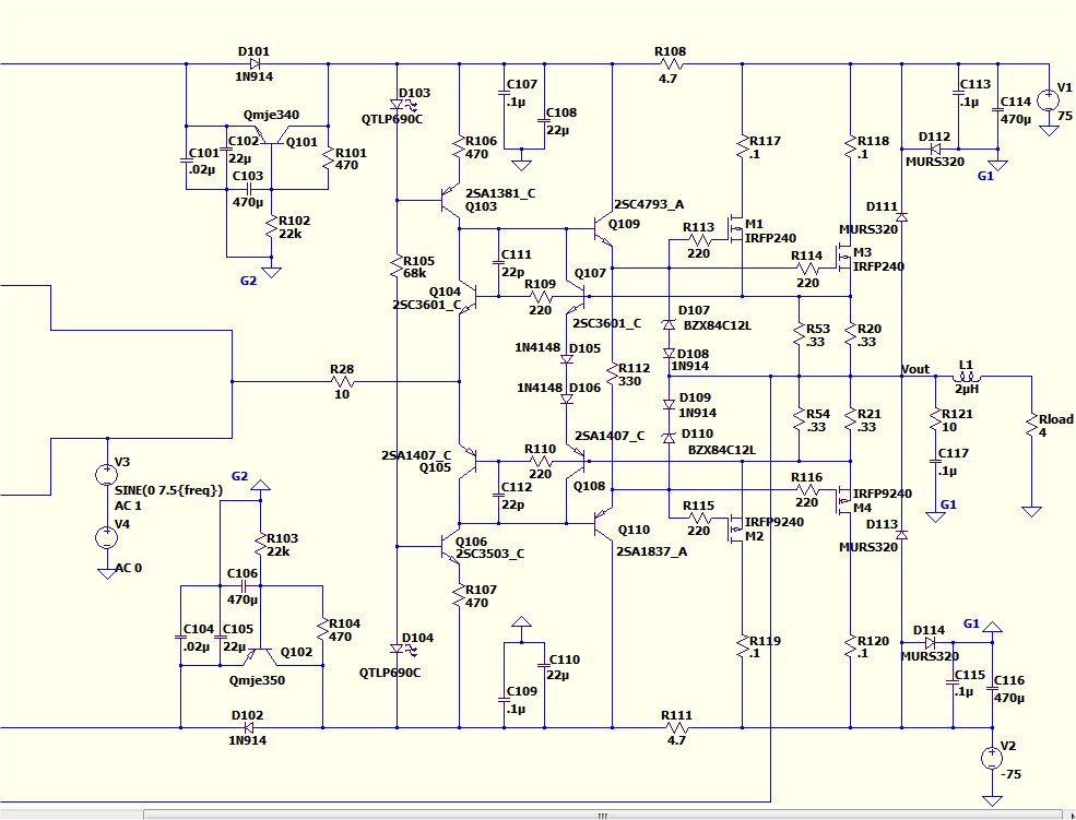

(below 3) is the "jewel" , made for MOSFETS ... built/tested.
All 3 are copyrighted ... I must add.
Therefore , I will take the best attributes of each to create
a universal "SLEWFET" OPS.
1. must be fast 2. must be either class A or AB switchable.
3. foolproof thermal stability.
PS .. EF3's are great , but some want FETS and/or A
(no X-over distortion). This might be a universal solution with great results.

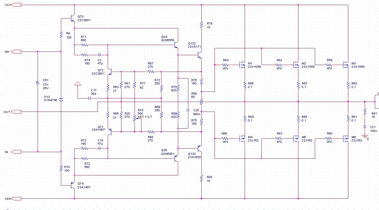

It would be great if we would have option to use Toshiba Audio mosfets like
2SK1530, 2SJ201.😀
Several guys who used IRFP and Toshiba in a identical circuit clamed the Toshiba has superior sound to the IRFP or even to the modern ON semi BJT.
I do believe it would be interest on the Toshiba circuit or PC board to
My humble opinion.🙂

Very cool!
OS, just one thought... If you don't use "CFP-kind-of" topology with IRFPs (as MOSKIDO does), then what are those 0.1R resistors at the drains are for?
Valery
The 0.1R an easy place to measure current?
You can easily measure at the source (double 0.33R), although dividing by 0.165 is more complicated than dividing by 0.1 😛
It's a current limiter, but what for? In "CFP-like" topology they are used to align the currents between the pairs (if sources would be looking at the rails), but at the drain there will be no alignment...

I'm not comparing with latfet, because 2SK1530, 2SJ201 are hexfet with low vgs. I'm comparing with irfp240/9240

Since the source(s) are all tied together and have a common resistor ,
how would you share current with multiple pairs ?
This will be a design consideration for a class switchable (A to AB) offering.
I'm trying for a V/LFET that will go from an AB biased state to a
"hard" 2A+ class A state with the flick of a switch.
If I make this a 3 pair contraption with the advanced HEC , I must
be able to monitor at least one pairs source R voltage drop as
feedback to set the class A current.
For an OPS , these are lofty goals (both Vfet/Lfet) and class switchable
operation - BUT ... i will produce.
OS
OS
