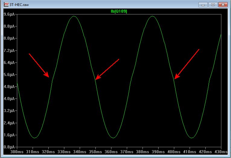

About HEC ...
Feed - forward is different the two "loops" are not as such....
The HEC devices (Q109/110) subtract the actual output waveform
from the gate drive info outputted by the drivers.
This results in a slightly distorted "correction" waveform (see below).
The "bulges" (red arrows) is HEC compensating for gate C and device
nonlinearity.
Eliminating the HEC circuit , this OPS does .5% , maximizing the
bulges (fine tuning)can get me .007% full power 20K.
The Vfet really sucks at the X-over point. 4.1123V is "off" .... 4.1130V is
full "on" . A standard EF2/3 is too "dumb" and lacks the control to
make this transition smoothly.
The HEC "pulls the rubber band tighter" at the driver stage. A real fast
driver pair (like the toshiba 2S/A pair) would work better here.
OS

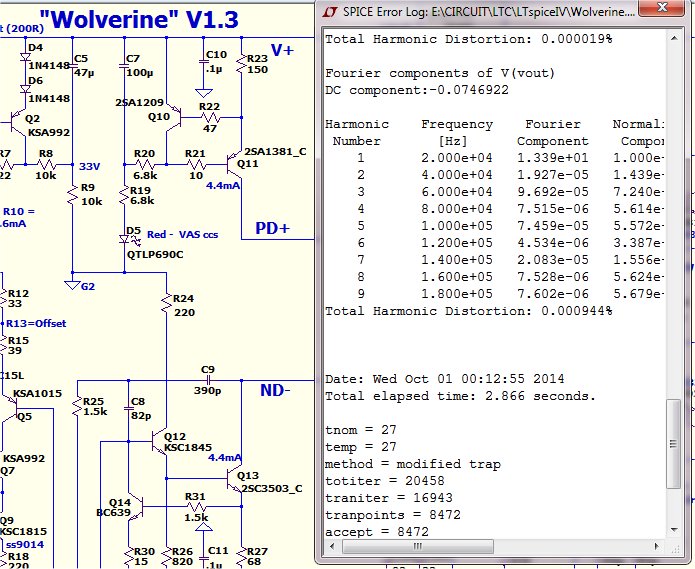

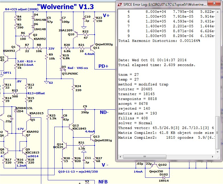

Below are the best voltage stage models ...
(Cordell's fairchild 1381/3503's)
And OUTPUT devices swapped into the circuit (#2).
WHAT ?? only 2 ppm difference @ 20K.
The amp was able to compensate for >Cob from 6pF to 500pF (the op's).
Is it the models , or the design ?
Which leads to this statement ...
This means "good" things are happening within the design. One's that
operate like this are usually tolerant of wide variations in the semi's ,
compensations , and electrical conditions.
BTW , Thimios/Bimo prototyped these ... 100+ slewmaster amps are
out in the "wild". Read deeper !
PS - generic LT and old spice models will give inferior results - Cordell/Andy C. models are precise.
OS
