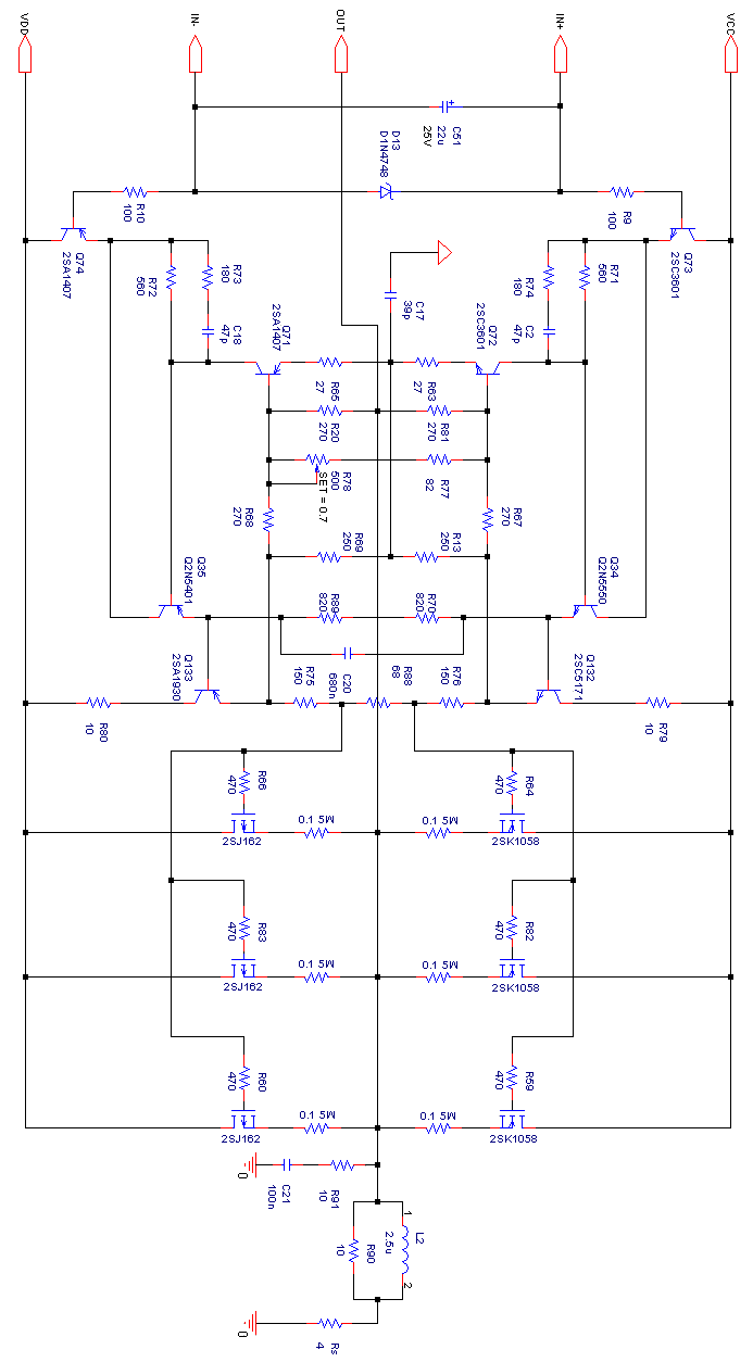

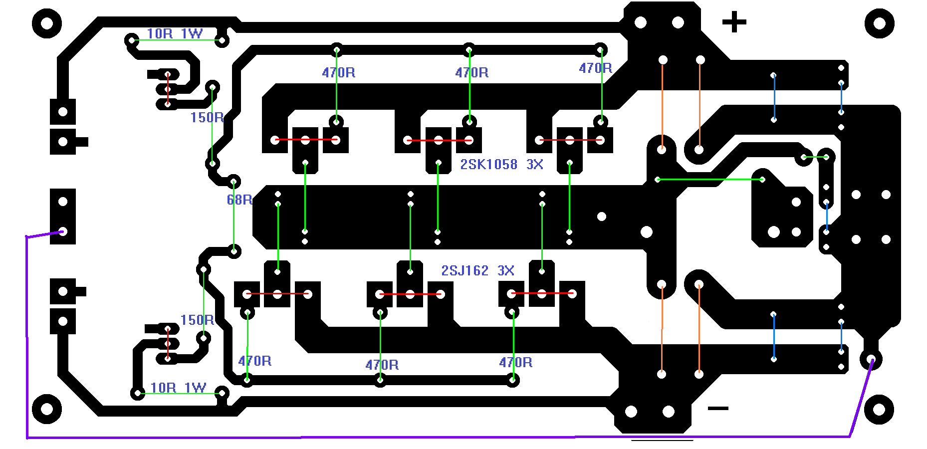

Hello
Guys do you think these mosfet circuit worth a try or better to stick with the still4given latfet version
I started to draw the layout but I do have some second taught so the best it would be to ask before I do any farther progress not to waste my time or the components (in case if it blow up)😀
Thank you very much 🙂

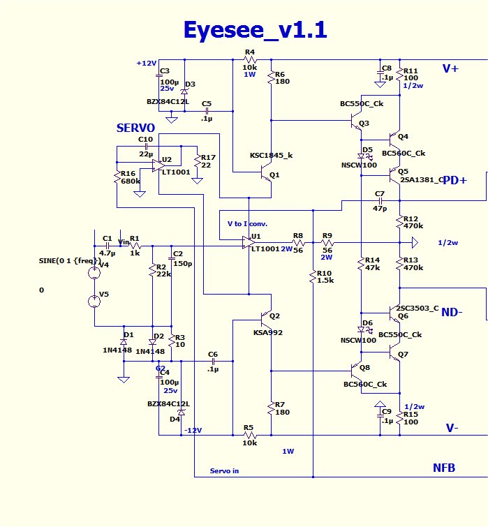

(below) is a new IPS that I let "rest" for a while.
Ohhhhh .... ICzzzz (eyesee).
Has a servo , but no servo in the loop 😀 .
Has a higher Z than a diamond buffer with fet inputs (in the chip).
Has CURRENT FB !!! Ohhhh. 😀
If you "wrap your head around it" , It is the chip version of the GONAD.
IC's output is the CFB node , Vcc/Vee sink the cascodes.
The chip used does not matter... (R6/7/17) change bias for offset/VAS Ic.

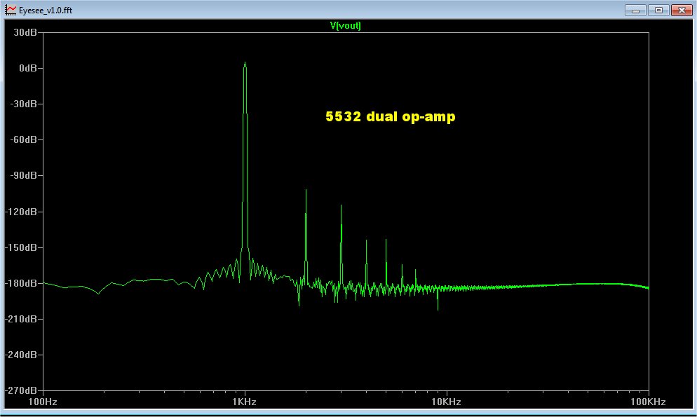

Tried 741/ 5532 / LTxxxx .
UG and THD20 performance varied with IC's. Slow IC's gave .05% thd20 ,
fast IC's gave 20ppm.
ALL were stable with good PM. ALL were 5 ppm 1k.
So , what you "hear" ... would be the internal structure (design) of the IC.
PS - FFT 's show distinct differences in distortion products between
devices. (below 2 -5532 dual)
