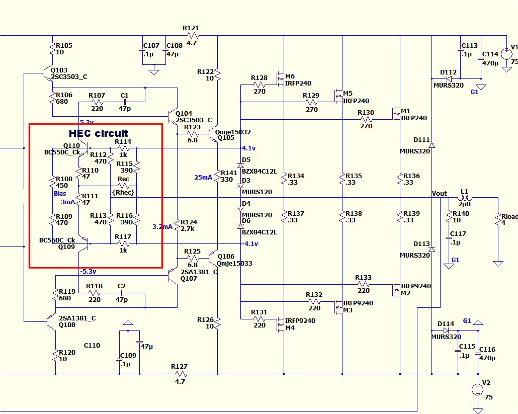

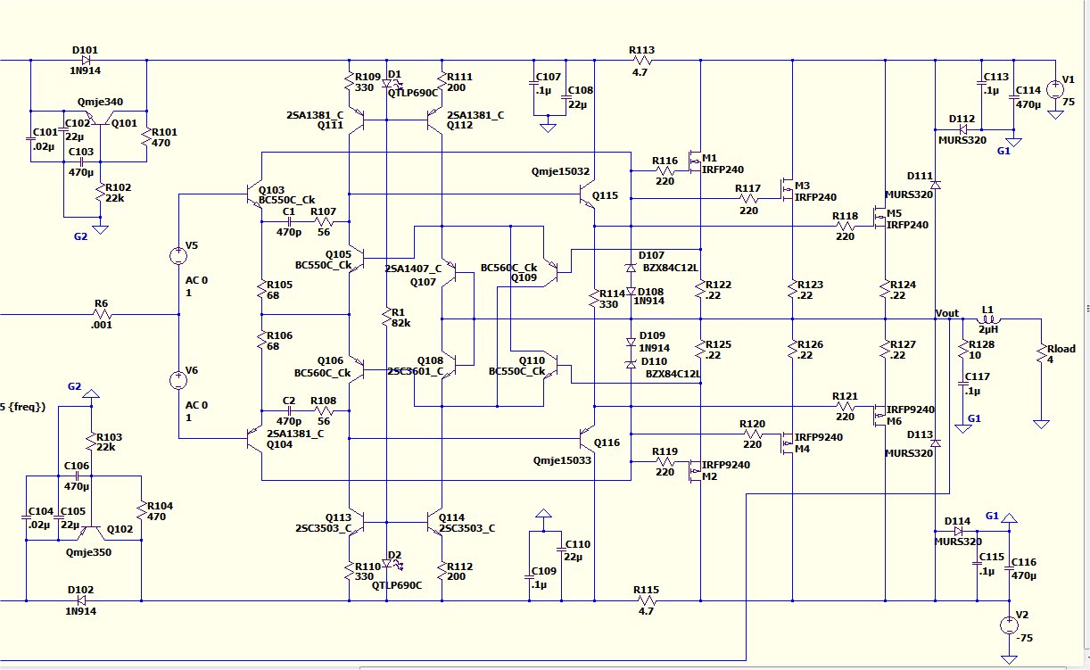

(Below 1) is a NON - switching Vfet/Lfet/BJT OPS.
It ....
A. Has the Hawksford error -correction (Q103 -106) , compensated
with (C1-2).
B. Has auto-bias and "Super A" (Below 2).
C. Bias is set both dynamically (Q107-110) ,
and by R111-112 .... the LED CCS's.
NO need for a Vbe circuit .... will work with VFET/LFET/BJT.
It essentially is class A -no device ever even comes close to shutoff.
THD is 10-20ppm high power 5-10ppm 1k/lower power.With NO NFB.

You're right, amps won't eat any square waves. Tortured with infinite fast transients any amp will be pushed beyond its limits.
In case of this amp I don't know yet what causes it to get 'berserk'. Saturation, lack of headroom of the bias circuit, missing Baker clamps? With vert. MOSFETs I got much higher slew rates. Maybe AB2 doesn't like BJT output devices anyhow. I have to figure that out.
Yes , the designer himself describes AB2 as "slewrate limited".
So , I'm not crazy ! OPS "choked" on my uber fast CFA's.
The standard EF3 OPS can take a .01uS risetime with ease.
Still , the IRF's (VFET's) and their 5V Vgs get along well with this
OPS.

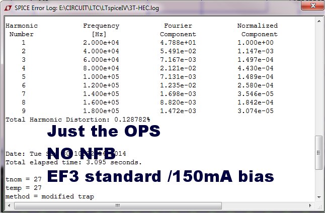

Does the slew/PPM even matter if the OPS is not accurately reproducing
these attributes ?
Ahhh , to simulate our typical OPS's (EF - 2/3) in isolation is quite sobering.
They really suck !! 😱
The "slewmaster" EF3 is the best of them , with .05 - .08% THD20.
A typical EF2 (a DX OPS 😛 ) is .2% or much worse !!
BUT .... why would we care about this? We could just swamp all this
badness out with lot's O' feedback. :headbash:
(below 1) is a typical EF3 with IRFP VFETS. .18% with increasing
amounts as you "crank it up". An EF2 Vfet is at best a SUB amp , I
would not want a <1% THD OPS running my tweeters. 🙁

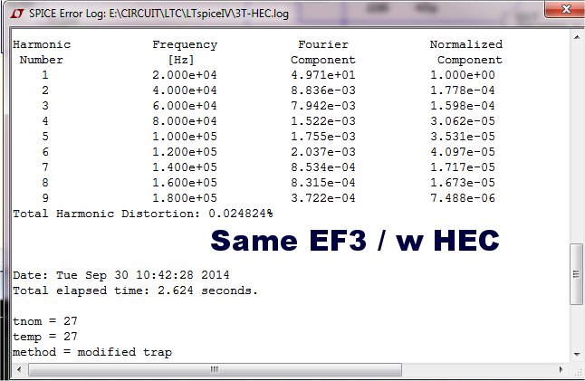

(Below 2) is the exact same OPS with the IRF's .... 🙂
NOW ... I see why Mr. Cordell did this , increased PSRR ,
actually decreasing THD with load and power.
I had the PGP amp (Lfet's) and Cordell's paper (Vfets) as inspiration.
I have tried all 3 "flavors" BJT/Vfet/Lfet - they all taste good !!
THD is reduced by >10:1 up to 20:1 with BJT's (they work best).
BJT's are the most linear (suitable for audio) of the 3.
Vfet's are NOT good audio devices (switches w/ high Vgs on).

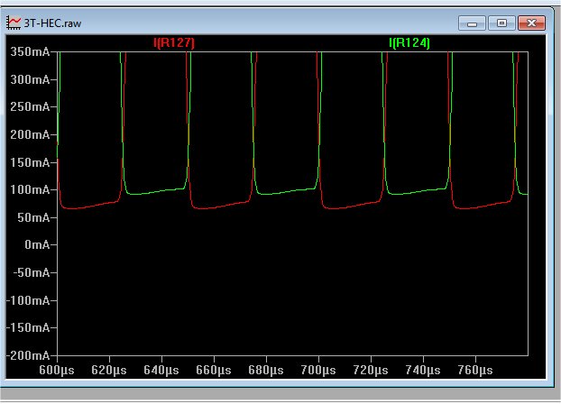

(below 3) is the output ...
As advertised , the ratio of the sum of (R112/113) versus (R115/116)
forms the "perfect" cancellation signal to feed the HEC semi's (Q109/110).
"Rhec" is a 100R trimmer , which can fine tune this balance.
Just 20% off- balance can make .01% into .05% ... better than a typical
OPS , but (properly "tuned") is preferred.
-Advantages
1.- Far less OPS THD .... which translates into a spooky IPS that will
be @ 5 PPM 1-20k full power ! 😀 THD even drops from 10W to 100W.
PS-available negative feedback has an easier job with this OPS.
2.-Lower PSRR , parasitic rail feedback is cancelled.
3.- LOUSY non-linear VFETS behave more like BJT's .. (instead of switches).
PS - lower TIM/PIM .... 😎
