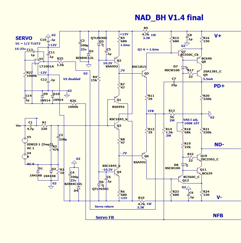

Hi OS,
I see in some of your IPS you use KSA1015/KSC1815. Are these comparable to the BC550/560? Do you have a preference?
Thanks, Terry
Thanks, Terry
1015/1815 , BC550/560 - same deal ...
1845/992 , BC639/640 - same deal , except the 639/640 is 80V ...
dadod says they suck ???
Only Q5 and 6 (CFB) + Q9 and 10 (VAS cascode) need to be high
Vceo.
Looks like most BCxxx sources are style 17 , which is EBC.
I'll make this IPS EBC , except for the 2 high voltage semi's.
PS - some say BCxxx sounds better ? truth or B$ ?😀

The 1015/1815 are still high-voltage Japanese transistors. One of them shows signs of having good Vcesat behavior but that's only speculation based on the datasheet charts, which may not tell the whole story. Personally, I would only use BC5xx/BC3x7 for current mirrors and Baxandall pairs because I have tested both of them to have excellent low-Vce behavior.
The 992/1845 are as bad as any high-voltage japanese transistor in low-Vce positions. For 4Vce or higher any transistor should work fine though, it's when you go under this you start to have problems.
As for the "sound" of these transistors... If the BC5xx has it's own sound then you should pay attention to the distinction between Fairchild, OnSemi (Motorola) and NXP (Phillips). The OnSemi/Motorola parts are faster. The same goes for the BC3x7.
The BC639/640 are versions of the BD13x/14X series, which varies from slow to very fast depending on whether the source is ST, ONSemi, NXP, and on and on... The KSC1845/A992 are much faster small-signal transistors, so I wouldn't ordinarily consider both for the same duty.

It's a one way street now.
I'm laying it out for mostly BCxxx. For the current sources .... BCxxx
should not present any problem ?? Only 12V for this part of the amp.
Servo path(s) will be very short - different than my first versions.
PS - Builders will have the choice of any EBC offering...
OS

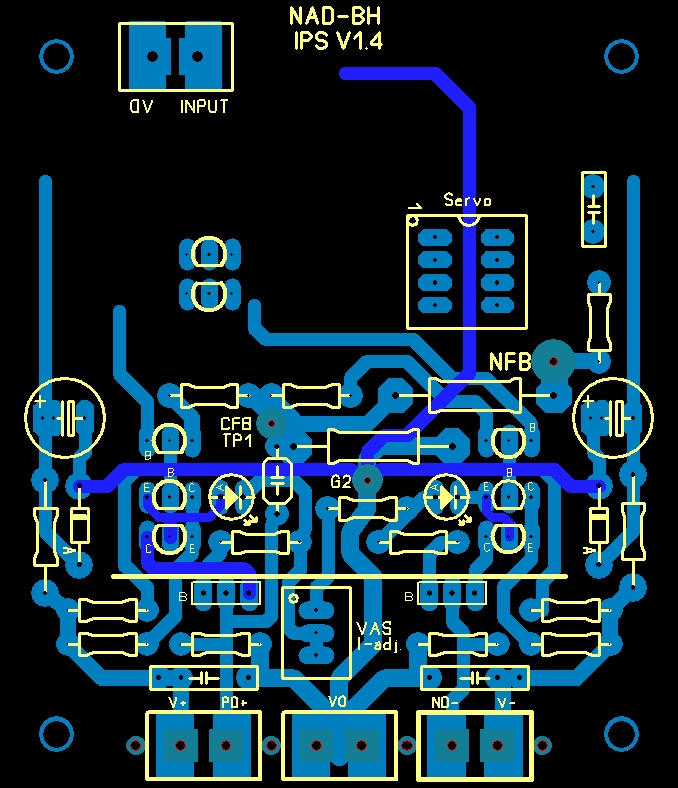

The layout says v1.4 but there's only a v1.3 posted. What is different?
I looked back and Thimios already tested a 1.3 (of the old nad/gonad). 😱
I suppose you could just call it "BH" ... it is the only IPS with
(Baxandall/Hawksford) .
PS - except for vzaichenko's 😀 .
OS

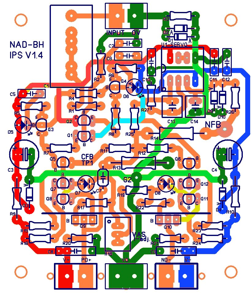

And here is V1.4 - last one.
To keep it the same design , this is
best. Of course , we have a "NEW" VAS (baxandall/hawksford).
(below 1/2) is the draft. Many grounds to go around 😀 ..green traces.

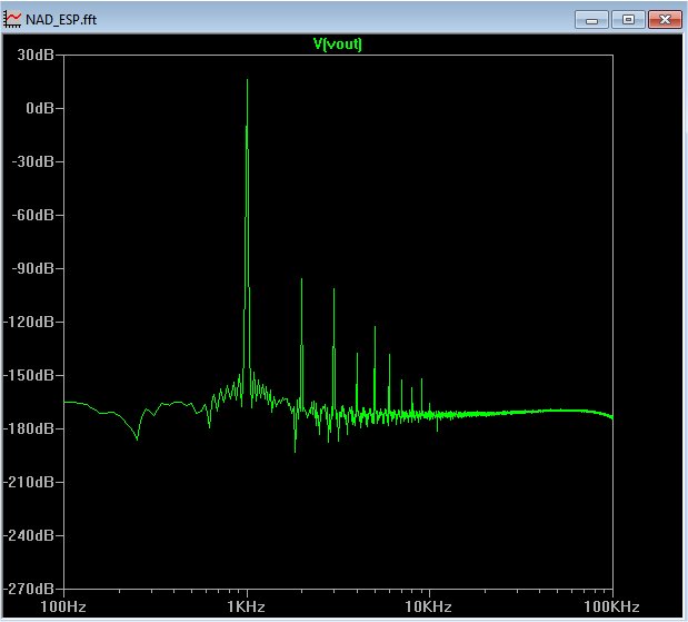

This is the more typical CFA design out there in OEM land.
It does tend to get to the 20-30ppm level with output , but
so does the CFA-X.
At listening levels , 5-10ppm should not offend.
Spectra is supurb .. (below 3).
Any errors - please tell.
OS
