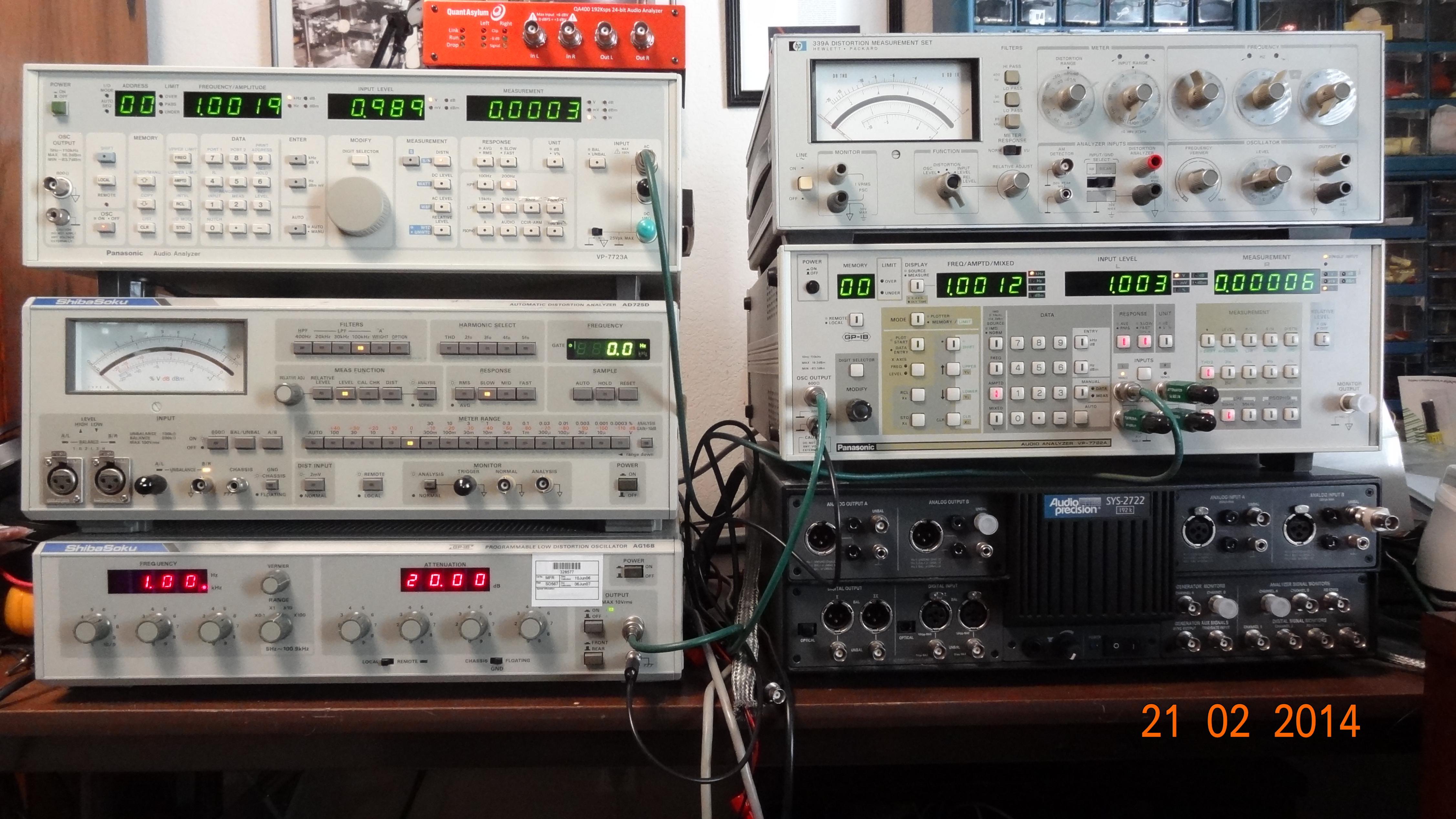

Which tests do you want made? 🙂
[click on picture to see it larger]
THx-RNMarsh
If I can get some PCB's made , you will get some 😀 .
Me, NAF , Bimo ... just have DMM's/oscilloscopes
PS - step 1 is done , they work and are stable. Step 2 - housekeeping and documentation (and a few more builds).
OS
Thanks Ostripper. I can wait for the details to be ironed out and the finished boards with the chosen input section. Another question is could these boards be used commercially without any patent problems if that could be arranged later on?
THx-RNMarsh
WOW😱 The only things you need to add to these are a Time Domain Reflectometer, a 5 Gigahertz 4 channel scope and a CAT-6 continuity tester. WOW😱
Do you consult for NASA or NSA?

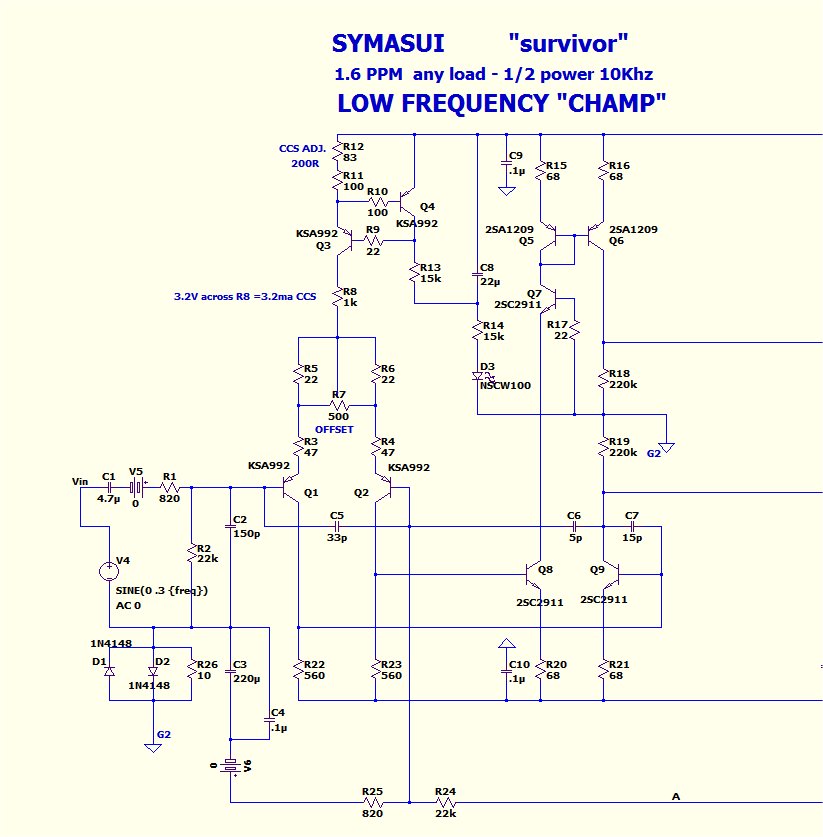

Final deal - (this weekend)
3-4 IPS's
1. NAF's "NADv1.2" with servo -
He says "wonderful" sound , 1mv offset, runs the OPS bias within a mV.\
I say "good to go" - tiny tweak to layout.
2."HB/wolverine" we KNOW this works - read the Badger thread. "war dog amp"
"good to go" 😀
3." VSSA variant" (I'm doing this now - multitasking) Very similar to the
NADv1.2 - 99.9% chance it will work just as well .... it is a far less
involved circuit - super simple .... sure bet !!
4. I might get to the "symasym" , it also - is one that I have already
built. Another sure bet. (this one is a great subwoofer IPS !!)
This can not beat the CFA's or HB/wolverine THD20 , but has the ONLY
10ppm 20HZ !
(below)
4 IPS's for many applications , all have different "personalities".
PS - NO infringements - my circuits are "bastardized" enough as not
to be like the others. Most designs are hybrids of several designs - ALL
fair game , no "prior art" 😀 I will integrate any good idea 🙂 .
OS

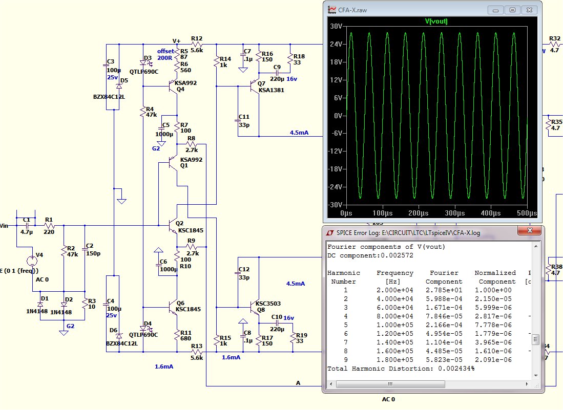

Am I correct to think that some of these are vfa and some are cfa implementations?
2 and 2 - just like the thread states "rumble"...
HB/wolverine and symasym are VFA.
NAD and "CFA-X" (below)are CFA.
CFA-X is dirt cheap ... amazing - 25ppm/90db PSRR /2mv offset - great CFA
"starter amp" 😀 .
ALL are 4-5ma VAS's , can be directly swapped out
to the OPS , might not even have to adjust the OP bias.
OS
