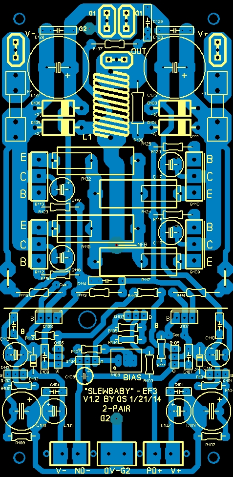

Pic one, track from out to output transistors emitters resistors not connected
Thanks 😱 , that's a big one - no sound ?? 😀

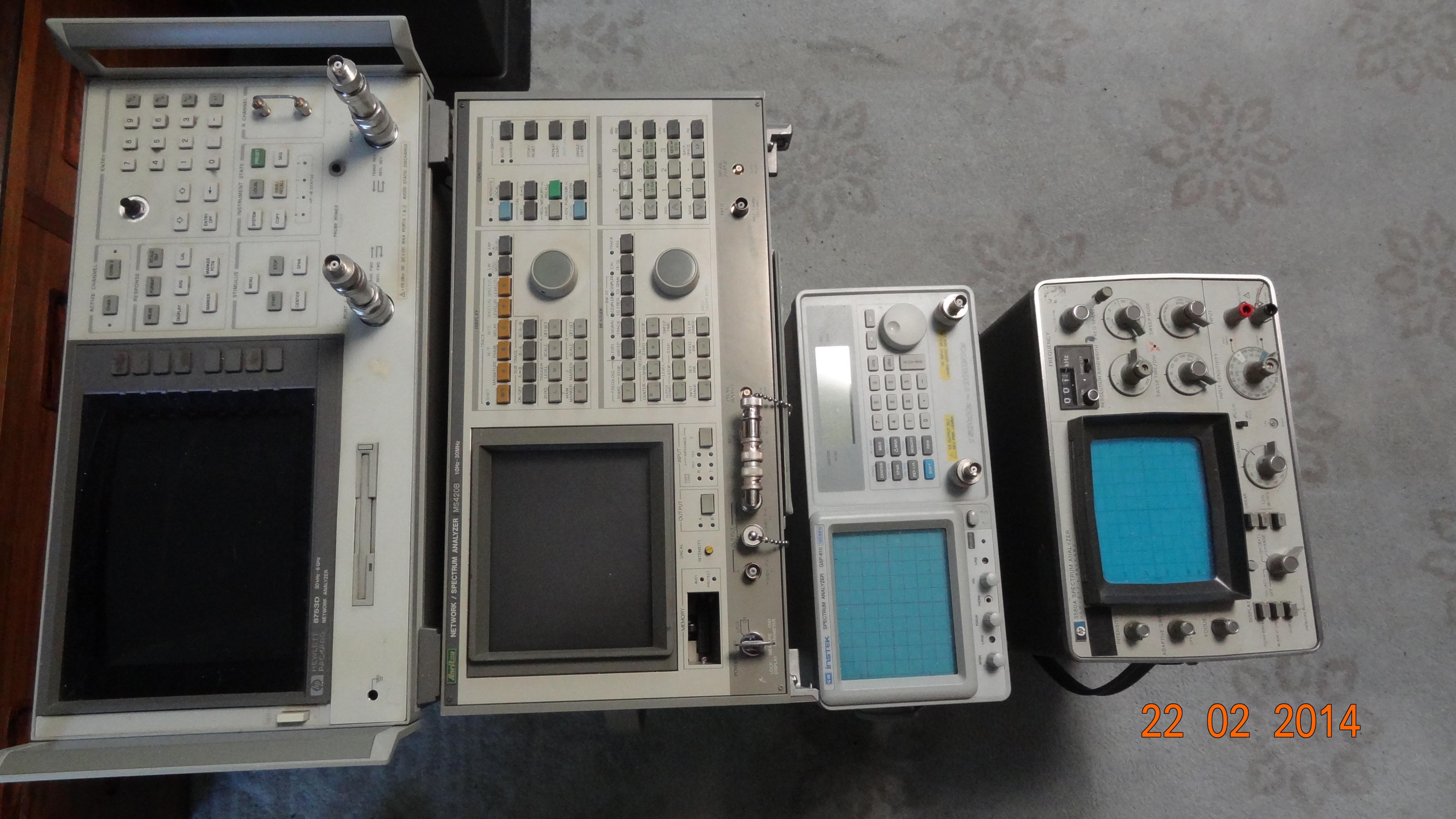

So include the complementary spectrum analyzer too Please.
It always helps to have the RIGHT equipment to do the job RIGHT😀
Ok. Done. Got four of those spectrum analyzers [ got you covered from 10Hz to 6Ghz]
Anything else I will need to test your amp designs with?

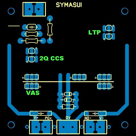

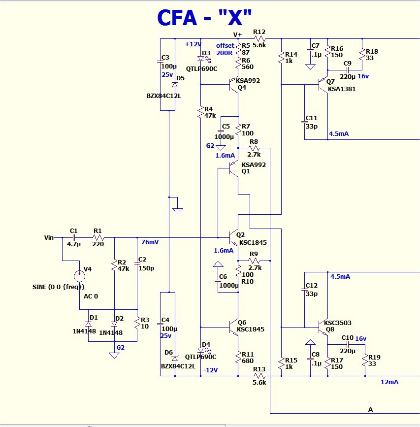

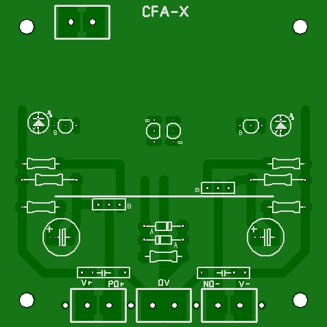

"Real time" LIVE !! design to layout . Time to "rock and roll " 😀
(Below 1-2) are the "victims" 😀 , one CFA (vssa) and the VFA (symasui).
(Below 3) is the "blank" for the VSSA. 76.2mm square .. with the interface
and primary decoupling/lifted ground.
VAS is the standard to-126 2sa/sc simple two device setup. Both are thermally coupled to a 25 X 60mm sheet AL HS.
The other "players" for this CFA are the 2 red LED CCS's which are arranged
symmetrically near the rails on either side of the central CFA pair.
I will show the placement and the "why" ? for that placement when I
get to the Zener/decoupling capacitor stage.
The CF network will be left ample room in a low Z area of the IPS boardspace.
Input filter/main input cap will be "distanced" from any high level signal/PS.
I'll do CFA-X first and "symasui" next. With a couple glasses of Argentine
merlot ... yumm .
It's Saturday ...
(The Doors on a Badger- amp that is
PS - nice to have a "system" .... Amp of the week , anyone ??

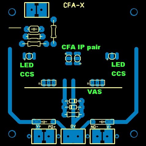

VAS is done.
Flipped the positive to-126 to the opposite side of the VAS HS to
have emitters facing the rails.
(why ?) no jumpers, straight traces to PD+/ND-... total symmetric layout.
Bases to VAS are open to be connected to collectors of the CF pair. 😎
PS - this IPS should be SMD'ed .... 35mm square IPS -
plug it in like a memory card. 😀
Oh , how simple (for a near PPM amp).

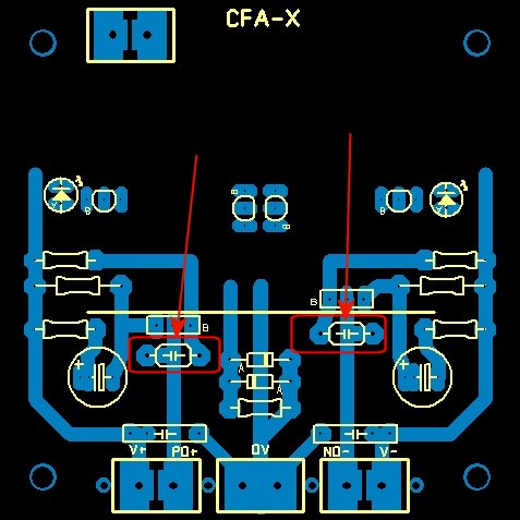

Keep it close ...
The two silver mica's (33pF - circled below) are all that keeps the
"magic smoke in".
They like to "loiter" VERY close to the active devices (VAS semi's).
Especially , if you want 300V/us slew with 22pF comp. A long trace
here can disrupt this perfection. Same with OP basestoppers -
as close to the active device as possible.
PS- on OEM's ... Cdom is "side by side" (right next to) the associated
active device.
This IPS can do 400V/us + with 22p/lower R in the FB network ,running
the OPS hotter (reduced re) .
I want to lay it out to allow slewaddicts to "get off" 😀 ...

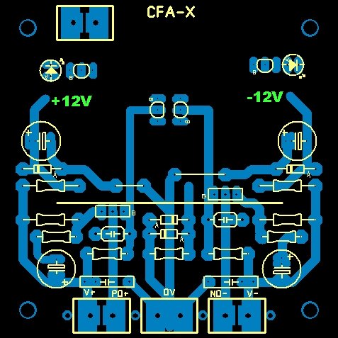

last installment ...
I reached my 12v Zener regulated portion of the circuit. As I go
along , empty space is filled by what I have already routed (below).
Now , most of the VAS/comp is below the VAS heatsink. Above is ALL input pair/
CCS/filter ( All 12v powered ) ...
A complete separation of high amplitude from low.
Where the CF (current feedback) enters the IPS , I will just allow "real estate" (space) to insulate
sensitive areas (IP pair) from the onslaught of the full OPS FB signal.

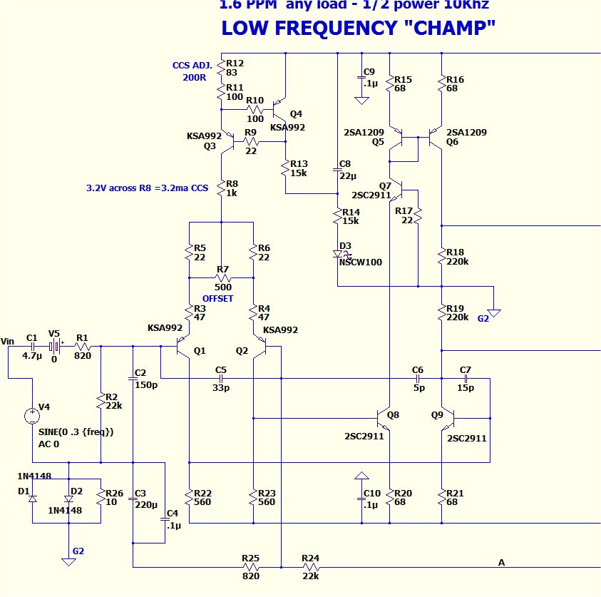

IPS like VSSA may be best for being simple. But when I drive it with +-63V and 2 Ohm (3EF can drive 2 Ohm with relative low distortion 😎), the input transistor can have 420mW peak 😱.
With cascode input transistor, it can share dissipation also make distortion reduce a bit, but voltage noise increase.
I need more sim to find "elegant" solution to keep input transistor cool.
Or , find a more robust input pair.
2sb647 / 2sd667 are to-92L ... the "big boys"... 1A/1W+ 120V Vce/20pf Cob
These could handle any CFA HD feedback with ease.
Don't let small devices hold back the "SLEW"
