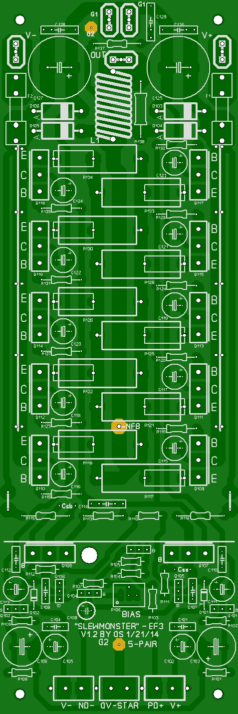

And the "MONSTER" ....
This one is no B$ ...
NOT for the faint at heart ...
85V rails - 12A fuses , and 16/14ga copper wire busses.
More room for the driver heatsink and power resistors.
250/500W with MJL21193/4 or Semilab MGxxxx (300/600W).
Very similar to the H/K990 , which is rated 200/400W (conservatively).
Fits on "heatsink USA" 250mm extrusion .... 100$USD for
1/2 a 2500$ amp .....
If I was rich - this would be mine. 😀

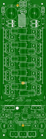

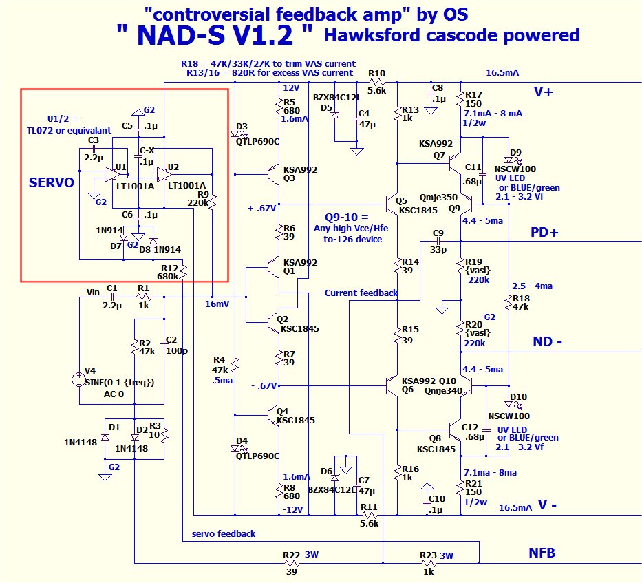

just a moment i see two tranz. Q103 NAMED VAS Vbe and Q104 NAMED OUT Vbe .Are these, Q103 IN THERMAL contact with Vas and Q104 mounted on the down side in thermal contact with outputs(on main heatsink)?
Best regards.
Yes the Q103 is the driver Vbe , it alters the thermal scaling of the main Vbe
(Q104). Q104 goes under the PCB (screwed down) it is about 30-35mm away from the
first OP. Same as the 680/990 HK.

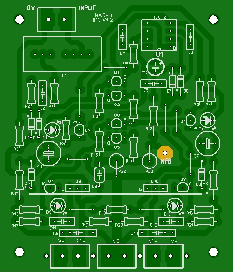

OK - a perfected NAF/NAD !!
He did V1.0 , here is V1.2.
Very verbose schema with VAS current "guide". Servo highlighted.
More room for servo , decoupling closer to IC ... better grounding.
Work of "art". 😀
PS - NAF even used (wrong) 68R cascode Re , amp DID NOT smoke - my mistake.
All this is corrected. Amp was developed in the "CFA discussion" thread.
Thumbs up from Cordell himself ... 🙂
EDIT - I made a couple tweaks to this design ... now at 6-8ppm THD20 1/2 power 4R !!
Red led's naf used were 1.8+ vf , this increased CCS I , 820R for R13/16 will negate this oversight.
OS
