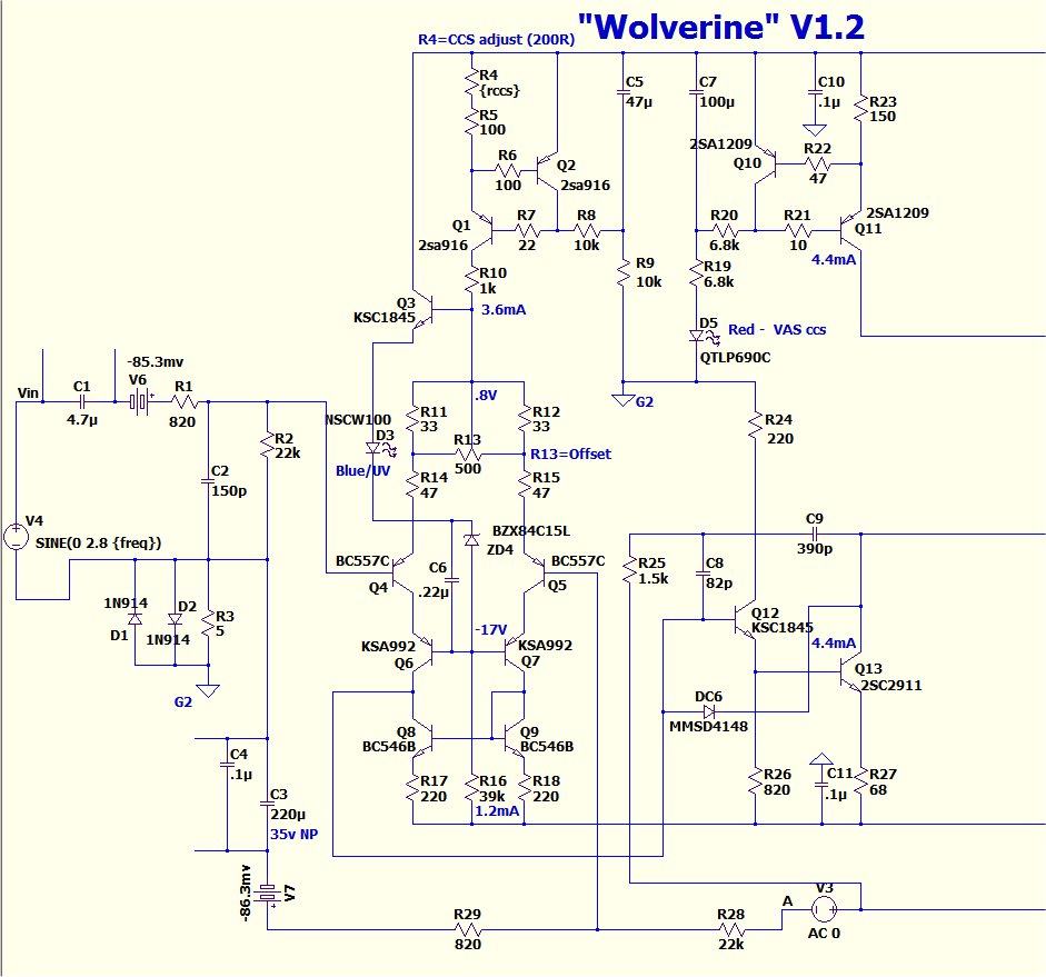

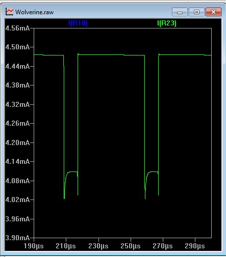

yep, this one appears to overshoot on positive rail, sticky on negative with sines from 2.35V up and square "pulse" a bit strange @1K going down to -4V with PULSE(-1 1 0 {t_edge} {t_edge} {1/2/f-t_edge} {1/f}) ?
yup , weny back to the diode clip clamp. Check the 2sc3503 model , even
with the transistor clamp , all the other models work except these.
Maybe other KSAxxxx should be tried.

Can you show IPS schematic of TSSA V1.6? May be we can modify it using this 3EF OPS.
Back to the diode ...
Yes ! The diode is both simpler and makes for a better clamp.
I think the transistor clamp is dependent on how fast it is ... or
how fast it can clamp as compared to how fast the main VAS can
saturate.
Basically , a Cob vs. Cob / Ft vs. Ft "war" between the clamp/VAS.
A fast diode is many magnitudes speedier than the compensated VAS.

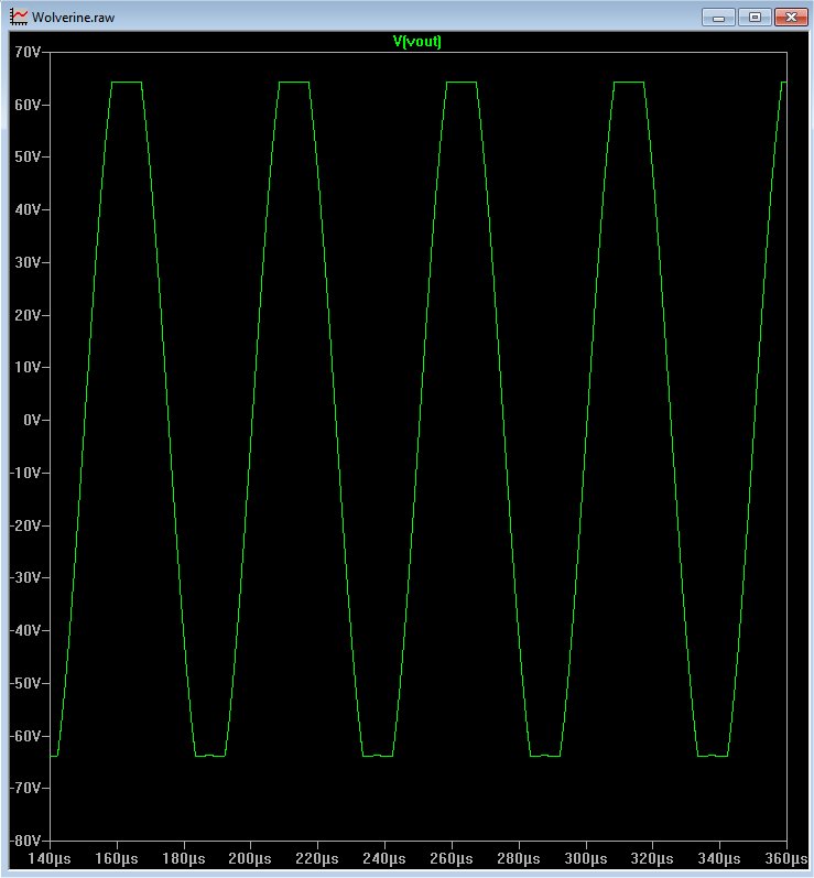

Much nicer clipping behavior with the simple solution (below 2).
The downside is now I have 6ppm 😱 😱 THD .... boo hoo !
Slight reverse diode leakage "steals my ppm's" ... 😀
Main CCS saturation (3'rd attachment) is way better with 2 references.
Updated Wolverine - tested SW and gross overload (2.8V input) - GOOD !
As compared to the "badger" ... 1/2 the THD20 ( dadods cascode !! 🙂 ) ,
slew is over 100v/us (70 - badger) UG is higher 1.1mhz.
At 120v p-p - just 15ppm 20K - one "bad amp" hooked to the "monster" 5p EF3.
PS - tried 2-3 different models at each stage , perf. remains the same ... performance
is not model dependent ... but design dependent.
OS

The technical differences between this and the Badger seem 'academic' - is there any difference in the sound ?
It is badger like.
The differences are -
1. LTP CCS and VAS CCS are not "bridged" from the same V reference.
This is a "clipping" thing. When the VAS saturates it takes the big
CCS "with it". This draws more current from the reference. On the badger
this also affects the LTP CCS.
On the "wolverine" , I increased current available to the main CCS +
its totally separate. MUCH better overload behavior.
2.Dadod's Cascode - halves THD20 , has no ground reference ...
totally in the signal path. This is also a "magic thing" - the sound
is much better ( as described by a "GURU" - 2 of them 😀 ).
ps- this might be a BIG one.
3-More aggressive TMC , EF3 compatable , cap multipliers or boosted rail.
4. Way better layout - floating NFB.
This should have no match .. blameless wise. Seen ASTX's EF2 blameless with
modular dongle do 9 ppm despite it all . No dongles here !
OS

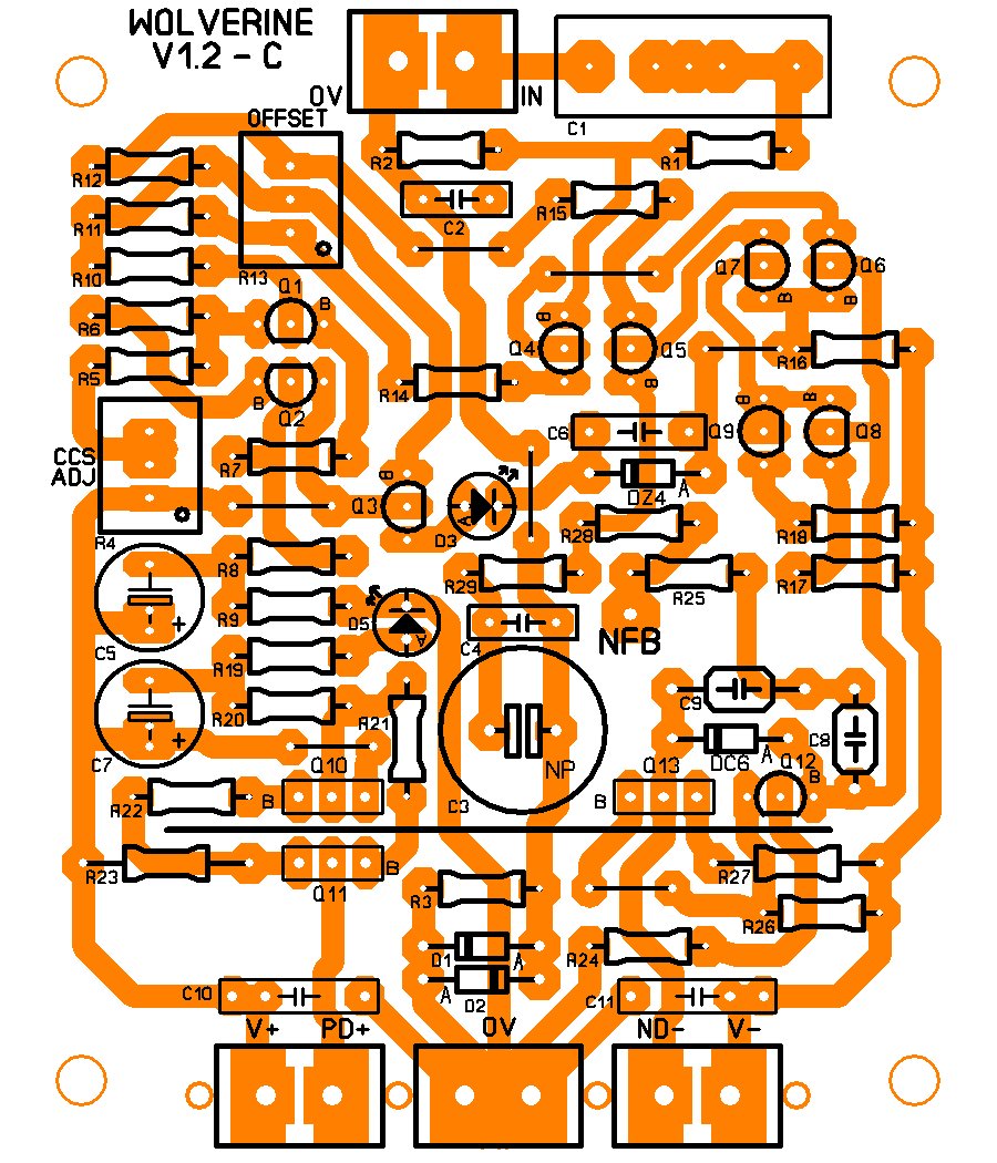

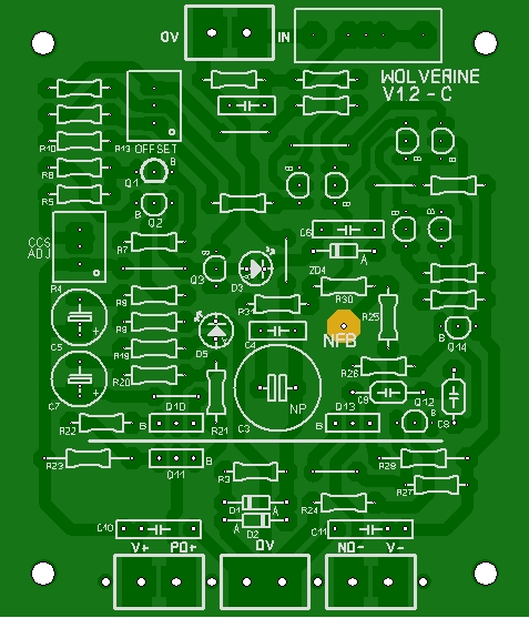

Please check out ..
This one was harder than the CFA NAD.
I DON'T use a computer to layout (from my head).
Schema/PCB are final (hopefully) ... look them
over ....
OS
