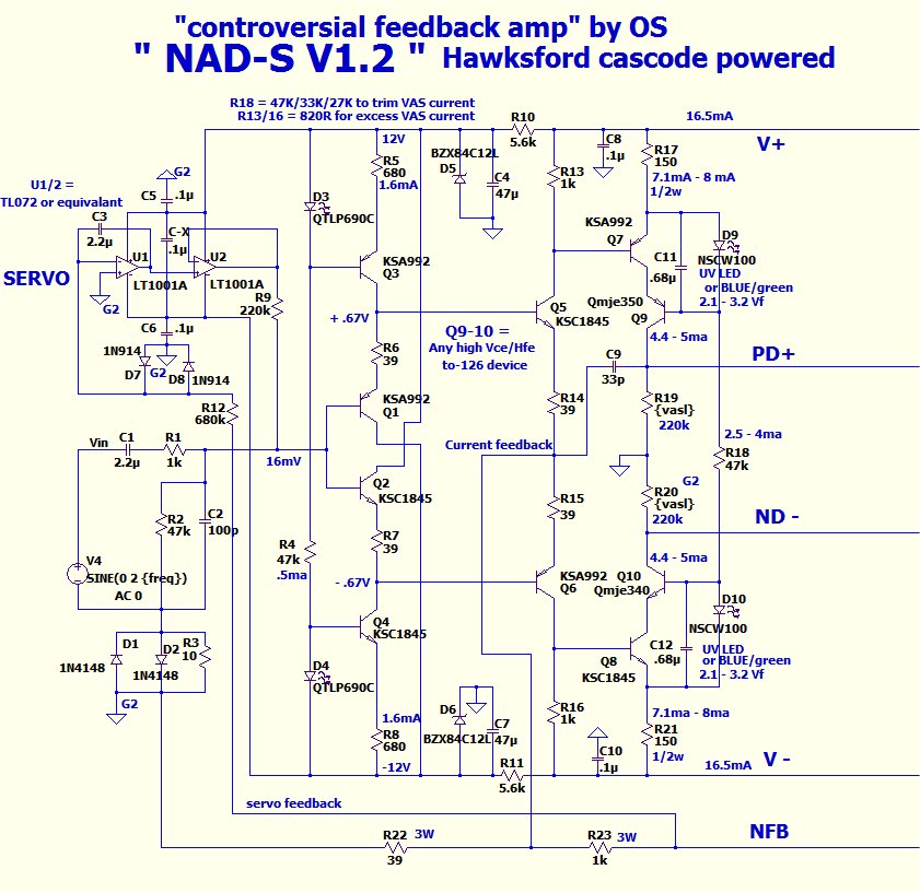

NAF's NAD w/servo is 1mV offset with 6-8ppm thd20 ... 90db PSRR.

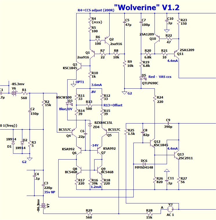

This one ,the wolverine (current work) ... is 2-3ppm without clamping ,5-6ppm with protection).
- - 120db PSRR !!

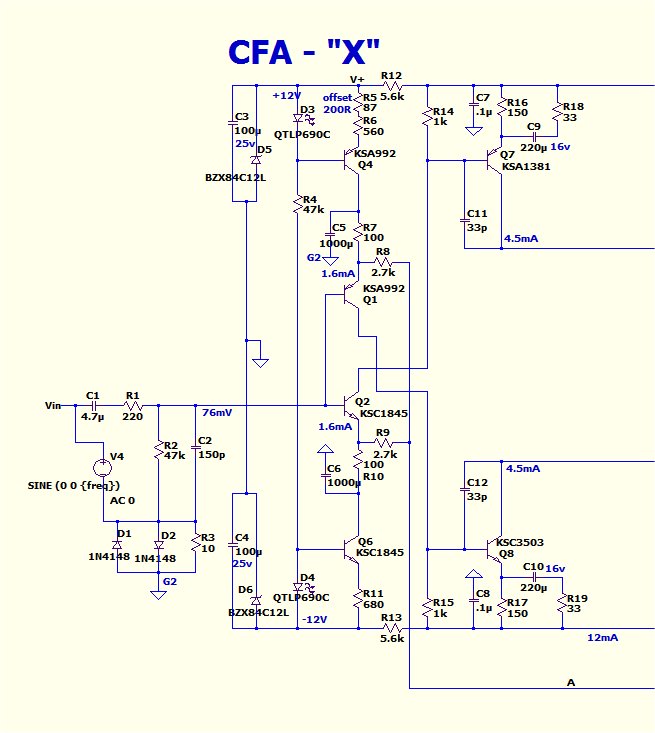

I also have a simpler CFA (VSSA variant) and the symasym VFA up next
they are 20-40ppm "contenders" for those who like it simple.

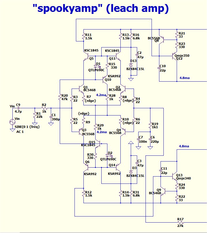

Below - are the 5 IPS's
1- NADservo (CFA) - all done, NAF loves it ...
2- Wolverine (VFA) - better blameless - done real soon (tomorrow).
3- CFA-X , real simple intro to the "CFA world" (next layout)

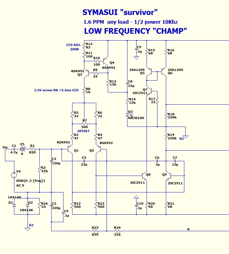

4- Symasui (VFA) - like the symasym , but with sansui z3900 comp./ltp.

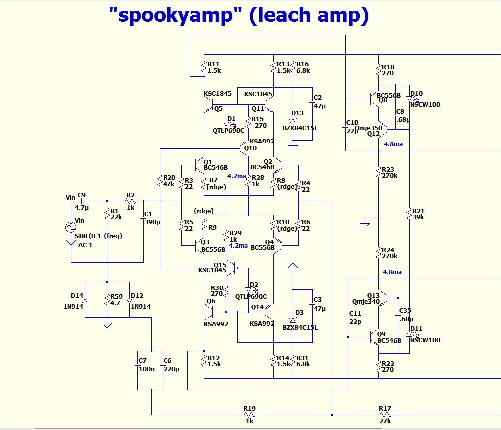

5 - a 21'st century leach amp (spookyamp -symmetrical VFA)
PS - 3 and 4 are almost done , as well.

regarding symmetrical front-ends, have you ever explored for differences between the leach and the psuedo-folded cascode (ala borbely/curl) ips?

Leach topology does not "get along" with CM's too well. Many have
tried/discussed this drawback.
To get more loop gain , beta enhance the VAS.

OS:

I never played around with JC's designs . I'd be 'a sliding in the snakeoil. I
like japanese designs !!

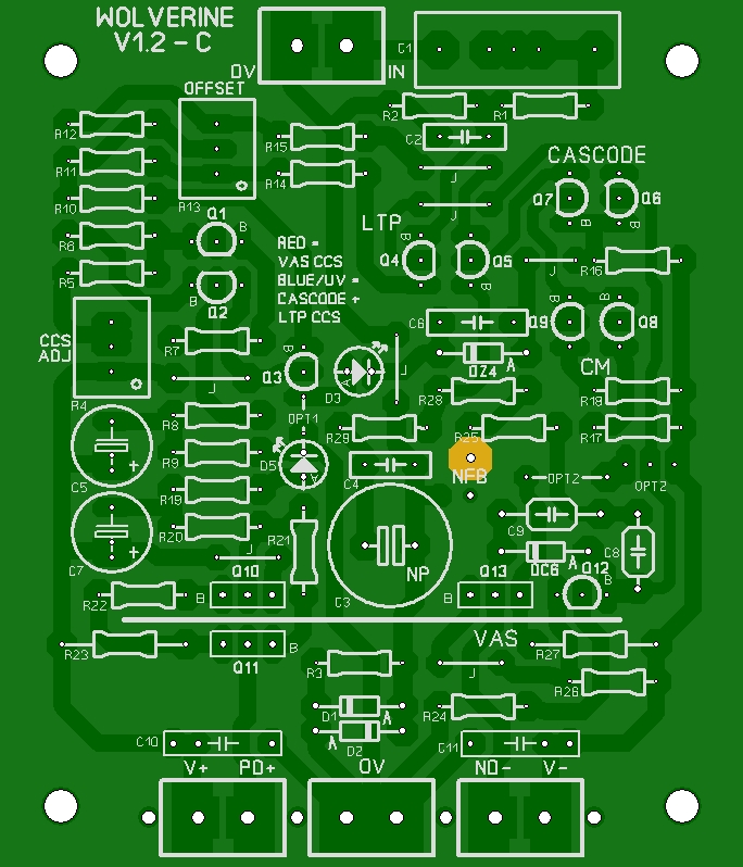

Drippin' with parts ... Wolverine V1.2
Here it is.
Self would like it ... 😀
2-4ppm THD 20 , transistor or diode clamp , buffered cascode ...
All the embellishments ...
ksa1015/sc1815-ss9014 for IP low voltage devices ,
ksa992/sc1845 for cascode/ccs/vas beta , and
mje340/350 or any other high Vceo device for main VAS-CCS.
