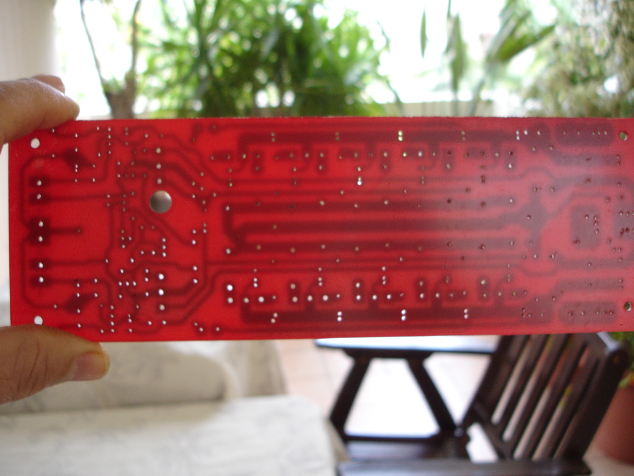

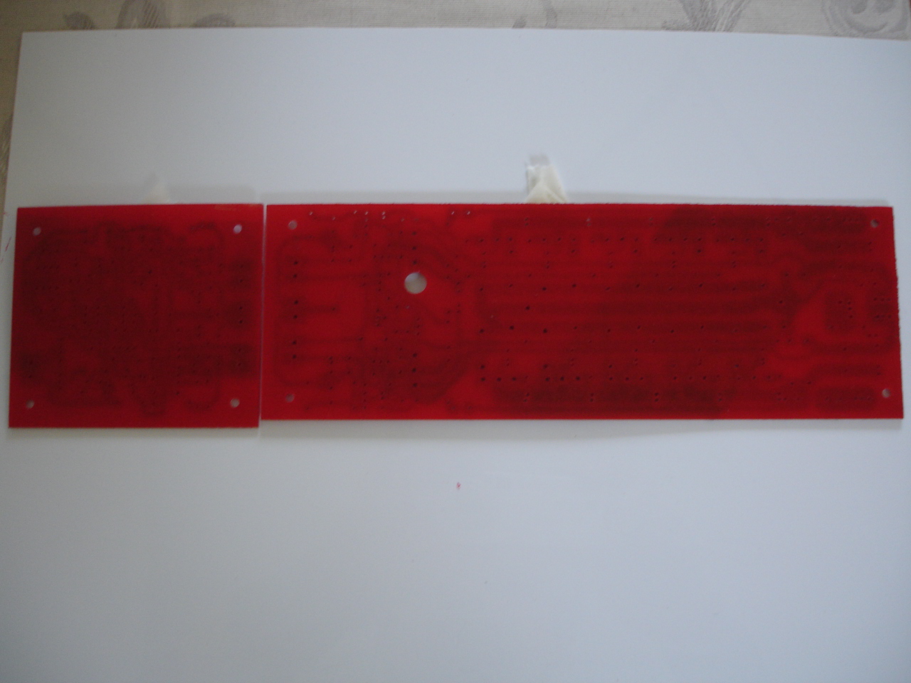

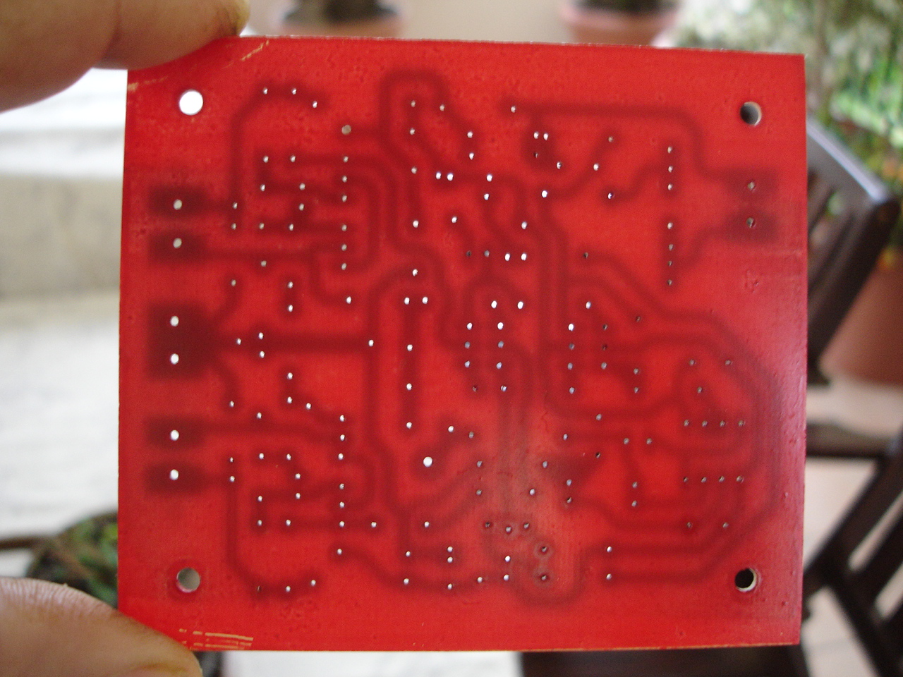

Hademade pcb as usual.
I want to start but i haven't many parts especially small signal transistors....
Ostripper what's your opinion for the possibility of use bc... series just for first try?

Nice red pCB's !
BC can be used for the current mirrors (see just 12V vce ).
BCxxx you would have to reverse the device ,(and swap C/B around)
as BCxxx is a CBE pinout.
Most to-92's are ECB , the reason for my layout choice.
Input can also be BCxxx , provided the amp is powered by 50V rails.
You made the 5 pair version , so I assume you mant mega power !
BCxxx could 🙄 work (<50v rails) , but your application
(desire) seem to be for high power/high rails.
The to-126 BD139/140 are OK for the Cap multipliers (<60V rails), and
any Vbe (any rail V- they also "fit" - ECB).
Personally , unless it was the "baby" I was building ... stick to
the higher Vceo KSA/2SA -KSC/2SC devices ... they fit the layout and
are properly derated to ensure years of service.
