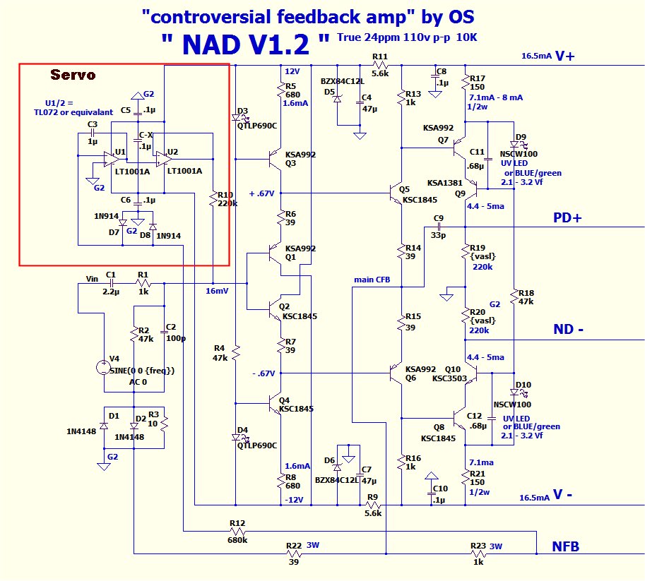

VAS at 10ma Re ? Main cascode must be 5.5 - 5.8ma ... this is within range.
OPS is designed for 4 - 6+ ma VAS currents.
Your (red led)CCS's must have a little more current than simulated (1.8+ mA).
Still , all is within design parameters. I design with a lot of "play" , so
the circuit will work VERY well -- regardless of unknown devices.
You say it "sings" very well ??
Then I will "lock down" the final "NAD V1.2" IPS schema (below).
"CFA "deluxe" 😀
PS - 2 days off ... I will streamline ALL OPS's (2 -3 - 5pair)
and I might even add an IPS (CFA)to the lineup !!
OS

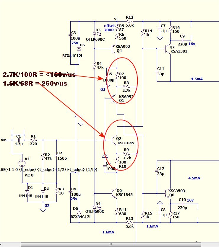

OS, what do you think about this IPS? It is almost same as your glacfa2.
I can improve the slew rate a bit if I run pre and driver transistor "hotter".
More slew rate is more current 😱
The OPS running a little "hotter" in your sim increases slew slightly.
Running the VAS at 10ma - slightly....
ON a CFA , higher IP stage CCS current/ increased current FB (lower R for current feedback resistors) will dramatically increase slew (below).
Even with a low I VAS (4.6ma) ....
OS

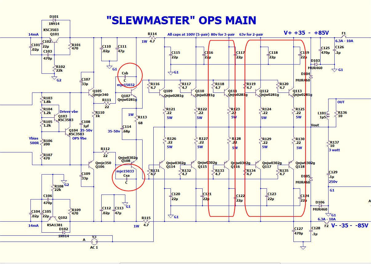

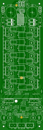

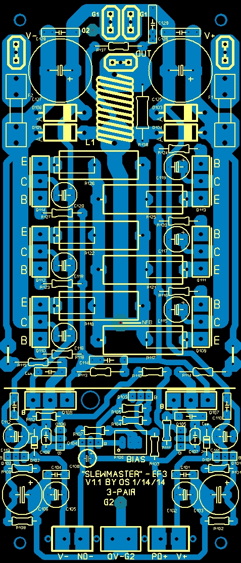

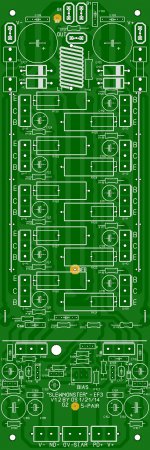

"unified" OPS (5/3/2 pair) ...
"Slewmonster (5 pair) is done (below 2).
- added a C-B shunt for drivers (Bimo 🙂 ) ... they are "Csa/Csb" ,
either a straight pF or R/C shunt of driver pair. OPS can now
be used universally for any EF3 configuration without modification.
-universal OP Re's all around.
-universal schematic for all 3 OPS PCB's ... omit last 2/3 pair for
smaller OPS PCB's. (below 1).
-The 2 pair board will have toshiba or MJE15032/33 (to-220) drivers. It will
be capable of being an EXACT clone of the H/K 680R OPS (105w/8R - 52V rails).
-Single sided for easy DIY (toner transfer) !
2 and 3 pair EF3 will be the same exact circuit as the 5 pair - no confusion
in troubleshooting or discussions. 🙂
Finished package will have BOM/screen/copper/schema/sprint file -all 3 OPS's.
Also a short "write-up" text file .... construction tips !
PS - final PCB size 5-7-9 X 3" (125/175/225 X 76mm)
OS

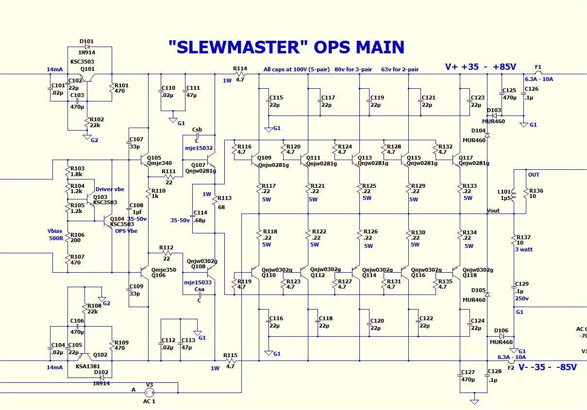

OS
Thank you, OS. Now, I understand about slew rate in CFA. 2EF can have more slew rate and more distortion than 3EF.
On my 3EF PCB, I add option for the driver. I can use TO-220 or TO-3P/TO-264. For compensation, I add option, C for pre-driver or C-R for driver.
OS thanks for all your hard and excellent work.
Two quick questions, what VA for a monoblock Slew Monster @85V(maybe you could recommend a transformer from AnTek ) maxed out.
How long in minutes does it take you to IRON on the toner transfer from your HP printer to a board? I bought a HP 2100 on your recommendation, thanks for tip. Can others here say how long it takes to do the IRONING? It seems to take for ever for me to get a good image transfer. I am trying to see if I am doing something wrong.🙁

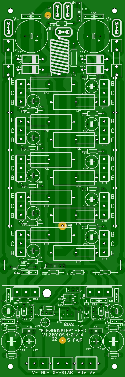

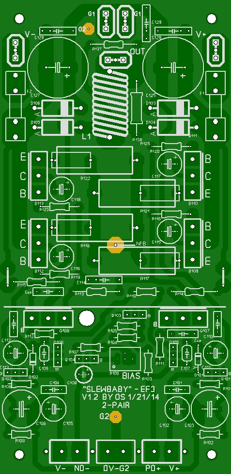

I'm impressed! I will be sure to build a couple of channels. Thank you!!
Wait for the "housekeeping" (which I'm doing).
It's harder than I thought (below 1-4)
Going from 5 -pair to 3 , each extra pair has to have numbers in
groups of 4 (2 re's and 2 basestoppers) to "jive" with the unified
schematic ... argggg !
There, all 3 and the schema .. ahhhh !
Still have to swap to-220 for the "baby" (first one).
If anyone wanted a 10pair, or something ... let them "have at" the
sprint file. These should do for most.
Ha ... we have the "monster, master, and the baby" ... 😎
PS - final scaling resulted in these dimensions - 6.125/7/9 X 3"
(155/177/225 X 76.2mm)
OS

Crank that iron up ... all the way. Pressing down real hard , I can get it in
about 2 or 3 passes.
You will see the pattern raise up slightly through the paper.
I'll even "preheat the board" a little with the iron to the backside.
PS - we should ask NAF .... his "master" looked awesome , even the
screenprint. I always screwed this up 😱 .
EDIT - the "monster" - get this .... http://www.antekinc.com/an-5464-500va-64v-transformer/ ahhhh ' site redesign !! 64-0-64 about 82-83v rails - 500w amp/4R - for real , I left
the "bus bar"(big copper wire) on the 5 pair - 12-15A fuses !!!
OS
