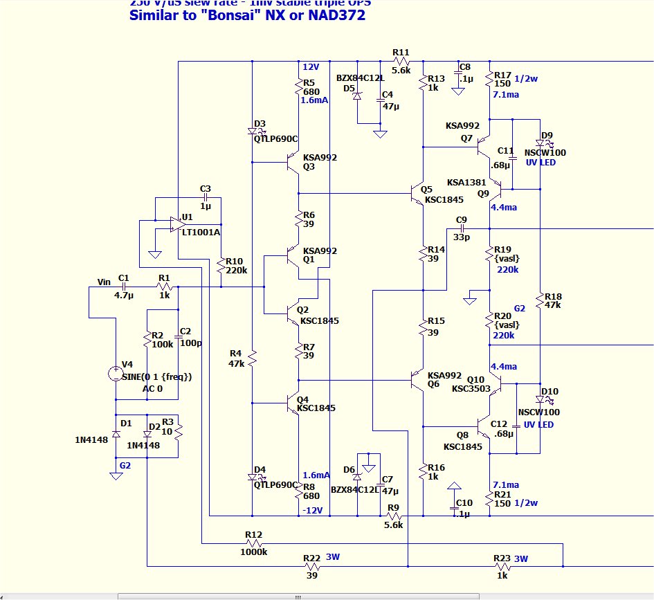

Hi uncle Os, yesterday i supply with 39vdc for testing.
Bias ok, i can set for 60mA a cross RE, dco stable below 2mv
Now i supply with 56vdc and i can't set the bias for 60mA across Re. I turn bias trim to minimum and it stay atv70mV (150mA)...it's very hot
Please would you simulate it so i can set bias for 60mA cross RE

I assume it is because with CFA , we are "mixed" ... a current derived
NFB vs. a voltage derived input signal.
Dumping the CF signal to the lifted ground modulates that ground reference.
THD suffers (this seems to be degenerative FB).
The VFA (like the Badger), I DO feed the DC cap back to the lifted ground.
NO THD degradation. (just uA FB current here)
What is different here ... we are differentiating two voltages.
I haven't exactly figured out why , but the manufacturers also do this ...
and the simulator backs up these differences. (lowest distortion)
OS

I already figured out why ! 🙂
look to your hawksford VAS. My original schema shows 68R for the Re's.
I messed up ! 😱😱
TOO much current !
Reduce VAS mA ....
Change R17/21 to 150R and R18 to 47K.
This will set 7.1ma total across R17/21 , the leds will drain off 2.7ma ...
leaving the main VAS cascode at 4.4ma.
Doing this will make for the 60ma OP bias at just about exactly half way
(205R out of the 500R trimmer).
I got these readings with my standard 60V rail simulations ... sorry for
mistake.
PS - another combo that will work is 120R = R17/21 (8ma total) reduce R18 to 27K
(brighter leds = 3.7ma) ... leaving 4.3ma at main Cascode !!
OS

No problem ... thank you very much it solved.. i'll fix my build.
But the sound its wonderfull
