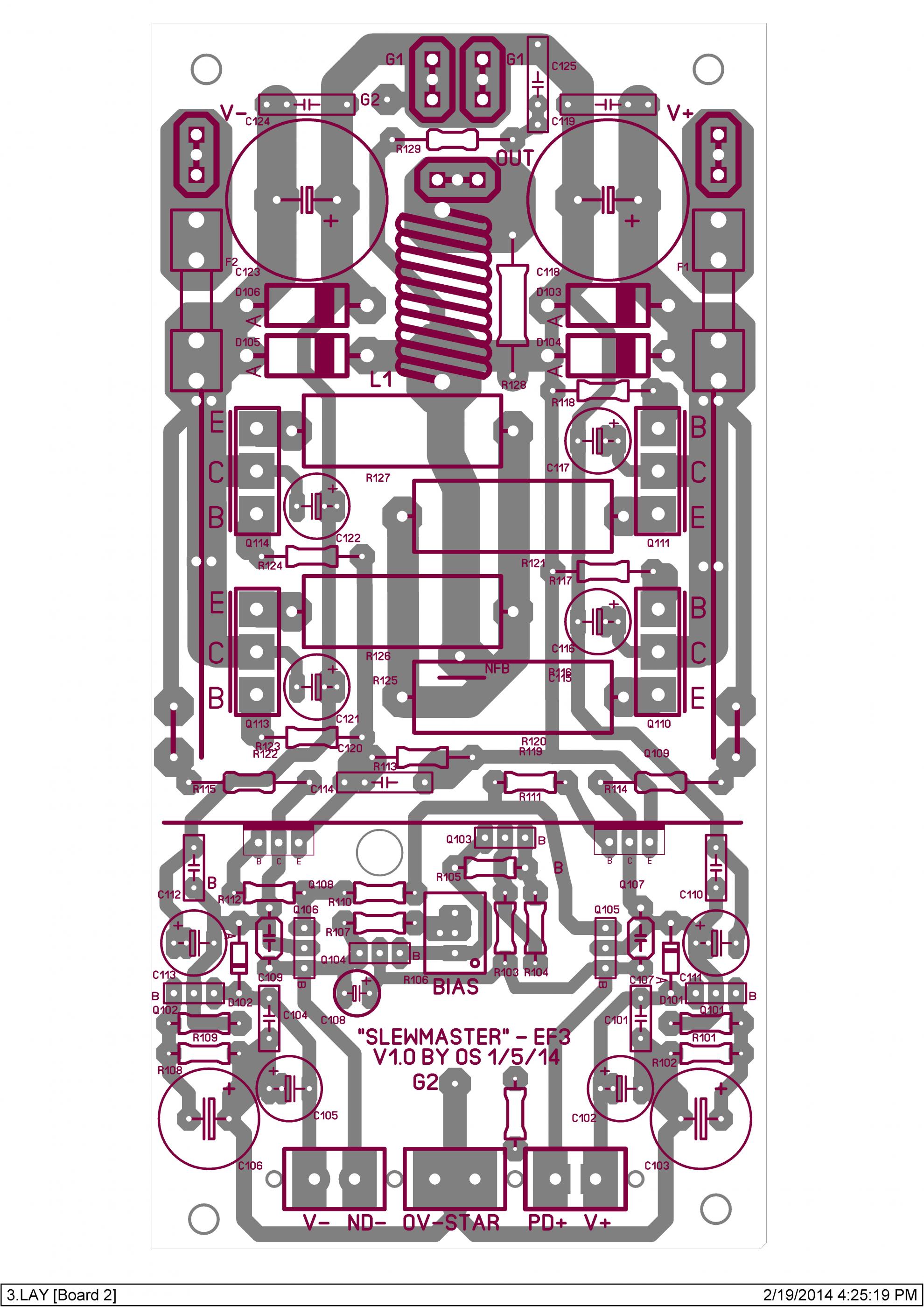

NAF , below is the "perfection" board.
the 5 pair version will be the same with 2 more OP pairs.
V1.1 has ....
1.single 8/10 pin/5mm pitch OPS/IPS euro-terminal can be used....
, 3 /3 pin , or /3 2 pin (nearly universal).
2. OPS emitter resistors can be Noble 12.5mm pitch/25mm ceramic/ or
18mm non-inductive (mount in 25mm resistor spots)
3.lots of "housekeeping" ... caps realigned (more clearance) - labeling.
After reading another thread , I will clarify ... the 3 pair version is for
up to 65V rails , the 5 pair version will be for( up to) 80V rails. 4R operation
on either will be dependant on OP selection and/or the rail voltage.
IPS's can be run with boosted supply (5-10V above OPS).

I think I must put "Bonsai protect" as option on my PCB.
I am not sure about mosfet for speaker protection, because sometime I can not find it in local market. I should ask Naf or John Bali about it.
If I can not find the mosfet, what kind of relay that I must use for speaker protect? 10A, 20A, or 30A contact?

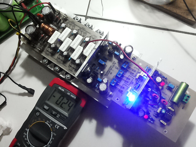

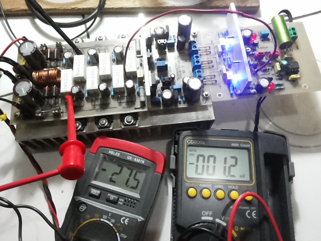

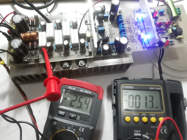

Hello Uncle Os,
The leds were lit...
I set 60mA per pair
Stable dc offset 1.x mV necer reach 2mV
It's night here so i'm not connect it yet to my speaker.
But this Slewmaster was shown a good sign of stability no oscillation😎😉

Servo is neat , aye ! Actively adjusts the offset...
Are they blue or UV leds ?
How is OPS thermal stability with the NJWxxxx drivers/Vbe ? this was the only
"guess of mine" .. 😀 I simulated with mje340/350 - NJW-NJW (pre/driver/OP)
for OPS circuit.
Nice to have something run the first time .... that is why I don't let the
computer do my layout , do the layout in "sections" (OPS/Vbe/multipliers).
Good work !!
OS
I reduced output to 2 output pairs because i only have 4 pairs mjll21193-4 for a stereo version and with lower supply voltage and mje1503x drivers.hope its ok.
Go for it ... the more the merrier !! 🙂
PS- edit the V1.1 OPS - then we can standardize troubleshooting/
layout issues. It is slightly better (shorter traces/more verbose).
See the "ghost resistor" error -V1.0 !!!! use V1.1 ... PERFECT !
In fact , you can contribute the 2 pair version - some want lower rail V/wattage !!
