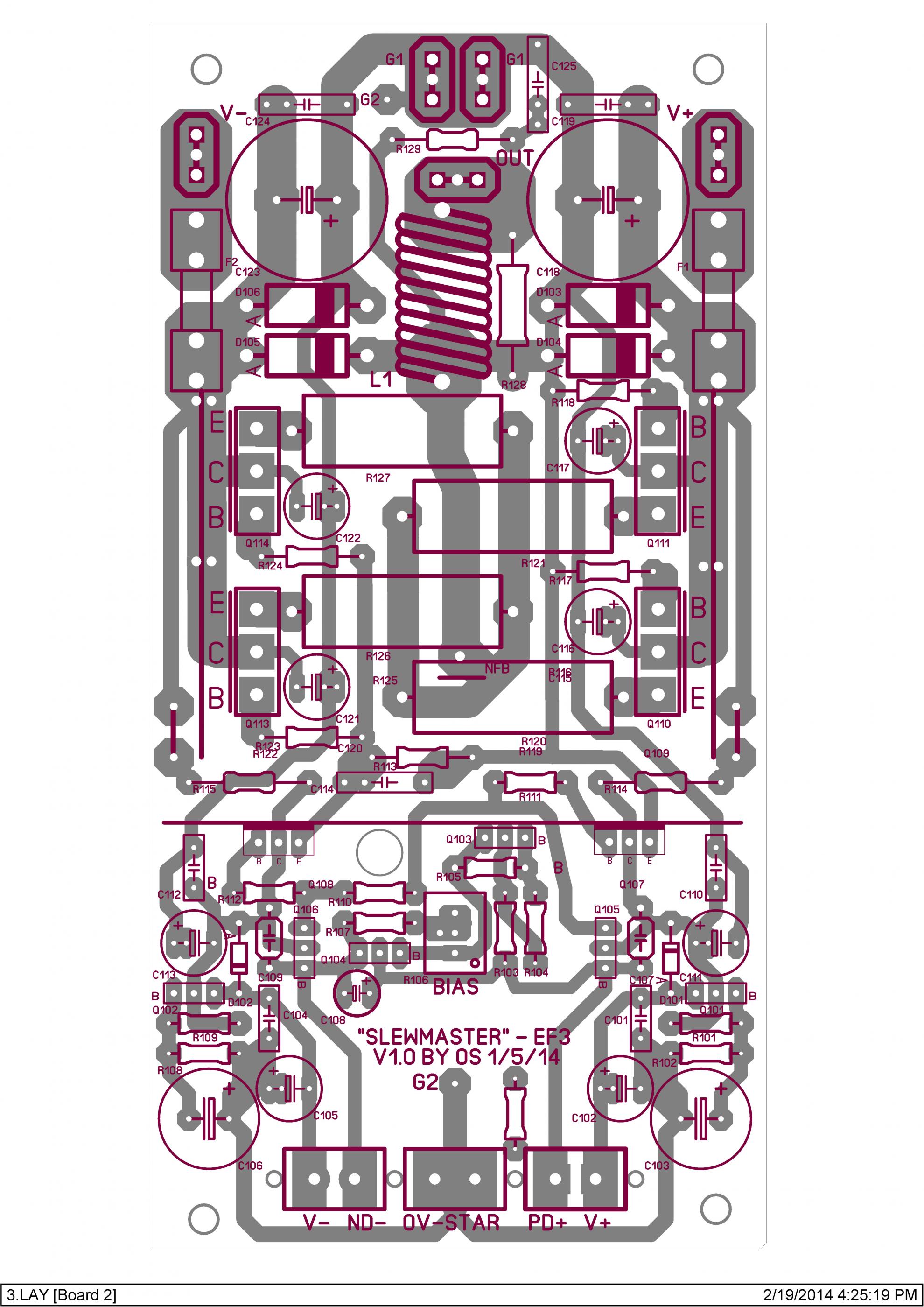

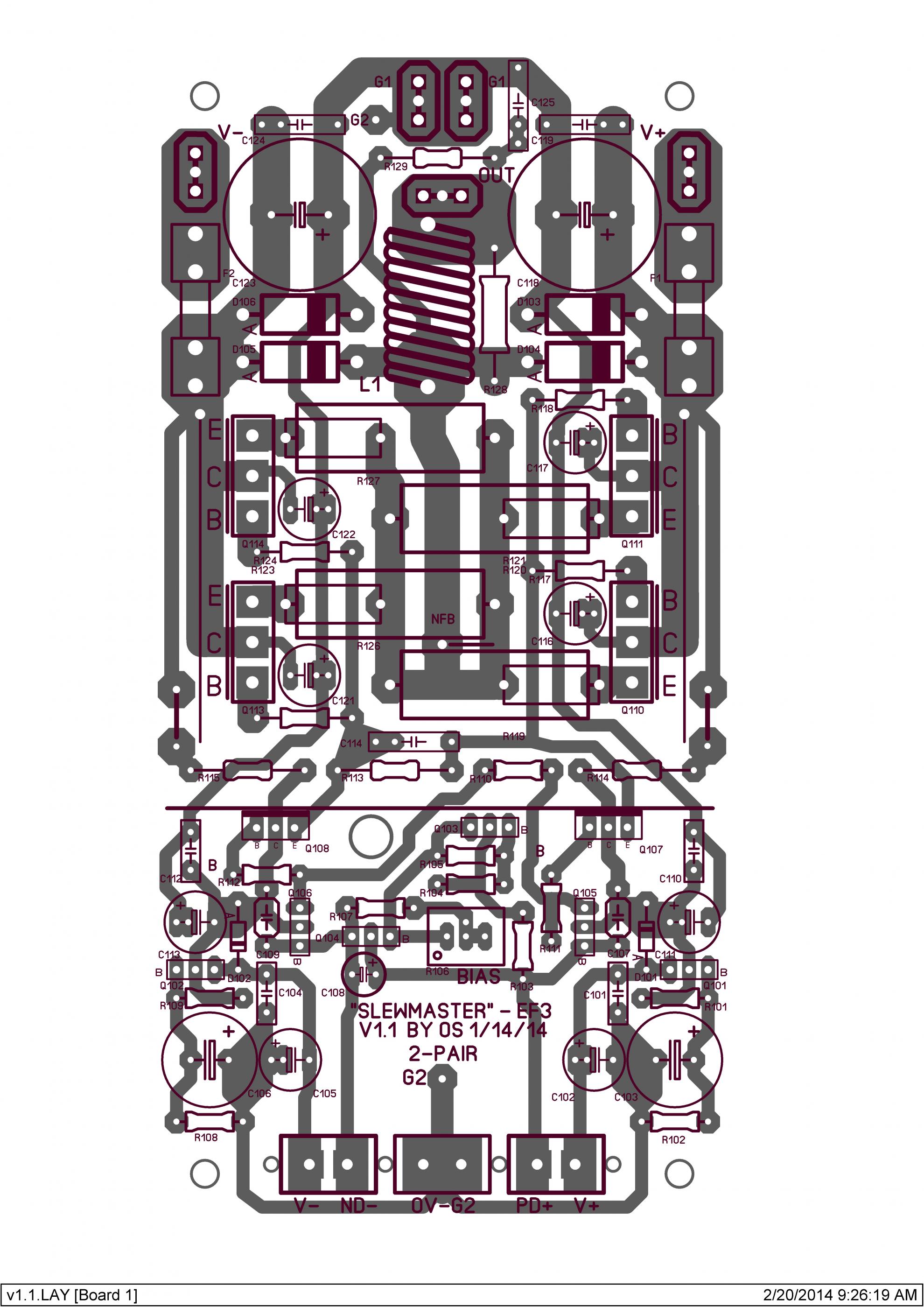

these are all the files (sprint layout file,pcb in pdf,components vie).it is based on version 1.0 sprint layout file you posted. i didnt take into account the "ghost resistor" error -V1.0 ,so i will edit version 1.1 for 2 output pairs and use that as you suggest. can you post the sprint layout file of V1.1? or modify it if you have time for 2 output pairs?
Post # 348 is V1.1.
edit- you wanted the sprint .. below.
