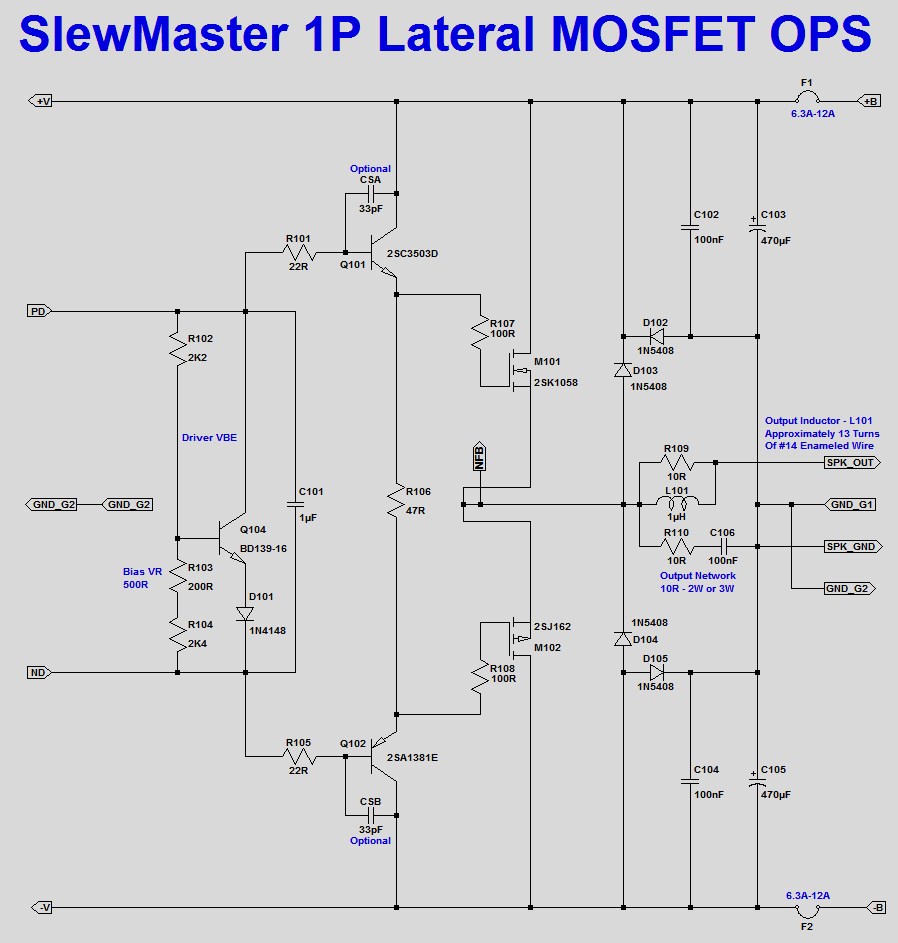

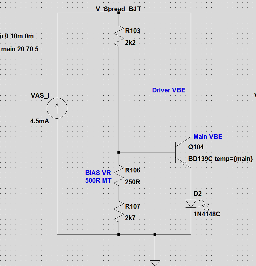

The LED will give some uncompensated spread for the lateral MOSFETs and the rest of the VBE multiplier will compensate the drivers. I haven't worked out the values to use in the lower resistive leg of the VBE to get the spread we are after and sim won't help much because the threshold voltages of the laterals isn't realistic. Just FYI, it might take some trial and error.

With the LED in place I have to raise the pot to 3K2 to get 16mA on the drivers and 120mA on the outputs. Would it be better to change the 2k2?

I don't think so. If the values get too high then you start getting base current causing errors. The lower leg on the board is a fixed resistor and a potentiometer, so you can choose something like a 500R potentiometer and change the value of the fixed resistor to suit the build.
That resistor value will be chosen to produce about 2.4V across the VBE multiplier in the real world, the simulator will have you setting the bias very low due to how easily the Cordell models turn on.

A quick sim suggests that you might get into the required range more easily with a 1N4148 diode rather than an LED. The voltage drop over the LED is too great to get the transistor to operate properly.
2K2 on top, 500R potentiometer+2K4 on bottom and a 1N4148 diode in place of the LED should be pretty close in real life but won't likely work quite right in simulation.

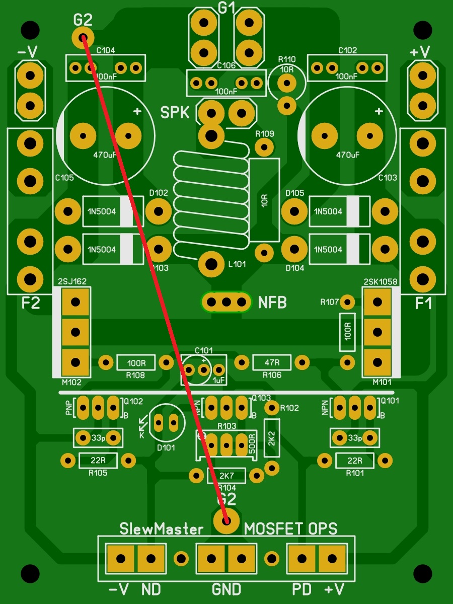

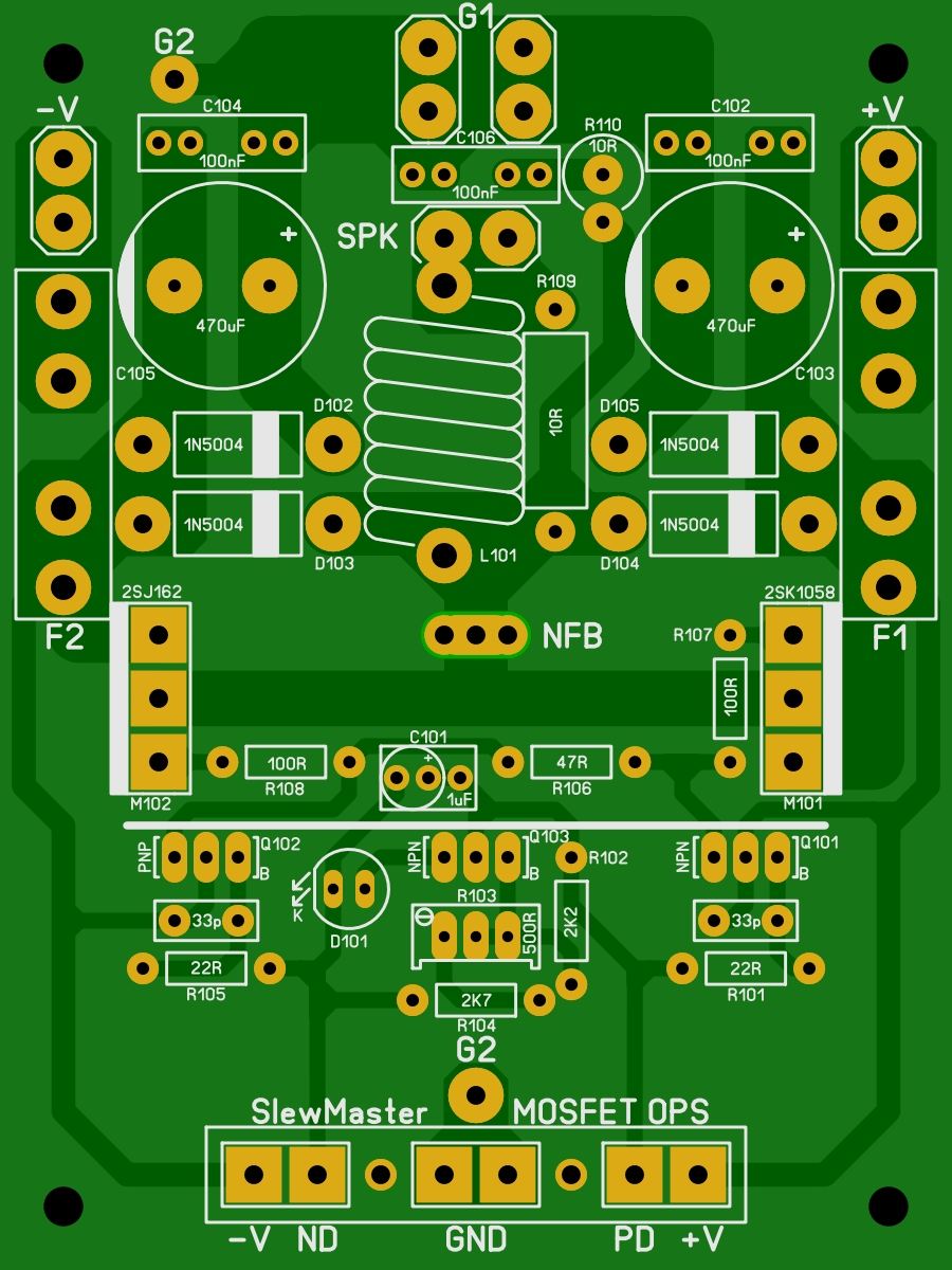

Not sure I follow. Which resistor are you talking about? You mentioned a 500R pot. I have to lower R131 to 400R to get the pot down to 500R. I'm just looking for a starting point so I don't burn something up.
Thanks, Terry
I did the layout with both a pot and fixed resistors, so I'm sorry I was referring to a physical build. In the simulation VR132 has a value that is the combination of of the potentiometer and the fixed resistor. I want to re-iterate the sim will give you values that likely won't work in real life.
Always start with the lower leg of the VBE multiplier at its highest resistance and reduce it until the target bias is achieved. The reason for putting a fixed resistor in combination with the pot is to prevent you from being able to basically shut the VBE multiplier off and allowing the bias to go totally out of control.

Thanks, I should have looked over the layout a little better. I was difficult with not part numbers or values. If you get a chance could you post the schematic you used for the board and maybe some values to start with. I think I'll stick a 2k pot in the to start, just to insure I have enough range. I can lower it later if it seems too sensitive. I have the boards ready to etch in the morning. I'll go from there.

Ok, I didn't bother creating a new silk layer because I figured it would be pretty easy to follow. I will do a quick schematic and silk layer and post them later so there is something to use as a guide.
That would be good. I'm going to set up my etching tank shortly. The schematic is more important than the silk. I can probably work it out from there.

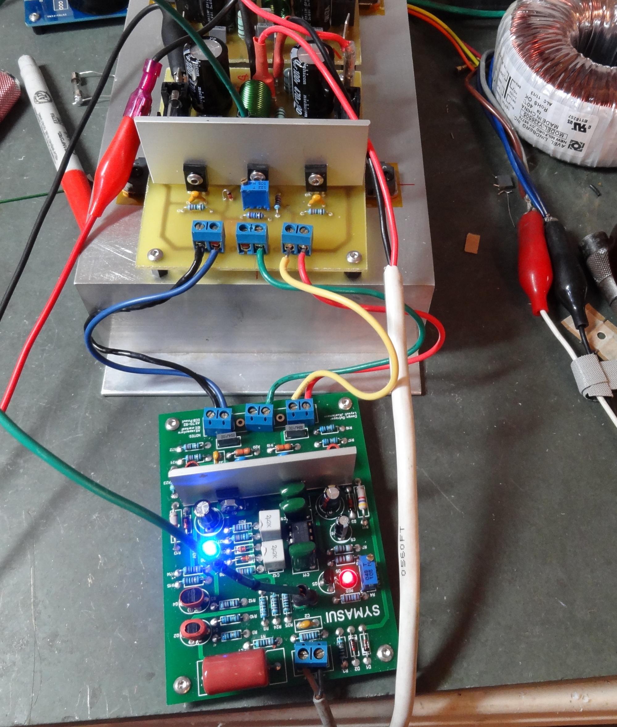

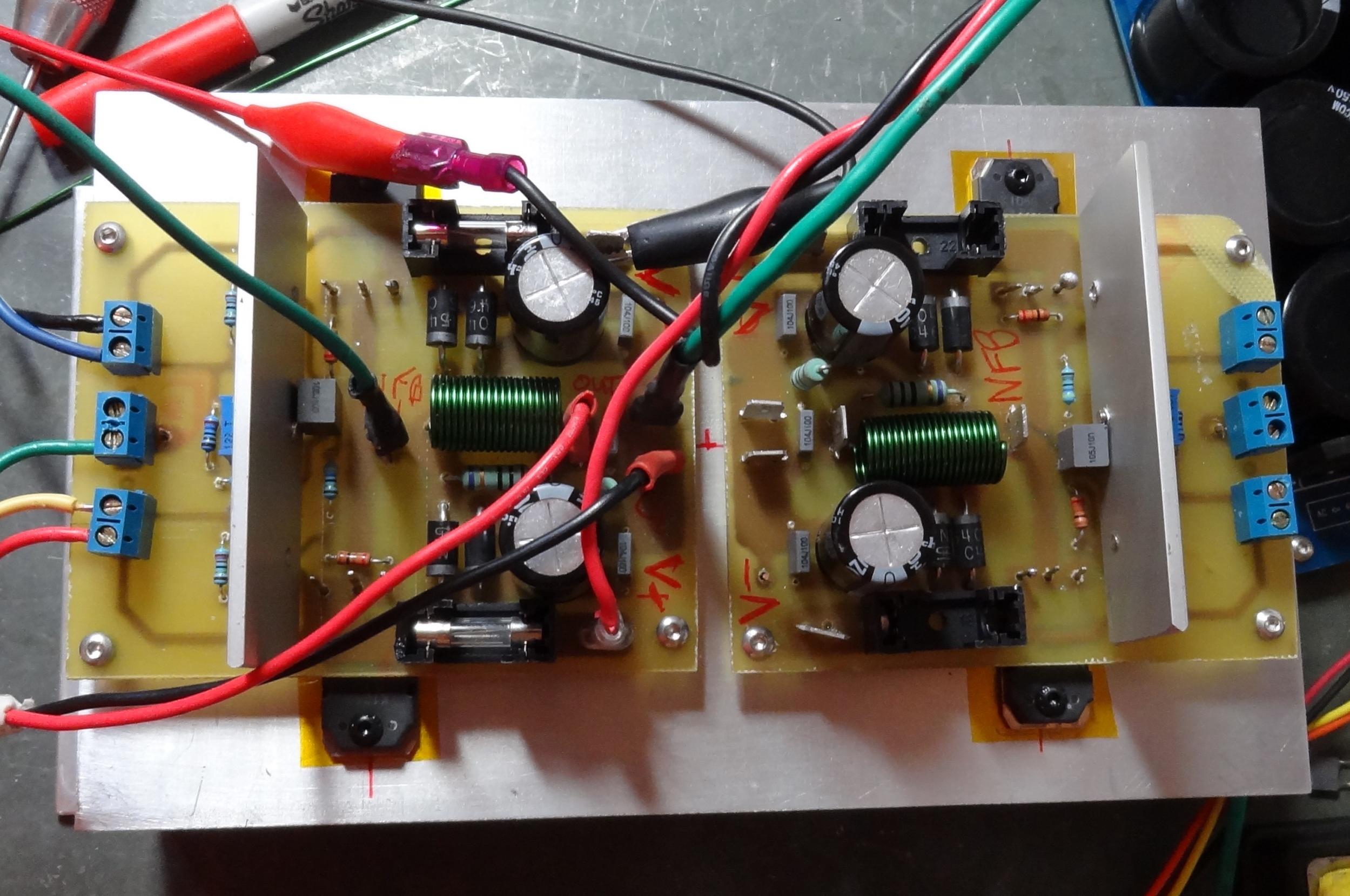

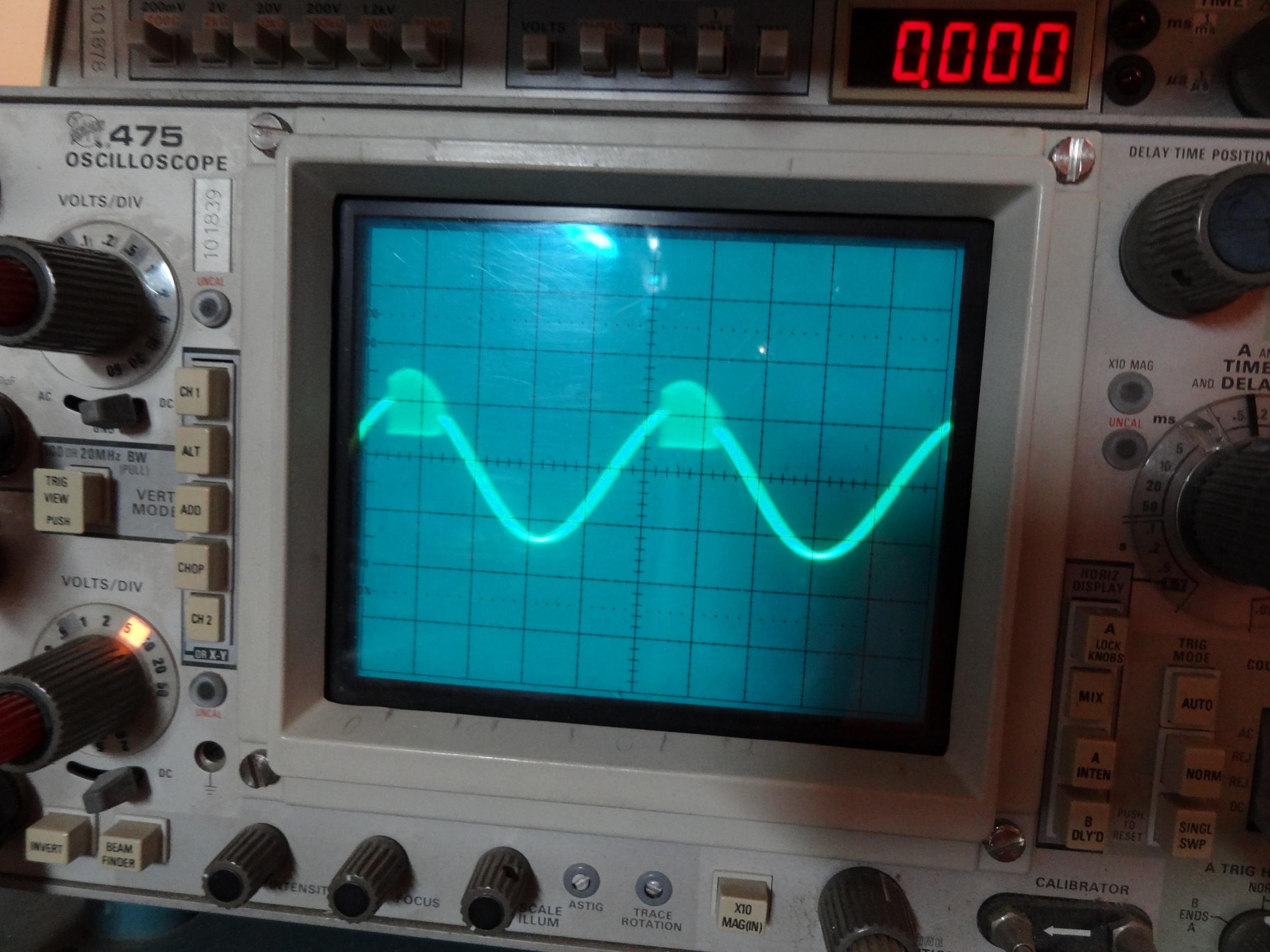

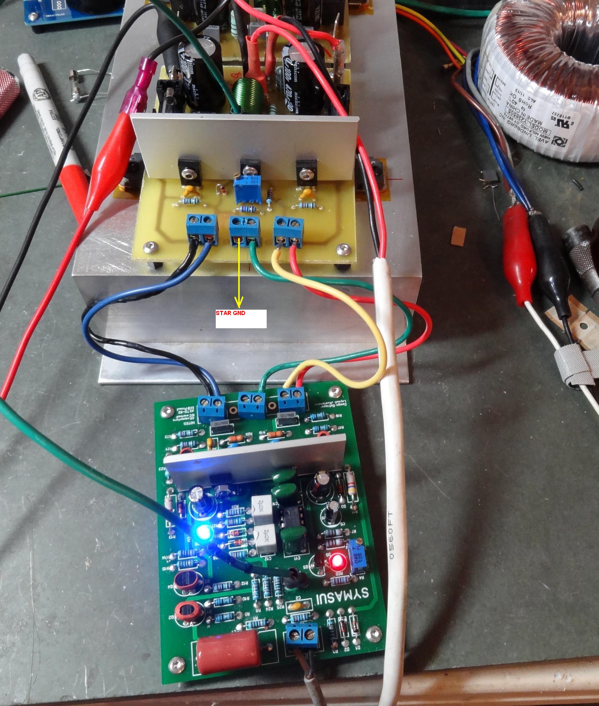

OK, I got it put together. Here is a report of the things that are happening.
First thing I did was hook it up with just 15K resistors from rail to PD+ and ND-. Not well balanced. 500mV offset. So the.n I hooked up a Symasui IPS to it and the servo was able to zero out the offset so that was good. Now for bias, with the 500R pot maxed out bias is at 80mA. With the pot turned all the way out it is at 105mA. Not much adjustment. Now for the worse part, with the output at about 3.5vac output I see some kind of oscillation on the scope. Suggestions?
Missed INP return.
