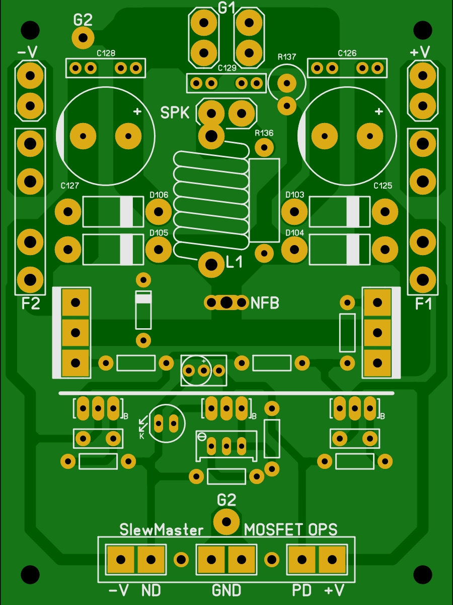

A stripped down bare bones lateral MOSFET OPS the same size as an IPS (3"x4") might look something like this:
But, I think it better using 3 mosfet, then we mount 1, 2, or 3.
The bias servo could optimize to both vertical and lateral. May be LED can be changed by jumper for lateral.

OK, gents. This is a 'use at your own risk', 'no warranty, expressed or implied' type deal. I'm pretty sure this is free of errors (did a little quick clean up) but since I haven't made one to test I can't say that it 'just works'. Enjoy.
Oh, and if it does work, post some pics!

Bimo, yes for a truly practical implementation I would agree. This is born out of an idea / desire Terry had to 'just give it a try'.
The LED will give some uncompensated spread for the lateral MOSFETs and the rest of the VBE multiplier will compensate the drivers. I haven't worked out the values to use in the lower resistive leg of the VBE to get the spread we are after and sim won't help much because the threshold voltages of the laterals isn't realistic. Just FYI, it might take some trial and error.
