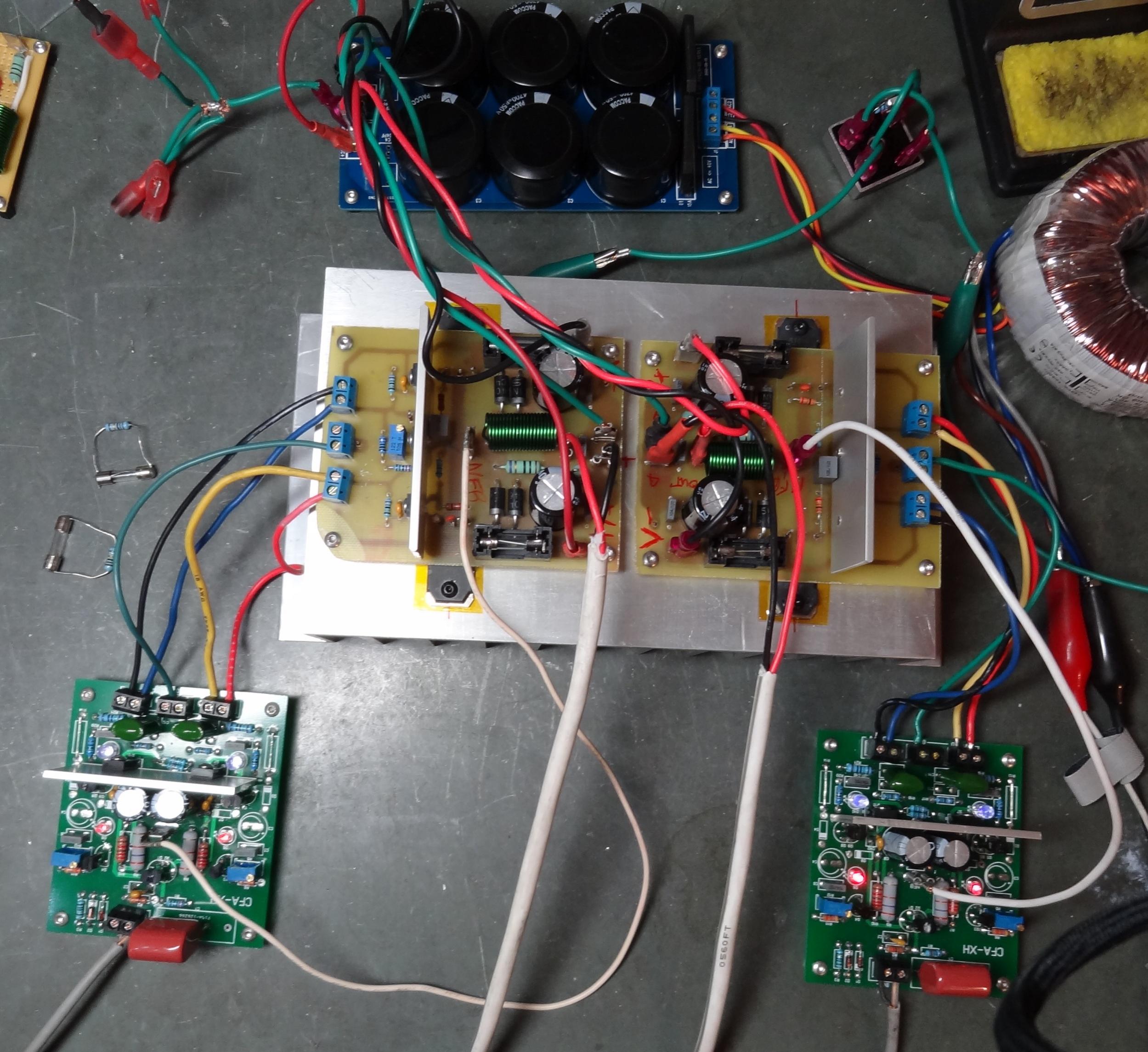

Yes I tried Symasui, Spooky and CFA-XH BV. The oscillation happens on the way up. From about 3.5vac to about 10vac. Then it goes away and the sine wave is clean. Maybe a hint, it is worse with the DMM attached to the output? One channel is a little worse than the other but they both do it. There is a hint of the oscillation on the driver emitters but not every time I cycle the sine wave. It is there on the output every time. With the DMM removed it is much less. Aside from the oscillation, both sine waves and square wave look very nice.
Another thing I noticed is that it is very sensitive to having other ground sources attached to it, i.e. the scope. presently there is no earth ground to anything. That is usually not a problem but I will see if adding that will have an effect on the oscillation. On other amp where I had oscillation, the grounding sensitivity went away once we found the source of the oscillation.

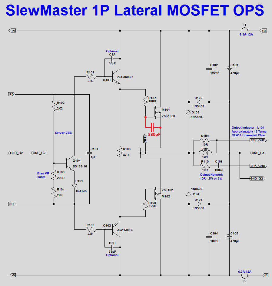

Hi Terry,
P-channel laterals (2SJ162 in your case ~ 900pF) have got significantly higher input capacitance, than N-channel ones (2SK1058 ~ 600pF), resulting in rather unbalanced OPS at high frequencies.
Try adding a 330pF cap between the gate and the source of 2SK1058 as shown on the picture - this will make the whole thing much more balanced and stable.
Also, slight increased stoppers may help (I would use 470 ohm for R107, R108), however the cap is more important.

Hi Valery,
That was it. Straightened it right out. I have it playing with the original BV modded CFA-XH IPS. Wonderful. I have it hooked up to the A/B setup along side my PMA VSSA (it uses the exact same outputs). Too close to call. Great sound stage as you would expect. This one has slightly more output but it is running on +-45V rails and the VSSA is on +-36V. Still only able to get 90mA at the fuses but that seems to be enough. The scope looks great.
Now I wonder why on the VSSA/peeceebee there is no special compensation for the 2SK1058. Both sides get the same thing. Cool thing is I'm still learning something and hopefully others following these threads are too.

Let's say the 2SJ162 has a gate stopper of 100Ω and a gate capacitance of 900pF, the RC time constant is just RgatexCgate=RC time constant, so 100x900x10^-12=90nS. If we want 'balance' we need a resistance on the gate of the 2SK1058 that gives the same time constant. So, Rgatex600pF=90nS, solve for Rgate. In this case Rgate needs to be 150Ω.
This could be a valid experiment, remove the capacitor and increase R107 to 150Ω and see if the effect is the same. I'd even suggest since it appears sensitive to set R107 to 470Ω and R108 to 330Ω, same equalization of the time constant, just with higher values overall and see if you can get it to function stably without the added capacitor.
For the VBE, try R104 as 2K4 or even 2K2 if needed and see if you are closer to the sweet spot.

Bump R106 to be 68R to get the EF current down to 16mA.
The gate stoppers need to be in place but it offers the best performance when they are as small as practical. In this case there will be no audible difference with them being 470R (or the 470R / 330R combination).
