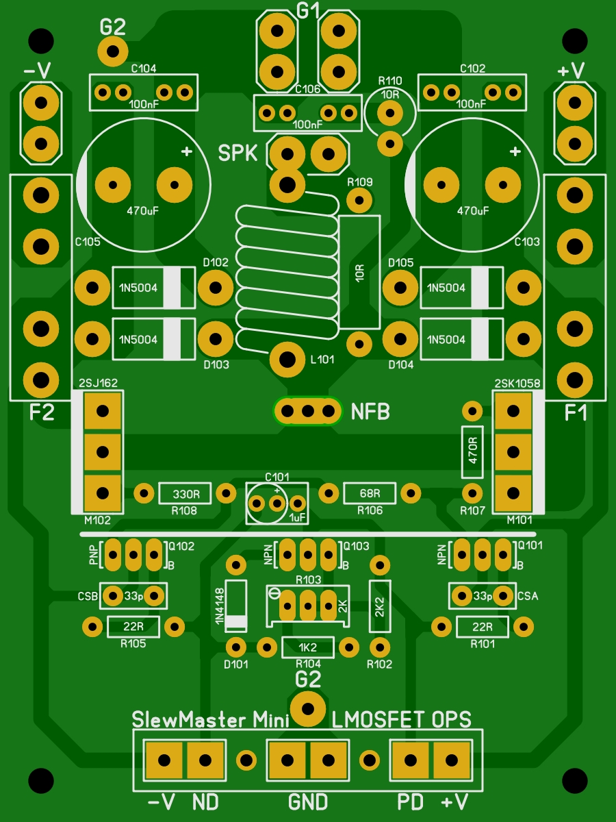

OK, yesterday ended up being a family day so I didn't get back to the OPS until today. I changed R107 to 470R, R108 to 330R, R106 to 68R and R104 to 2k2. I removed the 330p cap from the MOSFET.
Oscillation is gone.
16mA at drivers.
Quiescent current at the fuse starts at 105mA with trimmer all the way in and ends at 145mA with the trimmer turned all the way out. It is playing fine but it just seems like there is not enough adjustment. Seems like I should be able to get the bias a lot lower if I wanted and if I need 150mA at the device I need still more as 145mA-16ma = 129mA.
Looks like maybe still it need a little more fine tuning?
Thanks, Terry

We could move to a 1k potentiometer and make R104 1K8 (or even 1K5 if the range needs tweaked a little more). We aren't going to get a huge range od adjustment. As far as I'm concerened anything from 100mA to 150mA is good, I usually shoot for 120mA but that's just a personal choice.
Ok, so here's where it is set right now.
+-44Vdc rails at idle.
R104=1k2
R106 68R
R107=470R
R108=330R
1K trimmer.
With trimmer set to 1k, current at the fuse is 70mA I was able to adjust the current to 166mA without turning the trimmer all the way out. I will check the actual setting after it has played for a while. I see 16.2mA across R106. Looks like everything is now where it should be. I'm going to let it play for a while and then recheck the bias and heatsink temps. This sounds every bit as good as my VSSA so I'm pretty tickled with how it came out. Certainly a worthwhile option for someone who wants something smaller and simple.
I'll report back with some temp readings and any notable bias changes after it has played for while.
Blessings, Terry

Going with all just as it is except using a 2K trimmer will allow lower bias settings with the same maximum bias setting, as set by R104.
Minor housekeeping, but now looking like the attached. There is room to re-integrate the capacitance multipliers (simplified of course). Any value in that or just keep this one simple?

Looks really nice. I like the idea of the 2k pot. The bias is not touchy so that sounds like a better option. After letting it play for a while I rechecked some things. The driver heatsink still feels really hot and it reads 19mA with the bias set to 166mA so I think I should either go up in value on R104 or down in the bias.
This is just my thinking, but if you could fit it, I would like to see a trace, maybe on the top, to jumper the two G2 nodes so we don't have to solder that long jumper wire.

R104 sets the maximum allowable bias setting, did you mean R106? Next stop for that would be going up to 75 or 82 ohm, again to target the 16mA mark. Mind you they wont be exactly cool shaving off just 3mA, some dissipation of heat in the drivers is going to happen. A little more driver heatsink area maybe? You likely don't need to run with quite as much bias as you are currently using, maybe back down to 120mA-ish. I know the general opinion is that 150mA is a 'sweet spot' for the output bias but I'd suggest in proper testing folks couldn't tell if lower values of bias were being used.
A top side trace to connect the G2 points is easy enough and likely wont be any worse than a wire, so I'd be inclined to do that.

Yes, R106. I am on my tablet and was typing from memory. I'll back the bias back down to 136mA and check R106 again. It is likely OK at that setting. I have another amp on the bench right now but I will try to get back to it today.

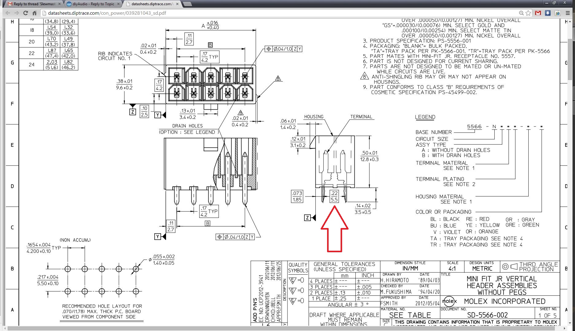

Hi Valery,
Can you tell me what the pin spacing is for the Molex connectors on your boards?

Hi Terry, pin spacing is 5.5 mm = 0.217 in. By some reason this one is metric originally...
Attached is a fragment of Molex datasheet with spacing marked.
Valery
