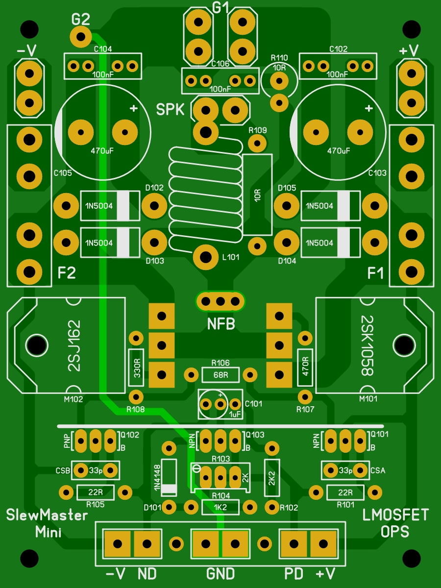

Is it important that the rail feeds and speaker output are at that end of the board? I saw another thread where they are talking about sawing the boards down to select the number of output devices. The boards looked very similar to these. It looked like if the power feeds were moved to between the drivers and output devices they could just saw the board off at the number of desired output devices and not need to splice the boards together again.

As for connector positioning, I think the idea here was to keep the high current areas well away from low current / higher impedance areas.

That's the thread. I was wondering if moving the rail feeds might actually help with voltage drop to the earlier stages of the amp? No power hog outputs in the path.
With the boards I've done there's sooo much copper there you could run two toasters on those rails without excessive voltage loss (the calculation said something like ~38A for a 20C rise over ambient). The voltage losses are actually designed in with the RC filters in each rail and the capacitance multipliers feeding the rest of the amplifier. Moving the connectors isn't going to save us much if any voltage headroom. It's the price we pay for catching a fair bit ripple and noise before feeding power to the more sensitive parts of the circuitry.
In-board output MOSFETs to minimize footprint...

This audio circuit board design is a lot tougher than the automotive world I normally deal with. I just need to get power or signal from a to b and design the circuit to be noise tolerant. Electrical environment is terrible in a vehicle. One thing that still keeps striking me as wrong with audio boards is fusing on the amplifier instead of the supply. I realize the wiring isn't moving as much but wouldn't it make sense to protect it with the fuse as well?
Lots of different and sometimes conflicting requirements in audio. That's why you sometimes see odd looking implementations; they are usually done to accommodate certain design criteria without compromising other areas of the design. Fun ain't it?
The PSU is of course always fused protected as well. It just comes down to whether or not you want to put all the fuses on the PSU. I have a personal preference for putting all fuses on the PSU but I bent to the popular design practise here of putting rail fuses on the amplifier board.

Thanks. Good call on in-boarding the output devices. Keep an eye on the Group Buy thread for availability of boards as they become available and post interest there. I'll make sure you are on the list when these are available.

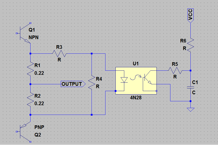

Imagine short to GND at output, so momentary Vce will be 77V. And look at SOAR region for 2SC5200 for (DC) allowed current. But for full output in normal load you need much more... It is not good idea..I want to use this simple current limiter, because I don't want add THD to may amp. If I use 2SC5200, how much current it should limit? I will use +-77V DC power supply.
Jason, this one is excellent! Very refined cutie, great addition to Slewmaster collection
For short circuit it will blown the fuse. I have accidentally short my amp. The transistors survived.
For PA use I agree to use SOA protection.
