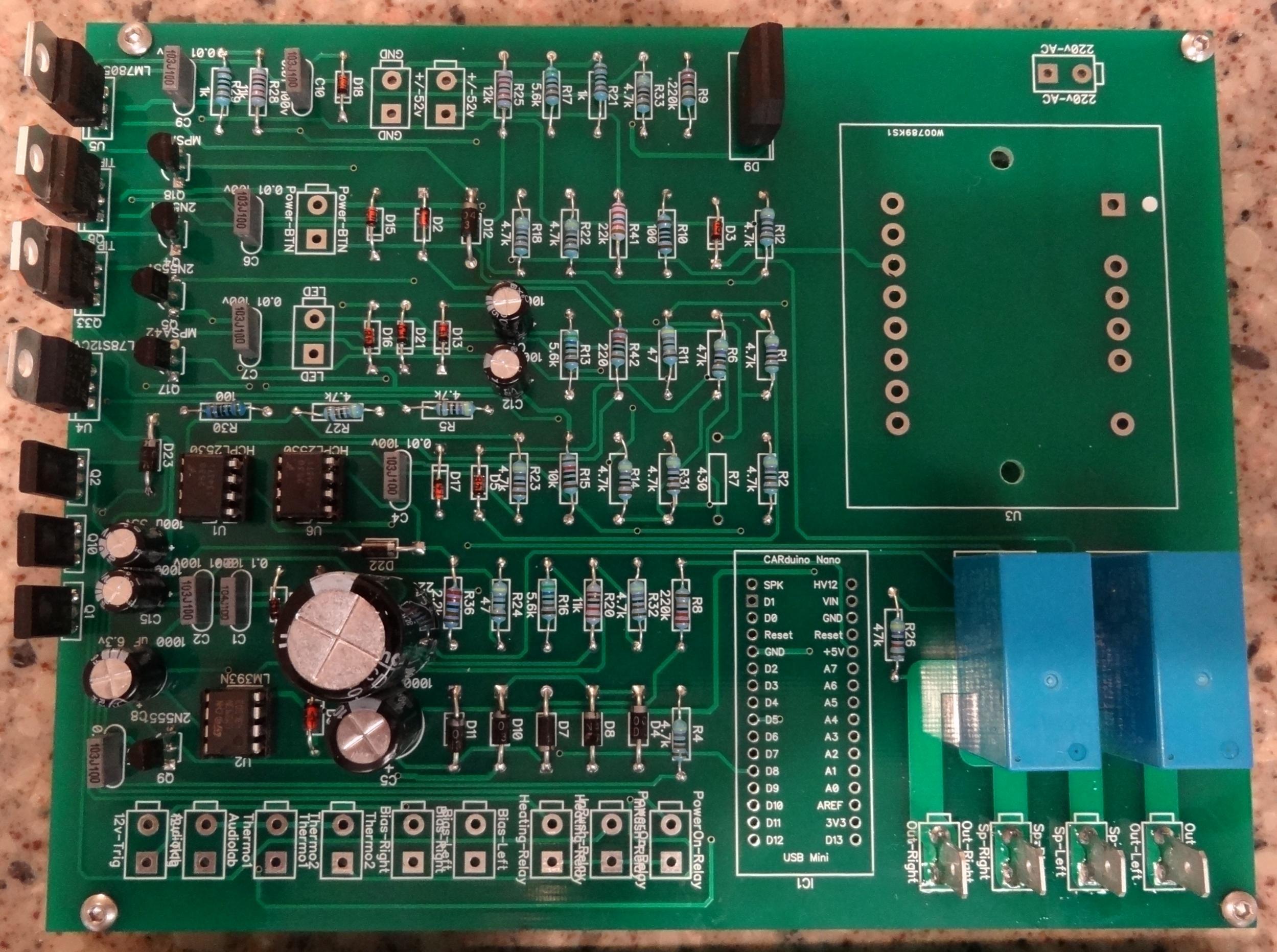

Hi Guys,
I got my Valery Protection circuit boards today. I didn't quite have all the parts yet but installed what I had. Still looking for a supplier of the Chinese plugs. If someone knows of a supplier for the transformer that fits this that would be a good thing.
I have some extra boards for those interested. PM me.

Cool! As soon as you get Arduino module - let me know, I will give a couple of guidelines on how to program it properly. You will also need a standard USB-to-miniUSB cable for programming.

I think, you mention those MJE340s' that are used as temperature sensors, right? They are expected to be placed on the main heatsinks.
Hi Valery,
Do you have a diagram on how all this stuff hooks up? There are a lot of plugs on this board. I'm assuming that the MJE340s must use a couple of the plugs but they are only two pin plugs so obviously there is some modification needed. I see +/-52V ?

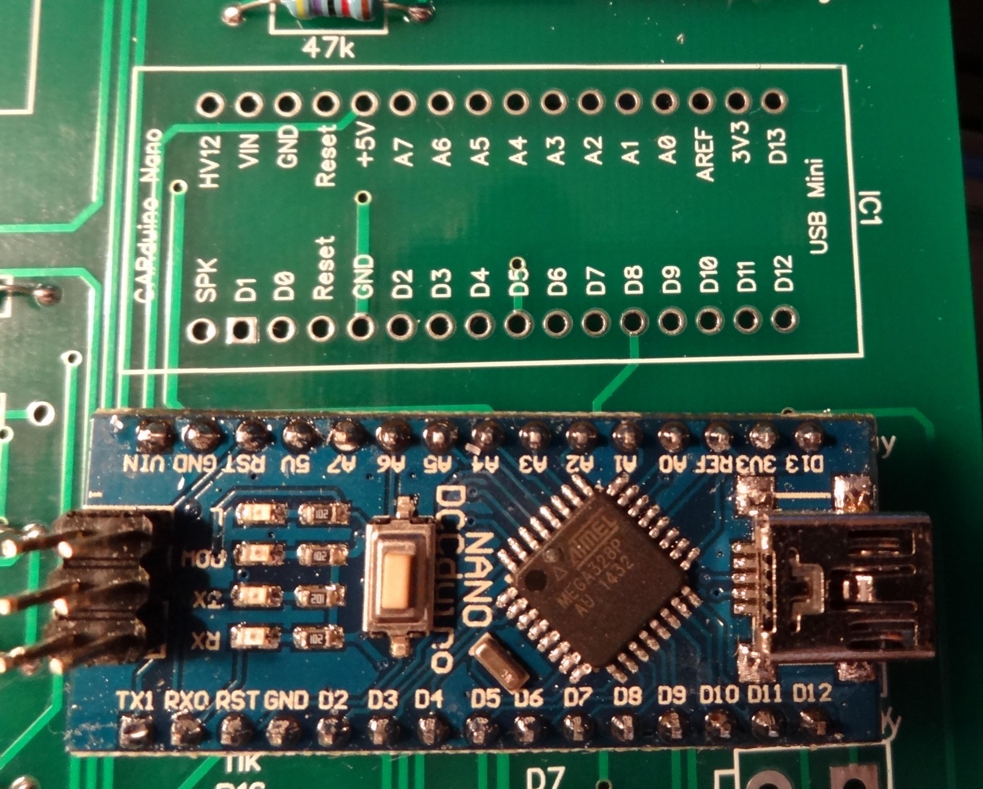

I received my nano today. Some pins have different designations. Can you take a look and see if there is any problem?

It looks to me that the PCB is laid out expecting a 2 x 16 MCU. The one you have is 2 x 15. However the pins that are present on your MCU appear to be in the same sequence as the one described on the PCB. Unless something is mapped to those missing pins I would think your MCU should work!

Hi Terry,
Carl is right, just leave 2 holes on the left (marked SPK and HV12) unused - they are reserved for those clones having 2x16 pinout. I actually use an IC panel, so that I can plug Arduino in and out, but it can be soldered-in as well.

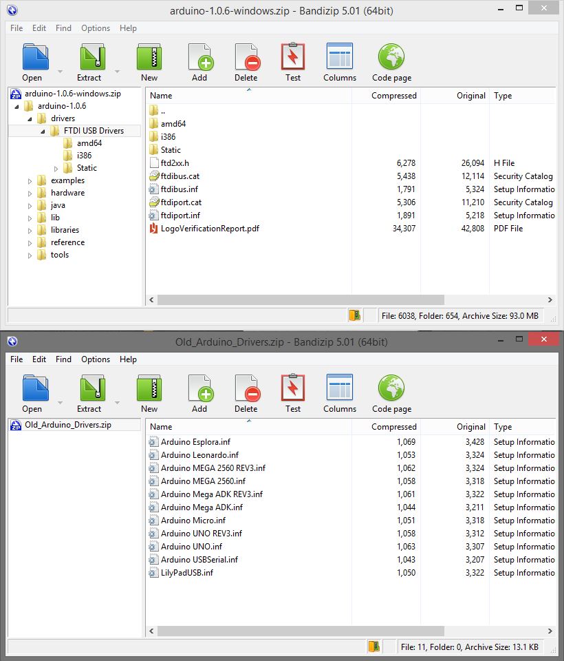

So, for programming, you need to install the software, as described in my document, copy the firmware to Arduino directory, connect Arduino via a miniUSB cable. See the new com port appearing after you connect Arduino - select this new com port in the software (Tools - Serial Port - COM-something-not-1-normally).
Open the firmware listing (File - Sketchbook - PowerAmp_05_int_tube).
