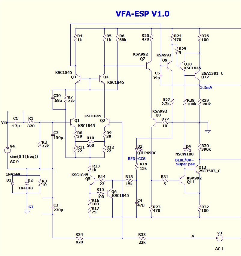

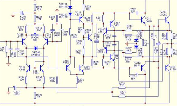

The VFA (attachment 1) is the original luxman IPS + a super-pair VAS.
- 10ppm THD20
-soft clipping
- faster slew than the typical VFA.

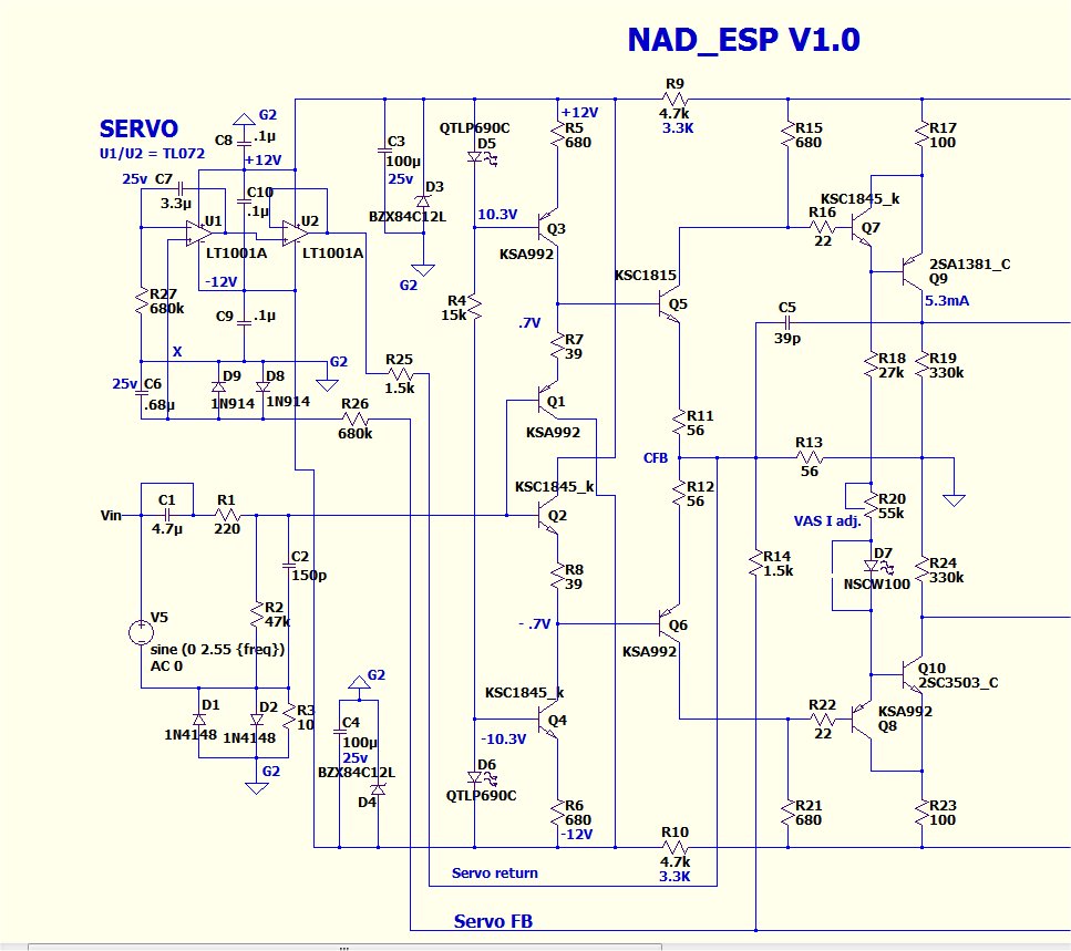

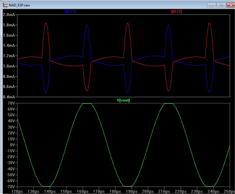

The CFA (attachment 2) is a re-do of the NAD-CFA.
The super-pair not only alleviates the stress on the current FB stage,but
has faster slew ,easier current trim , and the same "self-clamping" clip
behavior (attachment 3).
Both are literally saturation proof ( superpair to-92's shut off .. att 3 - upper plot) ... with
"tubelike" clip harmonics.
.... Less load on either VFA or CFA input stages .... superpairs are like
the blameless beta enhanced VAS , but with superior speed,slew and
overload characteristics. 😎
I now see why this is the Yamaha "way". Apex on the forum has also
used the superpair.
PS - on this forum (I might be wrong) ... this is the first "symmetric
super-pair"

Sweet. Any concerns about the super pair and internal stability? Some info I've read suggests they can be finicky.

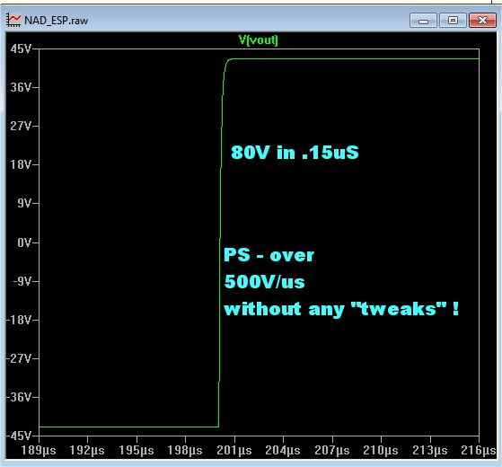

I read that too !!
The Koda KD261 has a "cult following" (they mod this amp like a hotrod).
It also has a bad habit of instability (attachment 1).
The Yamaha XP series , on the other hand , has the best record for reliability.
Superpairs are actually a very tight FB loop. The probe shows the pole is
near the Ft of the BJT's.
Beta is close to the wolverine/badger ... only a few uA to "swing" the VAS.
Look at the 2'nd attachment .... slew is 500V/uS with no tweaks.
Superpairs are much faster than the hawksford/single BJT.
PS - I was also both apprehensive and surprised by the superpair's performance.
I could only imagine the slew of a CFA-X/super-pair combo ... overkill ??
😀😀 ... (2kV+ ?)
OS

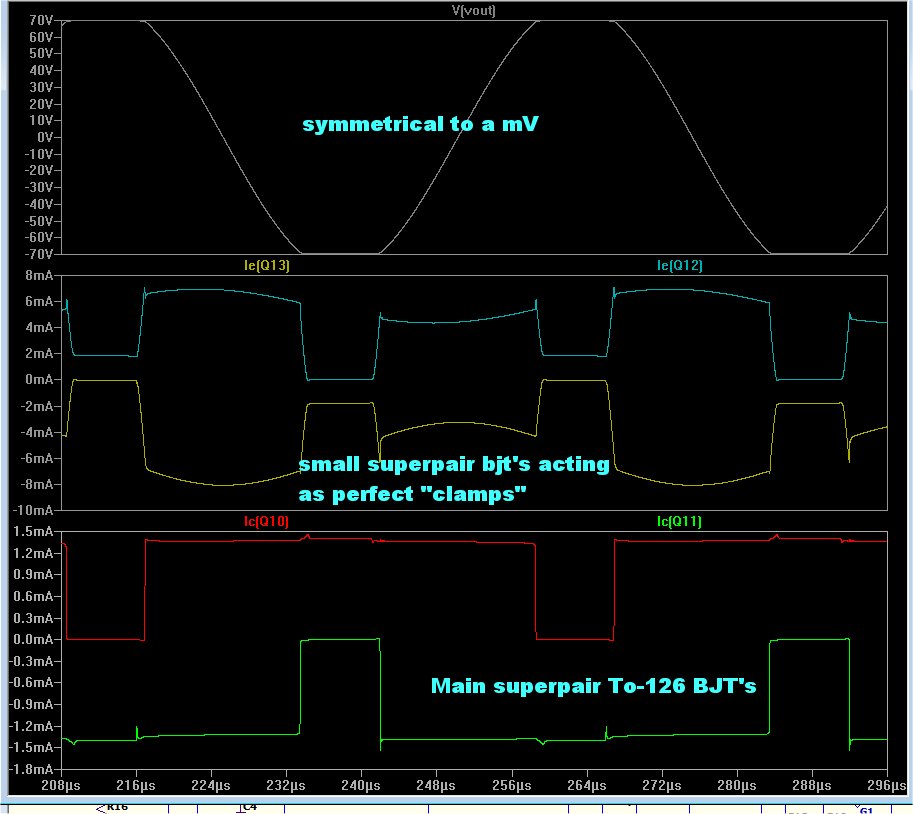

Why I am on the "superpair "kick" ...
Observe (attachment 1).
top plot is a perfect symmetrical overload.
Middle plot shows the low current superpair "clamping" the main
VAS bjt's .... (bottom plot).
The 3 Yamaha amps (schema's)... like this use no heatsink in the IPS ... ,
this is because all the stages actually dissipate LESS during
overload.
-The "blameless" overloads and draws more current from both
the beta enhancement device ( and both CCS's) .
-The Hawksford VAS's will also demand more current from the
preceding stage . This was (IS) an issue with most of the CFA
designs.
- We WILL clip our amps (even occasionally) .. the behavior at
this point will be heard (or we will smell it 😀 ).

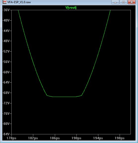

Superpairs have classic "rounded" tops when over-driven (tube-like??)
- (attachment 2) ...
Hope this explains the improvements ... both in reliability and performance.
OS
