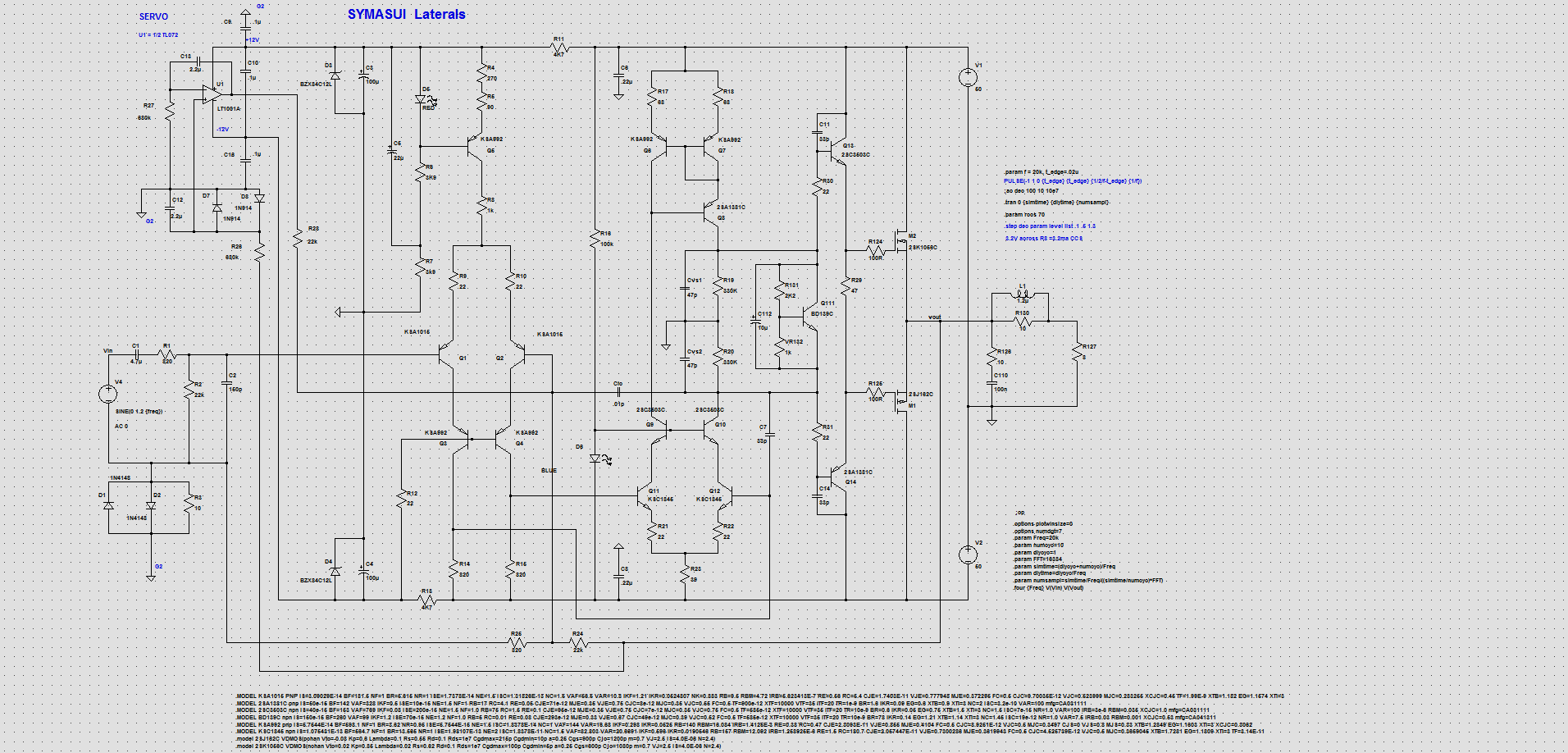

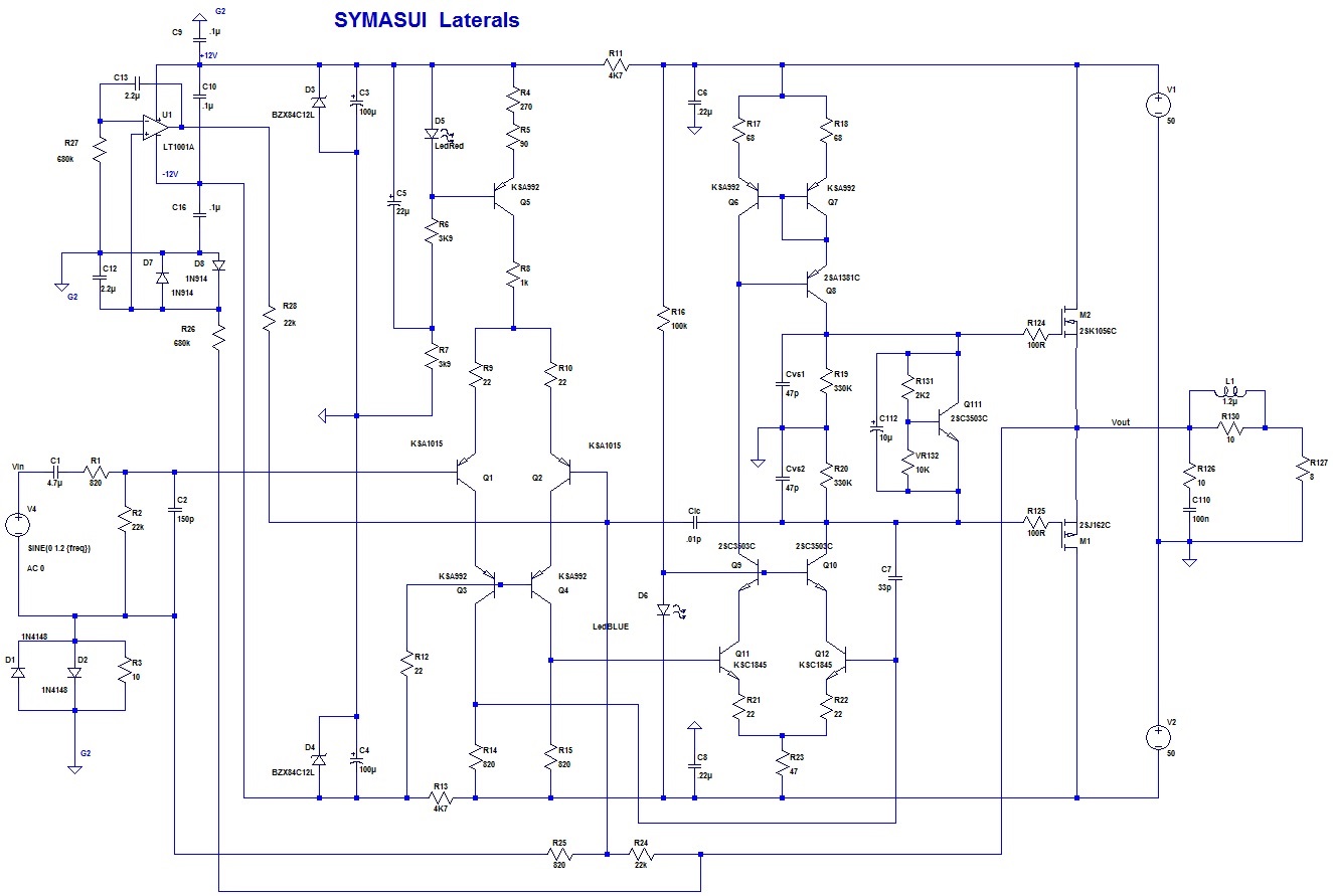

Speaking of Symasui, I have a few extra boards so I was trying to think of something to do with them when I got the idea to try making a small amp out of a pair. The MOSFET discussion got me wondering about laterals because they take fewer components. I put together a spice file to try it out and Jason was kind enough to help me get it working. Before I build it, I thought I would post it here so some of you could take a look and make suggestions.
Thanks, Terry
Thanks, Terry
Terry,
Does that circuit have both GNFB and a servo for control? I'm thinking this circuit looks familiar to something OS was doing earlier without the pair of mosfet outputs.
I don't know about GNFB. This is simply the Symasui IPS with a VBE multiplier and a couple lateral MOSFET's as the OPS. The IPS does have a servo. The IPS is the one that Jason is selling boards for. Another learning exercise for me. Specs aren't nearly as good as with the Slewmaster OPS but considering it only has a handful of parts it seems like worth trying.
And yes there is GNFB - Global Negative FeedBack. The servo is only for keeping DC output offset near zero without any manual intervention.
terry:
just had a very quick look at the schematic.
two things hit me right away:
1. i wouldn't build this unless i wanted to smoke the cascodes Q3 & Q4; they are not biased properly
2. if D6 is really an LED, (lets say it's red) is 1V across Q11 and Q12 really enough for them to operate properly? i'd guess not ...
there's more, such as <1ma seems small amount of bias for LED D6 to be used as a voltage reference ...
