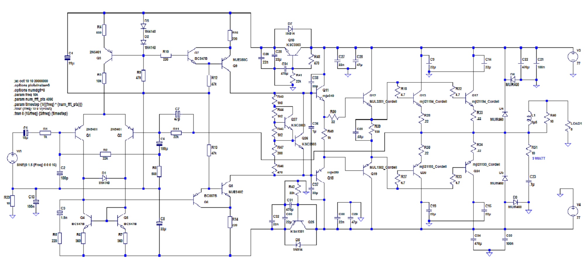

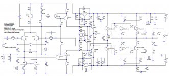

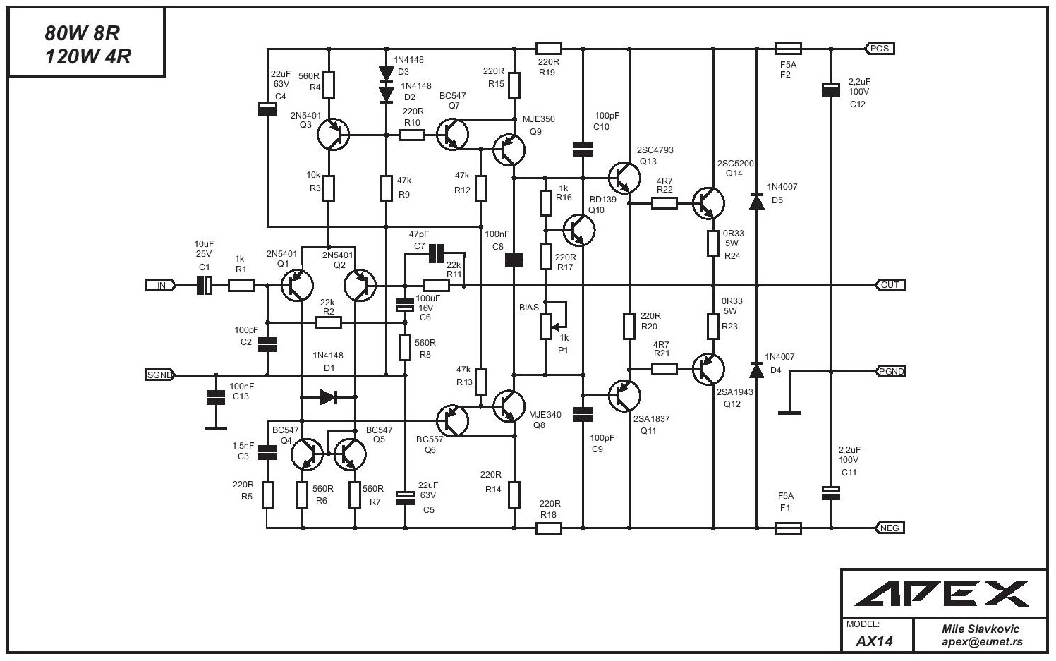

Hi Guys,
I recently built an Apex AX-14. Nice little amp. I have extra boards so I thought I would try using one for a Slewnmaster IPS. I tried loading it in spice and it seems to work but for some reason, the positive side pulls the CM down about 1.5V more than the negative rail. Maybe one of you can look it over and see if I've done it right.
Thanks, Terry

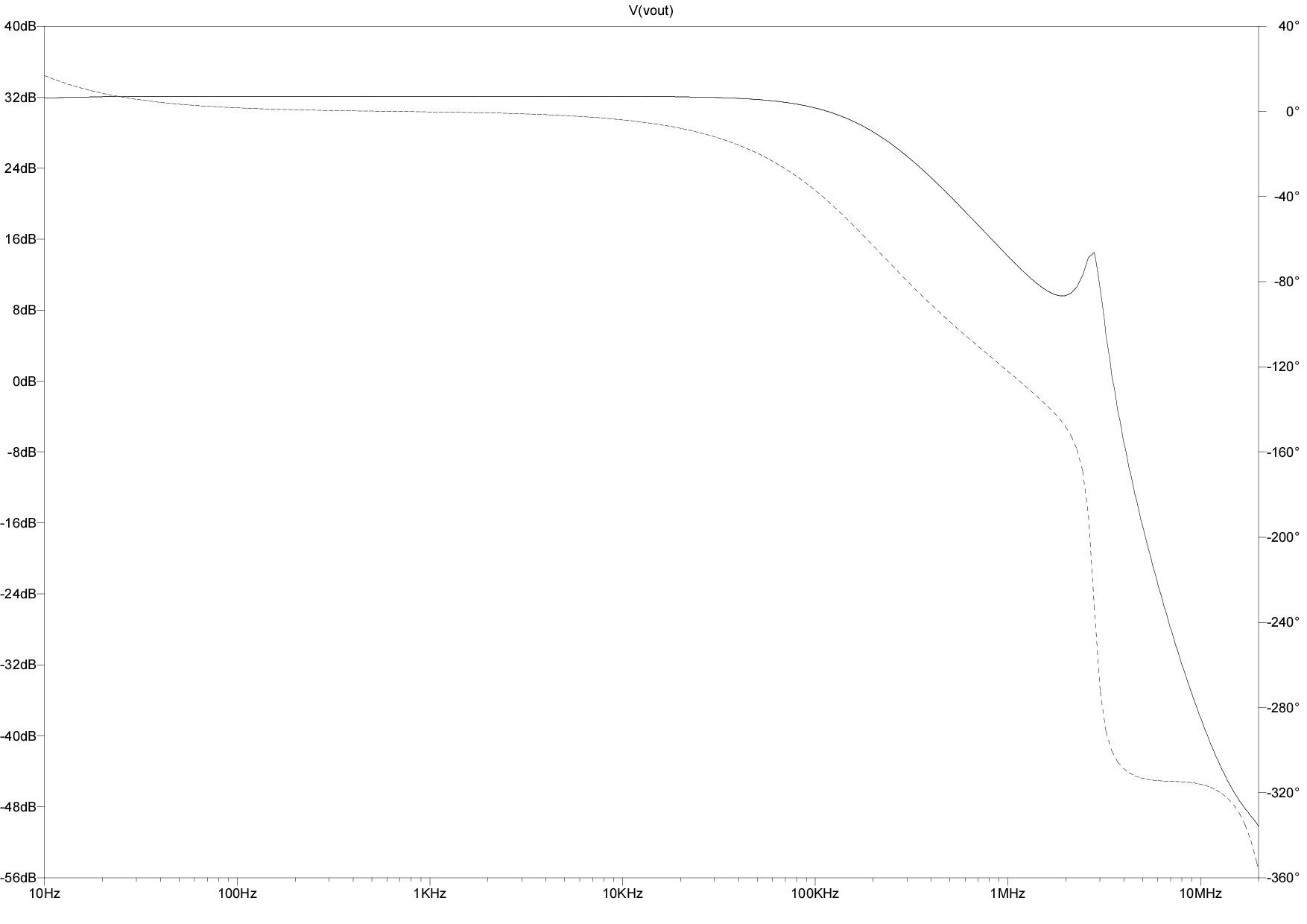

Something isn't right...
Have you taken a look at the closed loop gain plot? I get a "nice" peak here. Do you get the same? A peak suggests instability somewhere.
See attached...

No problem. 🙂
Your differing voltages are caused by a missing resistor in the lower cap multiplier.
Paul
I missed that. That fixed it. Looks like it runs OK now. Looking forward to what you find. It would be nice to know if I need to change something before I build it.

This peak is rather expected - EF3 OPS (like SlewMaster) introduces additional pole in the system, which was not the case in the original AX-14 (EF2). Mcd99uk is right - the way it is, it may cause instability and requires additional compensation. This pole will not "disappear", but may be smoothed and moved to the right and down on the curve, ensuring the unity gain level is crossed with 6 db/dec slope.
There are lots of possibilities though - original AX-14 utilizes only a lead cap in parallel with GNFB resistor (and this "minimalistic" approach to compensation is one of the beauties of it, I believe), so additional RC at IPS or VAS, and/or some Miller caps are possible cures (I can't tell anything more particular at the moment as I normally use Multisim and would need to re-draw the schematic for simulation) - I think Mcd99uk will handle it right 😉
Terry, this is not a big issue - just needs to be addressed. In overall, the setup is workable.
Valery

Thanks Guys,
I just have some empty boards right now so adding is easy. The goal here for me is to learn. I look at the schematic and looks like it is an EF2. It ties in pretty much the same as the Slewmaster. I just built the AX-14 and the SX-14 (MOSFET), inspired by you Valery. 😉 post #3342
I have already built most of the OS IPS's and your hybrid. Just seems natural now to try something else. I'll wait to start until you guys have had a chance to give it a good look.
One thing that will have to be dealt with is the fact that the AX14 is pretty high gain. Seems like the Slewmaster doesn't like that. Might have to lower that. If nothing else we can keep the thread alive while we wait for OS to return. 🙂
Blessings, Terry
