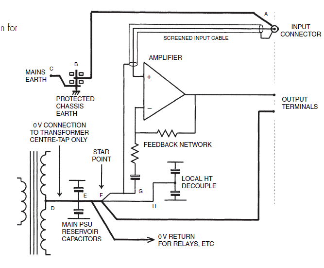

Hello
Thanks for the tips 5th, Esperado and Nikosey.
That Bonsai´s document was my first inspiration.
My initial ground layout was exactly like the link in First one thread. I´ll have to rework everything later today.

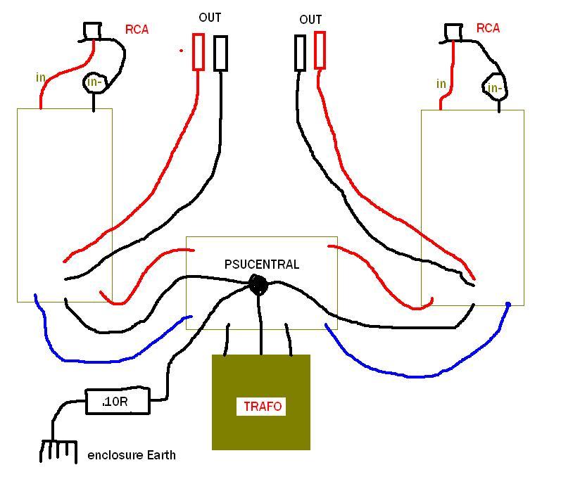

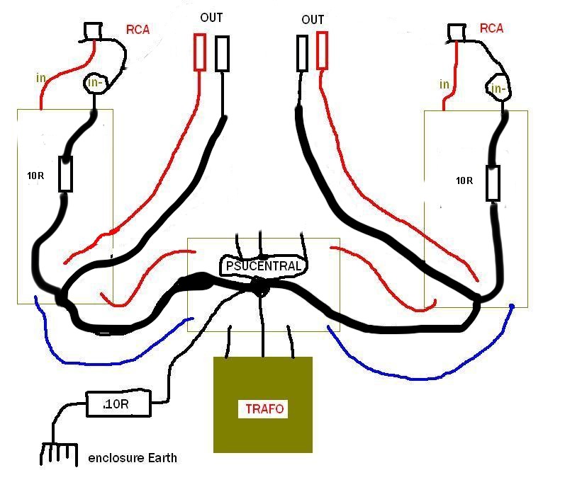

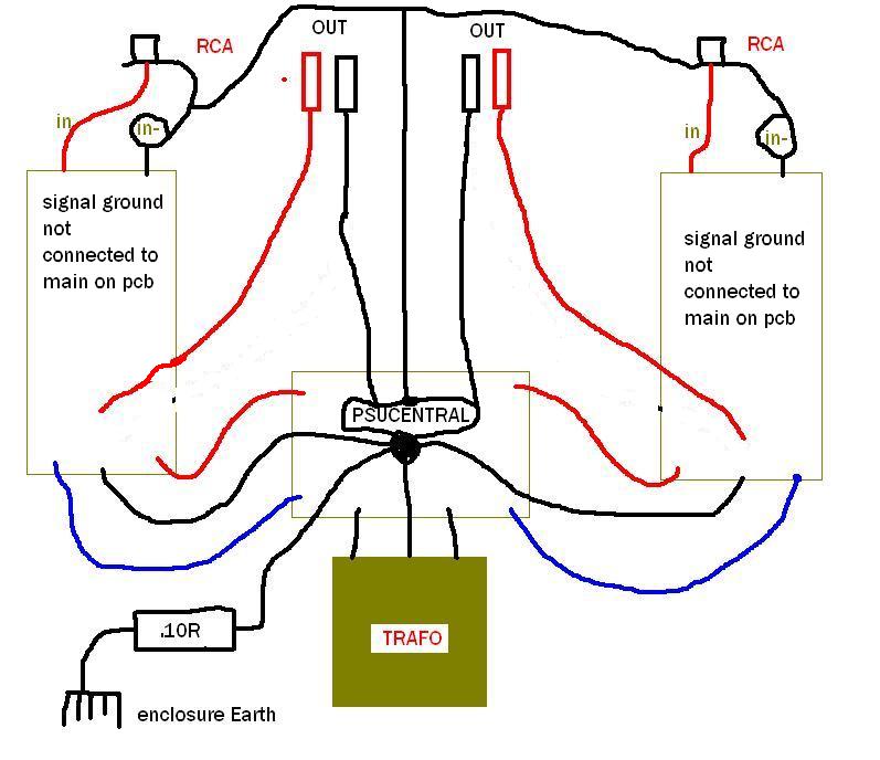

I am getting frustrated with this. I have had problems with grounding before but nothing like this.
The following attachments describe by latest tries without success.
The way I see this it is impossible to have a ground loop with proposed layouts.
My IPS boards have the signal return at the same point as input gound as BV noted few posts earlier.
Thanks for your help so far.
J

Did-you ensure one of your amps is not oscillating ?I am getting frustrated with this.
Did-you ensure all the the rails are clean enough ?
If no to the previous questions, is-it quiet when you shortcut the inputs, unconnected to other equipment ?
Still quiet if you connect just the ground between your input and the preamplifier ?
Quiet if only one side is connected to the preamplifier ?
Are-you sure your signal from preamp is hum-free ?
Don't be frustrated, there is always a solution.

There is a well written article here. I have used the loop breaker in figure 4. On one amp I needed to remove the 10R resistor to kill the hum. It uses an inexpensive 30A bridge and mounts easily to the case. It goes in place of the 10R in the above drawing.
EDIT: Something I meant to mention. Make sure that the source and amp are both plugged into the same outlet. I took me a while to realize that my work shop has two separate circuits. They must be from two separate sides of the panel because in some cases it will cause a hum if the pre and amp ate plugged into separate outlets.
Well indeed, the first arrangement is the better idea. If you have things connected like in the second one then there is no connection to ground for the input stage except through the 10R resistor when there are no cables plugged in. If the 10R resistor wasn't there the amplifier could explode. In the first example the input stage always has an excellent connection back to a clean ground.
I agree though, I cannot see where a ground loop could being created. You say the amplifiers are completely silent when the input cables are disconnected and the problem is only there when they are plugged in?
Yes, the same as if you forget any other important component or wire.. It simply must be connected, it is innevitable condition, no mistakes allowed.. And here is nothing such as "clean" ground..If the 10R resistor wasn't there the amplifier could explode..
10R resistors should decrease circulating ground currents, and so decrease voltage drop at signal cable shield non zero resistance (which is added than to signal in input as hum and noise), If you use those resistors, voltage drop at sheld resistance is divided in ratio (10R/shield resitance), if NFB ground arm is connected to input ground. Imagine ground loop, if you connect signal cable in both inputs and in signal source. And grounds for both channels are also connected at PSU star point..You disconnect input cable, ground loop is away.. 10R are needed, if you use suboptimal arrangement with common PSU for both channels and unbalanced connection form signal source to amp..
It is recomended for safety (to avoid burned 10R..) to bypass 10R resistors with two antiparalelled diodes, rated at least at 1A.

Hello Esperado and others.
Oscillation is the first suspect in this case I need to do more careful examination on this.
Rails are clean enough, very low ripple at main caps.
Even with a long rca connected shorting the inputs makes the hum go away completely.
unplugging rca wires kills the hum completely.
If I plug just rca cable into a channel the hum starts. It does not have to be connected to anything. Just a cable is enough for initiating the hum.
Preamp is hum free (Classé ssp-50).
The case earth is exactly how it is described in bonsai´s document. A resistor together with a hefty bridge rectifier.
I also tried removing the psu to chassis connection for testing purposes -> did not help
It seems that I need to take the amp into pieces once again and start from the scratch. When I tested the IPS and OPS separately I noticed nothing special.
The way BV presented the grounding was my first version.
