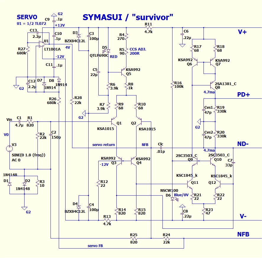

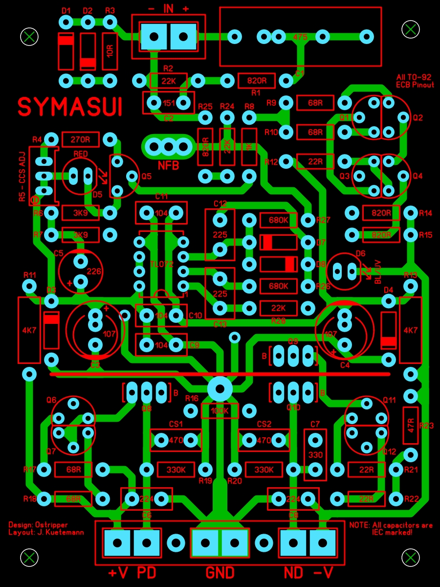

Symasui Re-draw

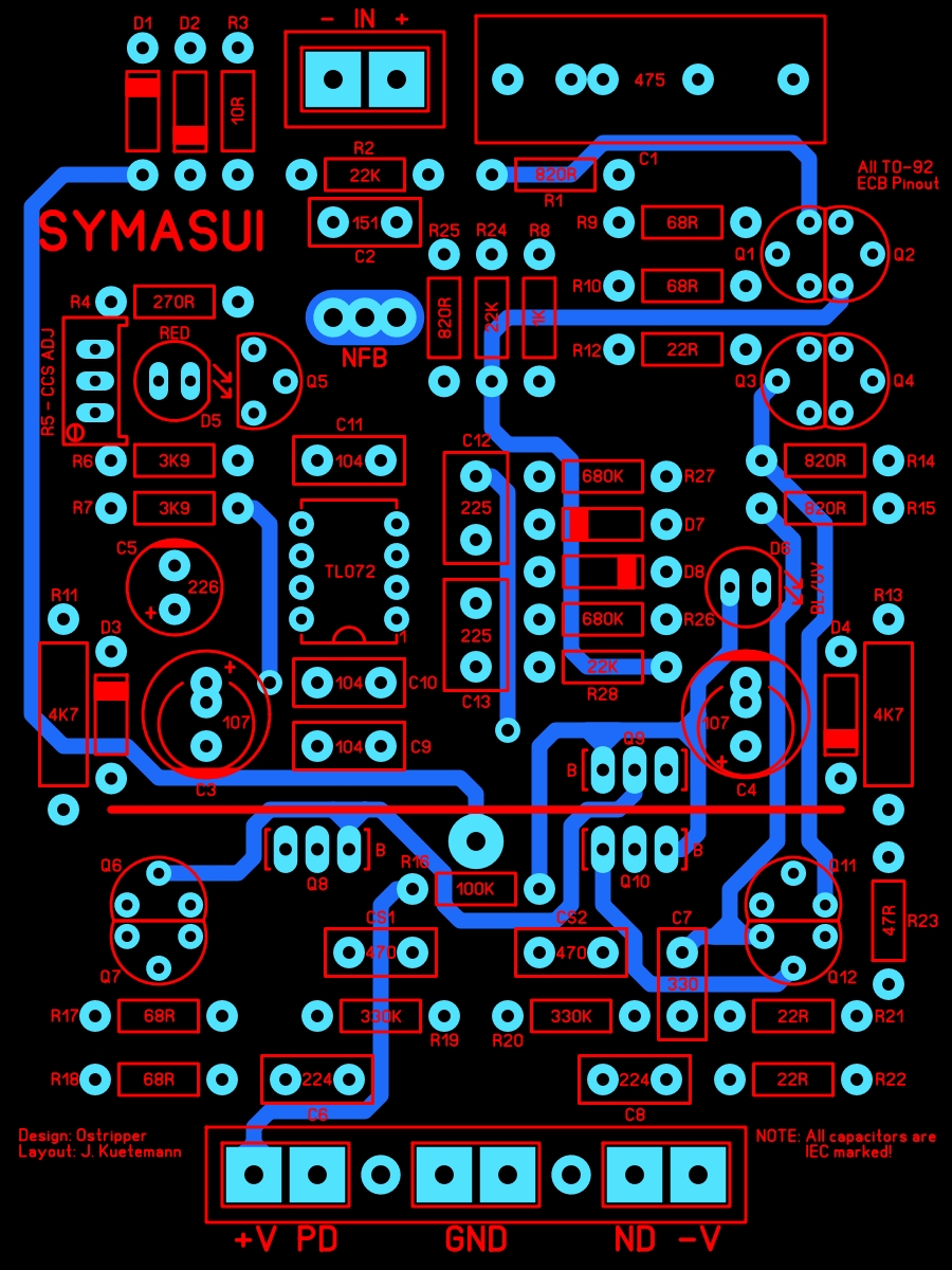

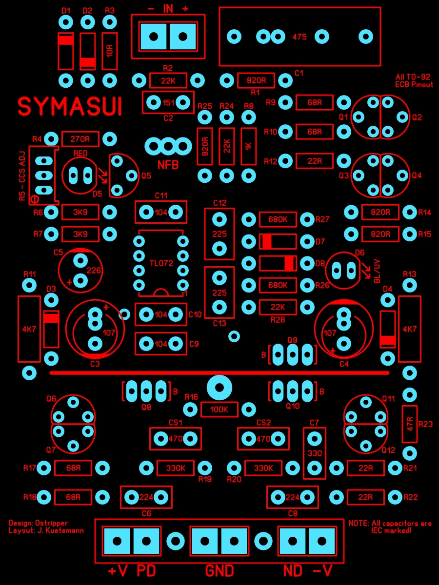

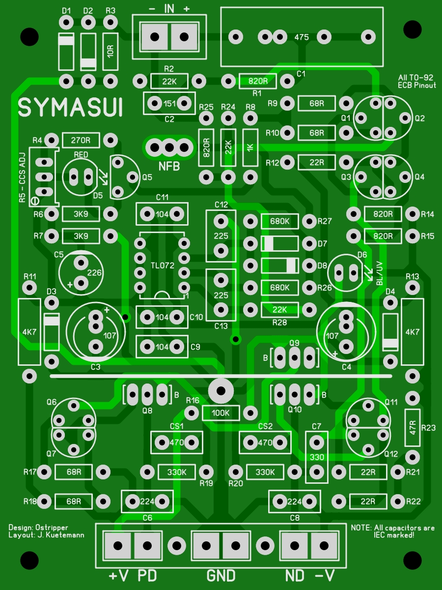

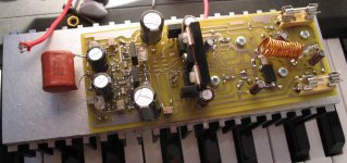

Here's my current rendition of the Symasui v1.2 board. It should be accurate but if anyone is so inclined to have a look over it to spot any potential errors that would be great. Any constructive comments / concerns welcomed.
Looks good Jason but two servo circuits and a NFB circuit, that should be fun to get everything right.
Not too sure what you mean. There is only one servo, it has two pole response. NFB of course is mandatory with the design's OLG. This is ostripper's circuit, just my spin on the PCB.

Jason,
I guess I am just not following how the servo feed and servo return are two poles? That is why you are the circuit designer and I'm not.
That is the same servo that is in the Spooky I just finished. Once everyone got me straightened out on how it works, it keeps the offset very stable.

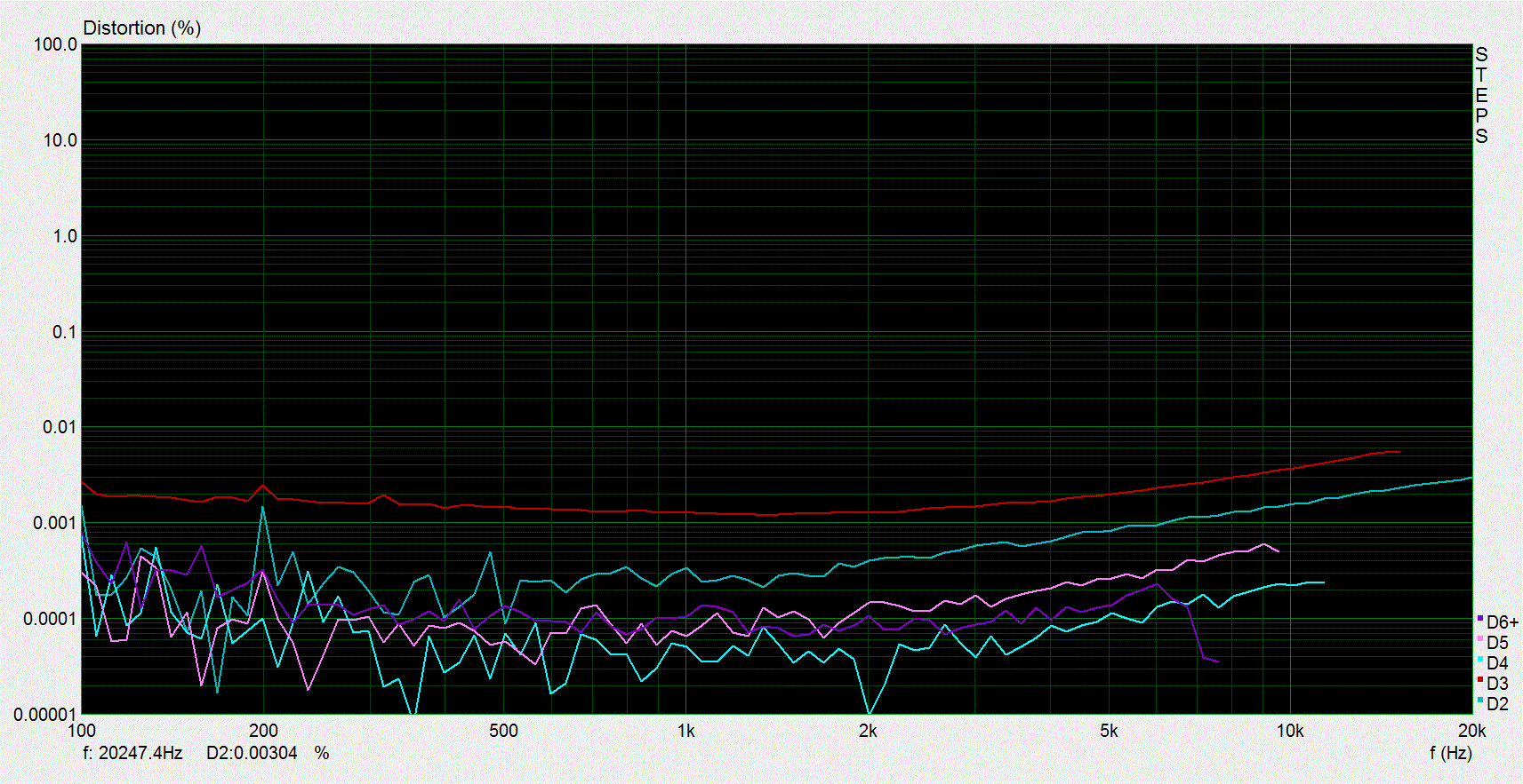

Okay so here we have the next instalment.
The CFA-XH BV2.
This is NOT the board that used the ground plane. I repeat NOT, the board that used the ground plane. That board seriously failed and suffered from TERRIBLE, I repeat TERRIBLE, induced distortion. Why this was so I don't really know as the high quality and dirty grounds were still separated. So here's your warning, do not bother with a ground plane type design for a power amplifier. It is not needed and all it does is give you a headache. If you don't have the capabilities to measure what you're doing properly then there's more reason to simply stick to what we know works.
NO GROUND PLANES!
Just so no one misses it!
This board uses LM337/317 regulation for the input stage and does not use the standard 992/1845 for the input pair either. As I posted before I had an idea to use the BC846BPN. This is a tiny little surface mount device that has both an NPN and PNP transistor combined, presumably built from the same wafer so promises to give you a good transistor match and obviously provides excellent thermal matching. NXP provide excellent simulation models for these and using them gives excellent results, better than the 992/1845s with my set up.
Once again this is the baby OPS, using two output pairs, this time 1943/5200s. The amplifiers are run from nominally ~26V supplies as I intend to use them mostly biased into class A.
First of all 2.83V RMS into 9.4 ohms optimally biased.
Pretty good, but somewhat high HD2.
Now the same as above but in class A.
If anyone wanted the proverbial straight wire with gain for the first watt, this would probably be quite close to it. 😀
As I mentioned in my previous post, measuring distortion at these kinds of levels is a trial in and of itself. I am sure that the HD2 vanishes in this case simply because biasing into class A removes any rail induction distortion. I can bring about quite dramatic changes in the distortion by moving the various wires around. Quite clearly these need to be positioned optimally to give the best results. The amplifier is currently a heatsink on board and not in any kind of case so I didn't want to mess about too much with it. This was more a proof of design before I build three more, but when put into the proper case I will take time routing the wires in a more optimal fashion.

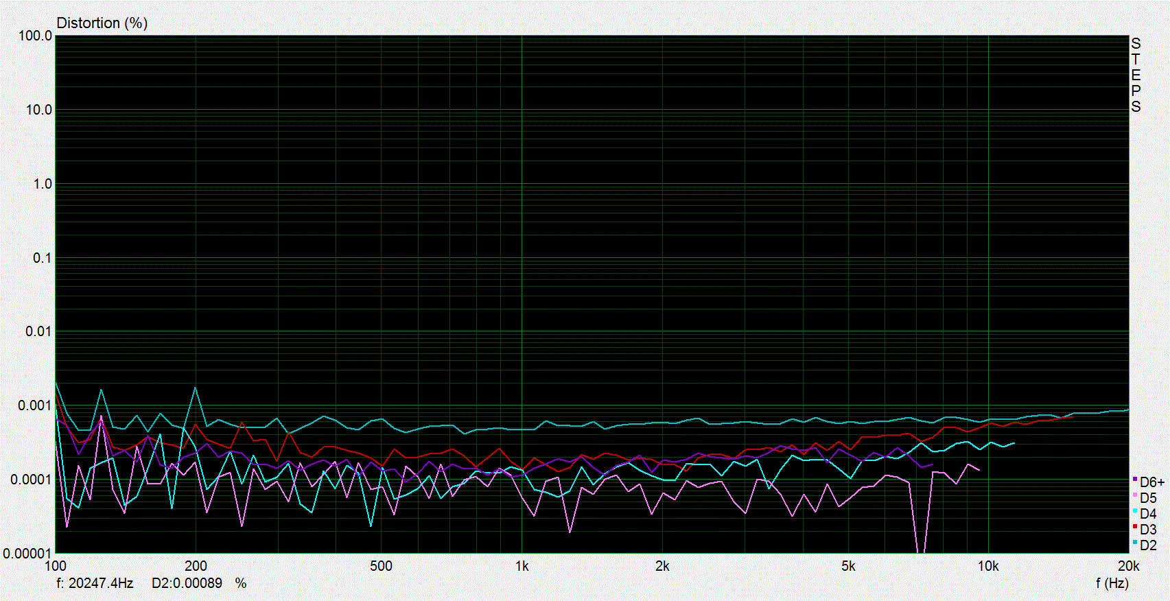

Next up is 7V RMS into the 9.4 ohm loas optimally biased.
It looks fairly similar to before.
And now in class A.
Once again, the first thing to note is that the HD2 just takes a vacation again. At an increased output power the SnR has increased and we can also see a small reduction in the magnitude of the higher order harmonics at high frequencies. This is what class A biasing is all about. We can also see the marked increase in the third order too. It's still objectively very low 0.001% @ 10k. Why this occurs I don't know, but it did it with my very first CFA-XH BV2 board also.
Still it's nothing to really lose any sleep over, it's still very low distortion.

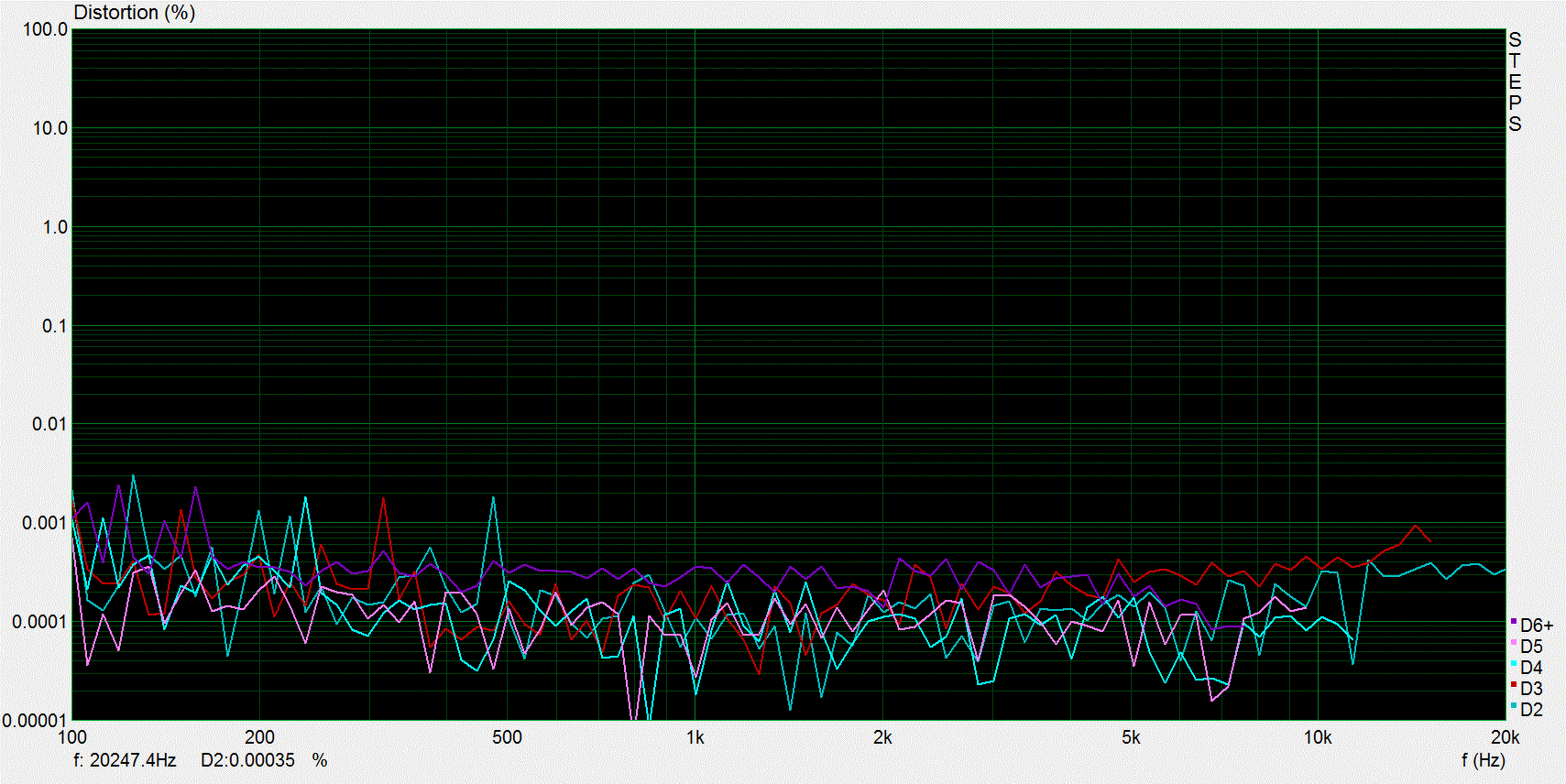

Next up is the amplifier just before clipping occurs so around 13.5V RMS optimally biased.
Here we can see that the HD3 has shot up, although absolute levels aren't excessively high.
Now into class A.
Once again HD2 drops, as do the higher harmonics, but the HD3 increases again at high frequencies.
Regardless of the amplifiers possibly odd behaviour with the third order, this version does appear to measure a little better than the previous one. Regardless of that though I am pretty pleased with how this turned out. The BC846BPN certainly works well and they cost peanuts.

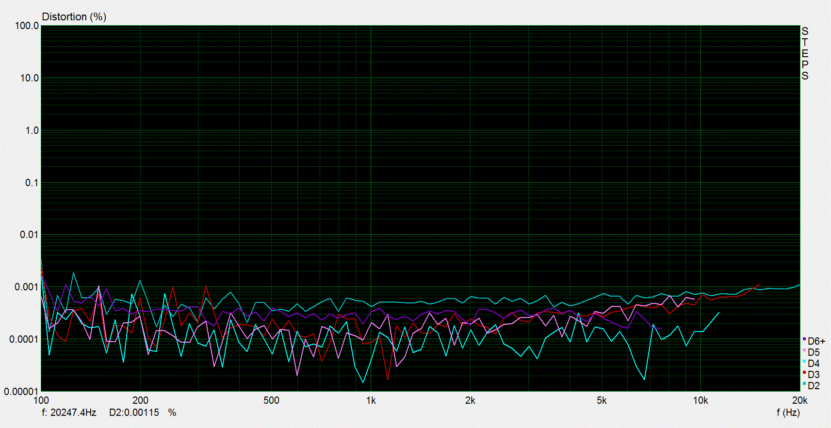

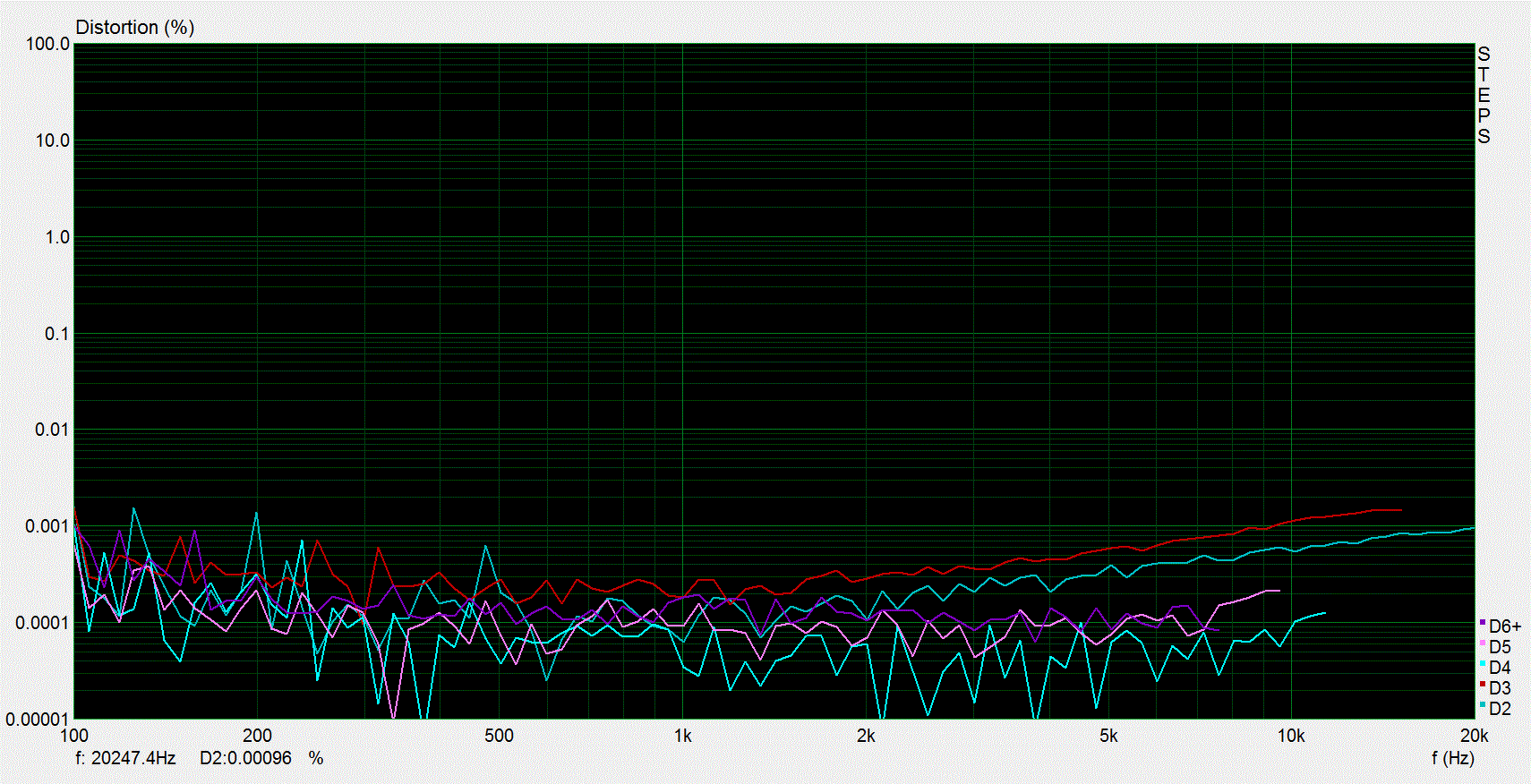

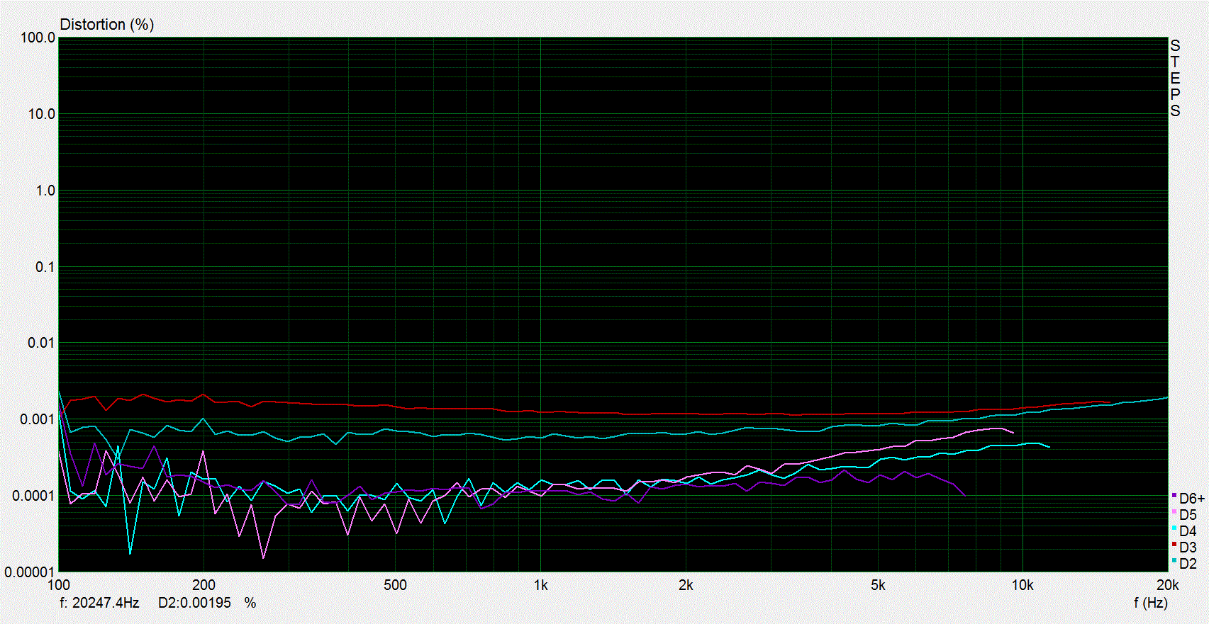

The CFA-XH BV2.
And now in class A.
Now into class A.
One thing I will mention again is just how sensitive this design is to getting the bias level spot on. If you under bias it a little, distortion, and most importantly, higher order distortion, shoots way up. If you over bias it the exact same thing happens too, but not as badly. When you reach class A all the over biasing nasties suddenly vanish.
This is mainly a comment towards thimios. I know you had some 'differences' in sound quality of what this amp did not and the others did. It might be worth trying this amplifier again, but before listening adjust the bias first with the amp connected to the FFT on the computer. I know your hardware isn't as capable as mine, but you should still be able to arrive at a more optimal bias setting I think, even with what you've got.
You are definitely better off over biasing the amplifier slightly though, than under biasing. Under biasing is a disaster and you lose anything and everything that the amplifier is capable of and all you'd be listening to is output stage nasties instead of what the input stage might be able to do.
I didn't give a subjective impression of the Wolverine simply because it's operating from only 50Hz-300Hz with multiple subs operating from 20Hz up to 100Hz over the top of that too. Whatever it's doing it's doing it well, but it's not the kind of thing you can get particularly excited or articulate about. The quad of CFA-XH BV2s will be used from 300Hz to 20kHz, so I will be certain to say something about that.
