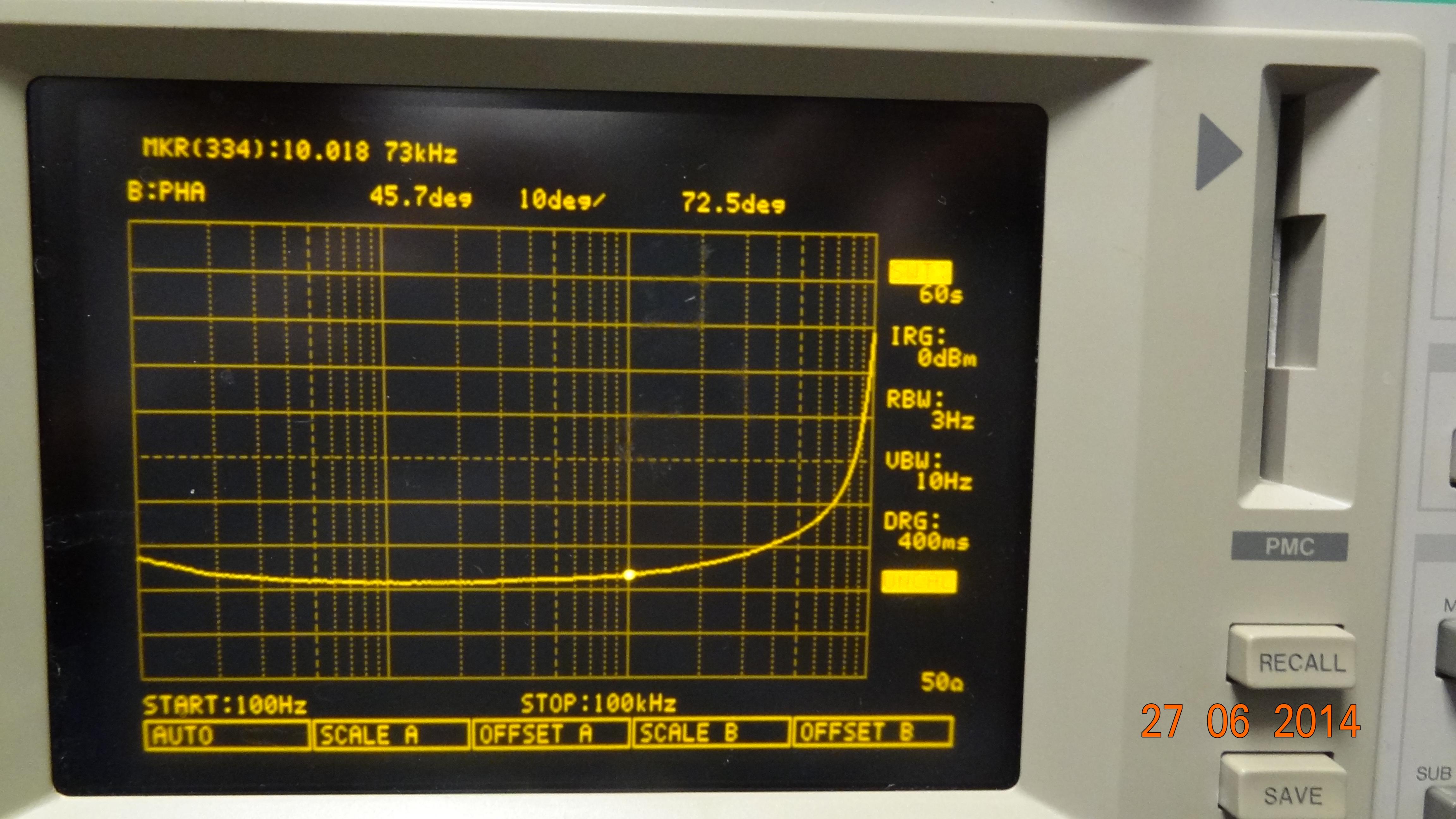

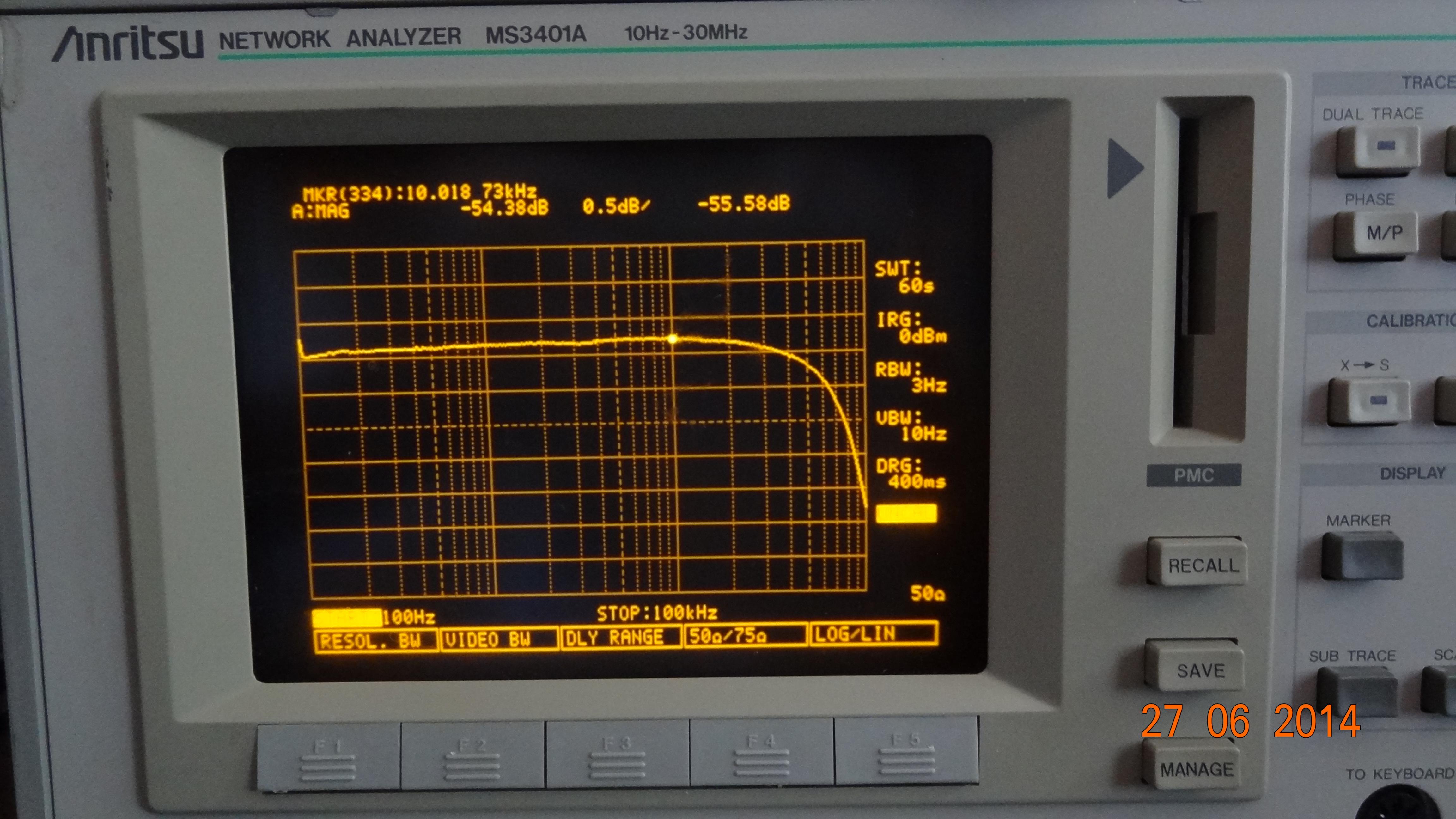

A short diversion..... what is the band-width of a wire? Well it all depends;
In an actual build of an amp, the wiring can play havoc with the stability of the design... even if in SIM, you get it very stable.
Without comment... here is a pair of parallel pcb wires over a ground plane. The wires are 1cm wide and 20cm long. they are side by side closely spaced. the ground plan is a few mil thickness from the strip wires.

_______________A short diversion..... what is the band-width of a wire? Well it all depends;
[it's one of the contributing reasons we need to place a big Cap locally or directly at the amp stage... ie OPS]
