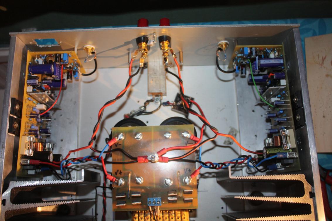

Hello,
I encountered a weird problem when assembling the amplifier into the case (cfa-x + baby ops). In the beginning everything went fine but when I connect rca cables into the input I get 25mV 50hz hum. When nothing is connected to the input or the input wires are very short (say 20cm) the amp is completely silent with 0.8mV ac at the output.
I have checked the grounding scheme about a dozen times and it should be correct and I am assuming the the origin of hum is somewhere else.
It seems that the cable is somehow collecting noise but I do not understand how this can happen. I have moved the amp away from assumingly noisy environment, tried to move the wires around, use different cables etc.
When I touch the amp case eith my finger the amount of hum is about halved.
I have no further ideas what to do.
Does anyone have any idea what is going on?

Obviously not. Ground loop, at evidence.I have checked the grounding scheme ...
Can-you publish your cabling schematic (with power supply and AC+audio) ?
Hello Esperado.
Please find the attached picture.
both PCB grounds and speaker grounds lead to single point in the middle of the supply caps except the rca ground which is connected to the signal ground at the ips board.
The trafo is center tap model. The ct is connected to the main star.
The main star is connected to the case through a ground lifter consisting of a bridge rectifier and 10 ohm resistor.
Too lazy to draw an illustration. I hope that the pic is clear enough.

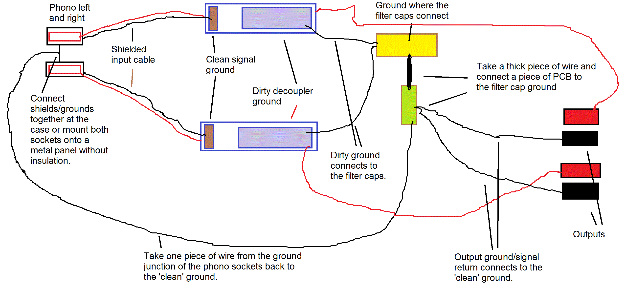

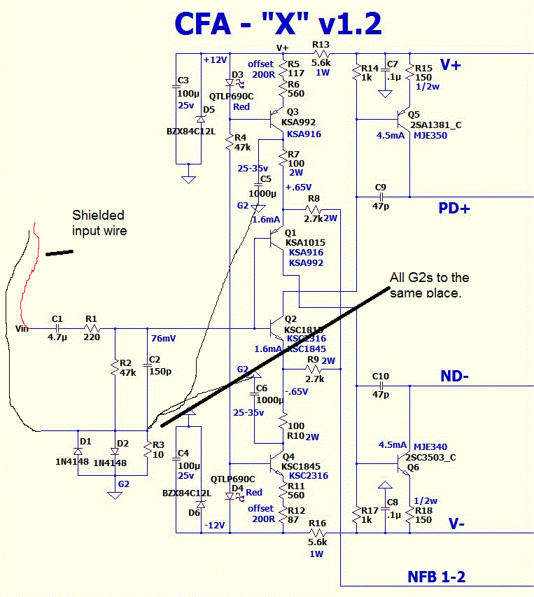

Mistake common to nearly all IPS schematics I saw here is feedback resistor (ground arm)connected to power ground ..It should be connected to input signal ground, to the same point as input bias resistor and input ground from signal source.
I just looked through the IPS schematics that I have from this thread and I don't see where you changed anything in regards to the ground in the IPS that you published. Would you please post a schematic showing what you are referring to?
I haven't had a problem with any of the ones I've built so far. CFA 3 versions, Spooky and Wolverine.
Thanks, Terry
This is how you need to wire up an amp internally to kill internal and externally created ground loops. The high quality and dirty grounds should not be connected on the PCB at any point. Wired up as shown you do not need the 10R isolation resistor on the input stage either. Simply connect all G2 points to the same place and connected the shielded input wire to it as shown.

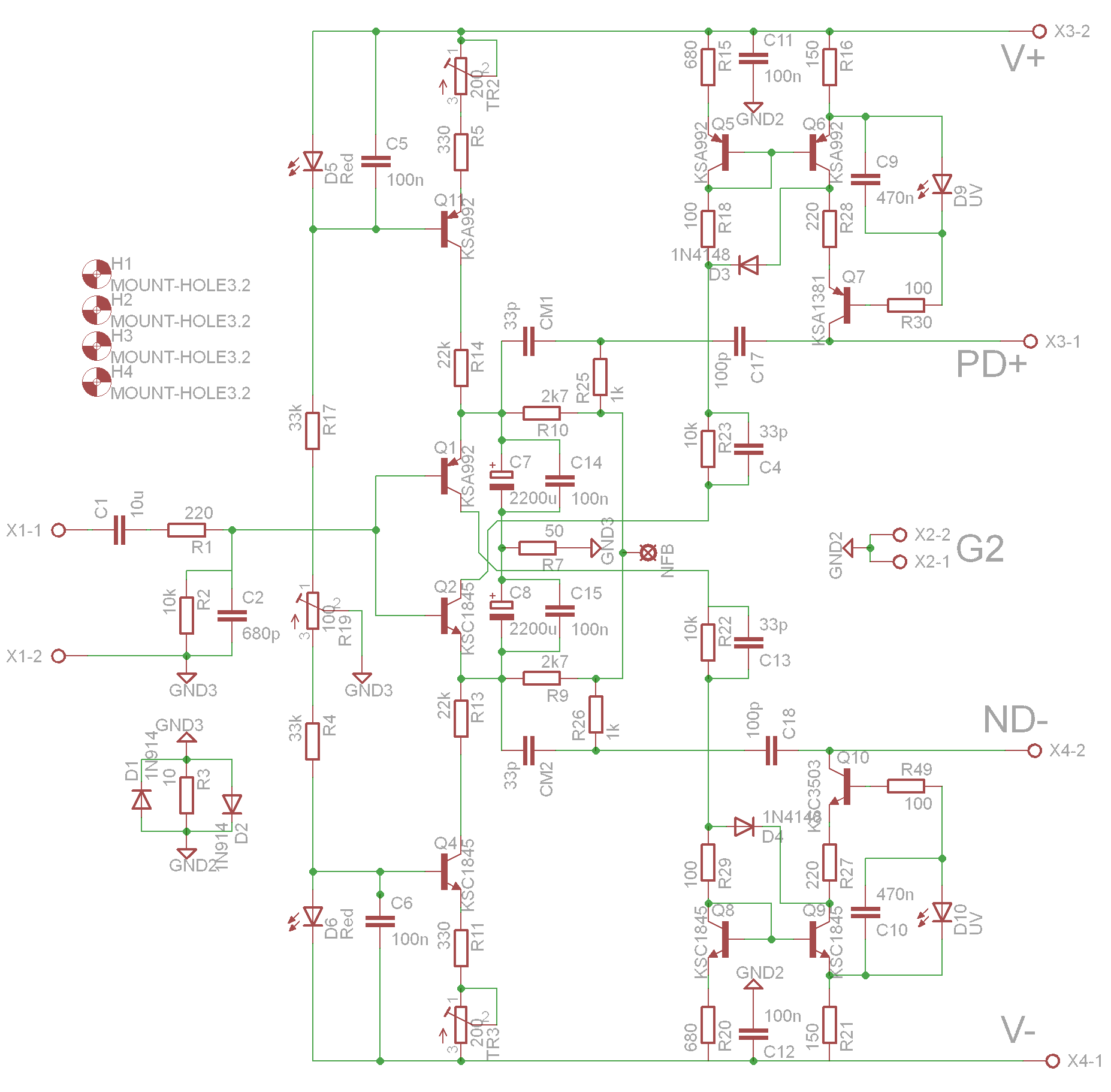

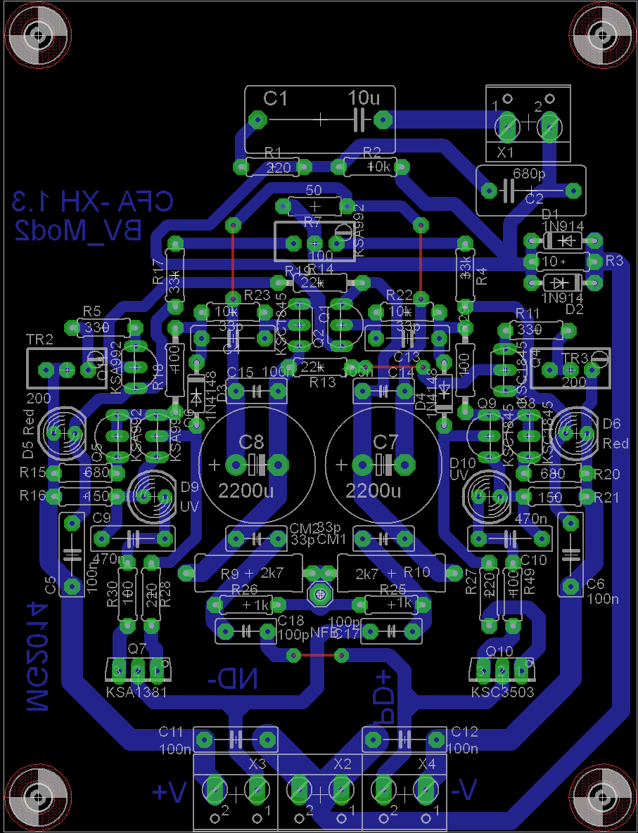

Some progress under eagle : as i didn't found CFA-XH 1.3 IPS in BV mod2 i decided to transfert schematic under eagle and do routing job. See under...if you have advise feel aware and post...

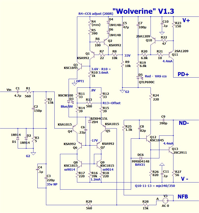

The ratio of R28 and R29 sets the gain. Check the values and adjust R29 if needed. R2 and R28 should be the same to help achieve low DC offset.

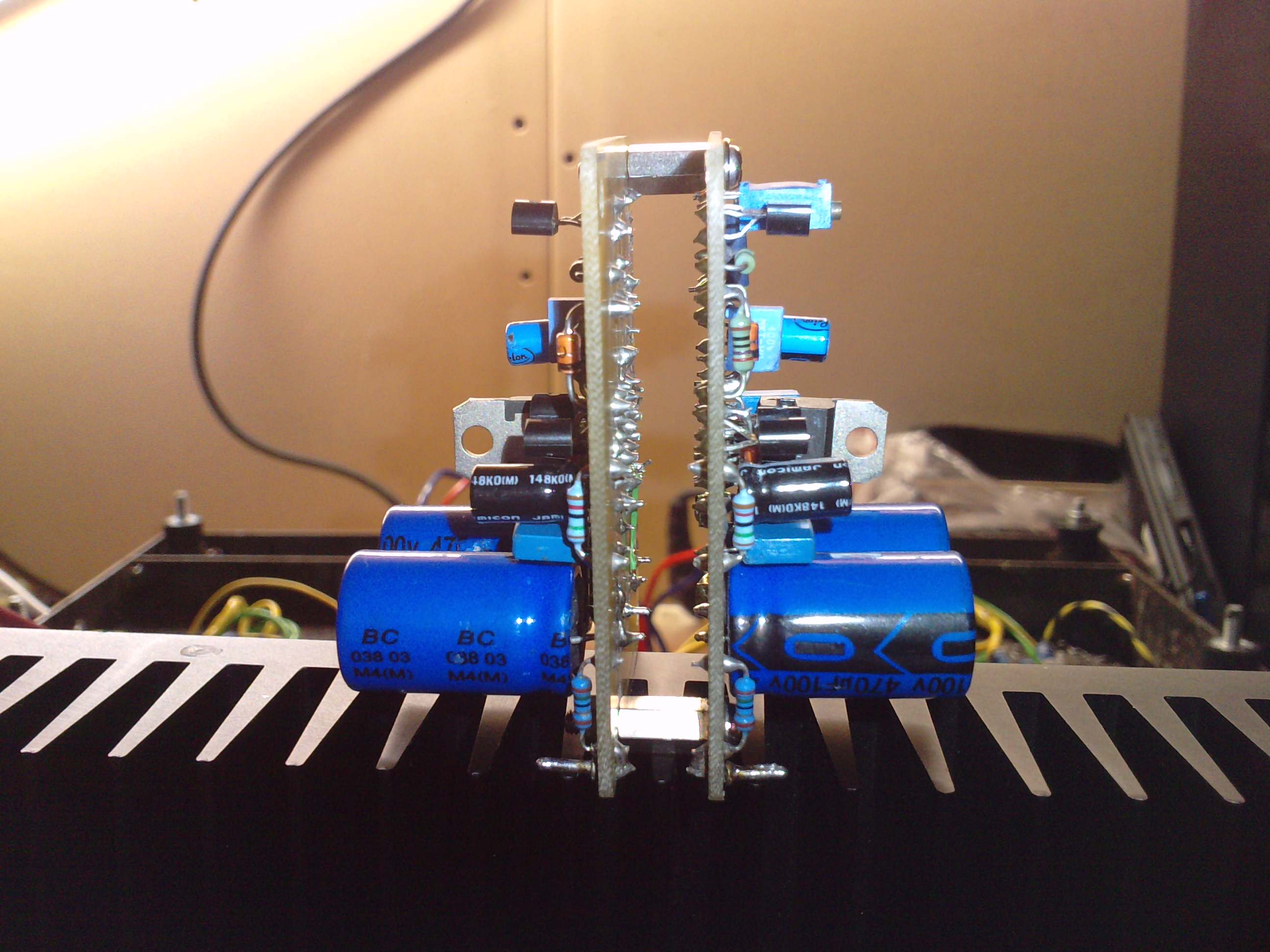

I think separate transformers for input and for drive/ outputstage is good idea even
and low impedance regulators for input stages perhaps type of shunt regulators.

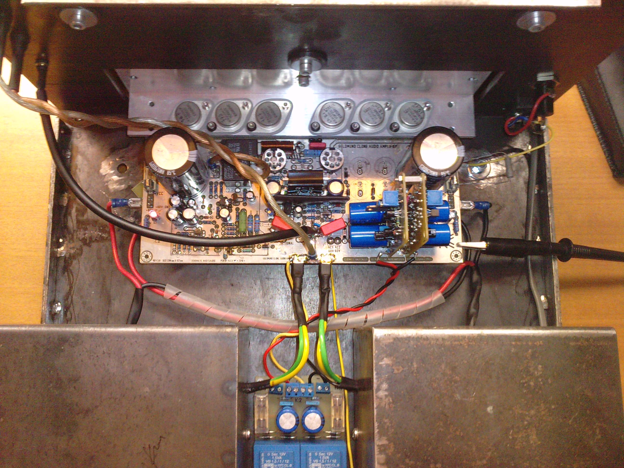

My front end supply.
Not really.Too lazy to draw an illustration. I hope that the pic is clear enough.
Thanks Jason. That worked. serves me right for only building one side first. I had too many schematics. One had 15k for R25 and the other had 22k. Switched to 15k in both and now all is good.
