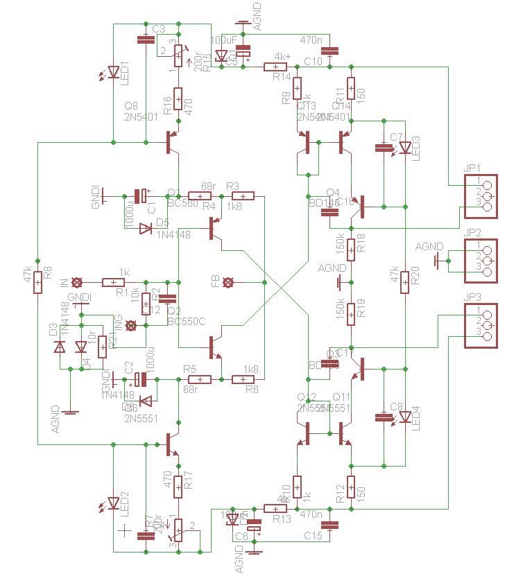

Attached schema and layout to clarify the situation. The safety diodes in parallel with feedback caps are not installed on the pcb.

You can try this:
- Plug your cable in the inputs.
- Remove C12.
- Tune C1 & C18 to have no oscillation and a flat bandwidth at HF (no peak in the response curve).
- Plug-in a square wave generator @ 50Khz to your cable.
- Replace C12 and tune it to have no peak in the square waves.
This will be you minimal C12 value, that you can increase for best listening results.

Esperado,
Great advice, unfortunately I have seen many amps tuned with the input lpf in place but it should be stable without the input filter. The lpf should only be used to prevent the amplifier from slew Induced issues.

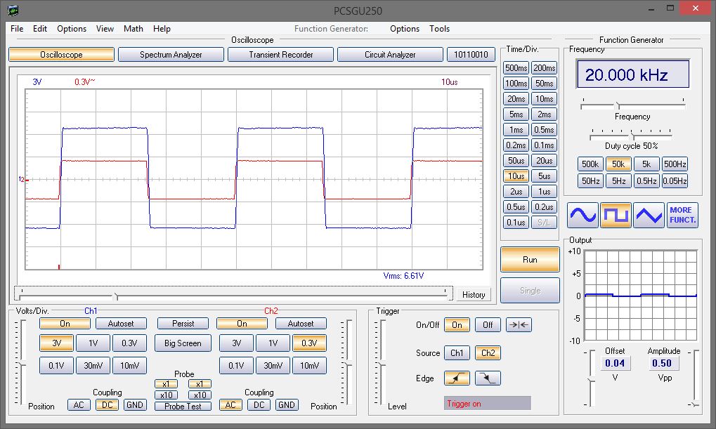

I don't like the way my sound card (e-mu 1616m) forms the square wave - by some reason I always see some "ringing" right at the output of the card. I'm afraid, julia may have the same issue, though I don't know for sure.

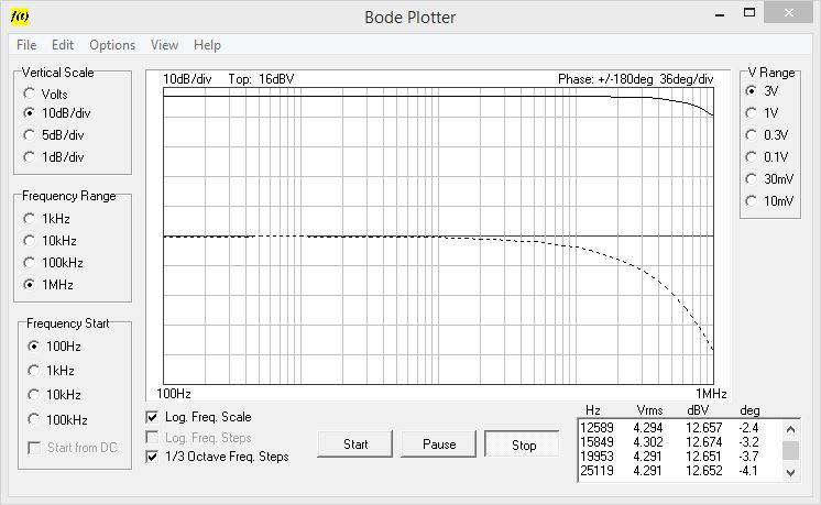

I use a USB-PC SCOPE + GENERATOR (2CH.) Velleman PCSGU250 as a function generator - this one forms a pretty good square vave and rather versatile tool in general - for example, it can create Bode plots automatically, showing both amplitude and phase responses at one plot (see attached examples).
Valery

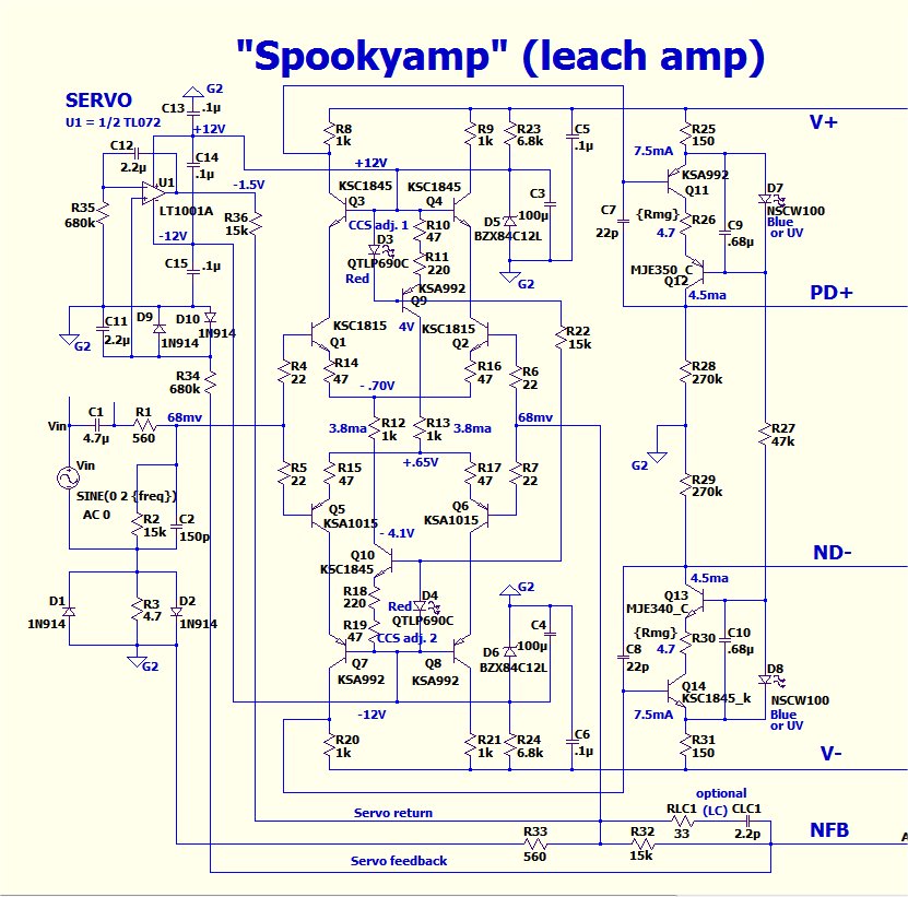

I was playing the Slewmonster today with the Spooky IPS ad I noticed that the heatsink on the VAS of the IPS is running pretty hot. I can hold onto it but it is hot. Where should I measure to make sure the bias on the IPS is set properly? Which resistors do I measure and what voltage should I be looking for.
Thanks, Terry
Thanks, Terry
Terry, measure the voltage over R25 (voltage over R31 will be the same or very close to it - you can check).
The current will be ([voltage over R25] / R25). It has to be 7.5mA, as per OS's design.
Out of these 7.5 mA, 3mA go to the LEDs and 4.5mA go to VAS.
Current through the LEDs ir relatively constant (3mA), so you can always calculate the VAS current as ([current through R25] - 3mA).
In fact, transistors getting hot are cascodes Q12, Q13.
Valery

Hi Valery,
Thanks for the detailed explanation. That is exactly what I did so I guess the VAS is just meant to run that hot. I measured R26 and it figured at 4.5mA so I guess it's right. Q12 & Q13 just seem a little too hot. The amp actually plays beautifully.
Thanks again, Terry
