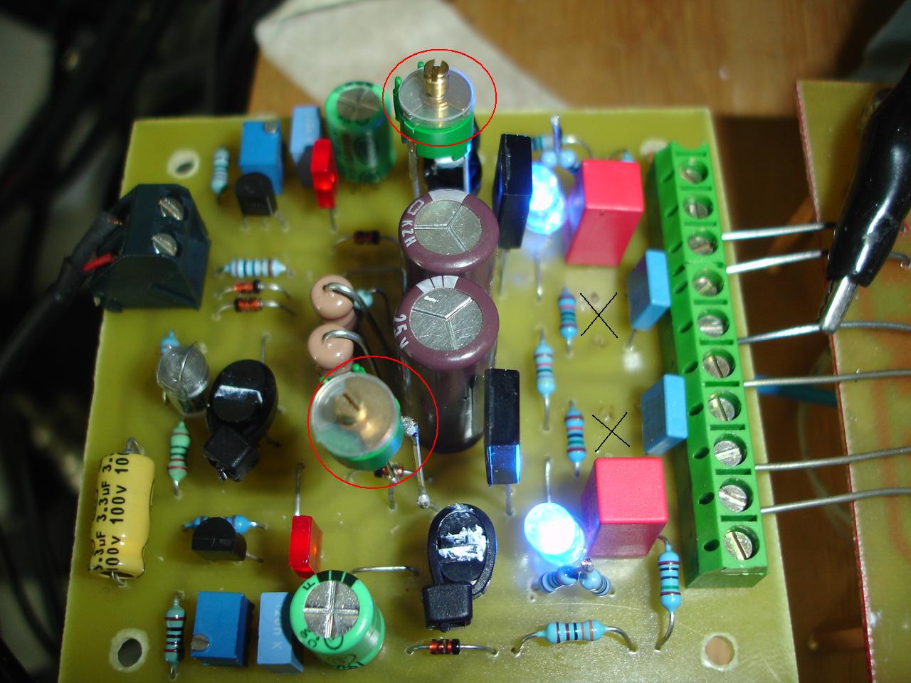

I got the JTK-CFA IPS working today. I tried the values in the schematic from post #2110. The lowest I could get the output was 8.1 mA. Something else needs to be changed as well to get to 4.5mA. I just changed back to the values Jason gave me and all is well. The 100R in R113 works. The heatsink is about as hot as I would expect. Probably want to go to 150R if you are using a thin sheet of aluminum.
I played it for a couple hours today. It sounds really good, especially considering it is an IPS that was designed to feed a couple MOSFETs.
Blessings, Terry

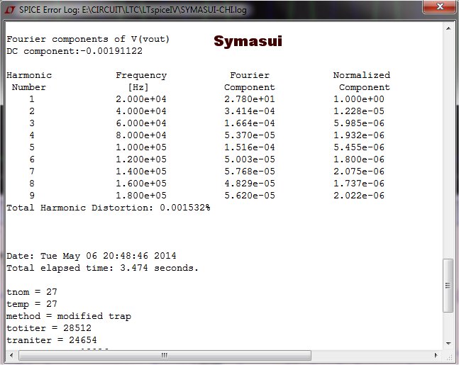

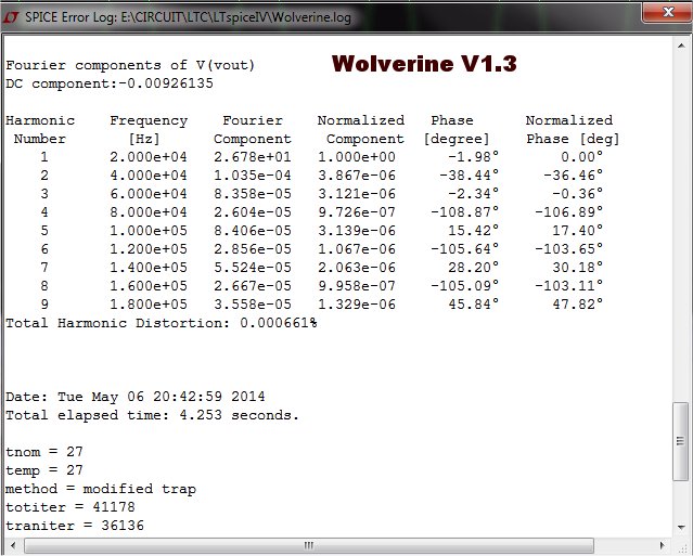

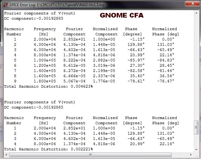

Present summary/"shootout"
I've changed and refined most of the original
amp designs (since the start of the thread).
The top 5 are ... (THD wise - below 1-5)
1-Wolverine
2-Spooky leach
3-Symasui
4-CFA-XH
5-Gnome
The fastest are...(slew)
1-CFA-XH
2-Gnome
3-Spooky ... the only VFA to even come close to CFA :D .
The cheapest .... $$$ :D
CFA-XH - @ 10-12$
The other 4 are <20$ IPS's.
These are the 5 final SOTA IPS's , the designs are about
as good as their topologies allow.
Of course , we could make a 40 device "instrumentation amp " ...
but would it be built. :confused:
OS

The final VAS current on jason's board has 3 variables.
1- the VAS Re's
2- The resistors from base to rail on these devices, (R5/6) in the post.
3- the IP current. Jason's 500R VR1/3 need to go a little higher to get
<1.7ma at the IP pair. 1K trimmers would give you a range of .5ma -
(infinity - too much).
PS- I use a fixed resistor in series with the trimmer for safety and a limited
range of 3- 7ma VAS ! (470 -670R at CCS)
You should be able to get ANY VAS current with these changes.
