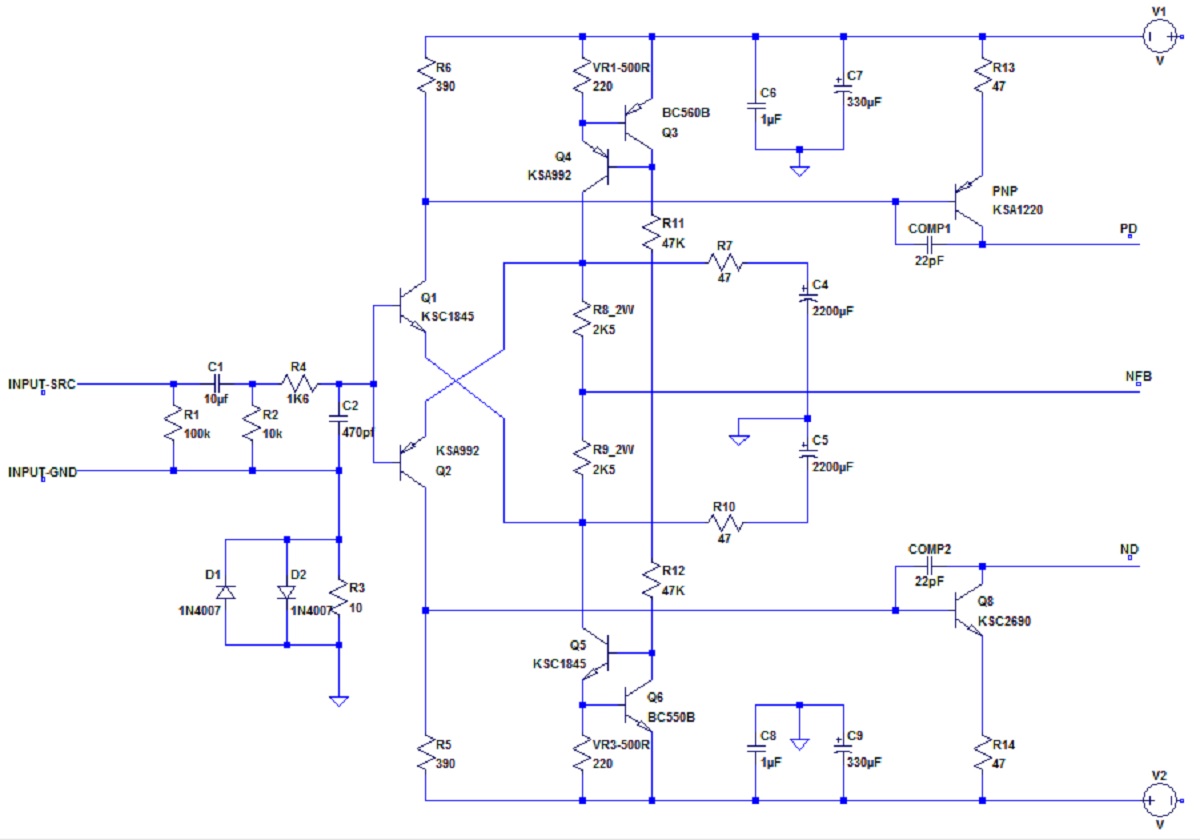

The final VAS current on jason's board has 3 variables.
1- the VAS Re's
2- The resistors from base to rail on these devices, (R5/6) in the post.
3- the IP current. Jason's 500R VR1/3 need to go a little higher to get
<1.7ma at the IP pair. 1K trimmers would give you a range of .5ma -
(infinity - too much).
PS- I use a fixed resistor in series with the trimmer for safety and a limited
range of 3- 7ma VAS ! (470 -670R at CCS)
You should be able to get ANY VAS current with these changes.
OS
Hmmm, not sure what I did wrong then. I tried adjusting both pots to their full extent and the lowest I could get was 1.2V across the 150R resistor. If I'm doing the math right that's 8mA. what is the problem with using the 47R/390R combination?
Thanks, Terry
I doubt there is anything wrong with the values I suggested, they just aren't the same as those suggest by OS. I think he was trying to get the VSSA patchwork IPS to be closer in configuration the the official CFA-X (v1.2). I think OS is suggesting to run a little less current in the input pair and degenerate the VAS a little more. I can't say how much of a difference those changes would make as far as actual performance goes.
Having the greatest range for the CCS's is the major variable.

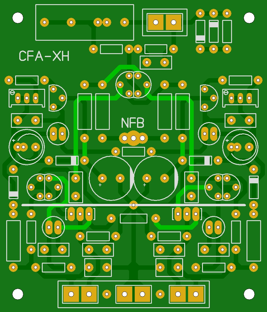

Thimios.

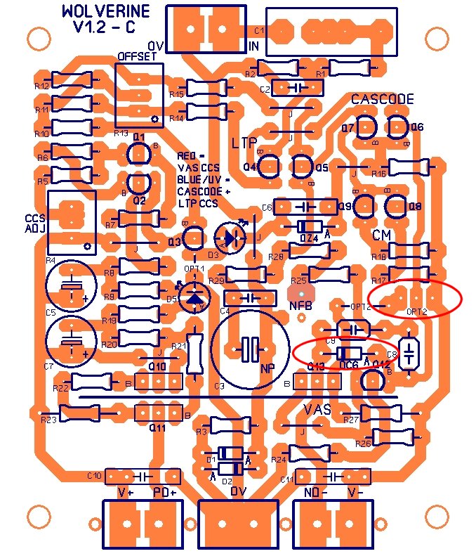

CFA-XH (v1.3) Redraw Progress
A quick snapshot of where I'm at with the CFA-XH IPS. I have not yet decided how to connect the star to the input ground lift components, it is currently absent. Some minor pushing and pulling, but leaving more room in some areas makes my art 3"x3.5", so a little bigger than OS's.

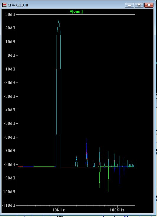

A generalized plot of what happens.
3 factors will affect harmonics.
-OPS bias
-Compensation capacitor value
-resistor loading of VAS
Last 2 also effect slew rate.
This effect might be interpreted as "sizzle" 😀 .
This is also (one of the factors) what makes tube amps/SS amps different ,
or what separates a good amp from a outstanding amp. 🙂
OS
Where are the schematics for the 1.3 versions or did I miss something? The first post of the thread links to v1.2 for the cxa and wolverine.
Hi look here.http://www.diyaudio.com/forums/solid-state/248105-slewmaster-cfa-vs-vfa-rumble-204.htmlWhere are the schematics for the 1.3 versions or did I miss something? The first post of the thread links to v1.2 for the cxa and wolverine.
Post#2034 is a zip file.

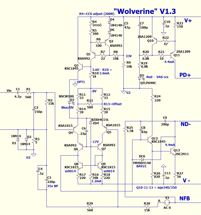

I looked , 1.2 -1.3 are the same. I might of tweaked a resistor value
or two. PCB is identical.
(schema below) 🙂
Edit - I did update the PCB (either will perform identical).
below 2/3 - allows diode or active transistor saturation clamp.
If you are using 1.2 - It is still SOTA !!

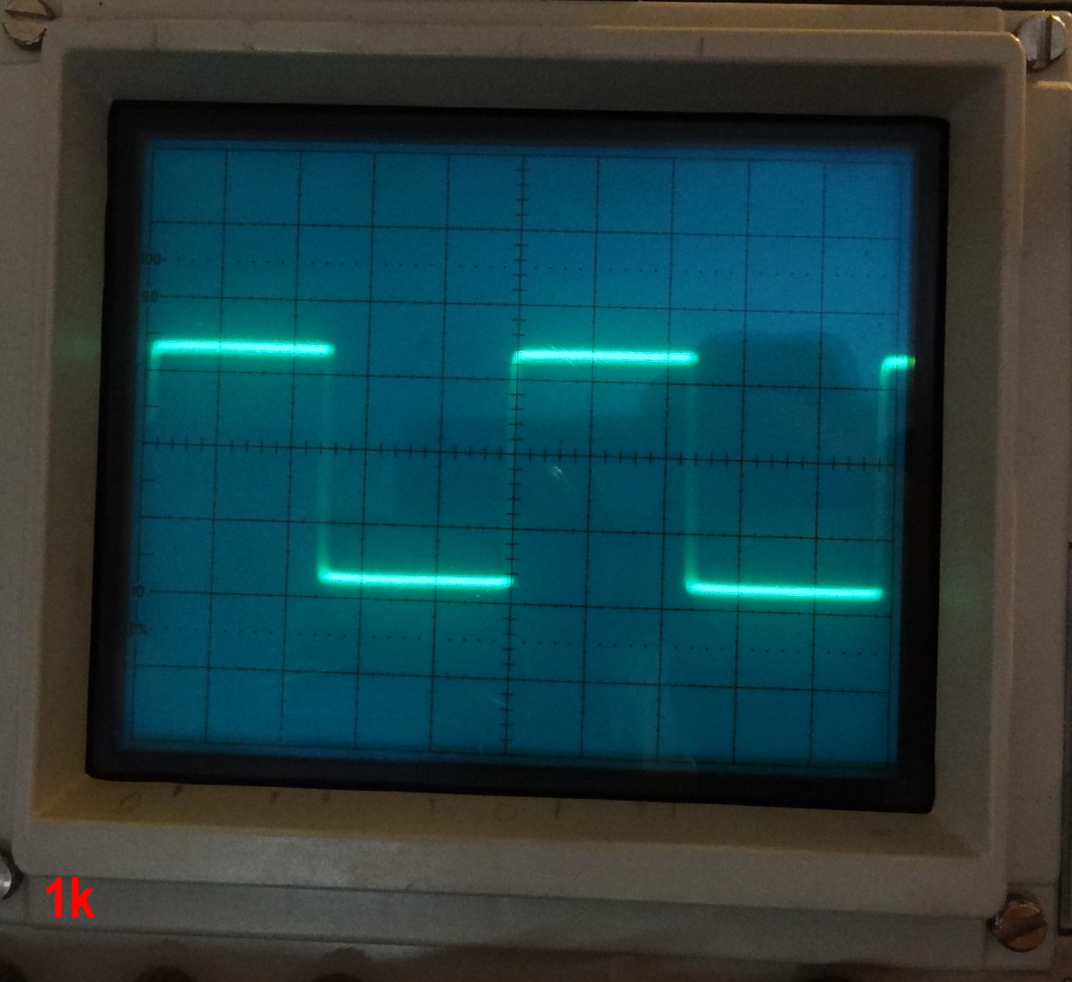

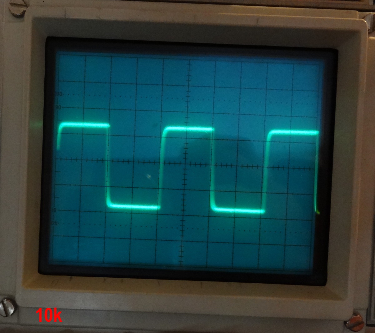

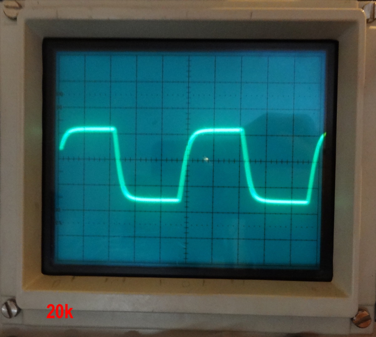

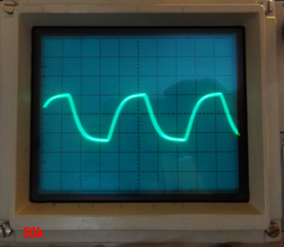

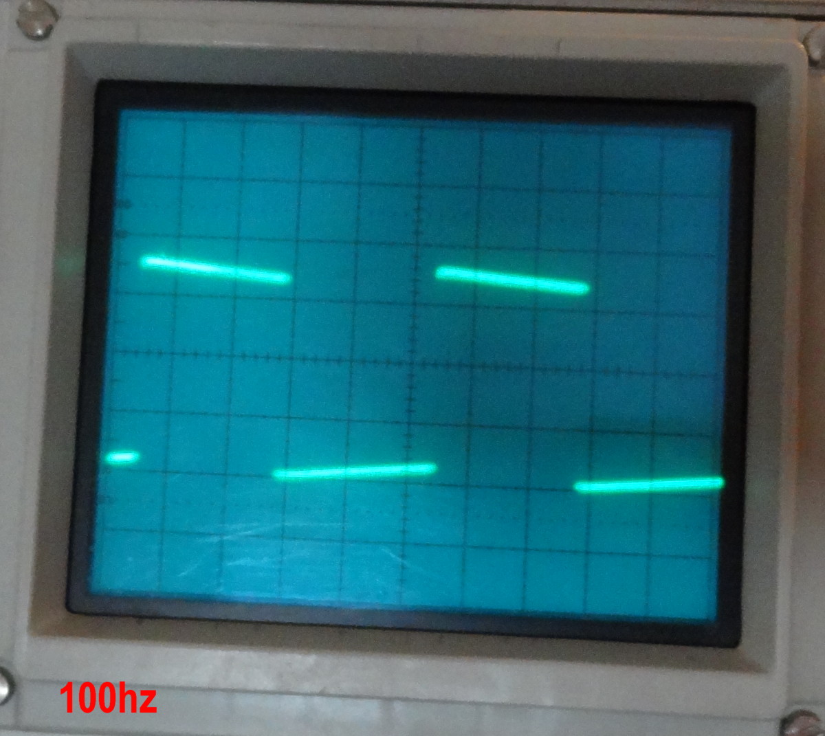

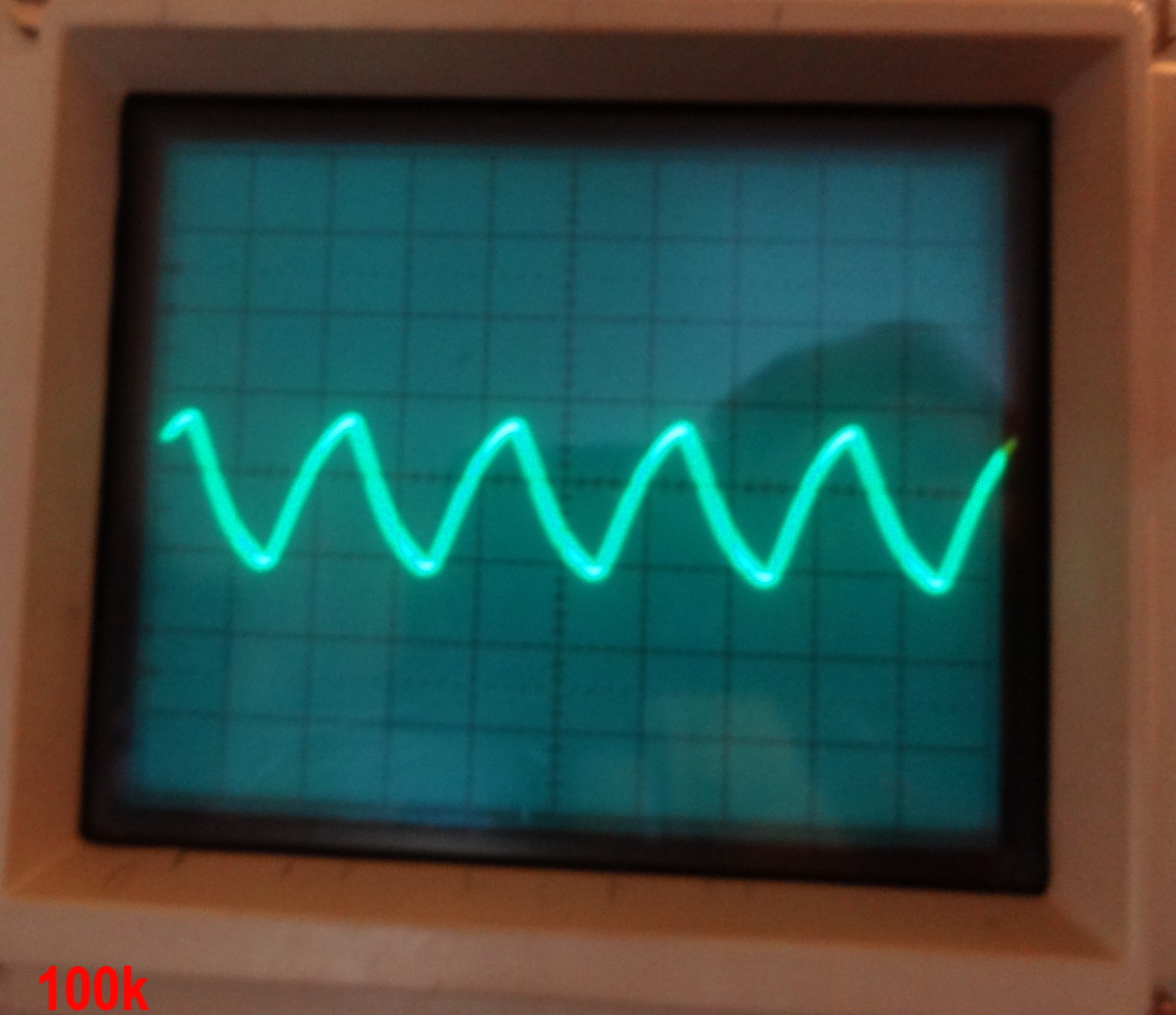

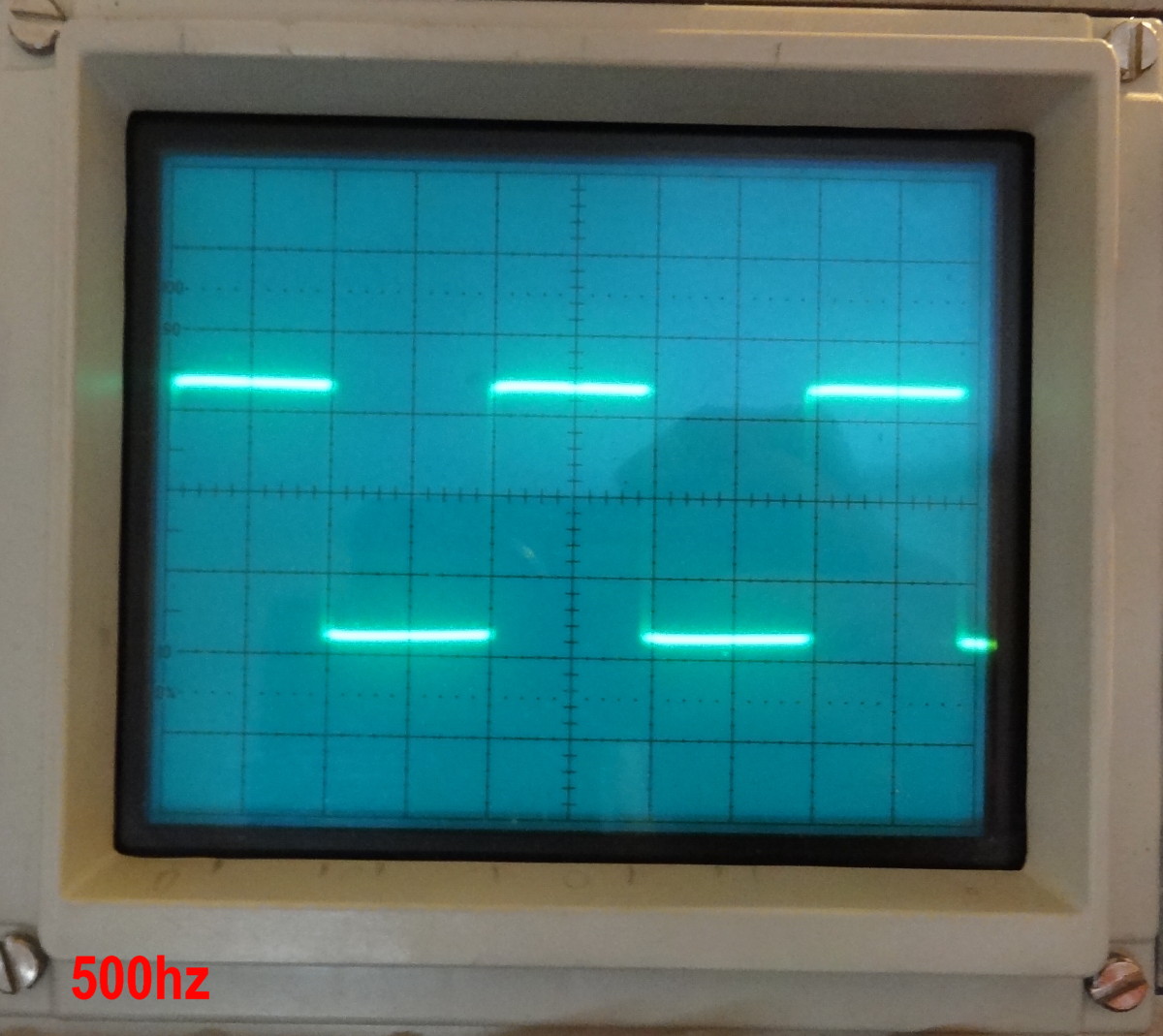

OK, I hooked up the scope and am attaching some pictures. These are all square waves with an 300W, 8ohm dummy load attached. Please take a look and give me some advice as to what, if anything should be changed.
Thanks, Terry
Thanks, Terry
What is the output level? Are you swinging through from rail to rail or are we looking at a lower voltage like 10Vp-p? Might make a difference in what the net result is, but it looks like some speed is lacking. What are your current values for R5, R6 & R13, R14 and COMP1 and COMP2? Also, I specified a lower cutoff frequency for my input filter at about 220kHz so you could temporarily pull C2 and see what you get.
Thimios was getting sharp SW's up to 200K on the CFA's. 😕
The above outputs look like a 100pf Cdom VFA ?
JK is right ... it could be too "aggressive" input filtering.
OS
OS

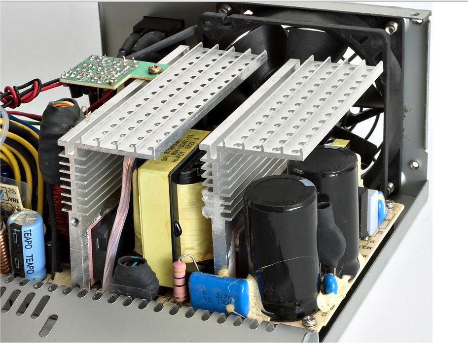

Driver heatsinks ....
Going through my E-waste pile today , I noticed most common
PC PS's (250-300w units) have the perfect 75mm extruded units for
the "slewmonster" (below).
Out of 15 SMPS's , 12 had 75-80mm (5-7C/w estimated) long
"overkill" extrusions. Could be lower than this.
A 300W SMPS at 88-92% efficiency would have 30w waste (heat).
Even as it is fan cooled - this is far more than the slew driver dissipation.
Being so common (PC SMPS's) this would be perfect (and free)
to apply to a build. 🙂
PS - with one of these , Driver Re @ 68 (or even 47-56)- no issue. A flat plate
is over 15C/W - 3 X the cooling for nothing !
OS

I checked again. Pretty healthy output in the pics. The amp starts clipping at about 41Vac into 8ohm with 1K input. The pics above represent about 30V output at 1K Of course at 100K it is probably 1.5Vac. I checked again with each channel and they both look the same. 100k on the square wave looks almost the same as the sinewave. No idea why 100k matters since I doubt I can even hear 20K anymore.
