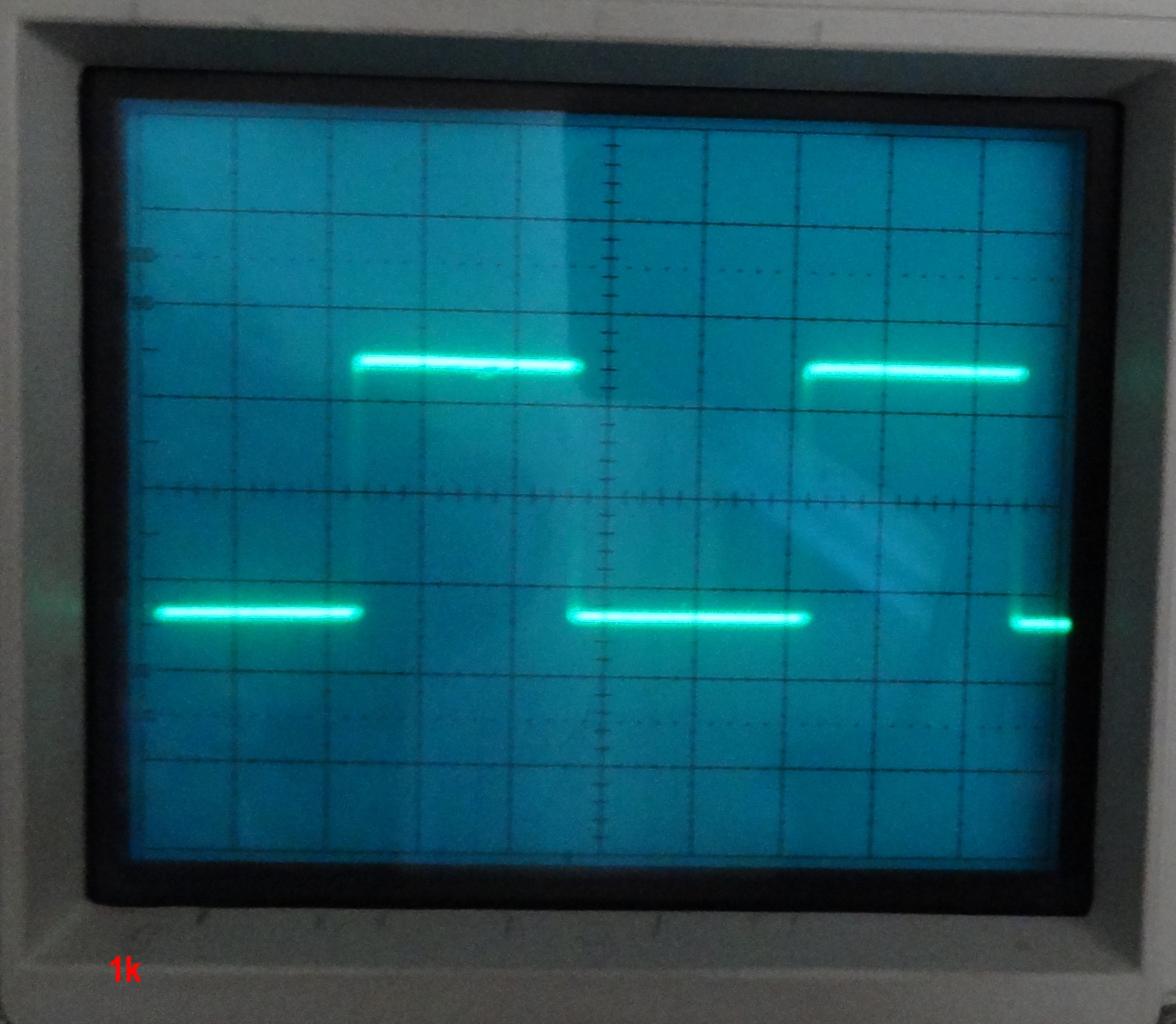

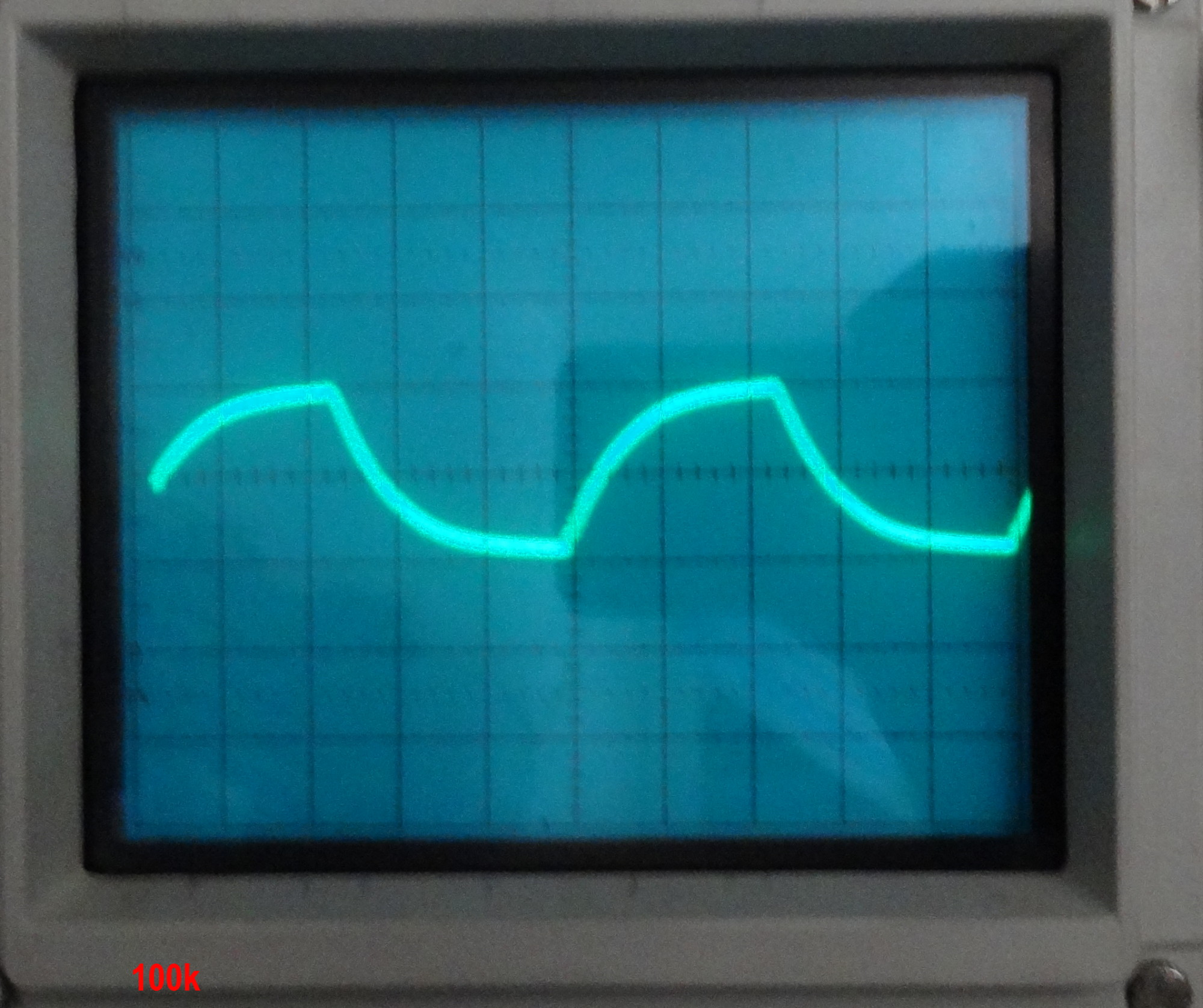

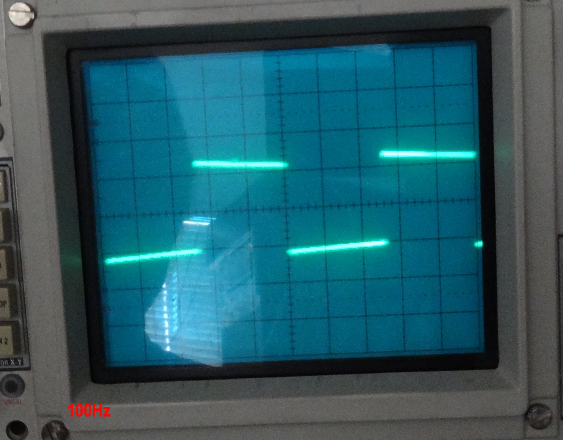

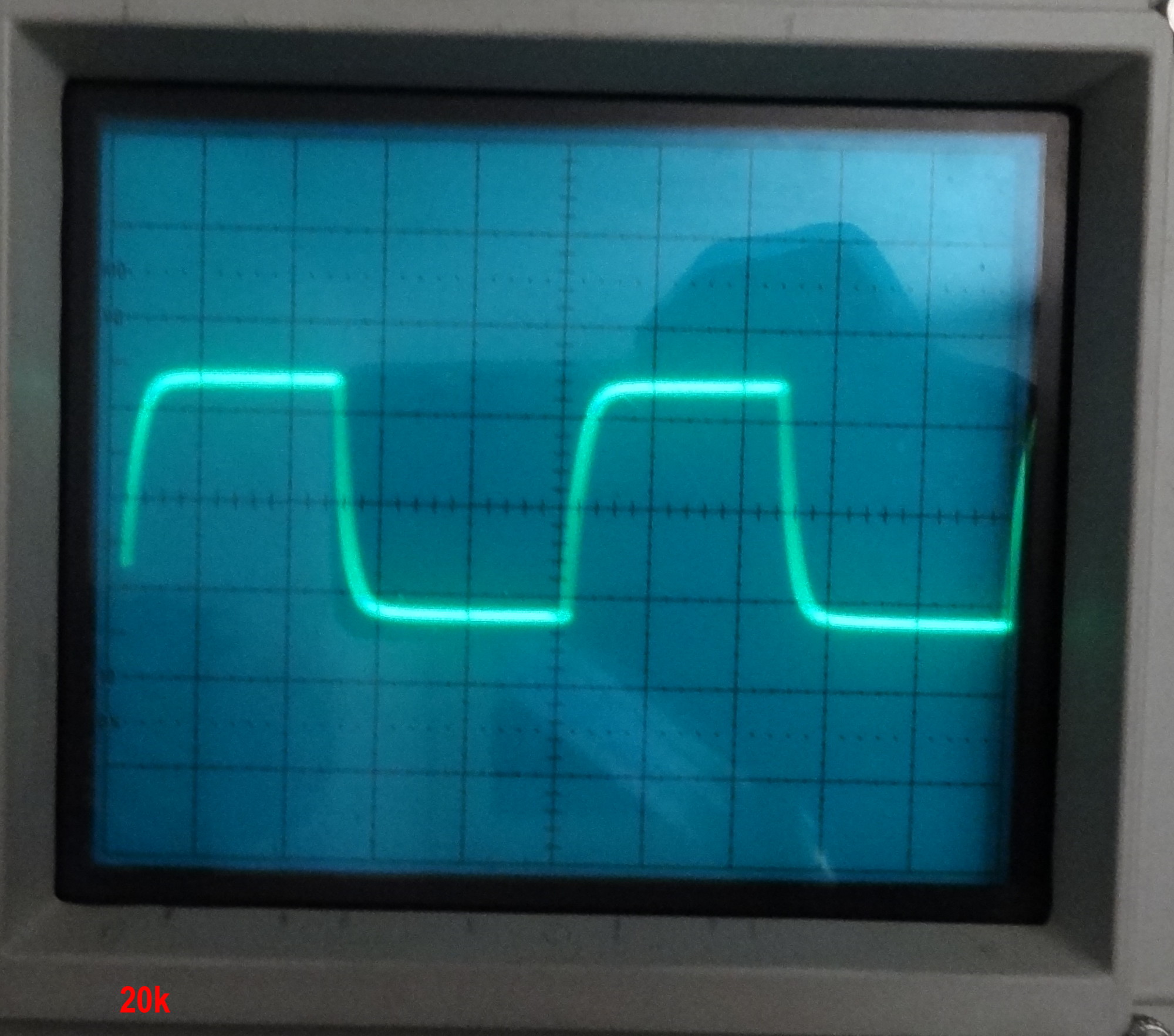

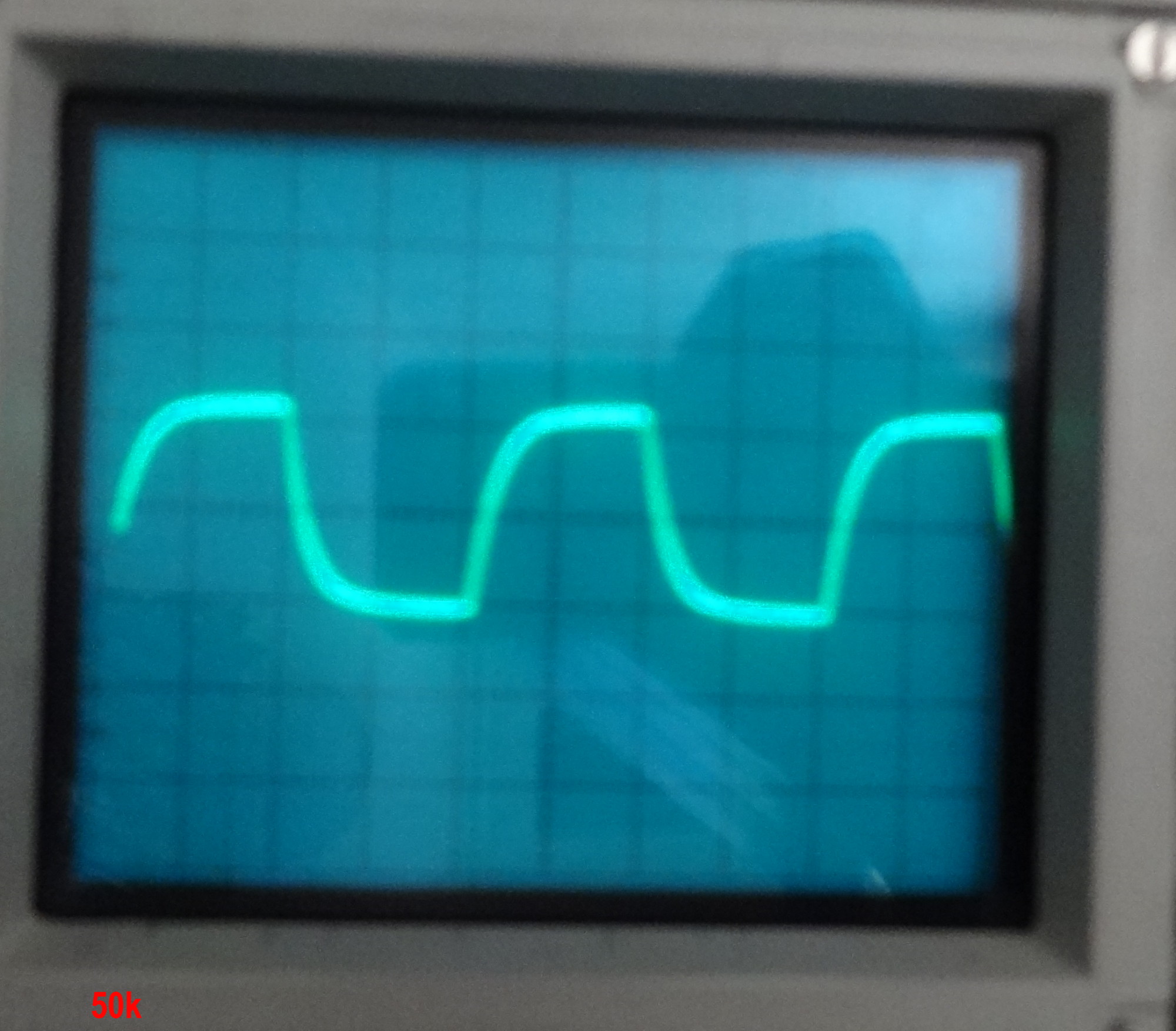

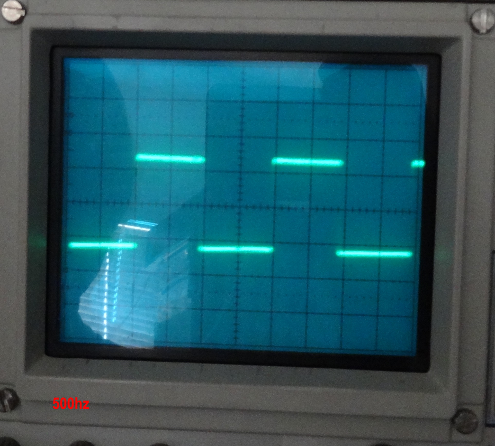

OK, I swapped out the A1220/C2690 for KSA1381/KSC3503. I pulled C2 and took some measurements. The square waves are better but not like thimios's. I am attaching some pics. I attached the probe at the output of the emitter resistors this time to get ahead of the L/R. Just to check, I also attached the scope to the PD on the IPS and the scope looks identical so this is definitely happening in the IPS.
Blessings, Terry
EDIT; OK, out of curiousity, I just hooked up my completed VSSA based on this very same board and the waveforms look identical to these so now I'm going to check some of my other amps to see how they look by comparison. I would suspect my scope but the tone generator direct shows perfectly square waves. I'll get back to you.

OK, fresh back from testing some of my other amps. Surprisingly, or maybe not, the purest looking 100K square wave was the Ovation NX. The 100K wave looked about like the 20K wave does above. I checked the Fetzilla, SKA GB150, DX Super A, DX MKIII, And Ovation nx. The squarest was the Super A but it has an overshoot and blew a fuse while I was testing. The MKIII was fairly square but tilted in on both sides. The FetZilla had bad squiggly lines as did the GB150. May have some oscillation I didn't know about. To be honest, I never tested any of my amps above 20K before. Didn't think it mattered. This Slewmaster concept is going to teach me a lot, I can see that now.

One thing I just checked was the waveform as it is being applied to the input pair bases, it has the same shape as the output. My input filter is intact. I see an amplified version of precisely what is being applied to the input pair. It looks much like Terry's shots. I'm going to see about the input filter section.
Thanks Waly.
Terry, I just raised the input filter cut-off frequency (I popped in the values OS has on his CFA-XH schematic, R4=220R and C2=100pF) and get what I expected - square waves out. In a real build I'd rather have a lower cut-off frequency than to be able to say 'look at my marvelous high powered square waves'. If you want to satisfy your curiosity you can try it. My set-up wasn't fond of 100kHz squares and popped a fuse (no damage but it likely set something into instability).
