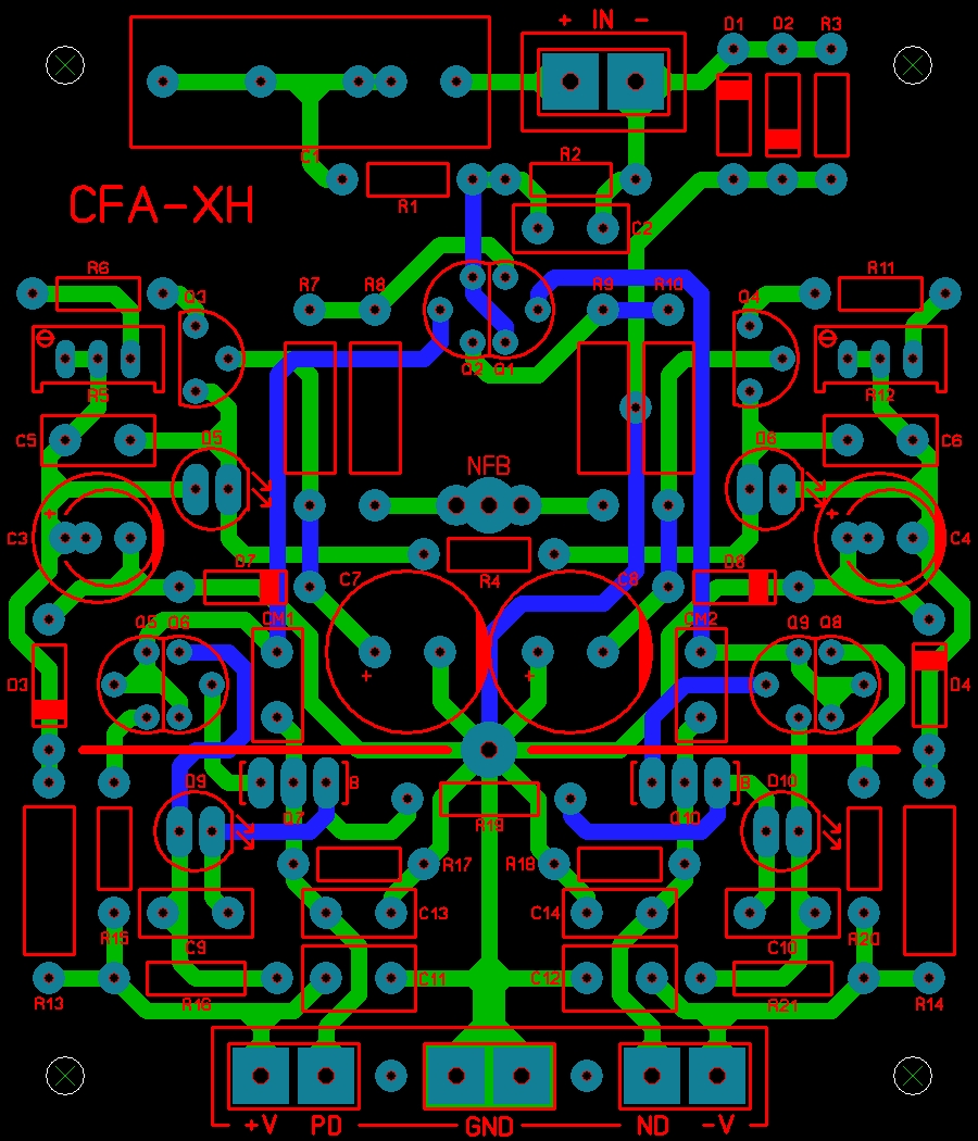

As for a proper IPS, I submit this for someone (ahem, OS? care to take a look?) to check for any errors. This would be the CFA-XH v1.3
Just get rid of the unmasked star point. OV can be the test point.
Heatsink can be one piece again.
Excellent work.

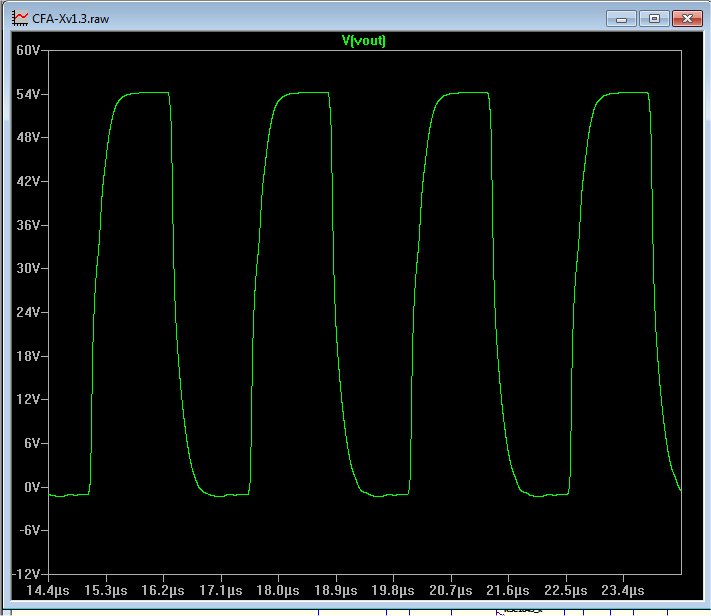

ps - bet you could get this board to put out nice 400K SW's !
(just to push the limits)...
edit - EASY ... even 1mhz still looks "square" 😀 .
OS

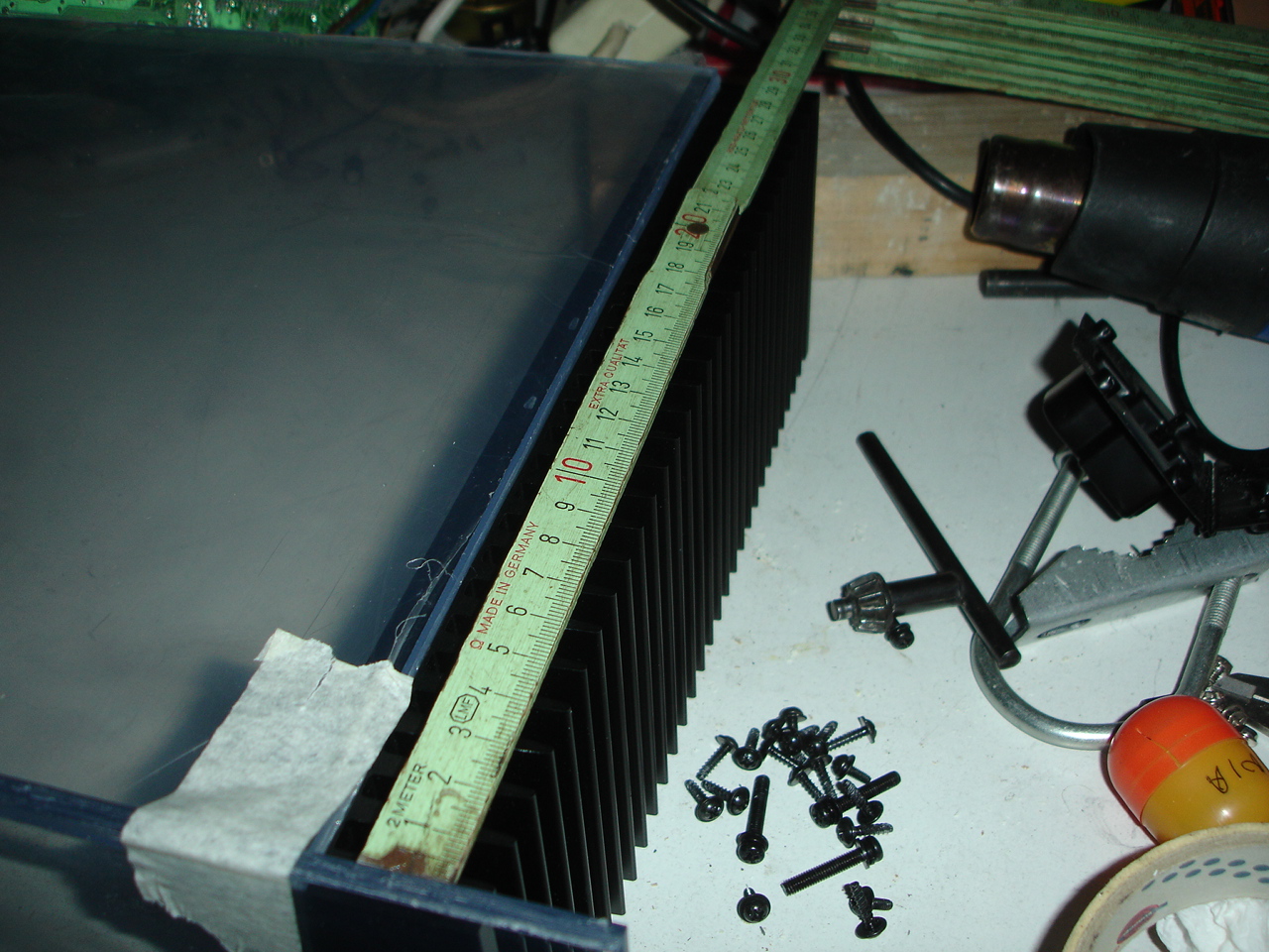

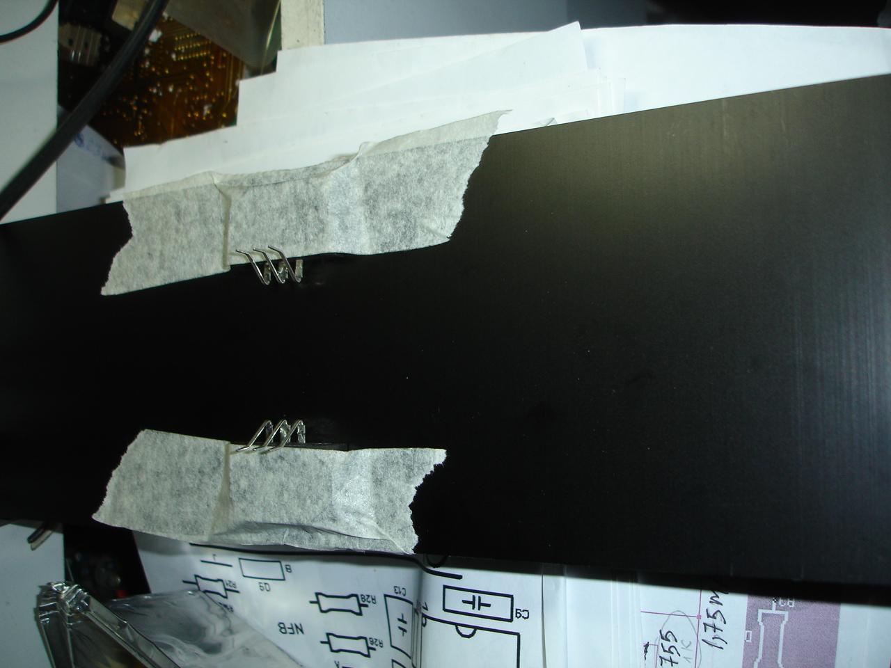

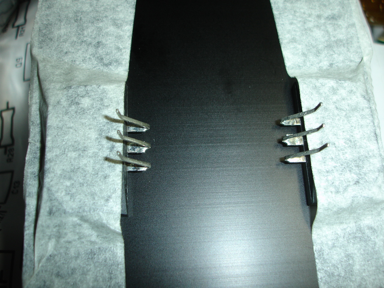

I want to mount two pairs MT200 transistors on this heatsink.(SA56/100SA)
It's useful if i have some opinions about this way.
Thimios.

I only broke the heat sink line to avoid a DRC error (silk on pad), the intent would be of course for the heat sink to be one piece. The main reason to keep the silk off that pad was so a spot of solder could be added to mechanically reinforce the via connecting the top and bottom. I followed parts placement fairly close to your example, including the IPS 'star' point, so I'm not sure what you mean by getting rid of the unmasked star point. Can you clarify your thoughts?
The "badger" layout has a few through- holes that are masked on both sides.
On my layout I had the star point offset (away from the heatsink).
I suppose it would not matter.
OS
