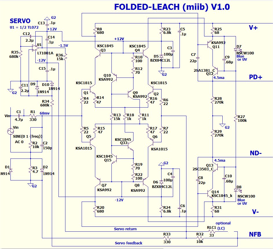

O-stripper- Gentlmen Here's one for you, A little Leach, a little folded cascode and a little bit of me. An innovative mirror and a HawksFord VAS.
Tremendous PSSR and some serious distortion cancellation.
Add your favorite OPS VBE and...
Maybe Stripper should form the compensation to fit his EF-triple
That one went right to the desktop !
A "folded (miib) leach V1.0" it shall be.

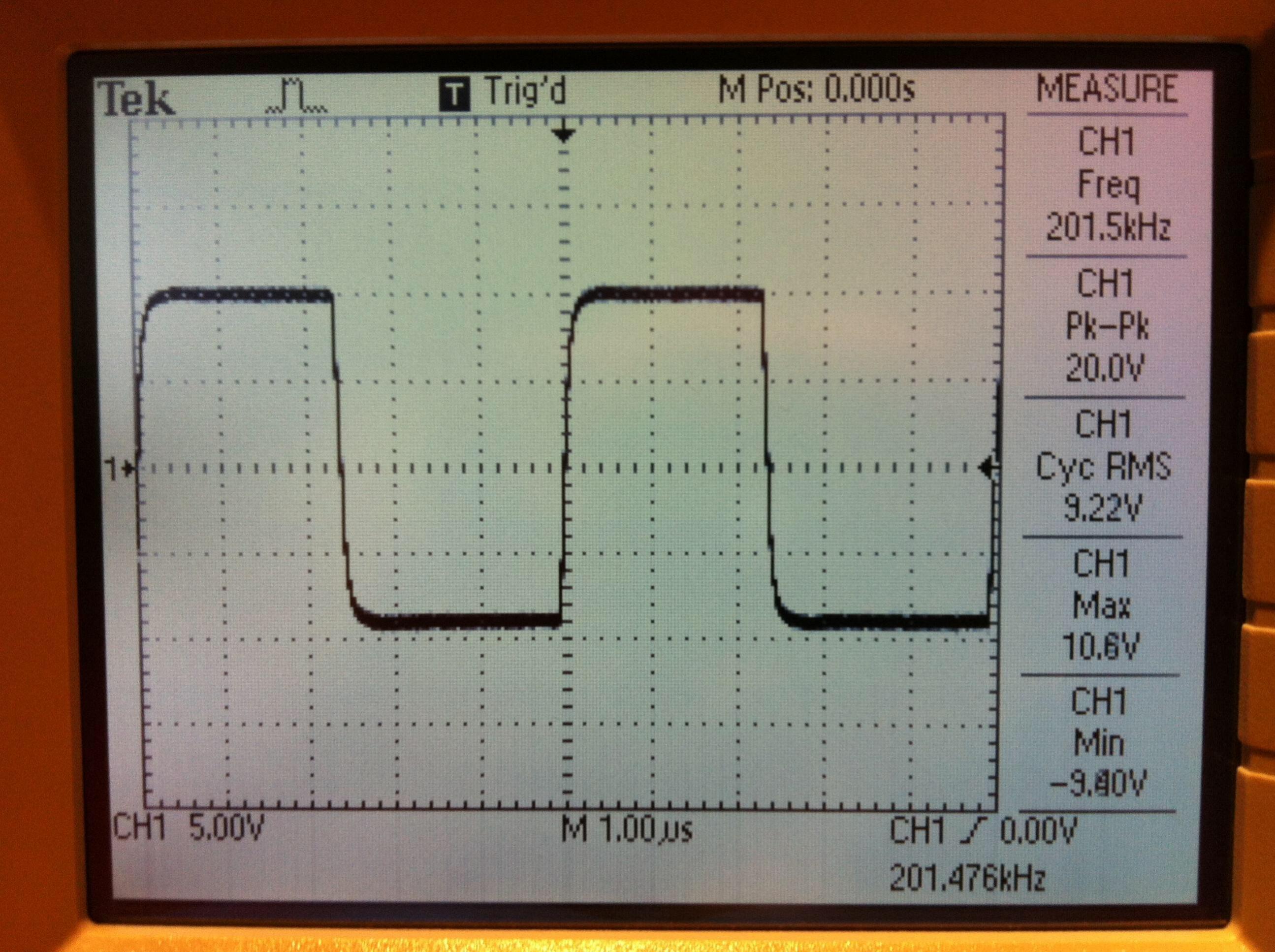

This is the meter I use. How much difference does it make?

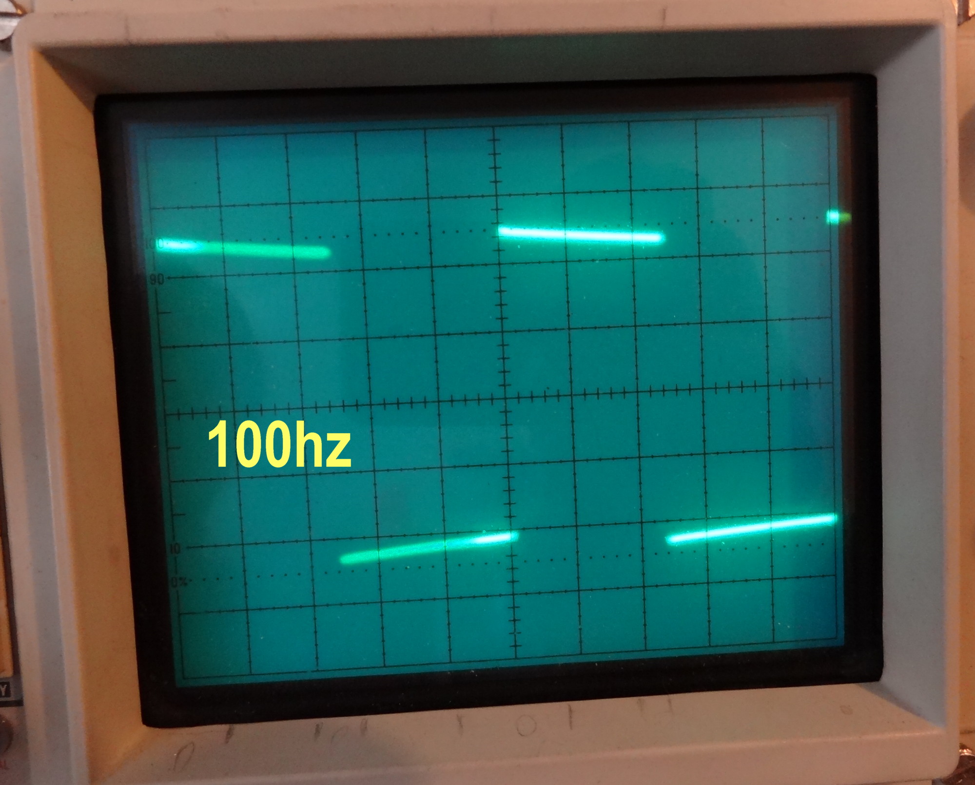

A considerable difference, 100k @ 2v p-p should not smoke a zobel, unless your making the amp oscillate. If your meter's bandwidth is rubbish then it might show 1v when in fact it should be showing 10. If you then turn things up to get the output back where you think it should be, then the amp is in fact putting out significantly more than you think it is and poof, up goes the zobel.
For example the 10 ohm 3 watt resistor in the zobel should be able to handle being loaded directly with 100k 2v p-p all day. There's no way it should be smoking.
If you've got a scope simply use that to set the output level.

2 volts DC into 10 ohms is only 0.4 of a watt. Whatever you're doing with the amp, even with that tiny zobel, if it's running properly, 2 volts peak to peak of anything put on the input should be entirely safe.
Super A is not properly compensated, phase margin fall well into positive gain bandwidth.
Properly designed power amplifier must withstand 20 kHz full power signal no matter the shape at all times, zobel must not smoke at 40 kHz/-3 dB full power output.

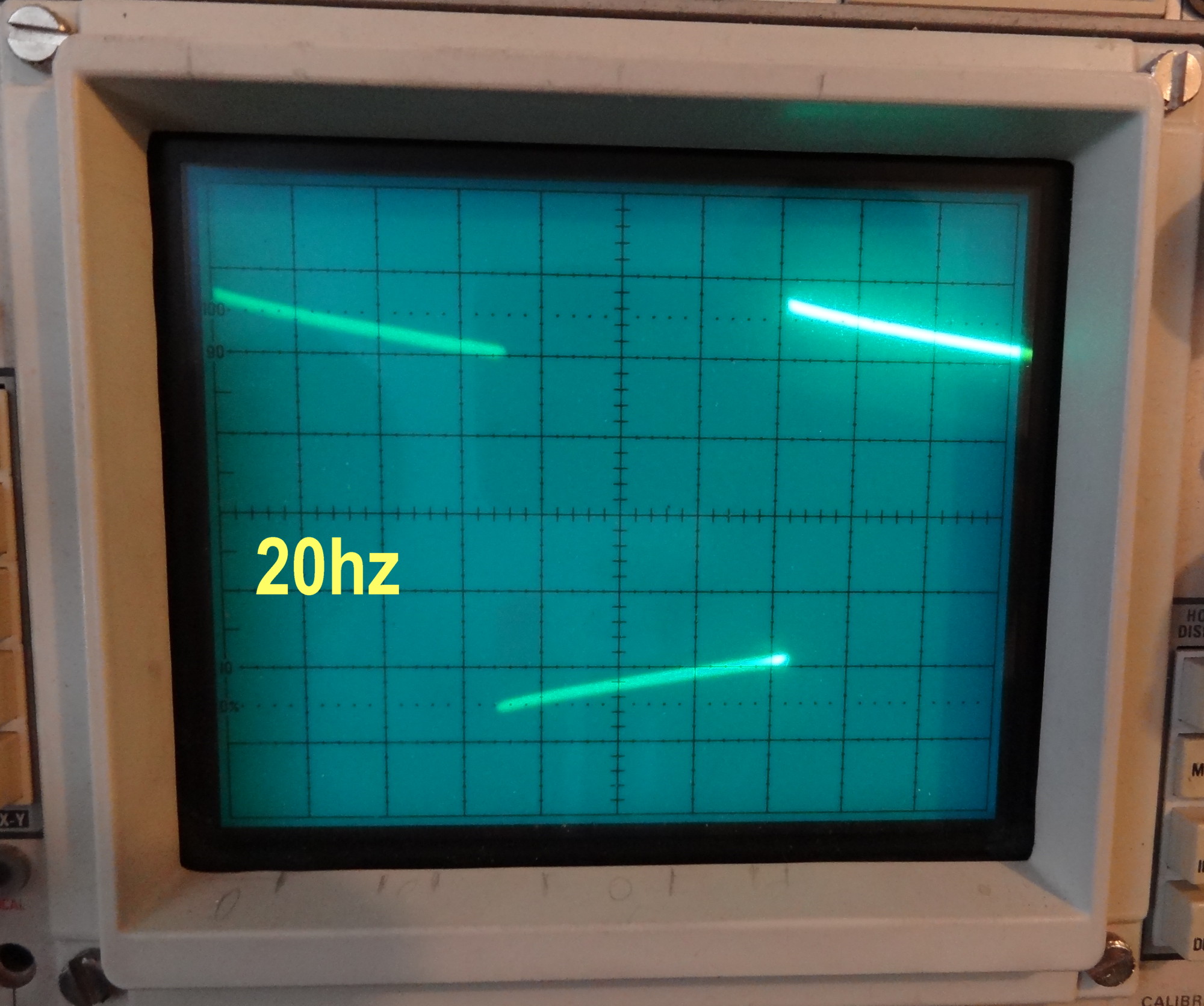

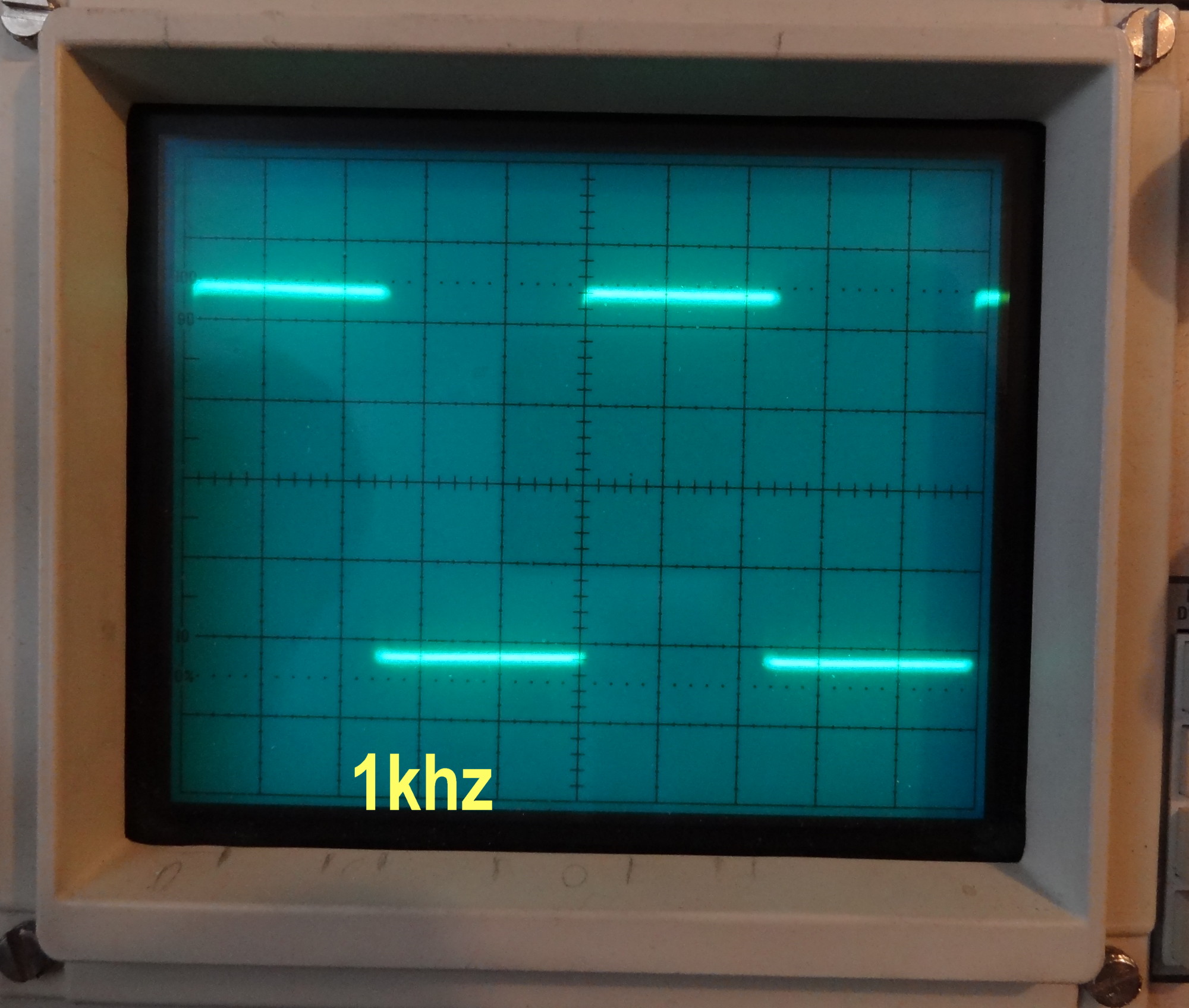

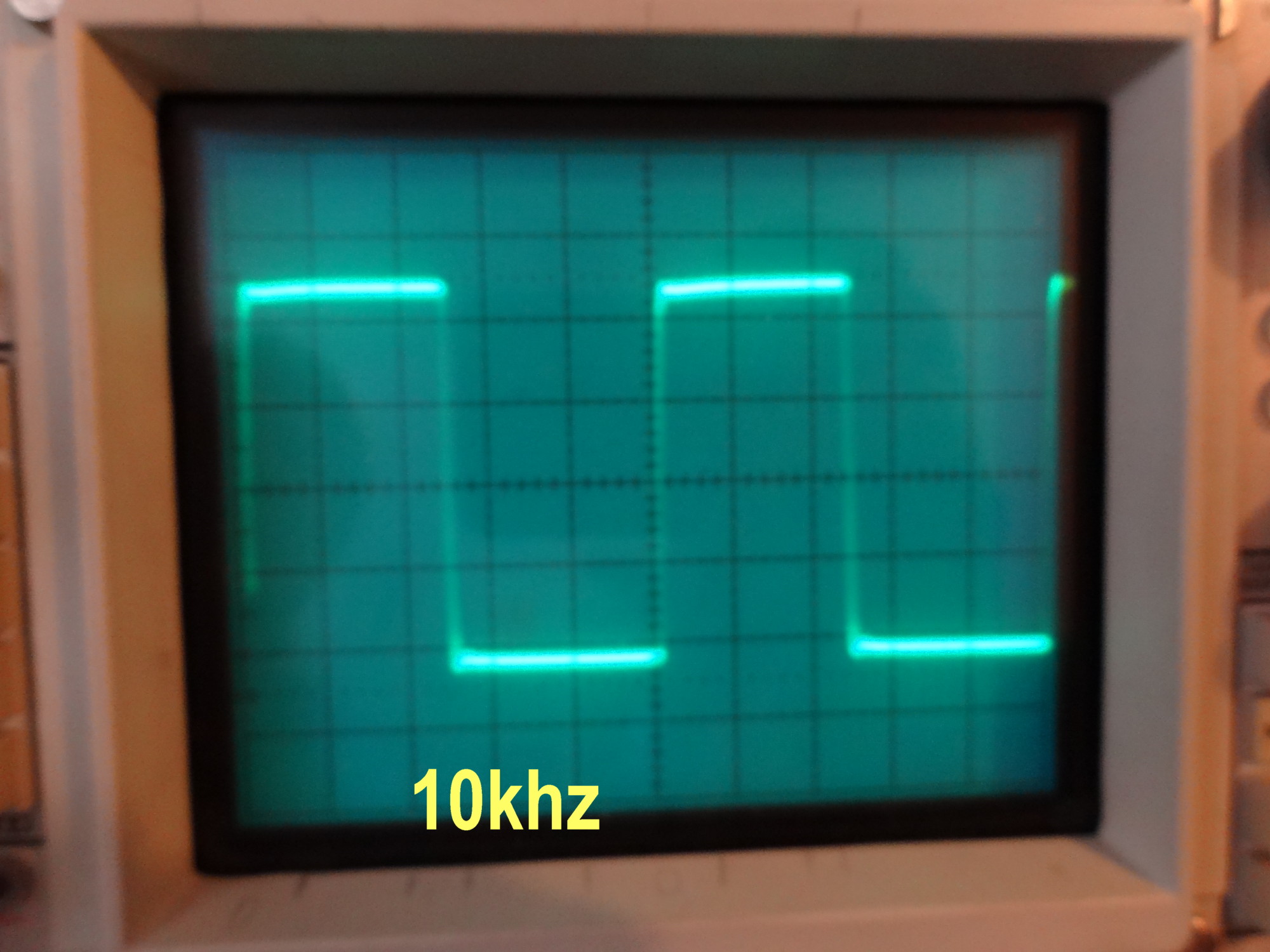

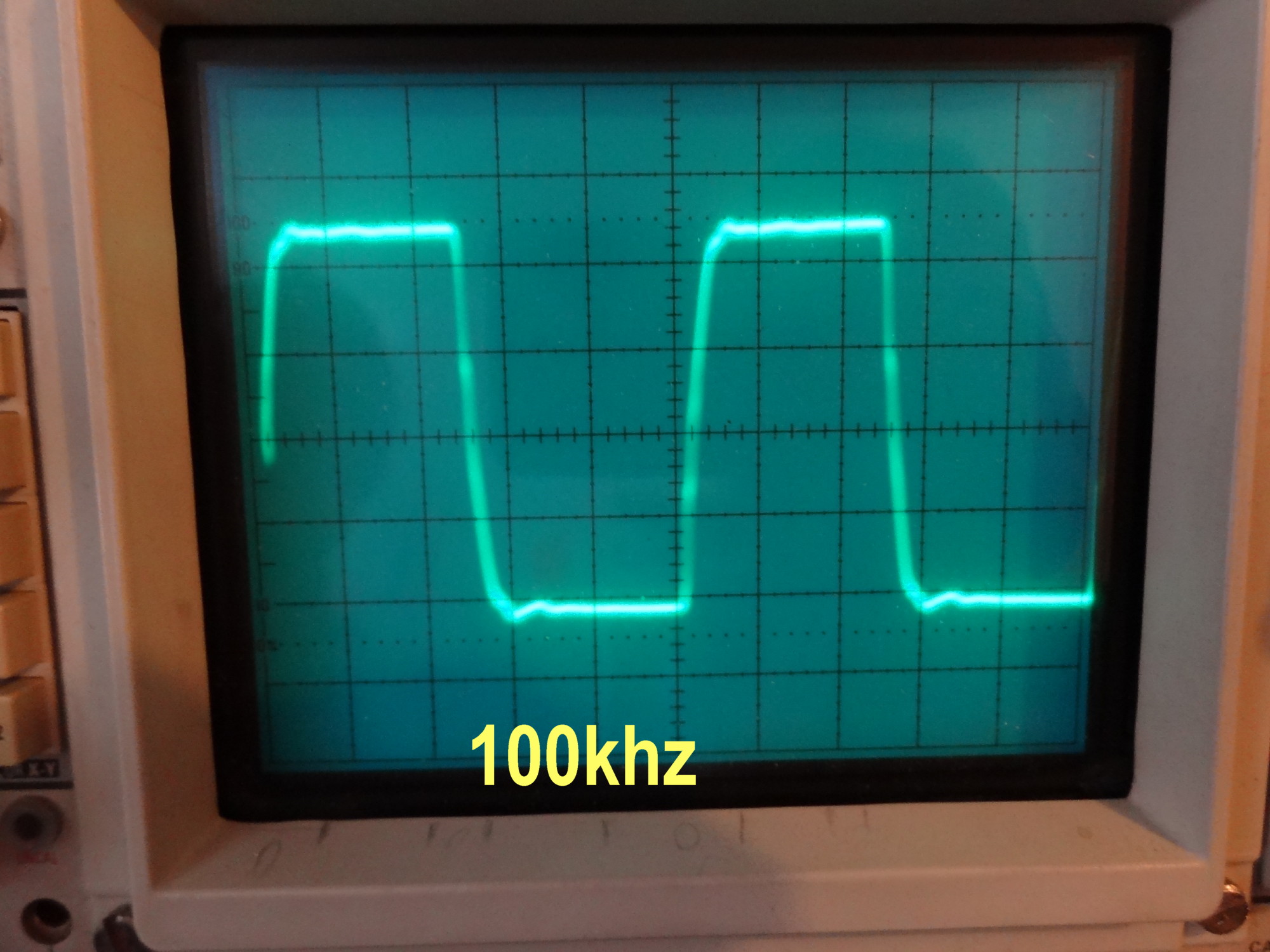

I shorted the 10uf input cap and took some more scope shots. Looks like I need to try some different caps there.

"FOLDED LEACH" ...
I'm still on Miib's first post ....
I DO like the "folded" deal !
(below) , the original spooky with Miib's folded hawksford and it rocks.
THD20 is now 2-3ppm (spooky is 10 ppm). TOTAL even order cancellation ,
NO h2/h4 .... just a little H3 , even beats the blameless (wolverine) now.
PSRR is 10db better.
I figured out what is happening ... an error- correcting hawksford.

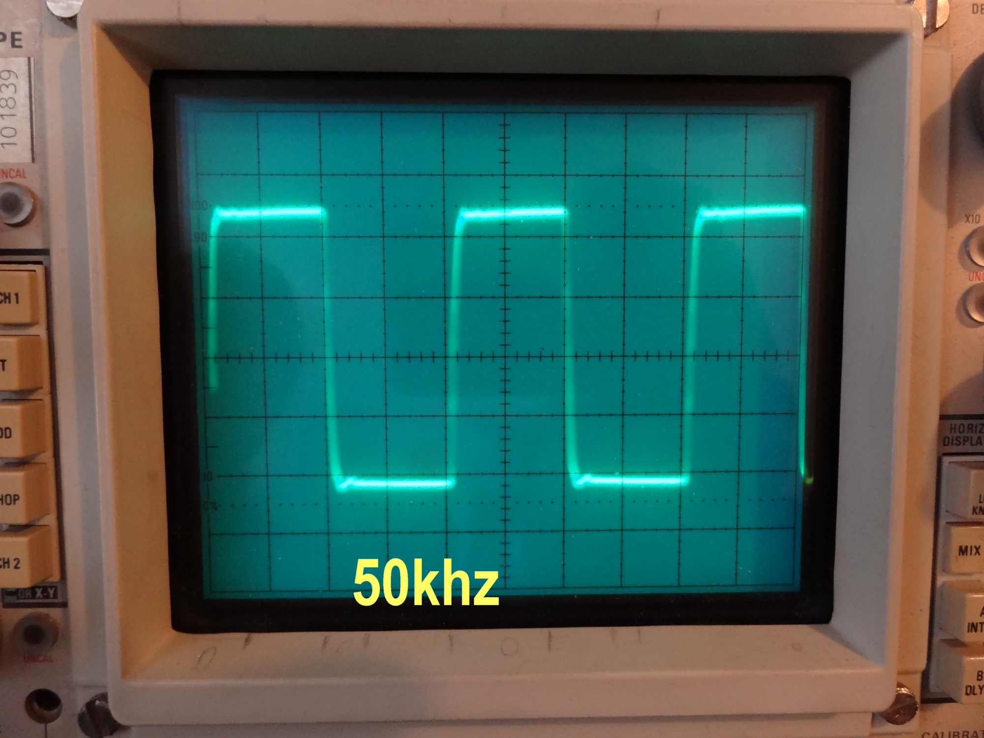

Test repeated.
New measurements,the problem isn't input filter but generators out voltage which isn't stable when frequency changes.
-3db high .All these tested at 10VRMS/4R

PS THE BEST LOOKING SINUSOIDAL at 400 khz belongs to Spooky
