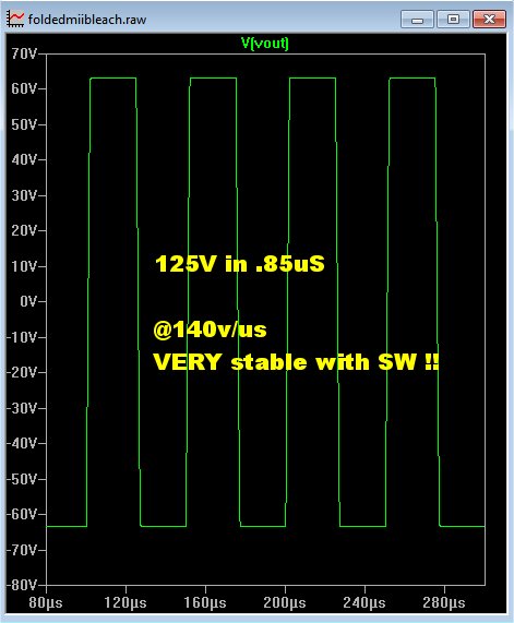

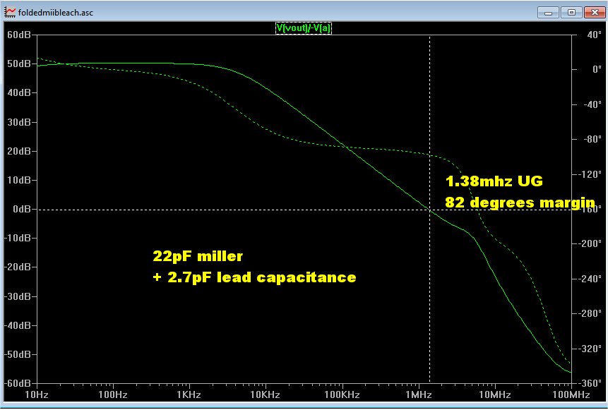

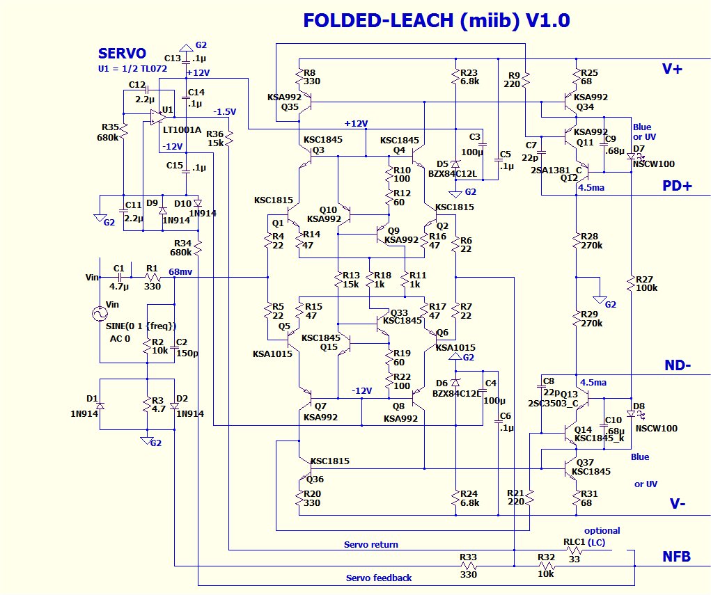

Don't count out the "wolverine" NOTHING can beat it's PSRR. (-120db+)
(below) , I went all the way with Miib's idea. The mirrors increase
PSRR to -100db. Best of the symmetrical designs.
THD is still 2ppm ... I'm using the input cap and am trying for a "realistic
simulation". And running it into the "slewmonster" OPS.
The circuit below does have the lowest THD 20 of all - winner !
Would we hear this (12ppm to 2 ppm ??)
Is this worth a 18 device IPS ? Hmmmm.

Thanks Bonsai for the practical hints regarding cascode oscillations, I have ofthen worked with cascodes in some of my phono-stage designs, and had to debug a lot due to these kind of issues, a gate/base stoppers are commonly used and why not here as well.
Makes sense..
O-stripper, why not make the input-cascodes driven..??
