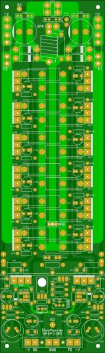

I know the topic of discussion has moved on from the OPS but I was playing about with my OPS artwork since I'm thinking about a new order to go with the IPS and this occurred 😱. It should still (just) fit a chunk of Heatsink USA 10.080" extrusion
and OS's choice of drivers will support the added pair... Maybe I'm just getting goofy...

I know the topic of discussion has moved on from the OPS but I was playing about with my OPS artwork since I'm thinking about a new order to go with the IPS and this occurred 😱. It should still (just) fit a chunk of Heatsink USA 10.080" extrusionand OS's choice of drivers will support the added pair... Maybe I'm just getting goofy...

The latest version is intended for board house manufacture, since it is a double sided layout. The actual output section could do solely with normal single sided construction but there are a few traces that are on the component side in the lower current areas of the board. That said I can output DIY friendly files in PDF and folks can either use wire jumpers or if they are good at home etching could do a fully double sided board.
OK, just 'cause AJT asked for it... Here is a ZIP of the following:

Please note the added outputs and supporting components do not have any component designators because there is no schematic showing six pairs. The circuit is the same as the five pair version with an added pair.

What are you doing, adding another 50 watts per board at 8 ohms? Will anything else need to change with this addition or does everything previous to the outputw stay the same no matter the number of output devices?

I'm not trying to actually change anything, it is just a conceptual piece. IF one were to pursue such a beast nothing changes except adding the sixth pair and supporting components. I recall a user (or maybe more than one) suggesting six pair to evenly distribute the outputs over two heat sink sections so I thought I'd see what it looks like. It is actually very easy to alter the art for any number of pairs from a single pair up to total goofiness.
I wonder how many pairs one can go to and still keep the amplifier fast and stable? Presumably there is a limit.
I think at about seven pairs the drivers are at risk driving from high rails into lower impedance, so there is the practical limit IMHO.

I think one main problem with heavy paralleling in parasitics. The inductances and trace coupling adds up and you get crazy oscillations. A ground plane would probably fix this.
Beyond that, unless you bulk up the drivers and VAS and input stage, then it won't be able to drive all those outputs, at least not at the same speed and grace. Cascading more stages may help to drive, but that will introduce a lot of poles that will reduce stability, meaning it will again be slow after being stabilized. By paralleling stages however you can increase drive without losing speed. So if you use many paralleled outputs, it may be appropriate to use parallel transistors in preceding stages.
Paralleling output transistors may be preferable to using super-high-power transistors, because the Ft of lower-power transistors will be better, which means a smaller rectifier-like "recovery" spike during switching.

I was more thinking in terms of adding more to increase the amps capabilities into lower ohm loads so one wouldn't need to increase the rail voltages. Of course that still places greater demands on the previous stages too.
