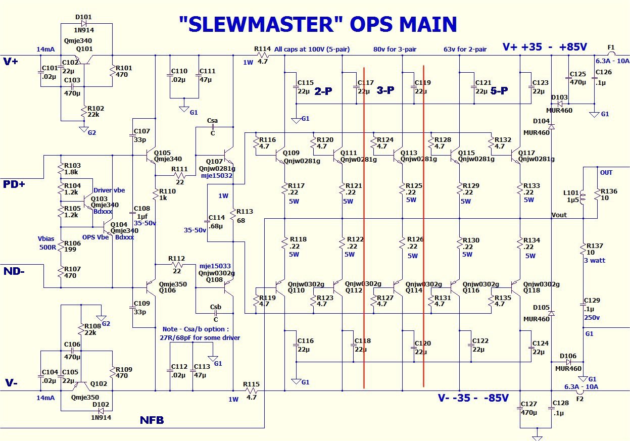

Hi guys
I'm about to start my "MONSTER" and wanted to confirm that the schematic in post #504 is still current.
I'm going to run these from 70V rails... is the driver emitter resistor (68R) a little low perhaps? Would 100R or even 150R be more suitable for this voltage?
Also what's the word on Csa/Csb? This OPS will be MJE340/NJW3281/MJL21194 and compliments.... thinking I might install some 68p np0's between the driver base/collectors to tame any oscillation.

Here is the "lowdown" , on this.
The wolverine (and all the VFA's) have stellar PSRR ... you can , omit
the capacitance multipliers here. Just jumper C-E on the multiplier
semi's (eliminate it's associated diode,R's , and main cap).
Leave the final output decoupling nearest to PD+/ND-. You will gain 2+V
on the rails.
Running the wolverine on <30v , you also might want to halve any rail dependent network.
R9,16,19 and 20 @ 1/2 value will ensure spec. operation.
PS - all these VFA ips's can run down to OP-amp voltages (+/- 15V).
The CFA's with regulated +/- 12v supplies would do with >20V and
you would have to adjust the Zener dropping resistors.
OS
Still4forgiven has spoken. 68-82R = a real large compound (finned) HS ...
(like the ones in a computer PS).
100-150R = flat plate of aluminum
220R (like the HK680) = just a piece of roof flashing.
One thing to consider with changing driver Re - you might either have to adjust IPS VAS current or change the series resistor next to
the main OPS bias(R106) to retain a centered optimal OP bias range (R107 , either (330/390 instead of 470R).

Hi Christian,
I would go with at least 100R for R113. That is what I just installed. They still run a little warm but I can keep my hand on the heatsink now. Hopefully I can give a full report later today. I had some bad caps for R125\127 and am trying to reform some. If that goes well it will be singing today. I installed CSA/CSB. I'm not sure if they were needed but they don't seem to hurt. Don't forget to install that long jumper tying the two G2's together.
Thanks Terry, I'll start with 150R and go from there. If you still have some of the 820u filter caps that Kevin specified on the LTT4 then these are ideal for C125/127. They're the perfect lead pitch and case size; the extra capacitance can only help when the outputs are drawing heavy currents.
