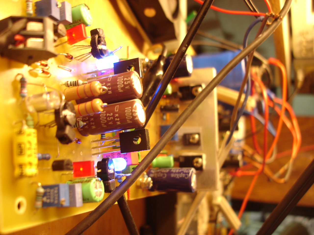

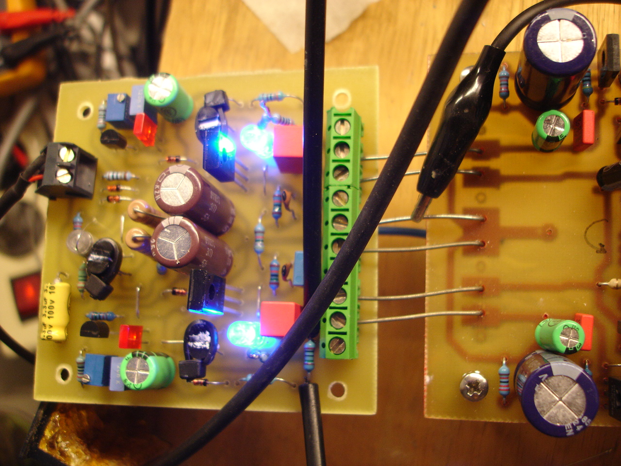

G2 on OPS not connected yet
this pict from post #2072
I see your G2 on OPS(near the terminal block) board is not connected anywhere yet...
There are two or three G2 on the OPS board, maybe you only connected the one near the rails tabs,
there is one G2 pad "free" that must be connected to the one near the terminal block
That should be connected to star ground if not then tour IPS is floating... 😱
Hi Terry,I pulled the IPS and installed 18K resistors across
That's where I measured. I will check it again.

Hmm, did you ensure the G2 at both ends of the OPS were connected? I used a wire under the board but I don't see any evidence of the pads having been used.
Hi Guys,
Thanks for the suggestions and kind help. You are correct that in the picture, I didn't have the grounds connected on both ends of the board. I didn't see that instruction. I did connect it to star after thimios mentioned it in post 2105. I haven't installed a jumper on the board yet but I did attach both grounds to the star. Hopefully Jason will have time to hit his boards with some higher rails and see if he has a similar issue. I don't want to keep swapping parts willy nilly. It's too hard on the boards. I will take this time to install those long jumpers.

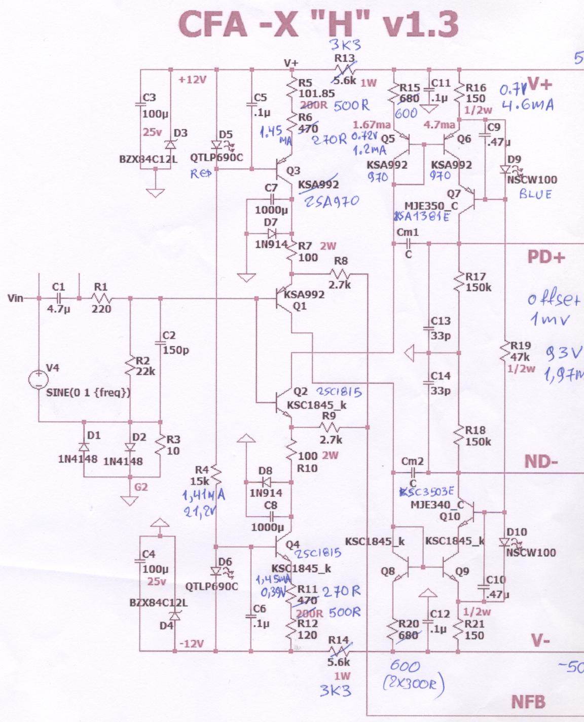

Calculating heat sinks
transistor C/W table ... above.
The slew drivers are at 2w , the tables show just a few C/W with a
minimal heatsink on a to-3P device.
We should be running cool. Even the OP's on the main heatsink.
Higher rails will at most double the wattage but this would add just
a few C to the HS temp.
Raising the driver Re to 100R (like the HK680) would just drop
the drivers to 1W ... for just a small temp. reduction.
1W - 2W is minor ... as far as temperature. The HK to-220
drivers have NO heatsink - just get warm when I abuse the
amp.

You can run R113 as high as 220R - I simulated 150R ... all is spec.
This will run the drivers at just 7ma.
When you said the oscillation stopped as you "fiddled" with the input ,
I should of realized you had no ground.
Actually , I'm surprised everything survived. I "floated a ground" and
let "magic smoke" out 😱 .

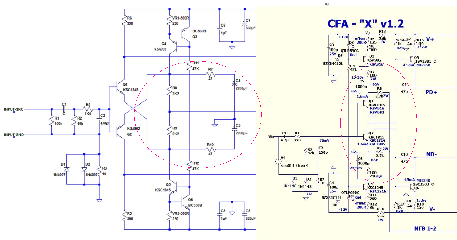

Hello Still4given
I note that the schematic JTK VSSA you showed has different feedback than original VSSA.
I put an attachment image for comparison. The small resistors on the original feedback configuration are connected in series with the css.
On the schema you posted the resistors are connected in series with fb caps which go to ground.
Maybe this causes the difference?

Just a different gain. CFA-X is 26db , Jason's is mid 30's.
CFA's are pretty much stable over wide set of gains (vs. compensation).
More so than a VFA.

PS - OHHH yeah , resistors are hooked to the CCS different ? I will simulate this !
This does not change a thing (according to LT spice). 🙂

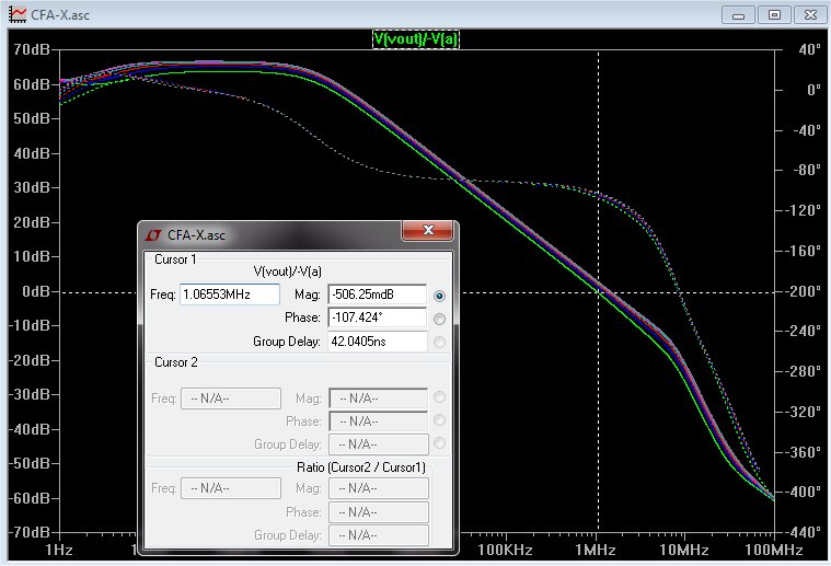

Oh yes it makes a difference if you degenerate the input pair with 47 ohm's or not.
open loop gain and phase margin is affected.
Yes , gain (below 1) , UG point (below 2).
But at least with "CFA-X" , phase margin is sufficient with all
6 gains I stepped between @20 X and 40+ X (120R -20R).
Some VFA's don't have sufficient margin at higher UG points (unstable).
PS- I agree you need (something) - 47R .... "not" would raise UG way above a safe margin (poof ! 😀 ).

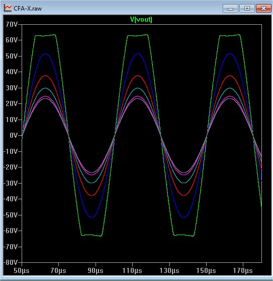

Also produced the same plot with both schema's from post 2131.

First fire ok. some first measurments.
Amplifier is alive and singing now.
Finally VFA is the winner for bass ,CFA is the winner for high!
THAT'S MY OPINION
PS I agree that cfa is a cheap ips but a suitable power supply for this ampl.isn't cheap at all.
My power supply with 22000uf/rail isn't quite for this because for low PSSR
Thimios.
THAT'S MY OPINION
Thimios.
