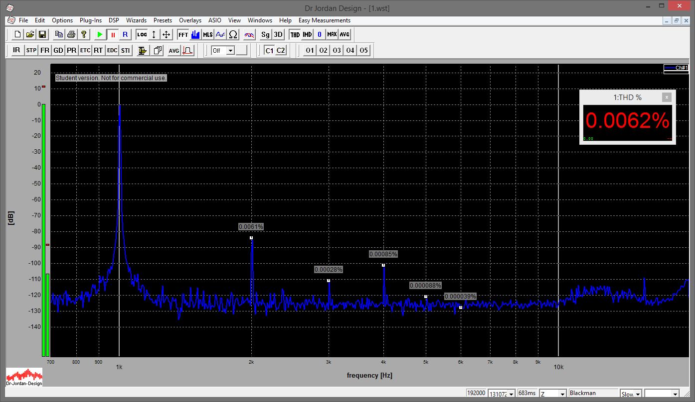

Hi all, just did THD / IMD measurements, using the recently-obtained Dr.Jordan's measurement system. See attached. Very cool harmonics distribution - most significant are the even ones (2, 4). 3 is much lower and 5 is practically not there...
12V RMS @ 8 Ohm resistive load
P.S. This is an addition to this post (CFA with GainWire input buffer)

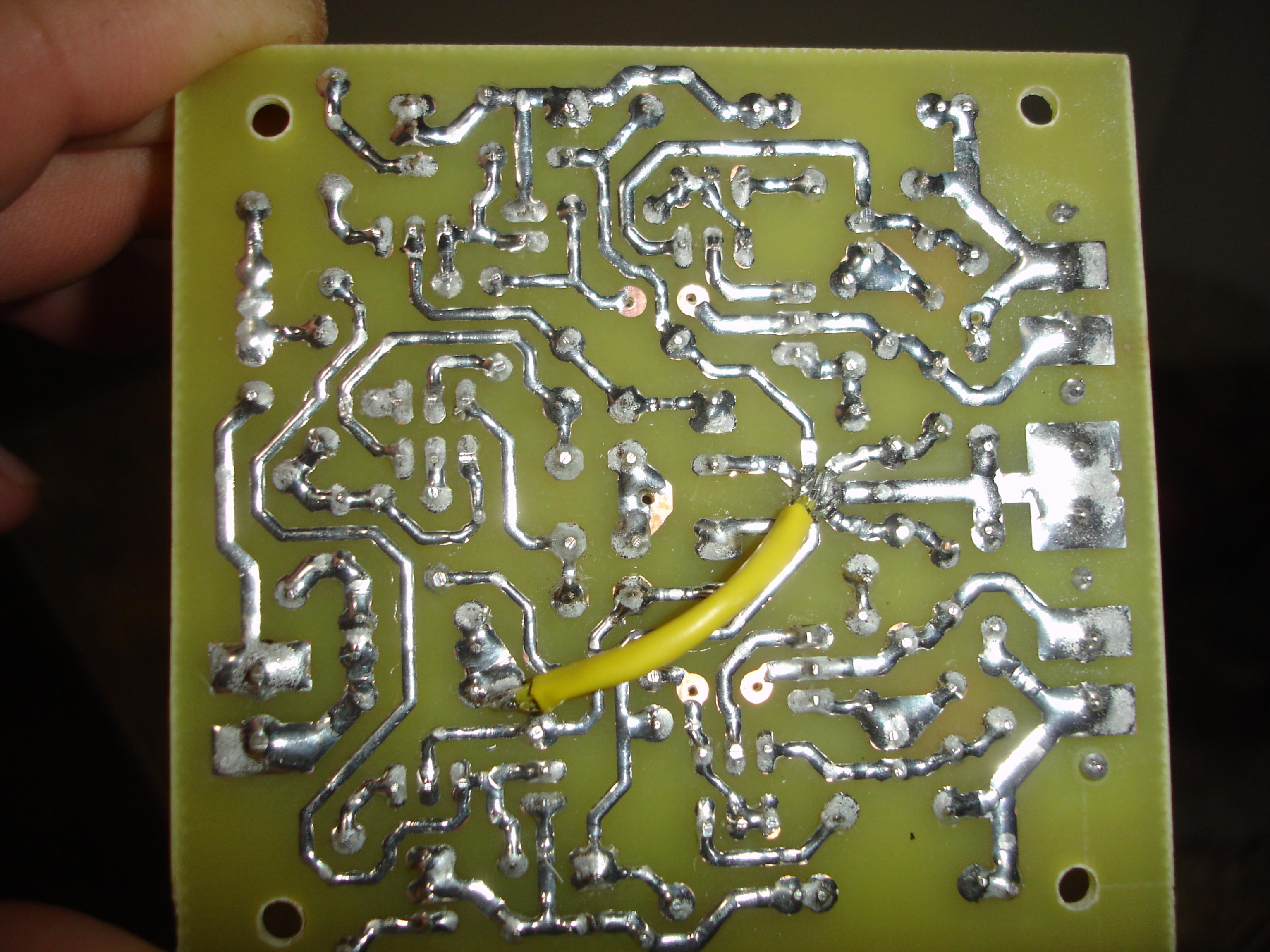

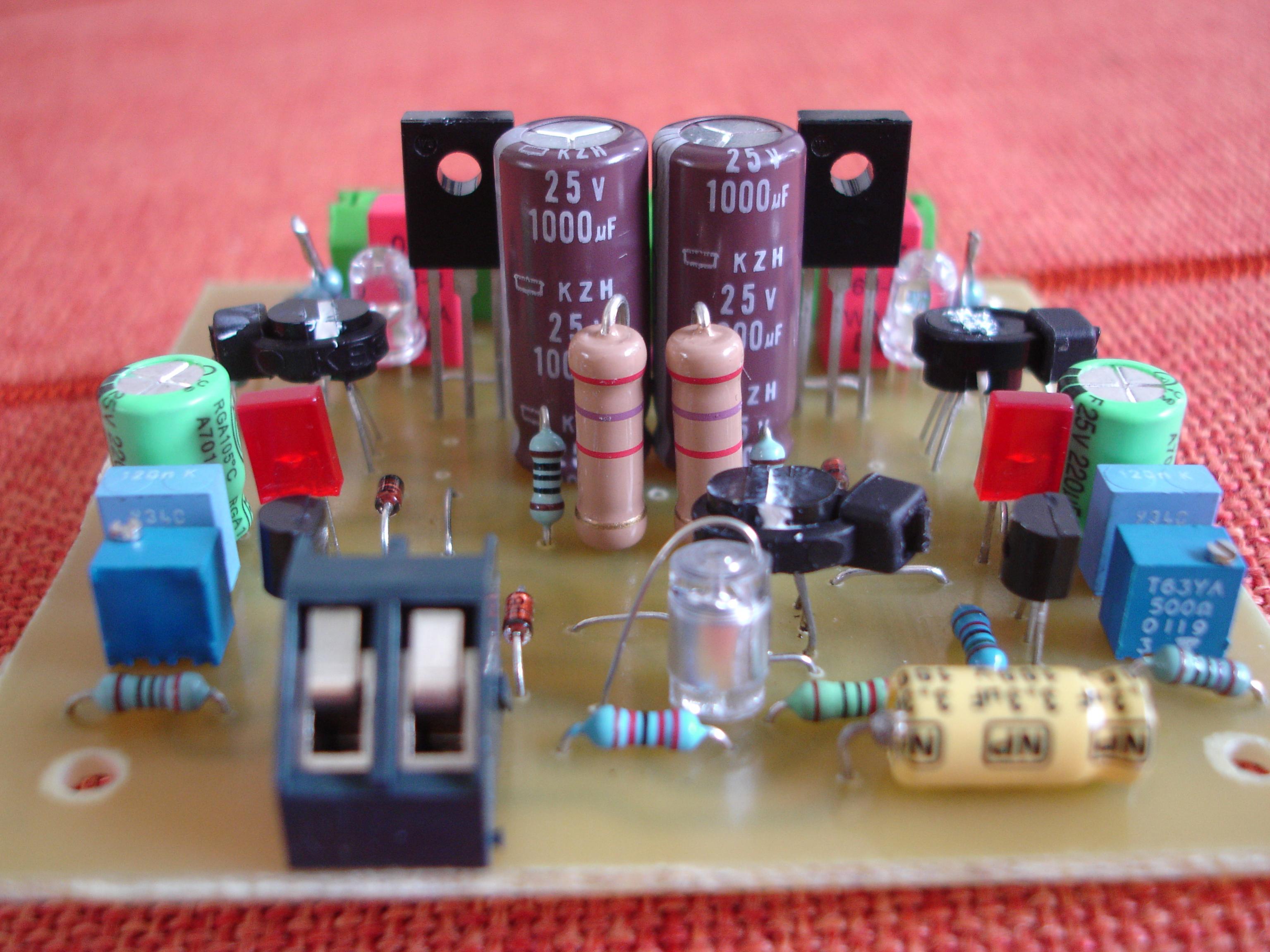

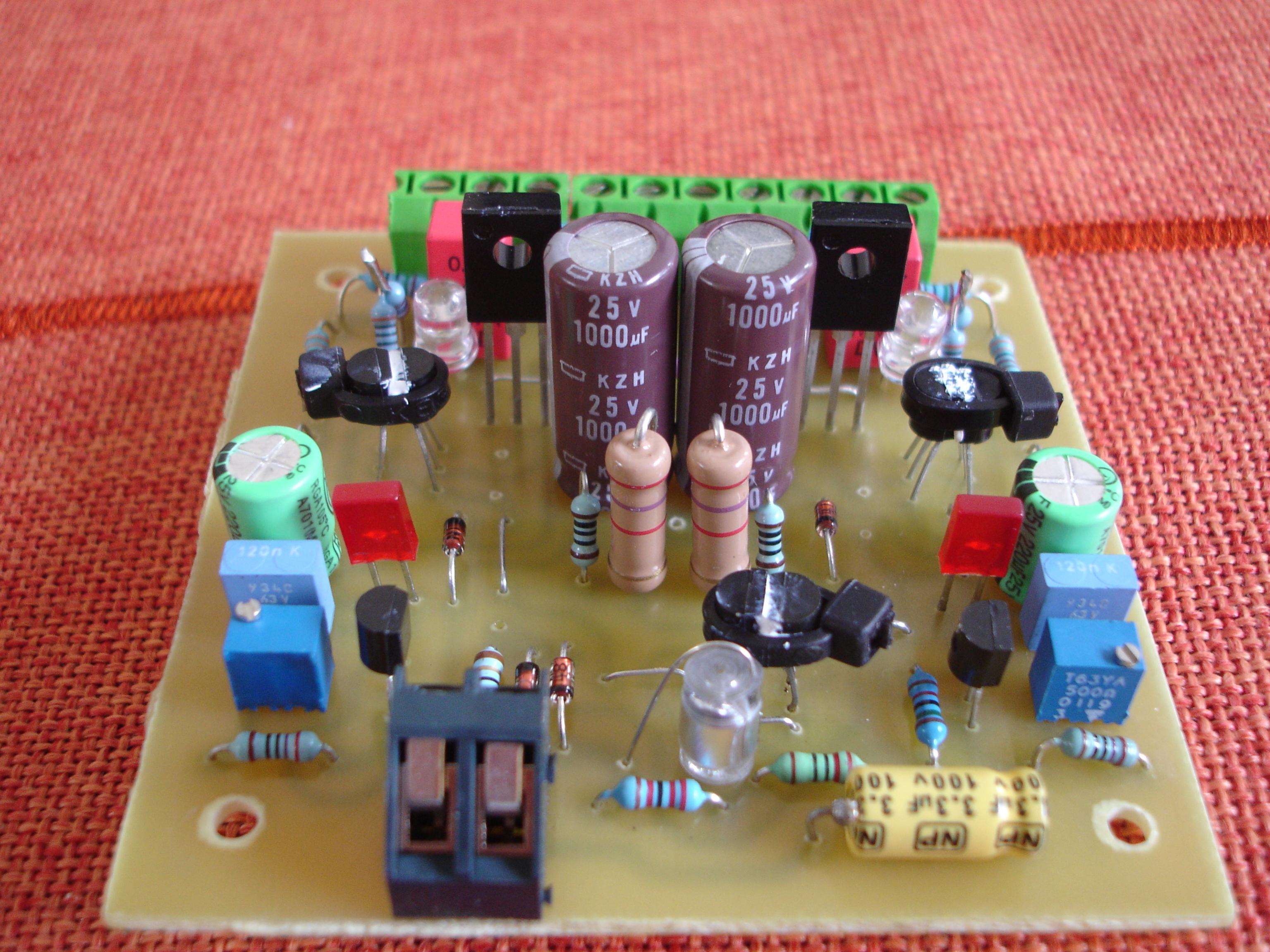

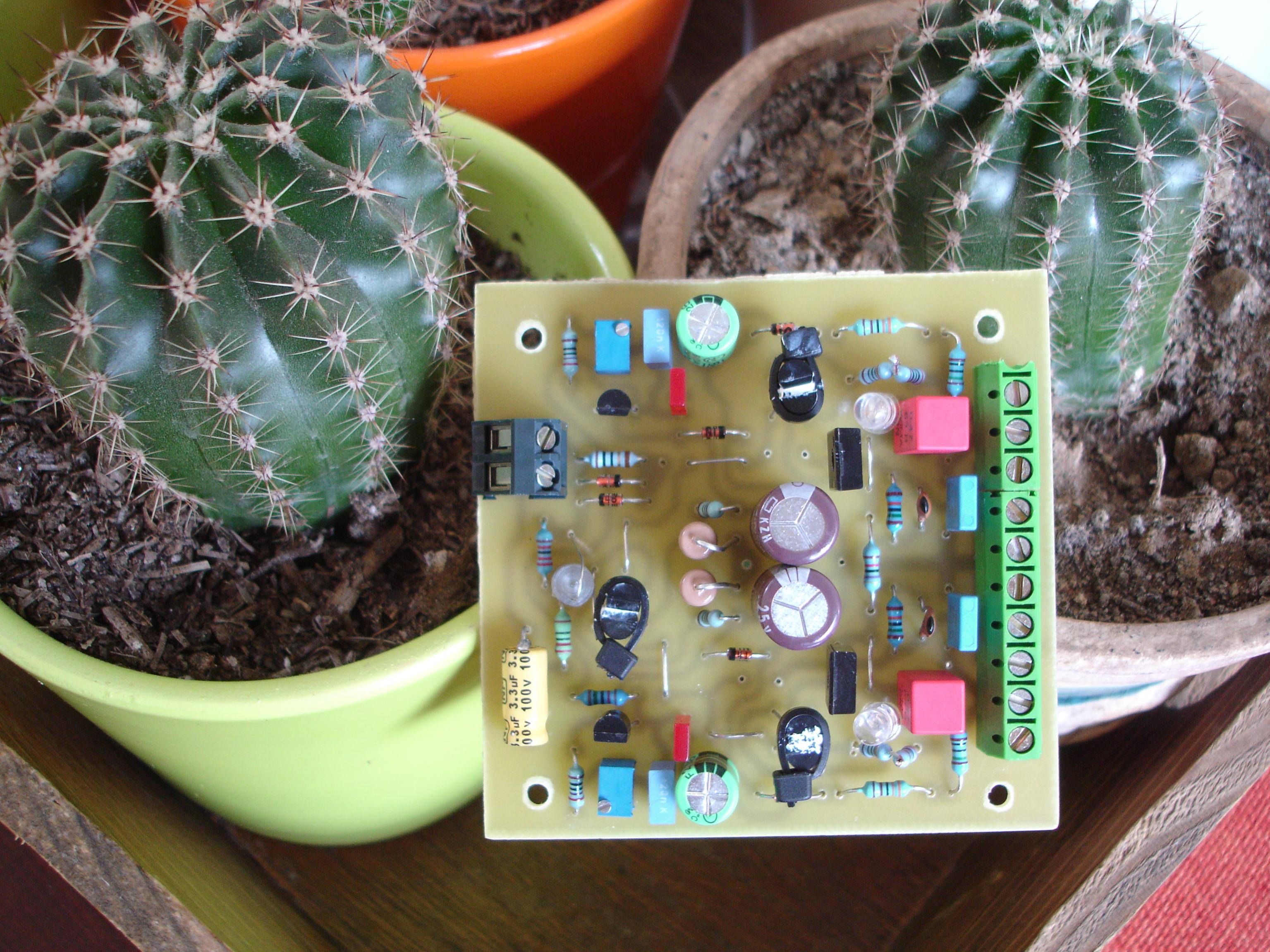

People asked "where is your 3D program"? ...
Thimios is my 3D program 😀 ..
They look nice, T ! These are the one's I will build.
PS - cool cacti ! Good climate for them ... I moving back to warmer
climes (tennessee) ... heck with "polar vortex's") ...
Edit - maybe a tad larger for the 100R CFB resistors ... I calculate >.3W
for them (worst case - they have lower V than the 2.7K's)
Thimios , make sure you jumper "a" to "a" for the input lifted ground to main IPS star.

Do the TO-220 devices need a heatsink?
To keep them at the same thermal constant and super cool in 40c weather
it is preferred.
I've seen thimios test with none (no bad results). The "slew" IPS , at 4.5ma ...
is cooler than badgers or DX's. It's only running a EF3.
My HK680 just uses TO-92L VAS devices (no heatsink).
The heatsink should be just a scissor cut piece of (AL) roof flashing
25mm X 60mm ... that's all you need !
OS
These are TO-126 transistors and yes they need heatsink 😉

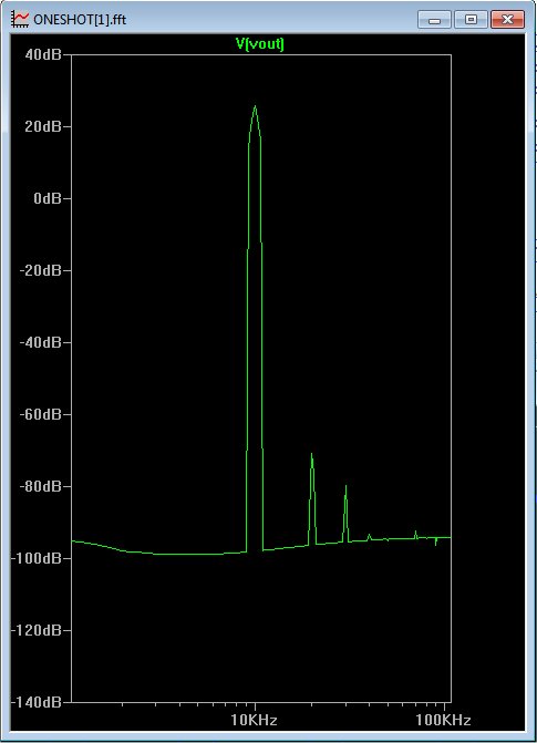

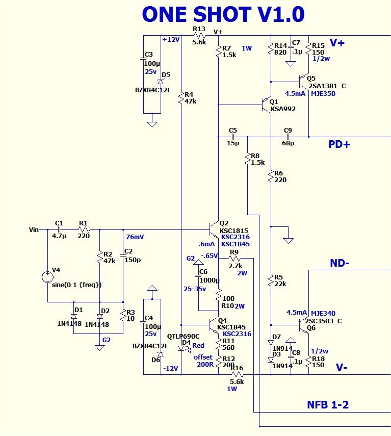

"ONE SHOT" CFA ....
Here is something different. This is what they SHOULD
be doing on the "CFA" thread !
(below) is a SINGLE CFB device driving a TMC beta enhanced VAS
with /current source.
I'm down to 20mv offset and 40ppm THD 20 with
just 5 devices.
I only just started refining CLG/UG (compensation).
OS

Oh oh another cfa😱Here is something different. This is what they SHOULD
just 5 devices.
OS
My god you can't stop.
I'm tired ,i will never built anything more

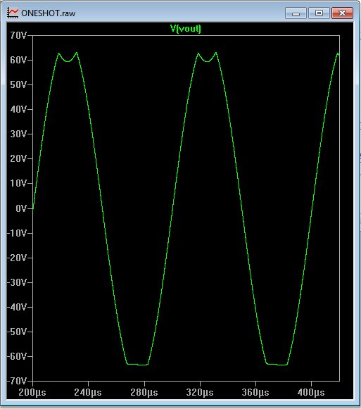

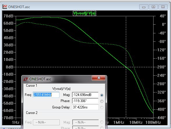

WOW !!
As expected , a single ended "badger/wolverine" VAS cancels
odd harmonics (below 1) ...
BUT , there is saturation on the enhanced VAS rail 🙁
(just like the badger -below 2).
CLG/UG seems to be almost a "hybrid" of a badger- CFA 😱 (below 3) .
Next is squarewave "abuse". (see if this sucker can "slew" !)
PS - I now am at <20ppm 20K !!
OS

The "downside" ...
Slew sucks !
VAS CCS ( not having a symetrical current on demand) VAS
really slows things down.
About the same 50-70V/ uS ... same as the "badger".
Still , It proves a 5 device CFB powered "abomination"
can give PPM performance.
Look below -
H5-9 is only 1 part per billion. (1st 4 Vs. all 9) This circuit cancels out ALL
higher order components. 😱
OS
