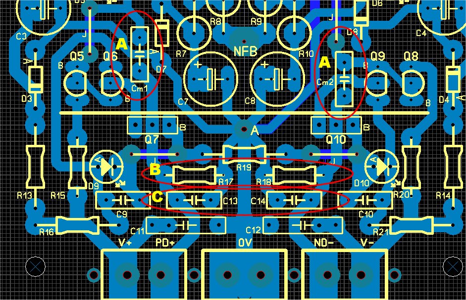

With respect the the Csa/Csb locations on the OPS, could or should they be a set of pads to make it a Zobel for the base-collector or just leave it for capacitance only. I only ask since your notation on the schematic suggests values for an R and a C.

I was about to elaborate on both the compensation and led choices.
1. on the OPS , no need to embellish "csa/b" with a full zobel. I added
this option as a last resort for that yet to be encountered IPS / OPS
device combination that (may) exhibit some instability.
With this option , just about every EF3 local compensation method can
be implemented. (NO redesign needed - covered my ar$e 😀 ).

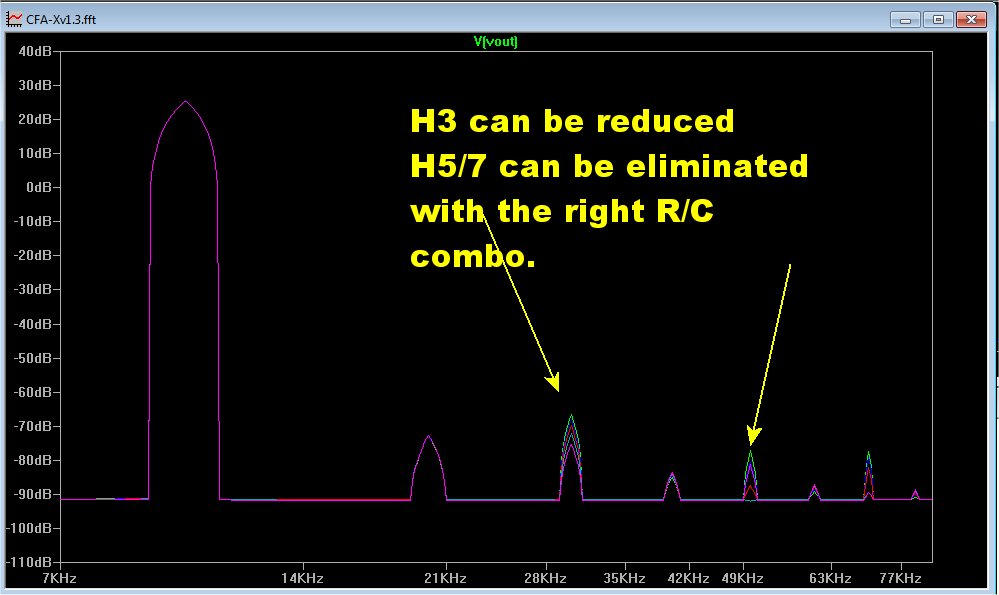

2. I'll elaborate on the "CFA-X" compensation.
Here I gave 3 options ....
A. - straight miller comp - stuff "Cm1/2" with the 33pF caps.
slightly lower THD , but you get overshoot if you go too low (pF - value).
H3 is dominant , lowest THD at higher OPS bias.
B. The Hawksford "load" resistors - can be used with "A" or "C" (or not
at all). These load the cascode down , making for a more uniform
Z (impedance ) with regards to freq. and amplitude. A lower
value raises H2 and total THD.
C. "Lead/shunt" comp. This method will allow for the fastest slew ,
has slightly higher THD (H2) .... it is funny , a lower OPS bias
gives the lowest THD.
The different compensations of the hawksford seem to change how
it interacts with the EF3 OPS ... the change in optimum bias vs.
THD is notable.
The "fastest" is "C" ,with 150K/15-22pF (B-C below) .... I can
get this little "gem" to slew rail to rail in .15uS (600V/uS+) - EASY!
Another big "fallacy" is the need for massive current feedback. I
simulated with 120-150R/3.9K as CFB. This only made for 4ppm
increased THD (all biases). Slew could be increased by lowering
Cdom.
At these values, 1/2W-1W resisters could be safely used and all
the "current on demand" plus the other CFA attributes remain
constant.
This most basic CFA IPS is a definite "learning experience" , it
can show the limits (or drawbacks) when using this topology. 😎
THD harmonics can be "trimmed" with the proper compensations
(below 2).
OS
